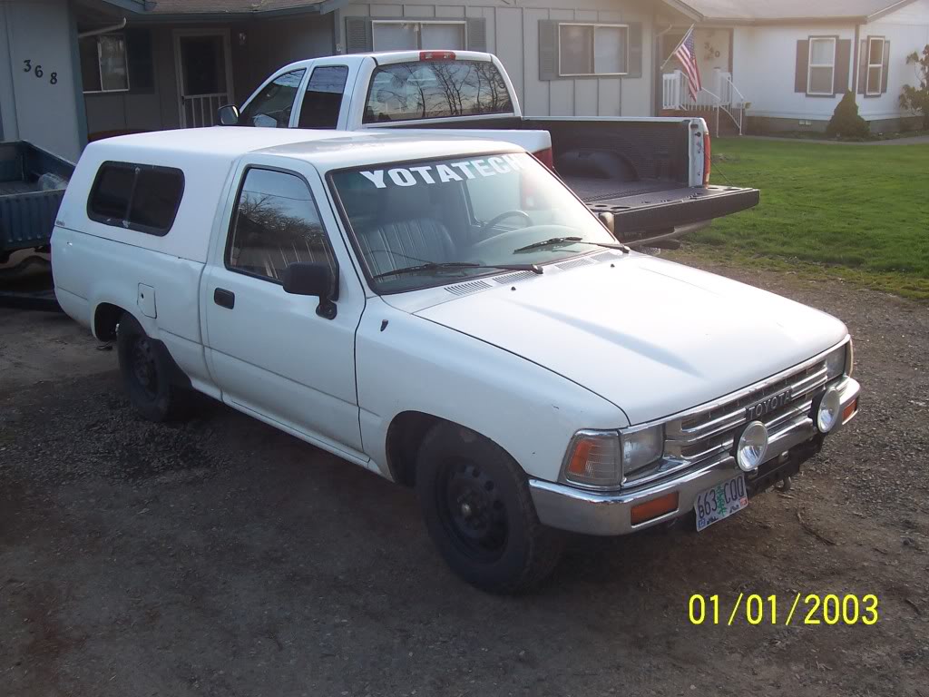

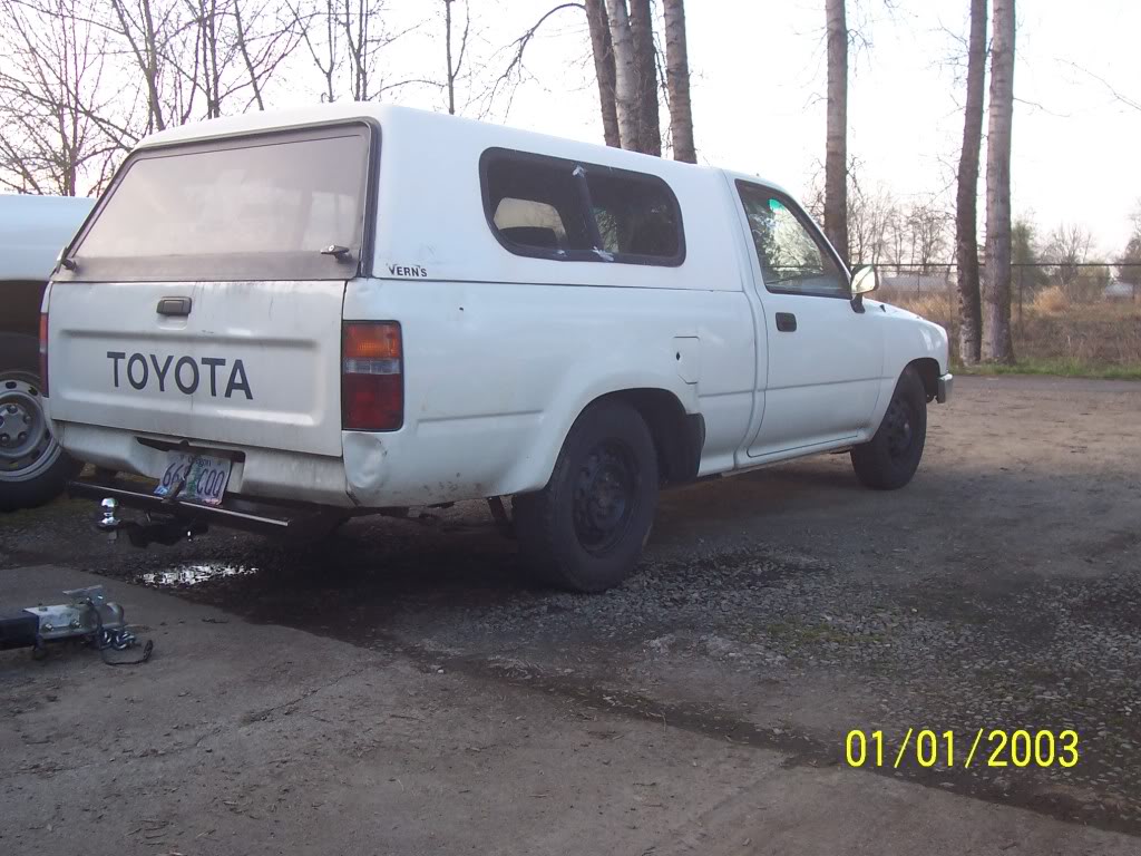

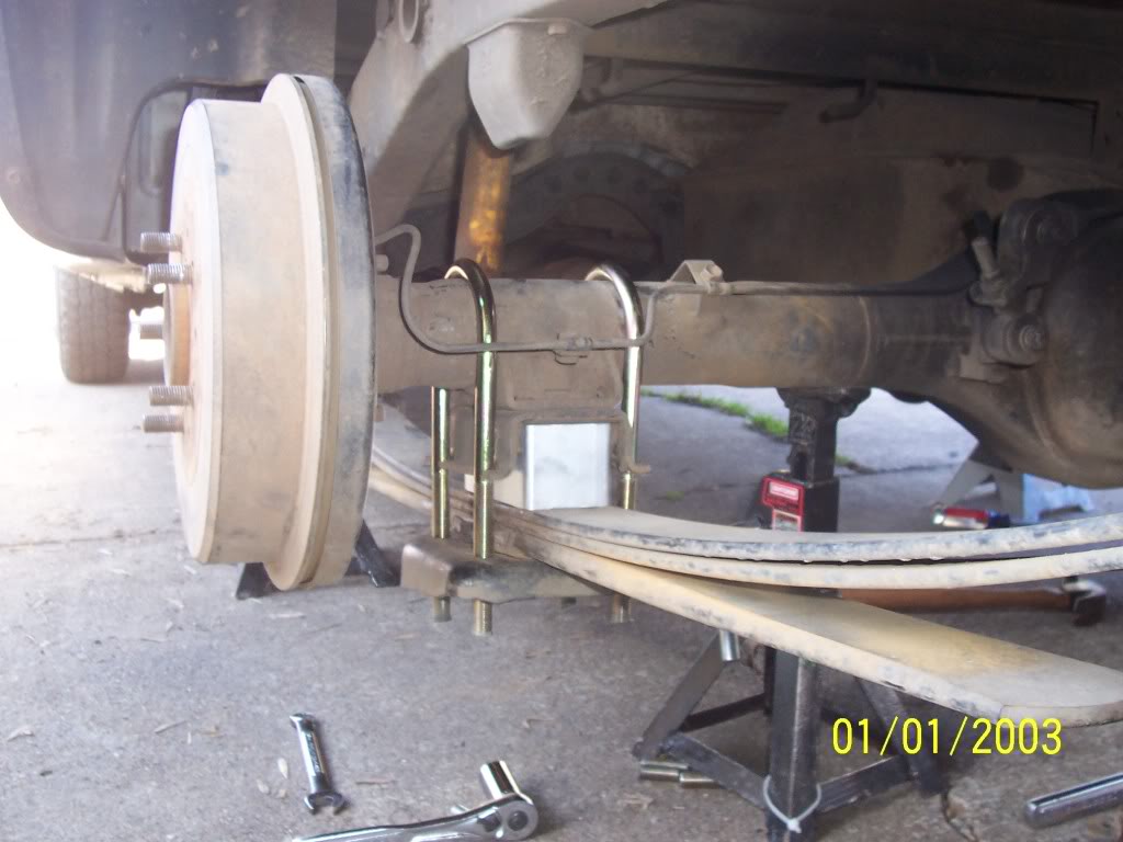

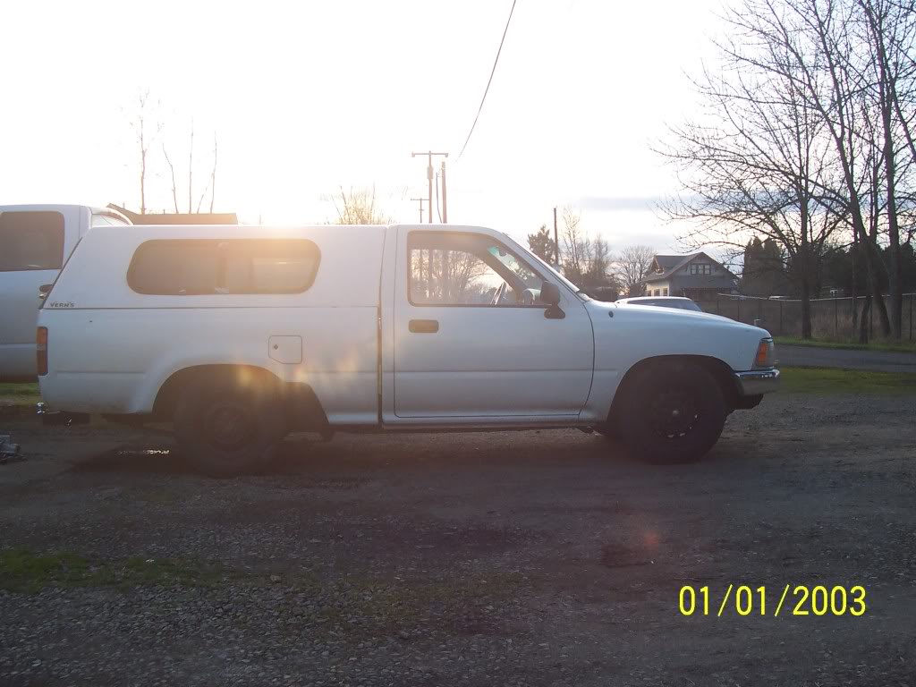

here's my truck after a couple hours ago...
Old Mar 18, 2009 | 08:17 PM

Just currious why you lowered it? With those off road lights up front it looks like it should be raised.
hey, how did you get the front lower?
was that all just from relaxing the tbars?

Haha sweet! You are gonna drag the tow hitch all over the place lol. Make sure to check your u-bolts often.
