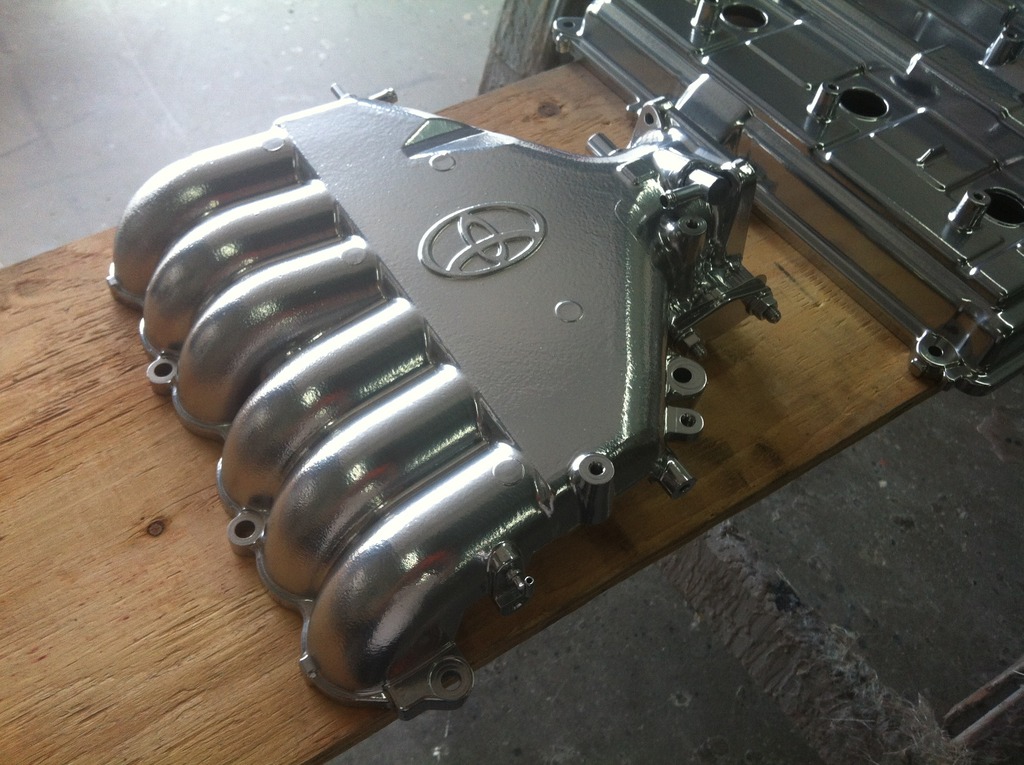

I have been using the eastwood chrome powder
http://www.eastwood.com/hotcoat-powd...rome-8-oz.html
if I had a tumbler , it is suppose to be real shinny , just like chrome ... but no tumbler .
I'm ok with this look .. it's pretty close to chrome ....

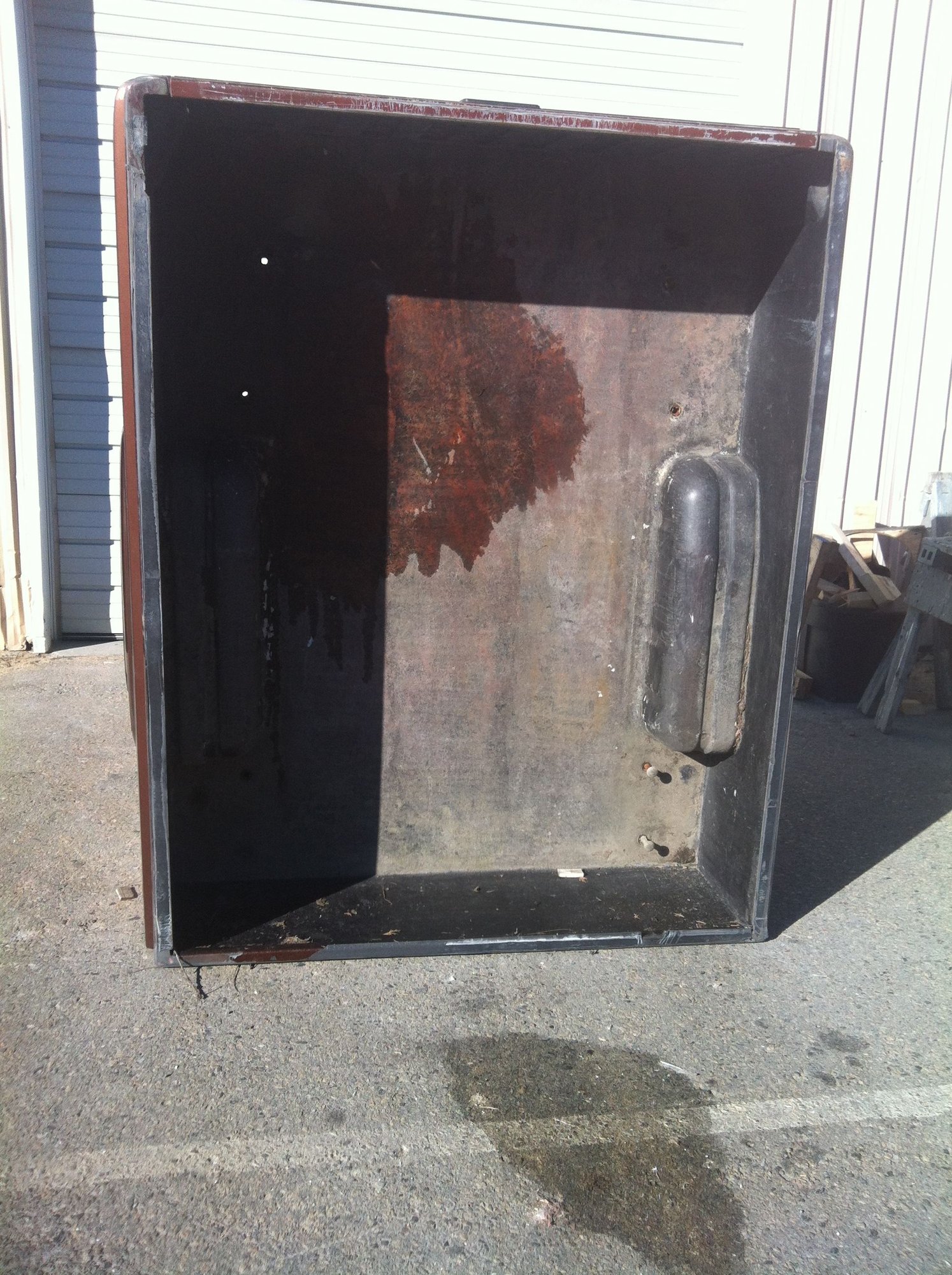

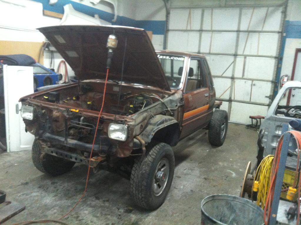

started the tear down this morning .. pulled the truck in my shop and got to work .
canopy was the first thing to go
and then removed the bed

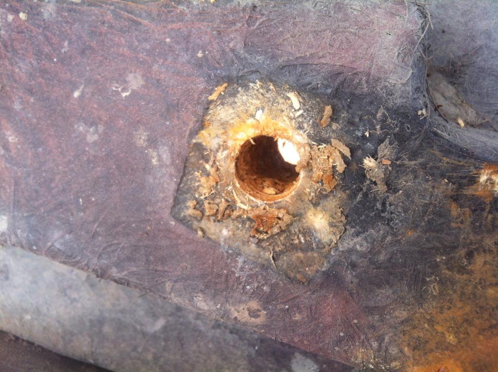

I was actually excited to see the out come of this , as I have only done this once before on one of my old beds . as I mentioned earlier , this bed was installed at my shop ~ 10 / 11 years ago , so I was anxious to see what it actually looked like after so many years . my personal DD has had it's bed on it's truck now for 15 years , but someone else's truck is always good "gauge" as well .
so heres what we got
other then the inner paint , and under side paint , everything is GREAT , I'm super happy with what I have to work with , and It should last at least another 15 years ... easily !!

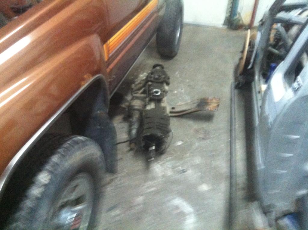

also , got the tranny out

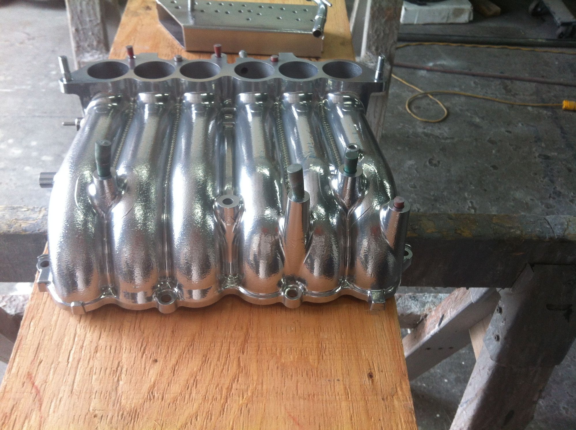

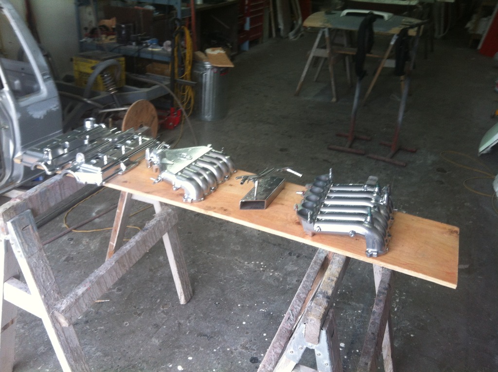

with summer approaching , it should make it easier to find time .
I was able to get some more shiny done
just about ready to build the engine now

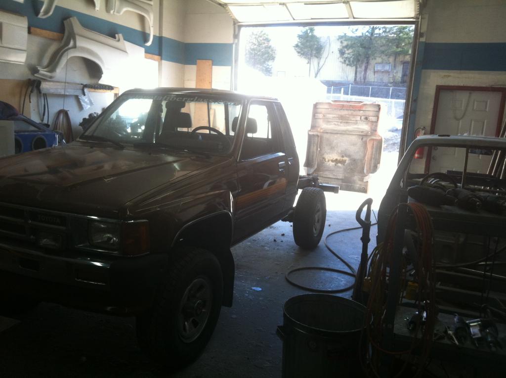

cab is ready to come off

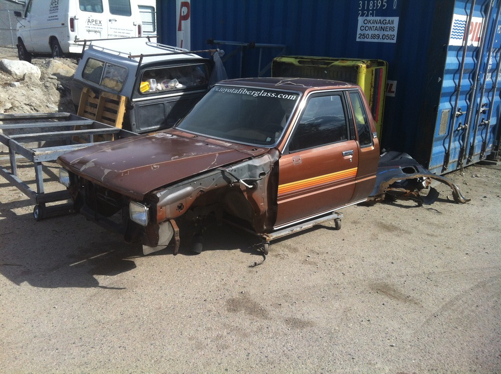

CAB OFF
and now I can get to work on the frame

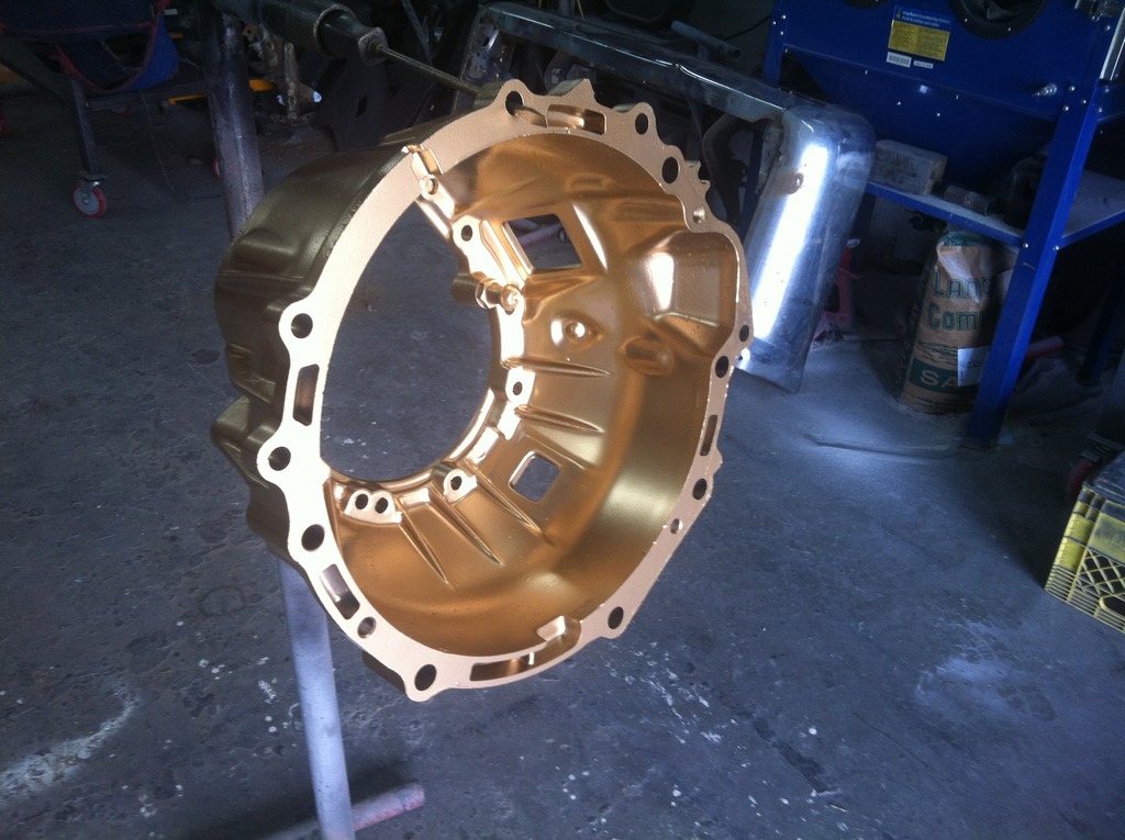

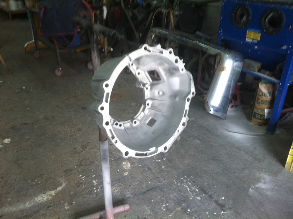

also .. "blasted" the bellhousing and painted ... I just needed to see some color . I think the gold is going to go well with the accent in the original tribal decals that are going on the outside .. this is also going to be the engine block color

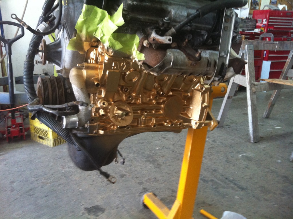

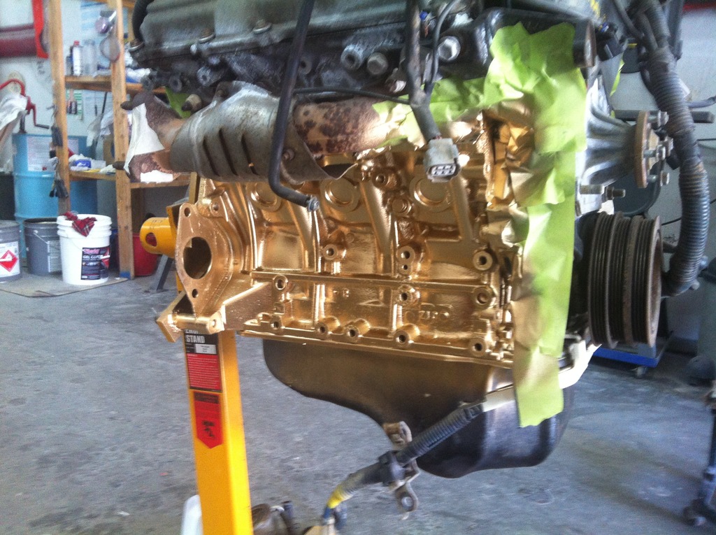

some color on the block today ...
now I can start striping and building

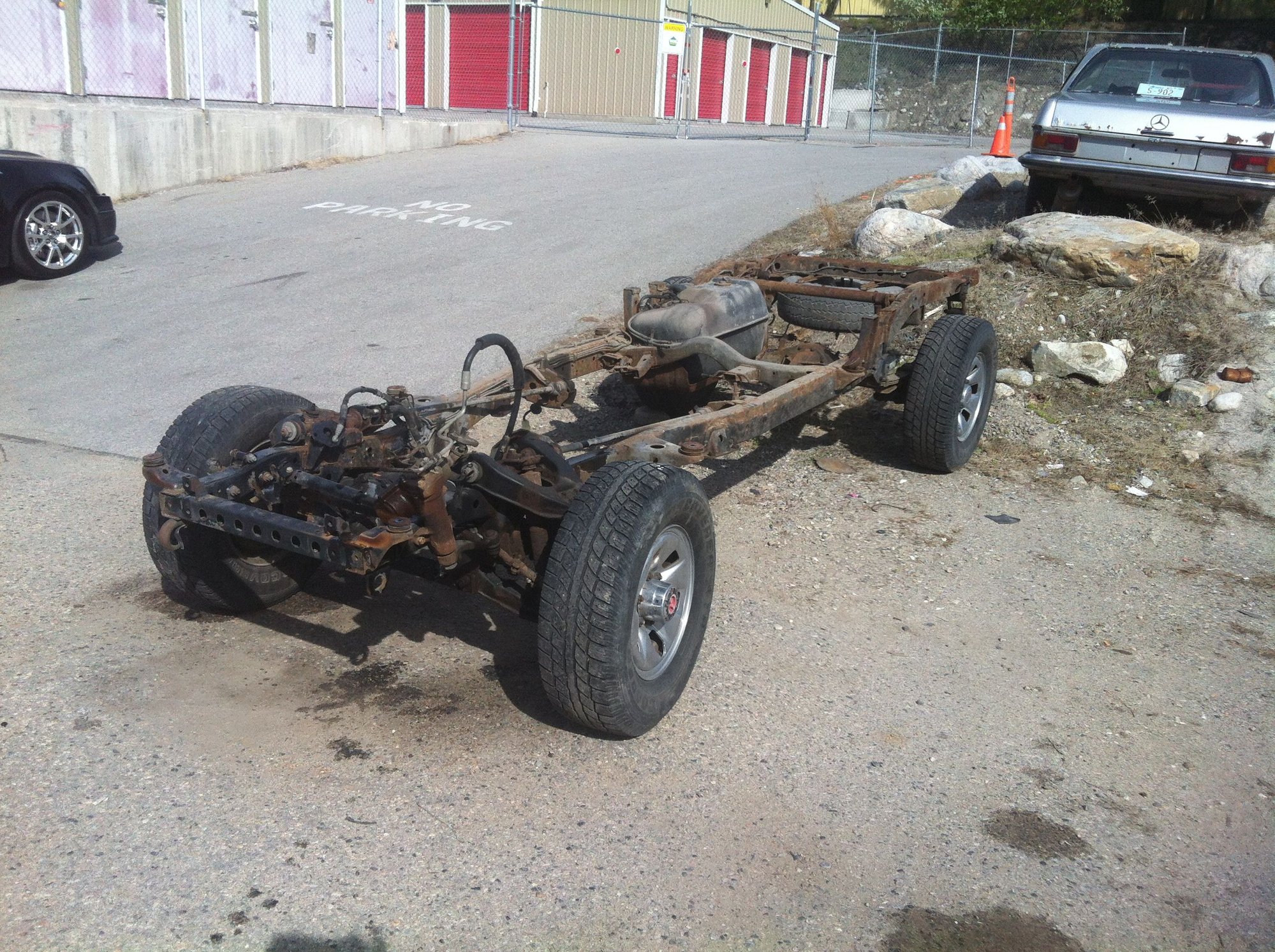

frame back into the shop for the weekend ...
pulled the fuel tank,brake lines,torsion bars .. and other pieces , getting ready for the POR 15 treatment
cut off the 22re motor mounts as well, and now just building some new ones for the 3.4L
sorry for the crappy pic

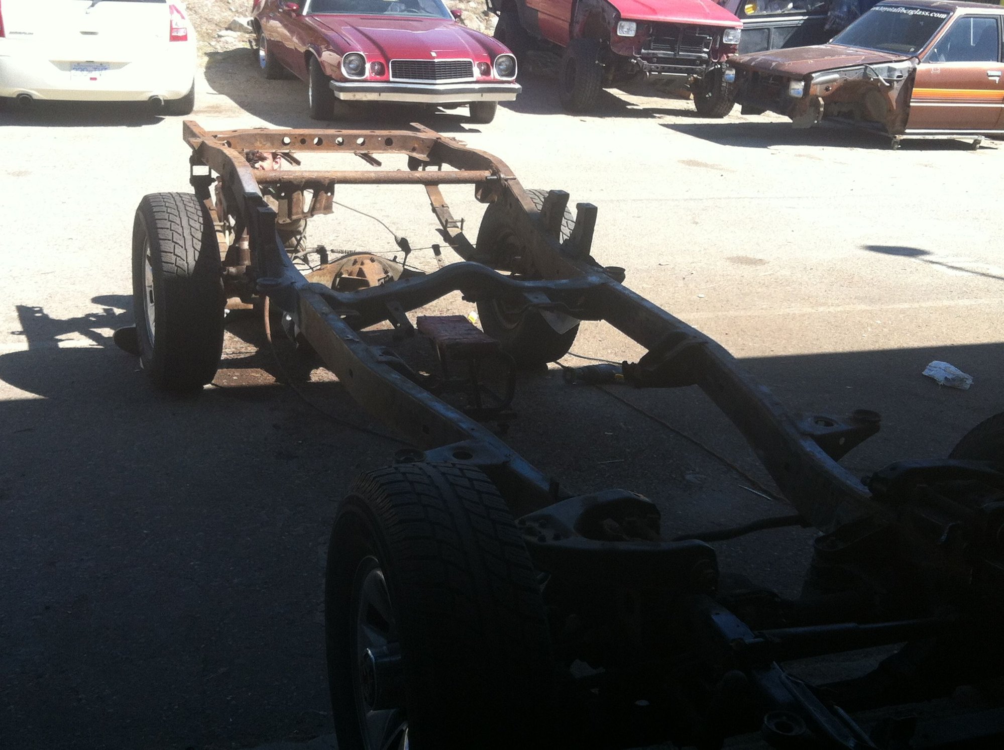

little more work in the last couple of days ..
my buddy Joel .. yep , supercharger 4Runner Joel ,( owner of a build I did for him a few years back ) wanted to help .. so put him to work cleanin the frame up ..
