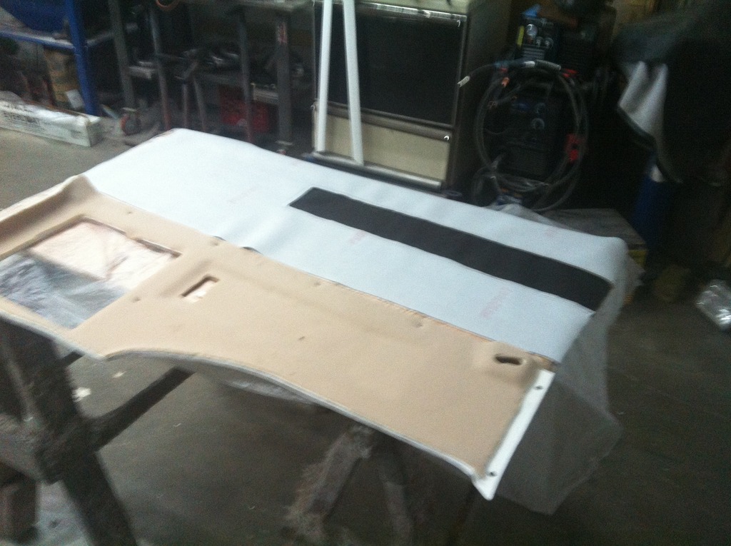

so .. a little incite on the panel builds ..
Zack asked for a " water resistant " solution to the deteriorated and warped cardboard backed interior panels , so as you saw in the previous pictures I made some FRP backings .. as well as the rear panels I already make , the interior has begun ..
so started first with the rear panels ..
covered in foam , and then "stitched" new covers ..

I guarantee these new backings will NEVER warp or rot

Did you sand the topper smooth before paint? Is there a way to add a little fiberglass reinforcement to the rear bottom corners where it stress cracks from its own weight and setting it down too hard?

yes , sanded the top smooth , IMO it is the only way to do it ! .
no way to add reinforcement in the corners , unless you separate the inner and outer .

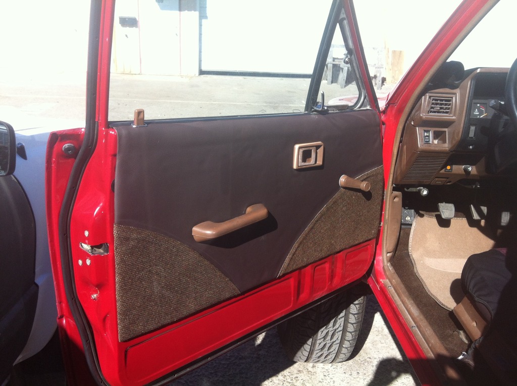

new door panels

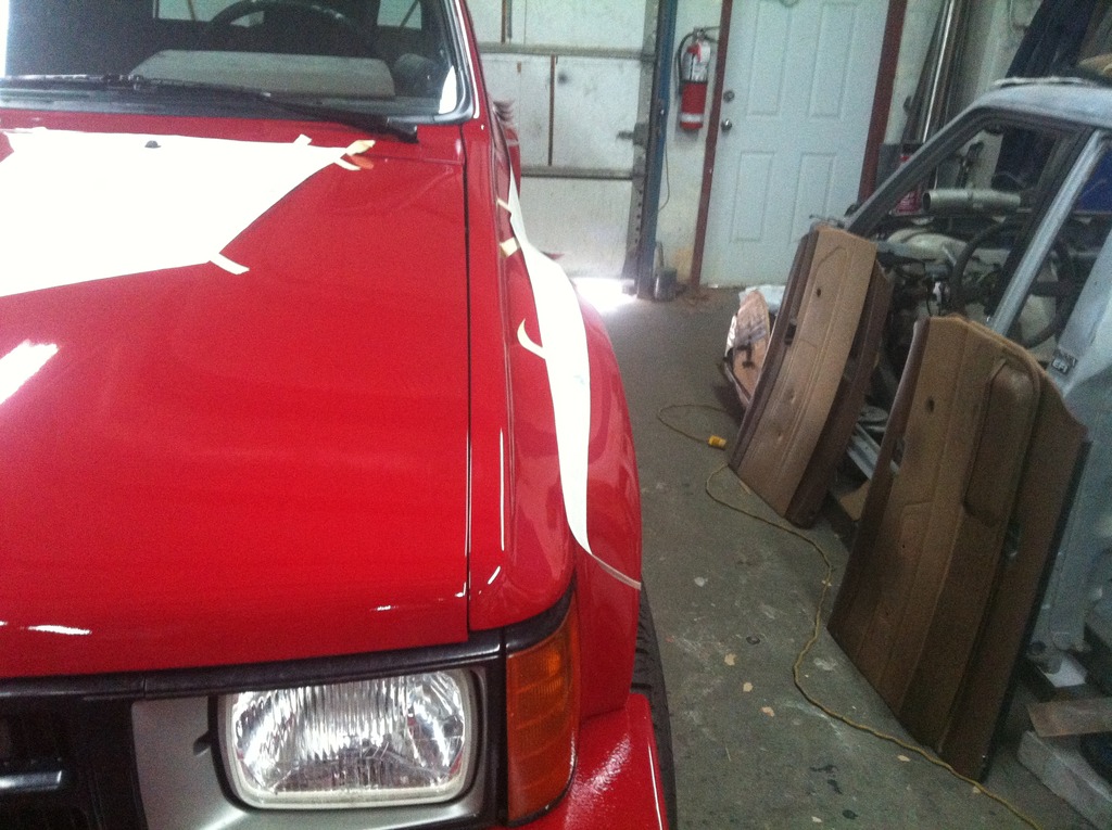

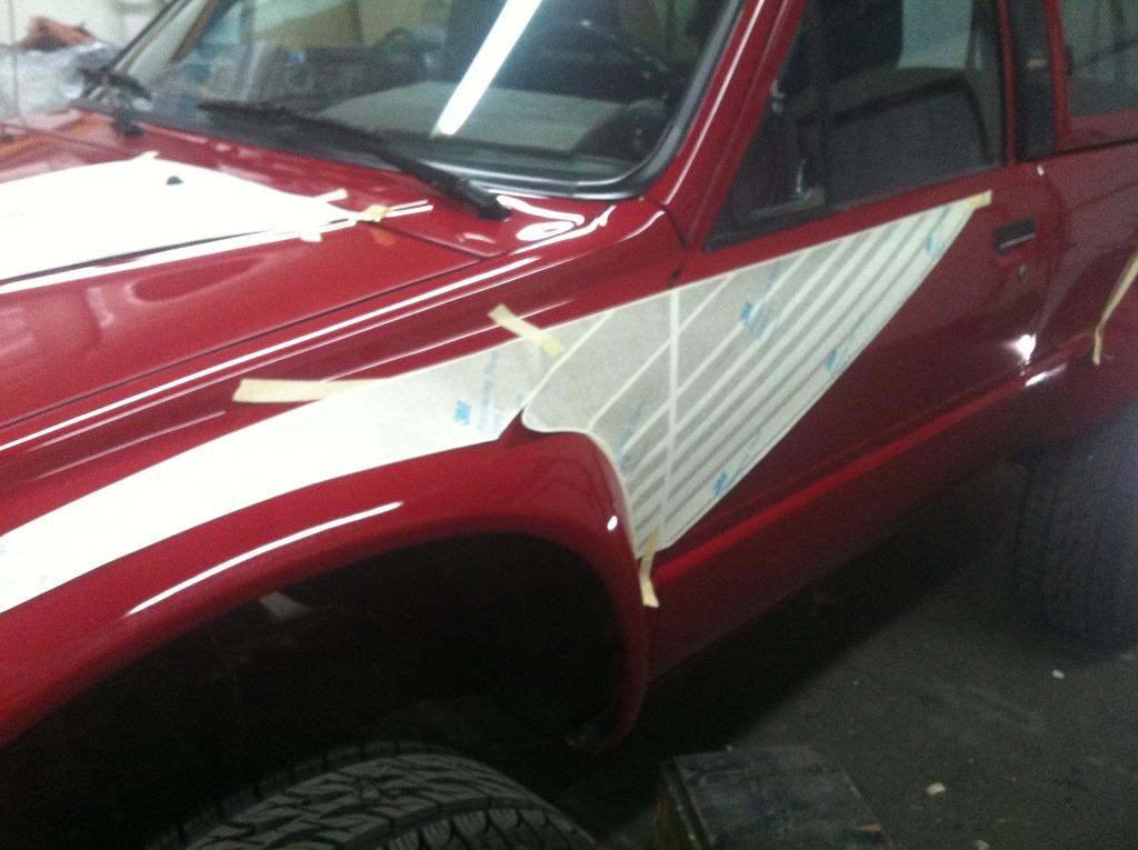

and stripes .. cant show the "final" product , but will post these .
Zack bought these from james dean creations , and brought them with him when he dropped the truck off . because of the flared and round fenders , we couldn't use the whole kit , in fact , it was a bit of a challenge to fit , but we did it .. I wish we could have done our stripes .
anyway ...
my pro stripe guy Wayne doing the install

as you can see , they would be great for a stock unit , but this is now far from stock , so we did have to modify

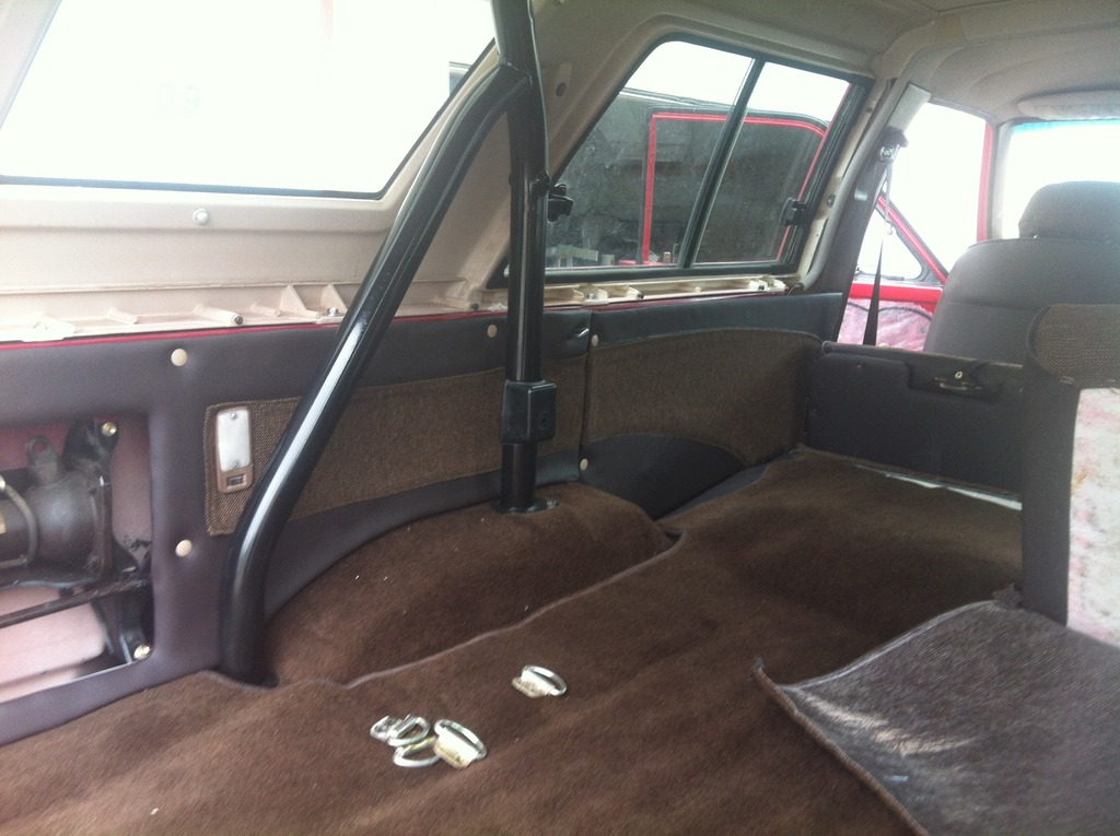

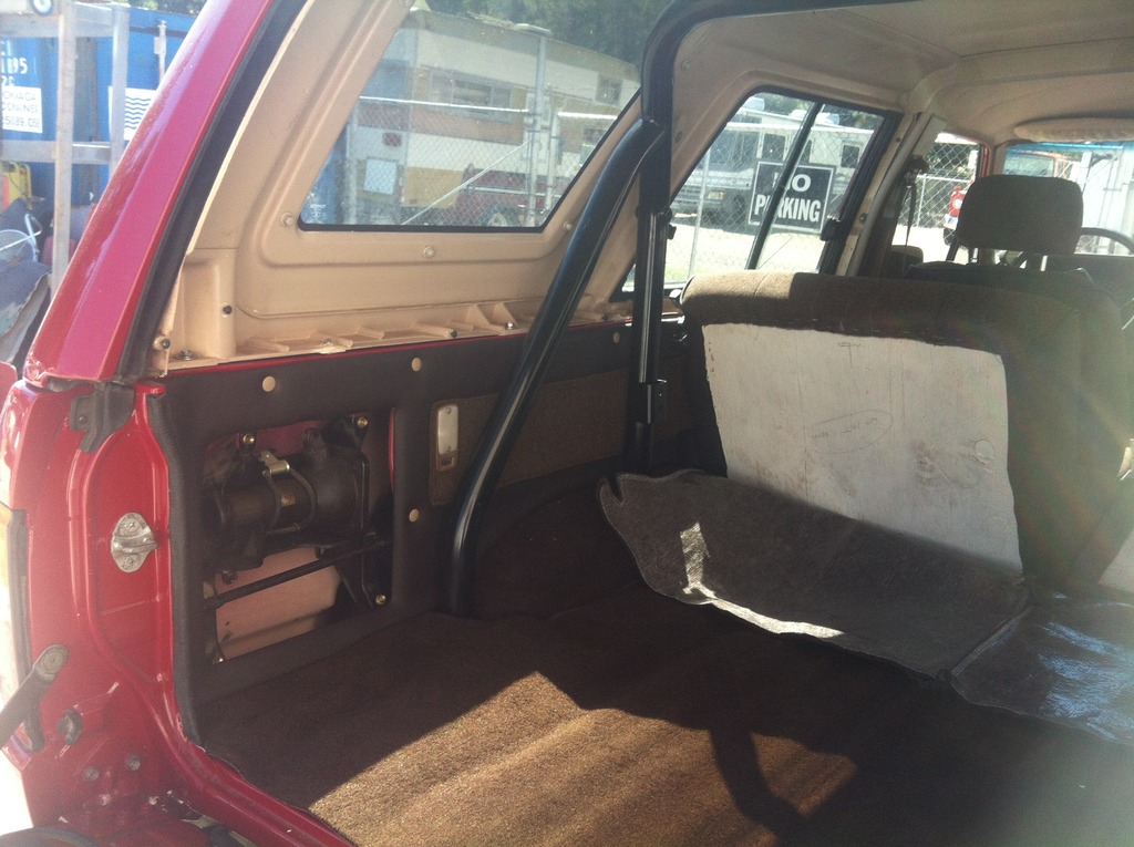

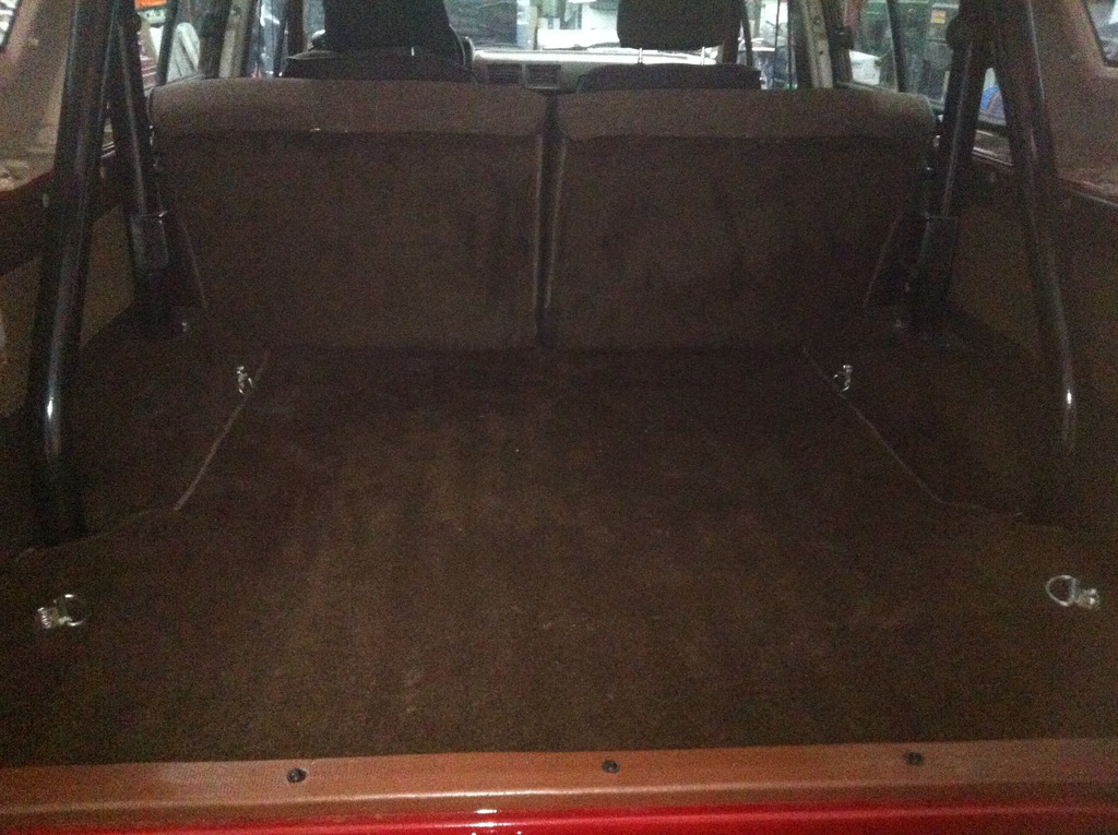

and 1 more pic I can post
rear hatch area
