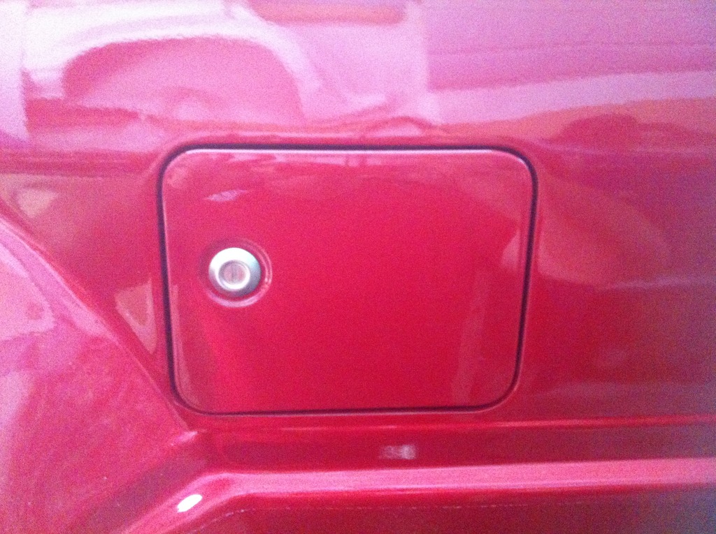

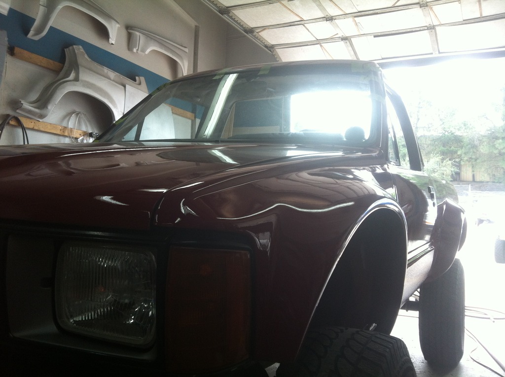

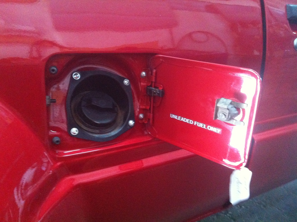

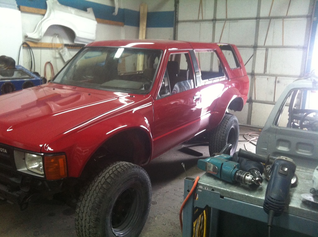

fuel door installed ..
notice the new decal ... it's a beautiful thing

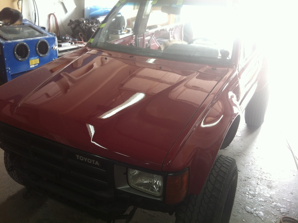

also , hood is installed

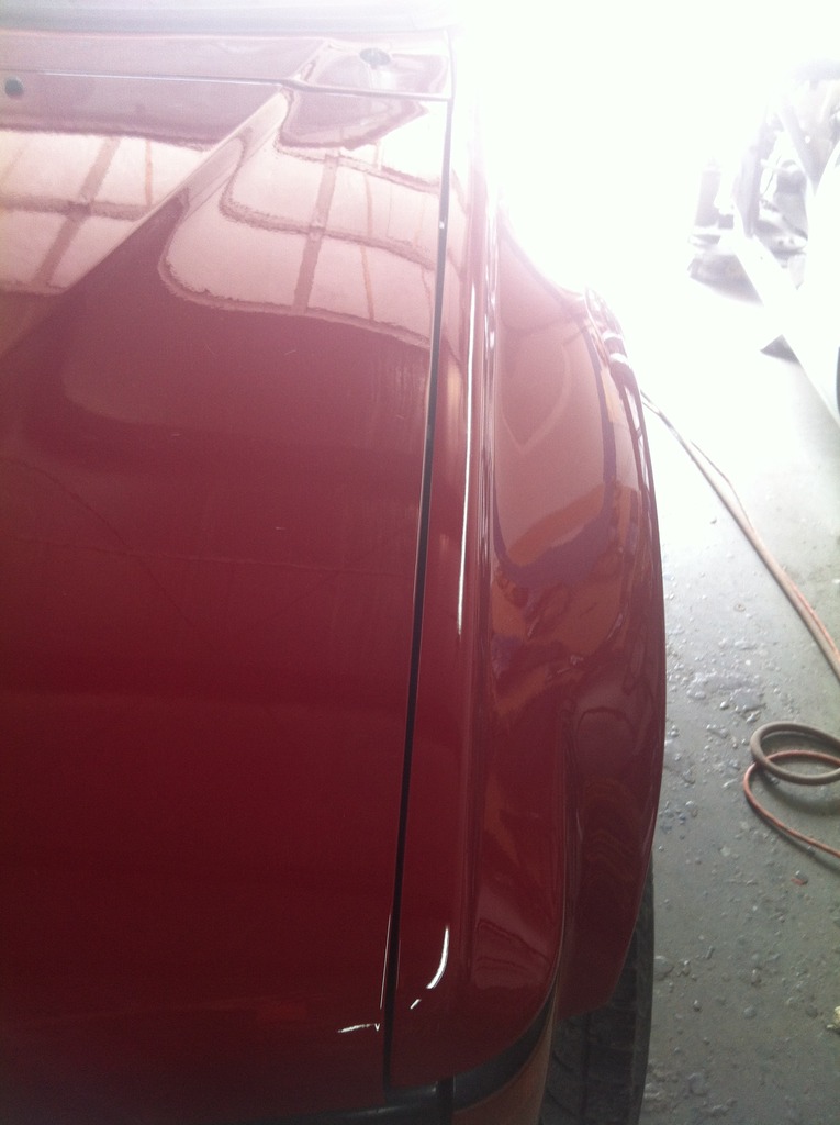

and some body lines

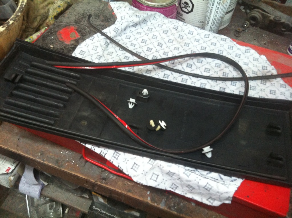

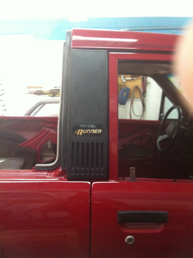

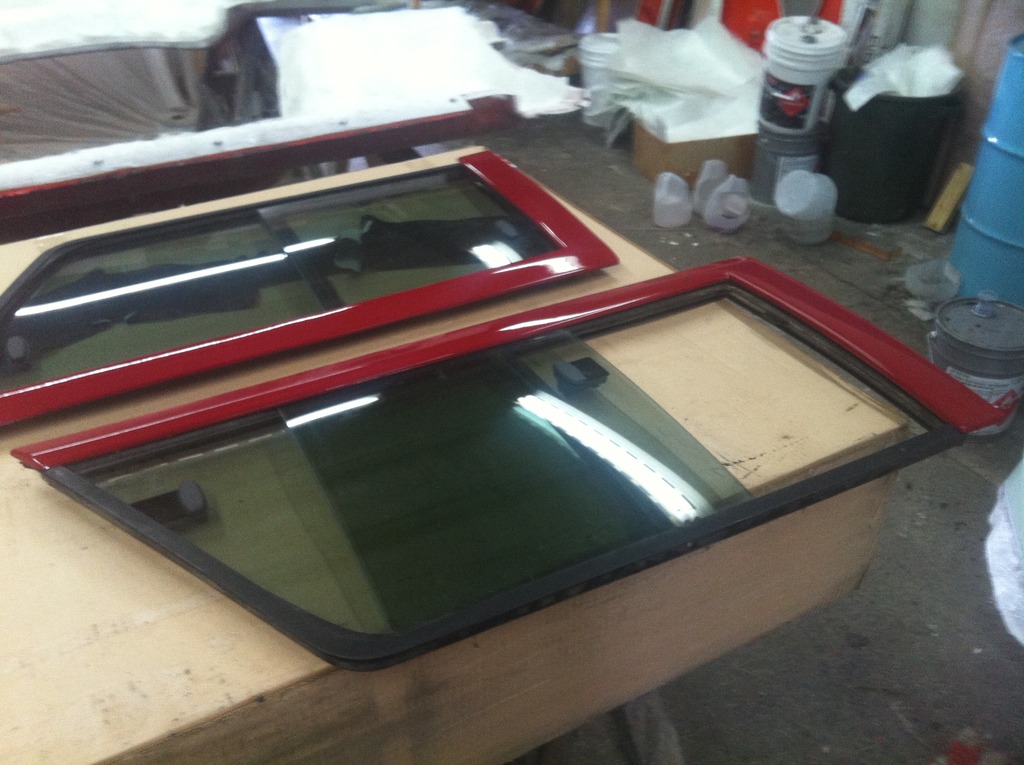

also , the sail panels , new clips , and seals

Nice clean body gaps! That Unleaded Fuel Only sticker reminds me that I need to put mine on - not that I ever encounter leaded fuel. I hope I didn't lose the one you sent me! If I did I may be coming to you for another one and a Precision 4x4 sticker to sport on my truck as well!

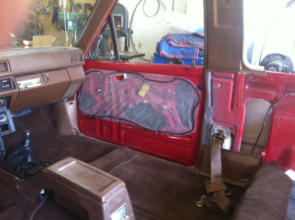

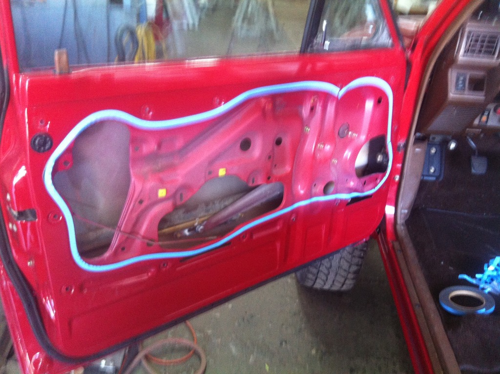

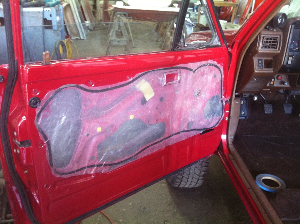

doors are back together , window tracks greased and working smoooooth
added some new door seals on all 3 doors ....

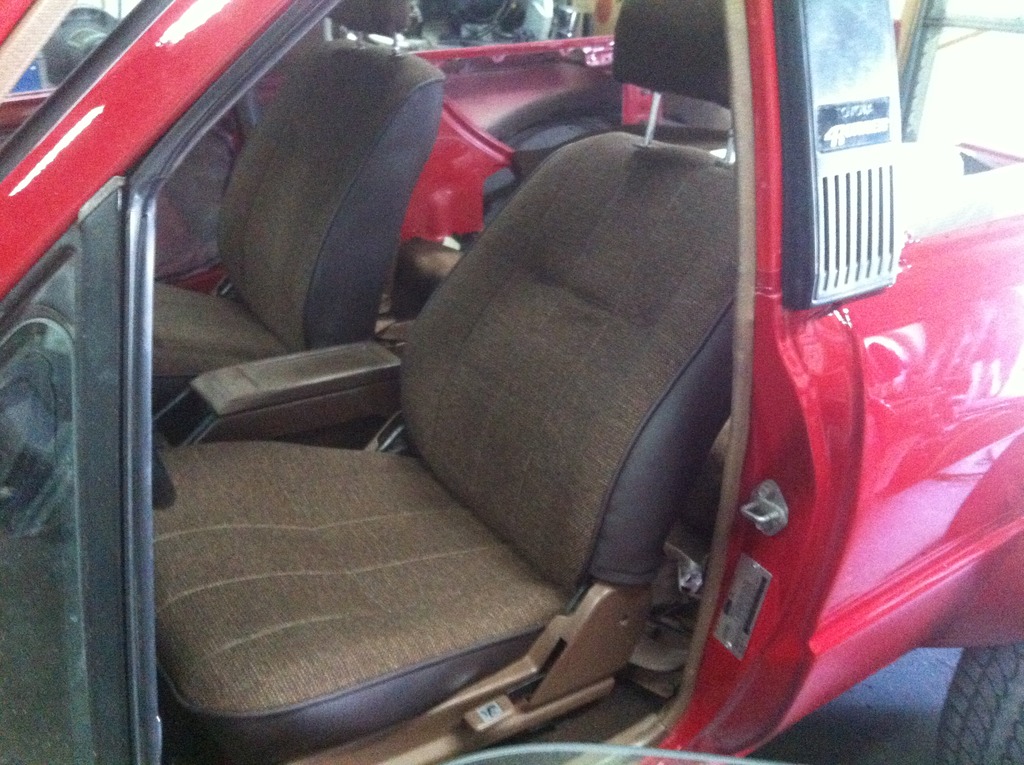

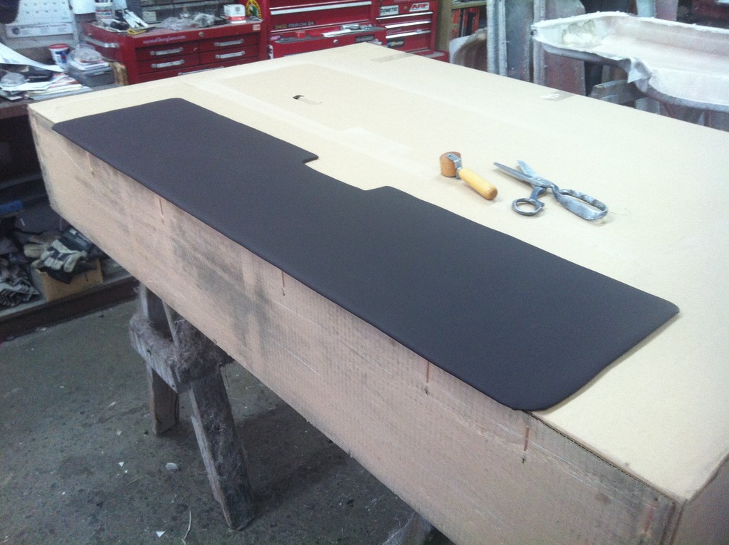

and .. also front seats are done ...
added some new foam , as Zack was saying they weren't comfortable anymore . Zack has the roof off quite a bit , so he wanted a product that would work in the out door environment .. the main "fabric" is rated @ 400,000 rubs , and the vinyl is 200,000 .. so should be wear really well and last a long time .
interior panels will be custom made to match

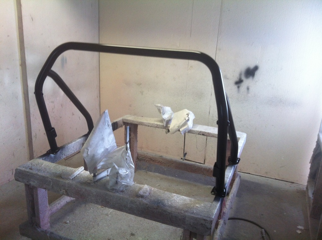

scuffed the almost 30 year old , weather beaten paint on the roll bar .. and put a new coat of satin on it

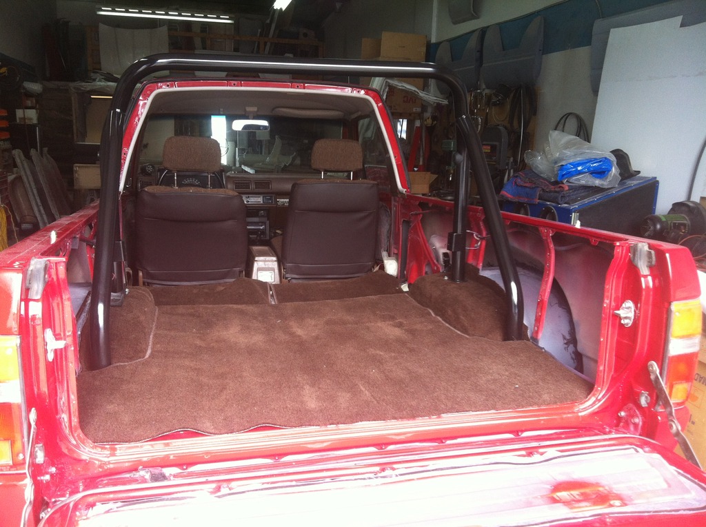

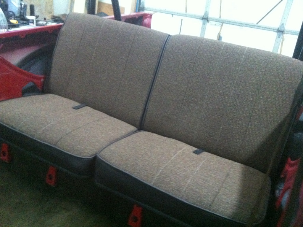

back seats are in ..
and back carpet kit .. is sitting in place

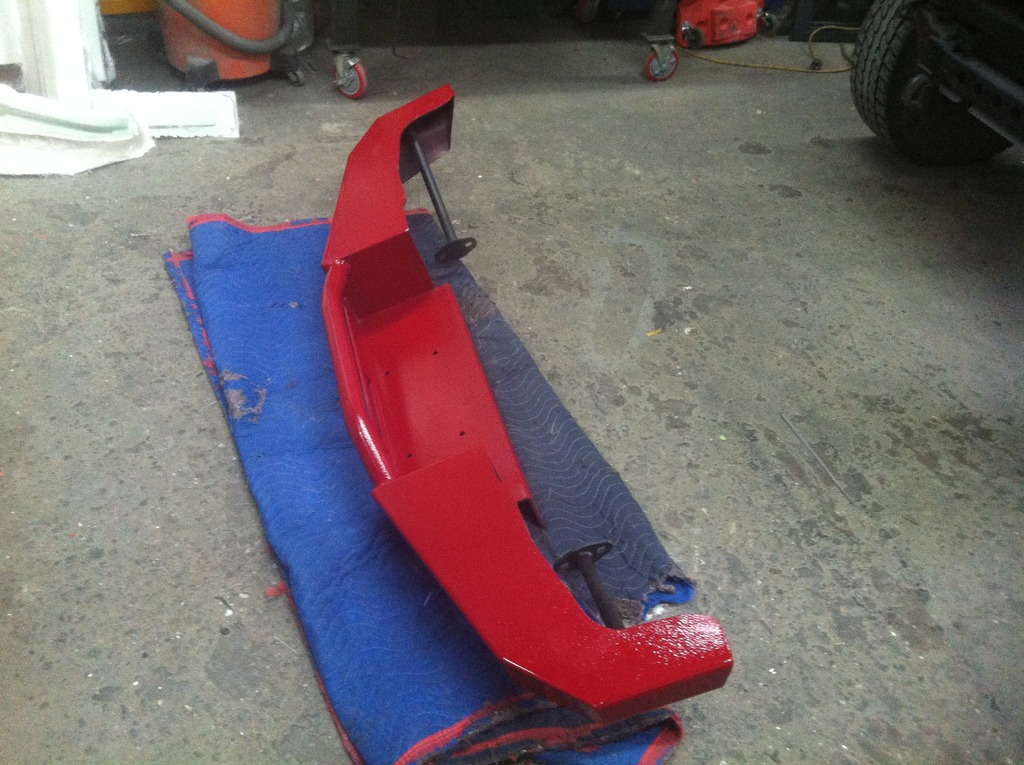

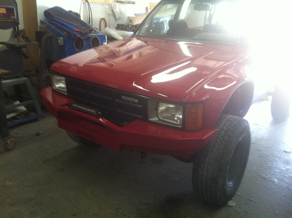

Zack wanted the front bumper painted ..
and installed

so did you build those seat covers yourself, or did you get them as a kit? my seats are super uncomfy too so I've been looking for ways to upgrade to different seats or repair the one I have.

This thing is coming together beautifully!! I really like that style bumper on that truck - solid and beefy yet non-obtrusive! Looks like you used chip guard on it too (good idea!), but what kind do you use? The kind that goes under the paint or the clear over the paint? I think we need to convince Zack to snag a chrome grille and headlight doors - That would really set off that front end nicely with the color matched bumper! (Zack, I'm pretty good at spending my own money but I'm REEEEALLY good at spending other people's money LOL)
all sewn here ... same as the door panels (coming soon) We do the custom work here .

yep , used the rock chip protector on certain sections of the bumper , it really flows nicely with the paint on the body , and it will be very helpful
I cant remember the product line at the moment , but yes , it is sprayed on the body/bumper , and then top coated , and cleared just like the truck .

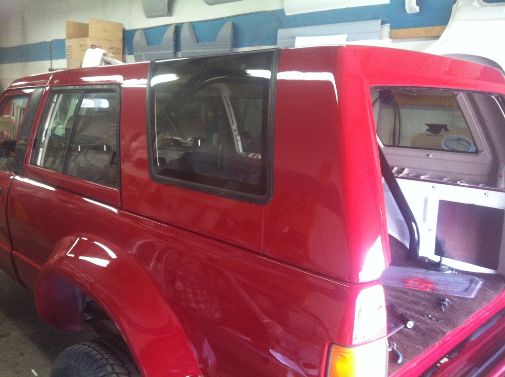

Originally Posted by yotes86
how do the back curved glass pieces come out of the 4runner top?
they just un-bolt from the inside , and then you have to push , as they are held in with butle tape

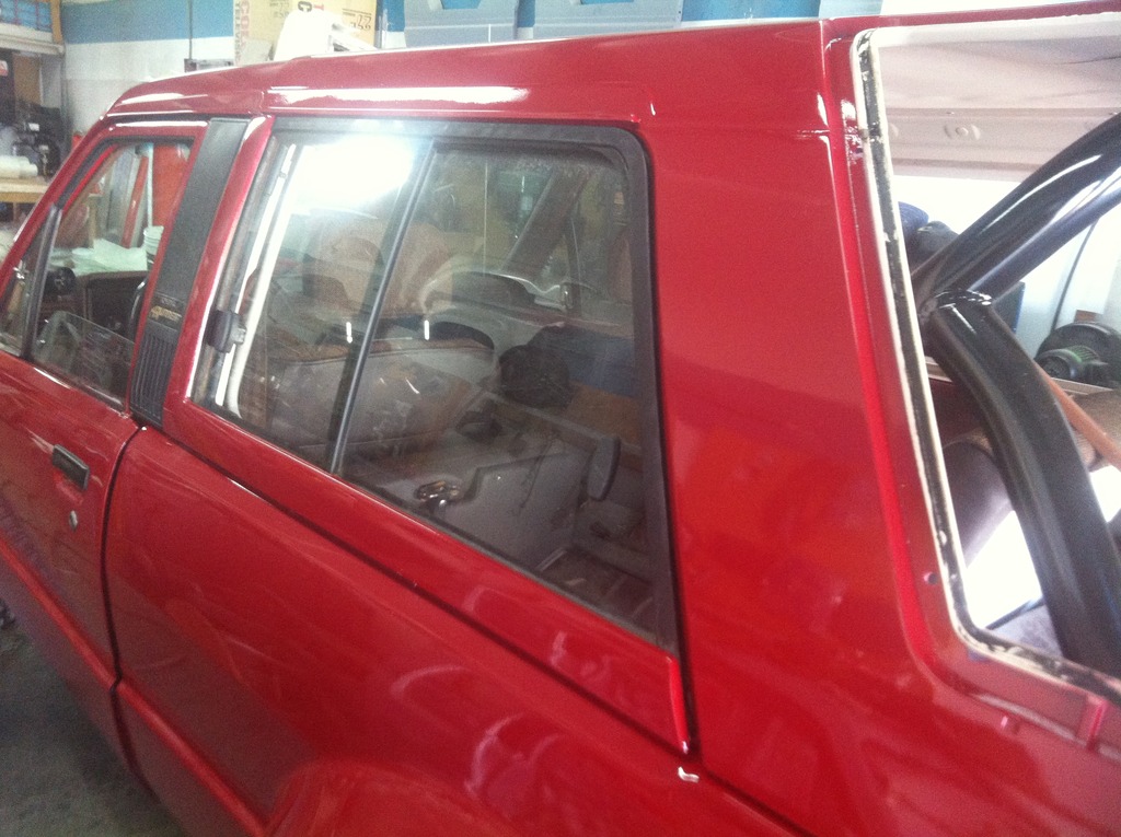

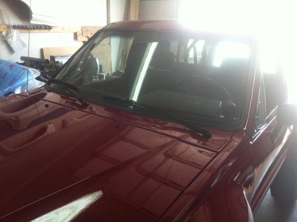

working on the smalls
1/4r windows in ...
wipers and mirrors

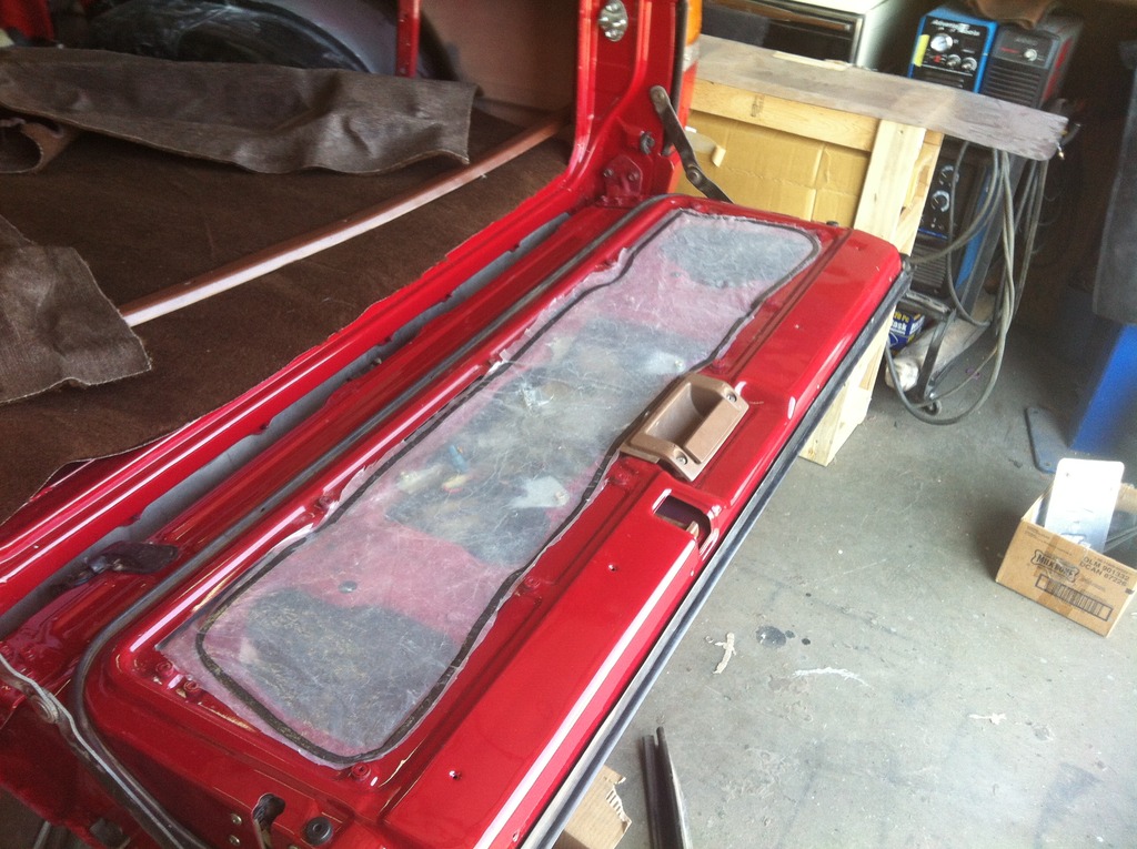

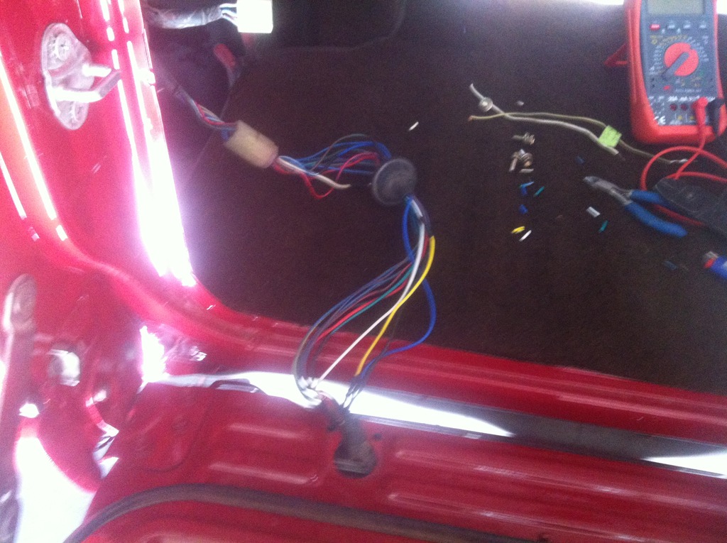

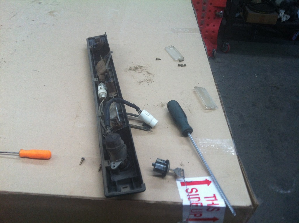

also went to try the rear window with the key , and dag namit ! it didn't work , so I tore it all a part again . on initial inspection , I noticed the ground wiring was not in great shape

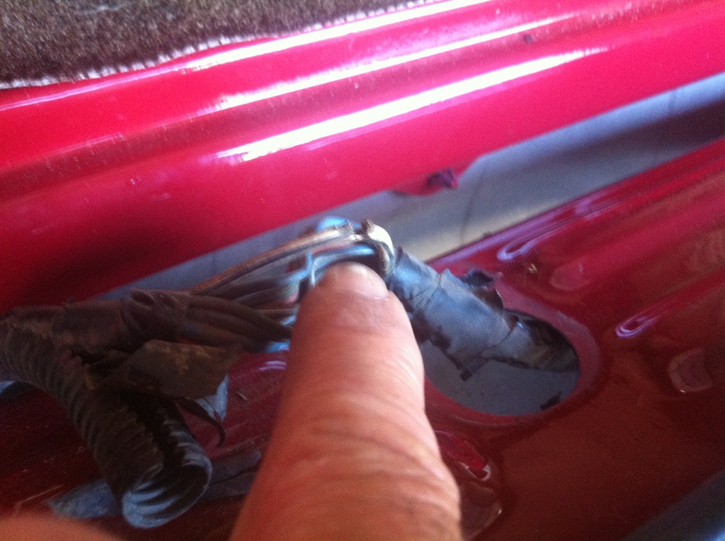

somebody , some where down the line ? .. used a test light on the wires . a lot of the wires had "pin" holes .and The wires we're very badly deteriorated , so I ended up splicing NEW wire and re looming
new back up bulbs , cleaned the lenses , and lubed the lock
I don't remember if the window was working or not when I got it , I think it was ? but the stress of gate removal was maybe what did it in .. in any case .. it works perfect now !!
new ball joint spacers installed

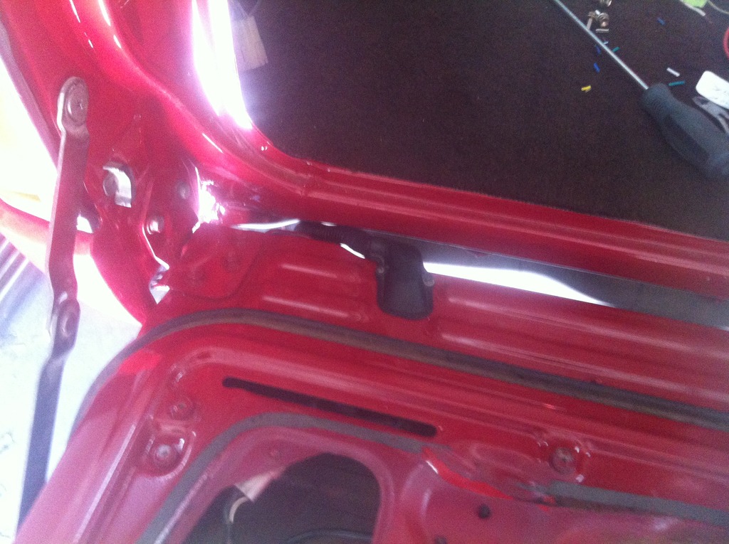

Yeah, yeah, yeah. I can feel all of your glaring eyeballs about the ball joint spacers. While I AM going all in here with Corey, it is still a limited budget build, and believe me, a TC Caddy kit is on the to do list, hopefully in the not too distant future.
Corey, I'm loving the progress pictures, and FWIW that wasn't me with the test light on those rear wires so it's been like that for over 10 years...thanks for saving me a headache down the road.
I noticed 2 things in the pictures...
-is that a different anti-rattle device for the tailgate support? something specific to the fiberglass setup?
-Can you do something about those horrible stickers on the rear side glass before the final glamour shots.

Zack
good eye .... yes , the original plastic ones are real delicate , and break easily . I think 3 of the 4 of yours were broken . these are rubber , and should last way longer , and work much better .
The wires were obviously done a long time ago , I had to cut and replace almost a foot of about 6 wires . the corrosion had "greened" the copper wire that much .
I also removed the switch on the back of the cylinder , cleaned the contacts in the switch , and put it all back together .. you will have pics on your CD , but I didn't bother posting all that stuff here . your CD contains 150 pics so far .
