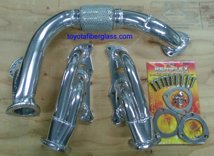

I finally got the headers back from my ceramic coater ..
I built the headers , but I cant do the ceramic coating yet , as it is cured at a much higher temp. then my powder coating oven will go . Cant wait to install them

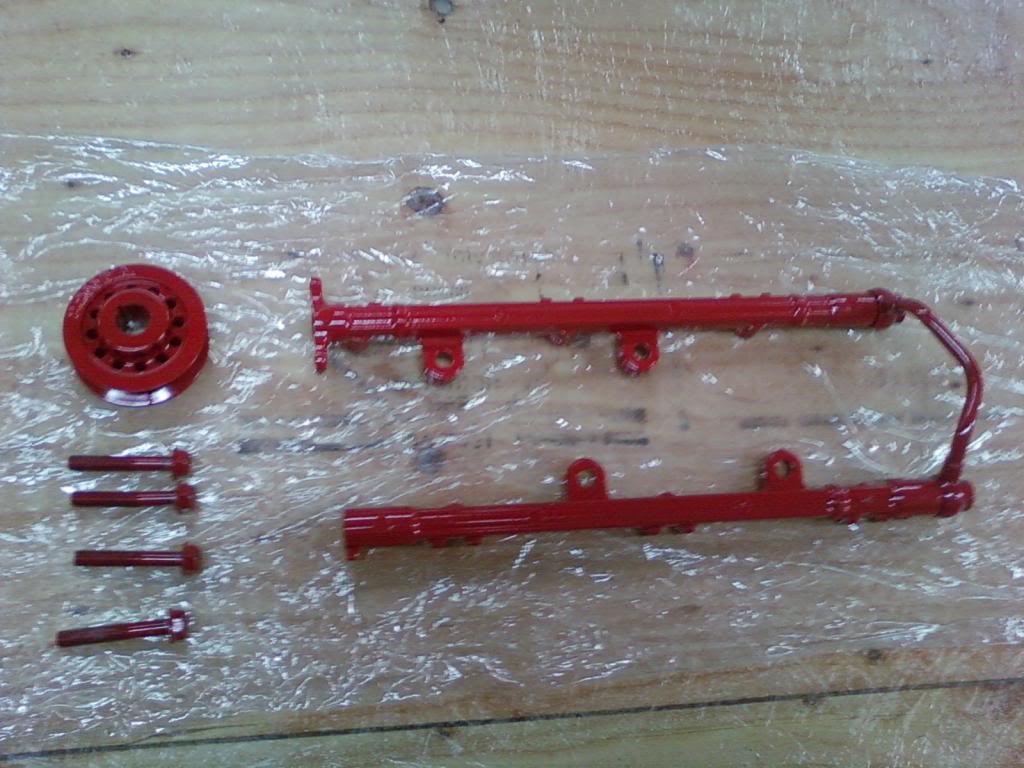

looks better in person

it's the fuel rail + bolts , and a URD 2.1" supercharger pulley ..

Does the powdercoating on the bolt threads give you any grief? I'm thinking that it could be beneficial by acting a little bit like a thread sealer and loc-tite

I will re die the threads before install , + add some neversieze

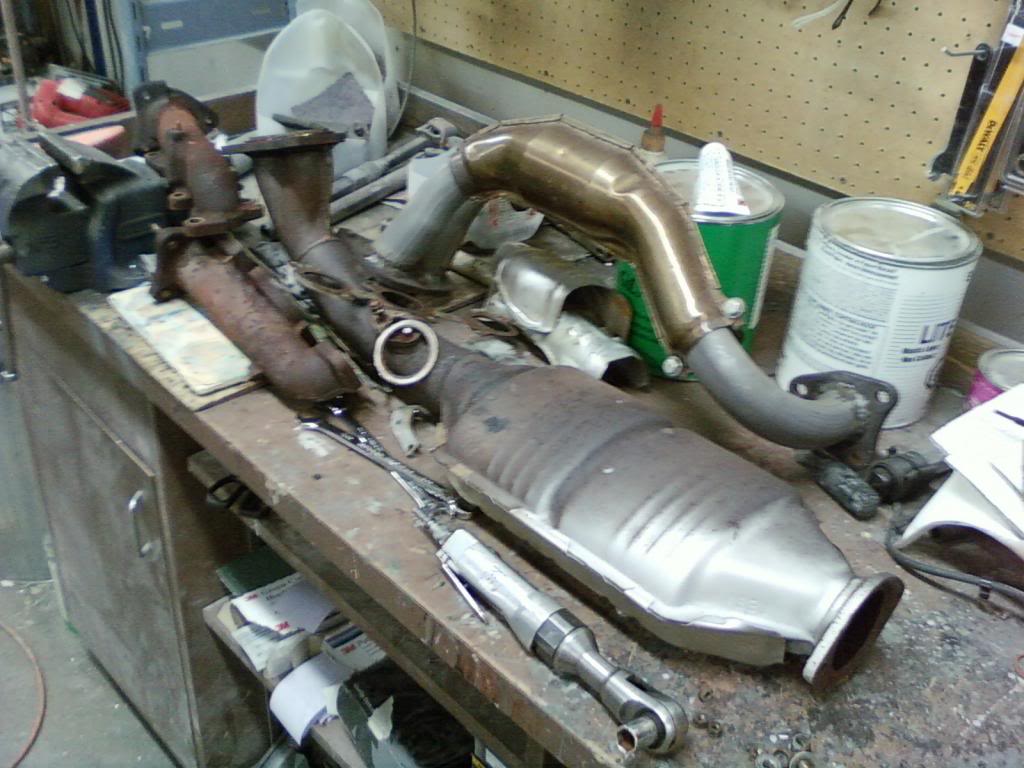

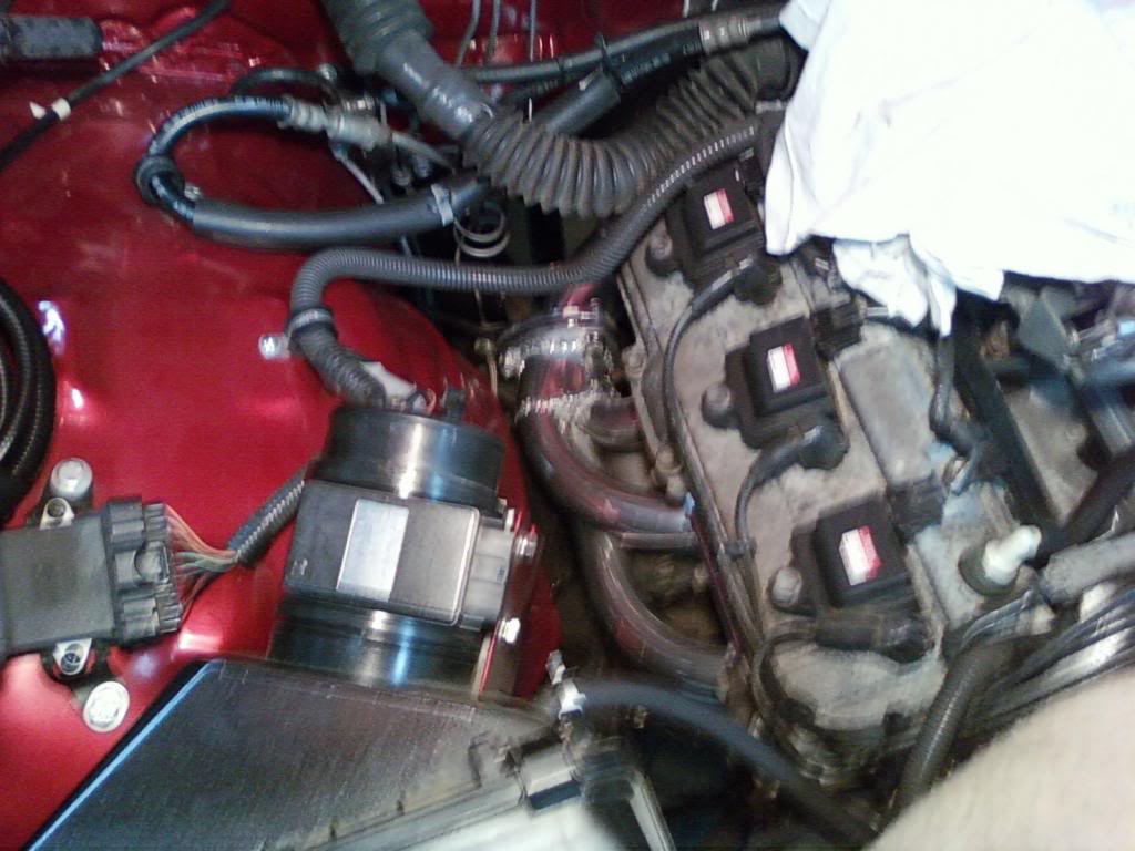

well yeah .. finally found some time to work on my stuff .
woke her up out of hibernation today
got er' into the shop . I decided to only do the headers and pipes for now , and leave the powder coated pieces to do another day ..
got the stock manifolds and crossover , as well as the header pipe with the cat off .

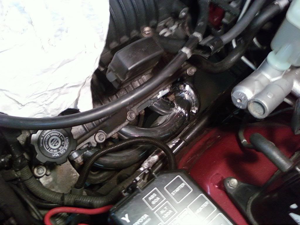

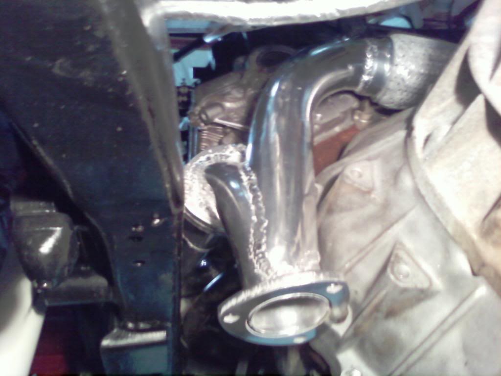

and my NEW headers installed
it's just loose right now , but all the bolts are in .. SUPER happy with the fit , I did have to remove a couple of the exhaust studs in order to get the headers on , but all in all , I think it was easier to install these , then remove the originals very happy
