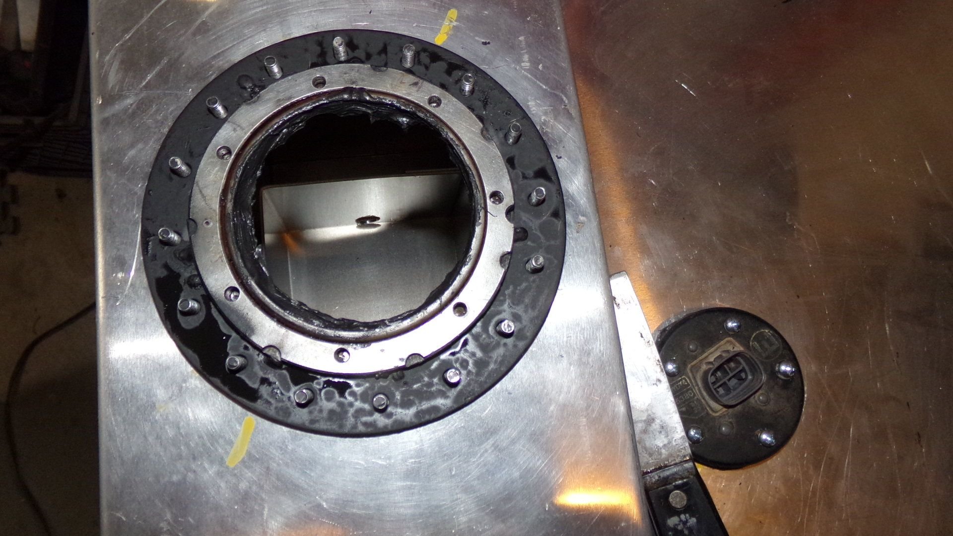

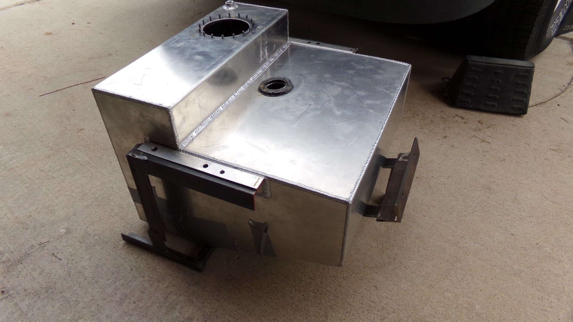

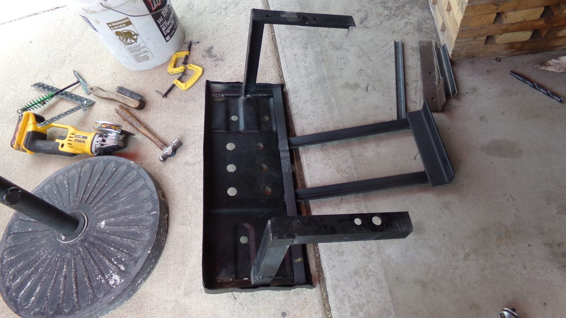

Aux Fuel tank
I had an Aluminum (al-loo-min-eum) tank fabbed by a shop over in E Tx somewhere. Cant recall exactly. Don't even remember how I found them.
My archives show a Rock Valley Antique Auto <rvroddin@aol.com> as my only contact back and forth.
Think I spent some $1k. Its was pressure tested, tig welded, yadayada. Was able to find a few photos. I built a shield underneath, more a throw-a-prayer rock/skid plate. Biggest hassle was the filler neck.
He sold me a generic sending unit. Which I ended up removing and replacing with a used yota unit. (I have a switch that toggles between this and original tank (but its also a 'dorman' (?) replacement.) Also my "low fuel light also works. Also I replaced the pump unit bracket with a total jacked-up hybrid. And cut an acess plate in the rear bed so I can swap the pump (more) easily. Also put a spill flap inside the inlet. Building the plumbing for fill was the biggest pita. Many iterations. Can't find any of those pics right now. Not to mention my welding sux, so took pipe down to NM to have a buddy do it decent and not leak.
The downside is my spare tire area is gone. And I could with some effort rig it up to supply the engine, however it really only transfers (into the original fuel inlet) into the faktree tank. Never started a build thread, so these would be only photos I admit to. Let the hatin' begin.
OH! And make sure you get a drain plug. Somehow that got lost in the comms. My maf shows probably holds about 17 gallons. Probably will drain 3-5 gal out before guage shows movement. Also had him put in an internal baffle. Guessing I will have two gal unusable. Only have about 6 gal in right now. Not driving either. Drive train issues. Still need to see if I messed up on transmission, lol. But HEY! I got (old) wheels and tires on it.
tank with some braket. large hole is pump.

Well I can't get the damed text to show. So here is the top part.

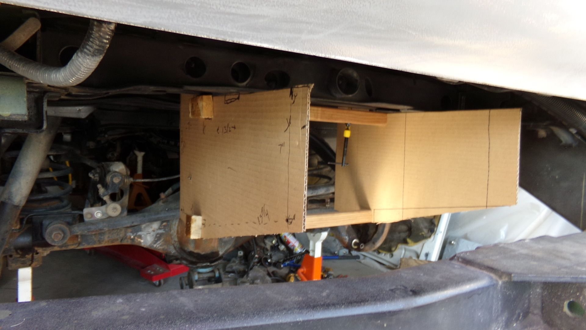

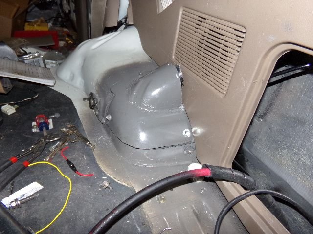

Spare to Rear frame fuel tank
Originally Posted by mechkw
how much room did you lose by putting the tank where the spare is? pics of install?
All of it. LOL. I don't seem to have any 'finished product' photos for some reason.
On my laptop now I have a pic of the starting cardboard mock up. And the photos in post above show the raised portion that actually sits higher than the crossmember that supports the tank. So you can use your 'maginater. on The side view, the filler neck is actually above the bottom of the frame rail (hidden in the photo).
Inside filler pipe protection
