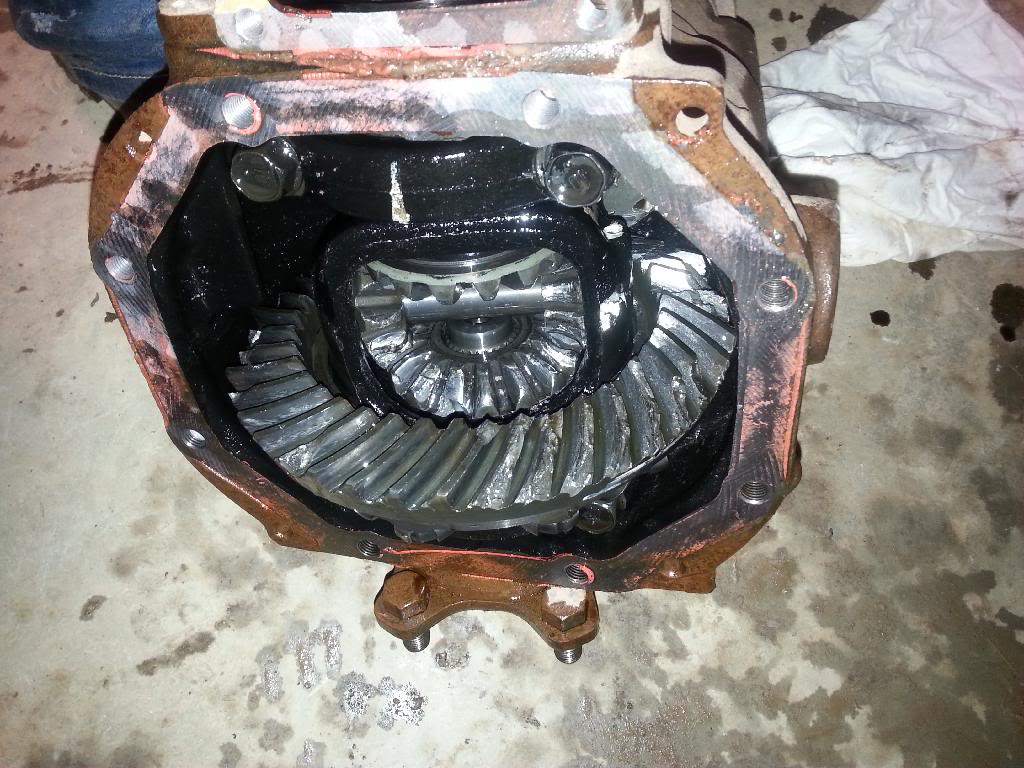

Anyone got a 7.5" front diff for a 86-95 Toyota. Mine kinda messed up. I'm unsure what's wrong with it. I think something is stripped out. When lock in 4WD my drive shaft will rotate however the front end just jerks really bad and kinda sounds like it's grinding. I know this because I chained the truck to a tree, locked it in 4LOW then got out and watched it to see what was wrong lol. Yesterday my 4WD worked great but this morning I was pulling out of my driveway and when I went to take the truck outa 4WD it popped really loud. Later on today I was locked in and rolling 4ward and my truck kinda locked up like I slammed the breaks. I was barley rolling when it did it. Then this evening I had no 4wd. That's when I diagnosed it.
Soo,... Anyone got a diff... 4.10 ratio...

So today I made a few phone calls to the local salvage yards. I found a diff about 70 miles away for $100.00. So I took a road trip. Once I got back my buddy and I put my truck on his lift and started disassembling. After I got my old one out I had to inspect it lol. The ring gear is missing half its teeth and 2 spider gears were stripped. I ended up doing a ADD delete while I had it apart. Once it was reinstalled I headed home and everything works great except for my 4x4 light which uses the ADD setup

Yup...had a similar break about a year ago. Mine I only cracked 6 teeth off of though. 4wd was still usable, but I got this weird harmonic that kept getting worse. Just gotta remember these front diffs aren't that strong, especially for you turning 35's. Have you thought about regearing to handle them?

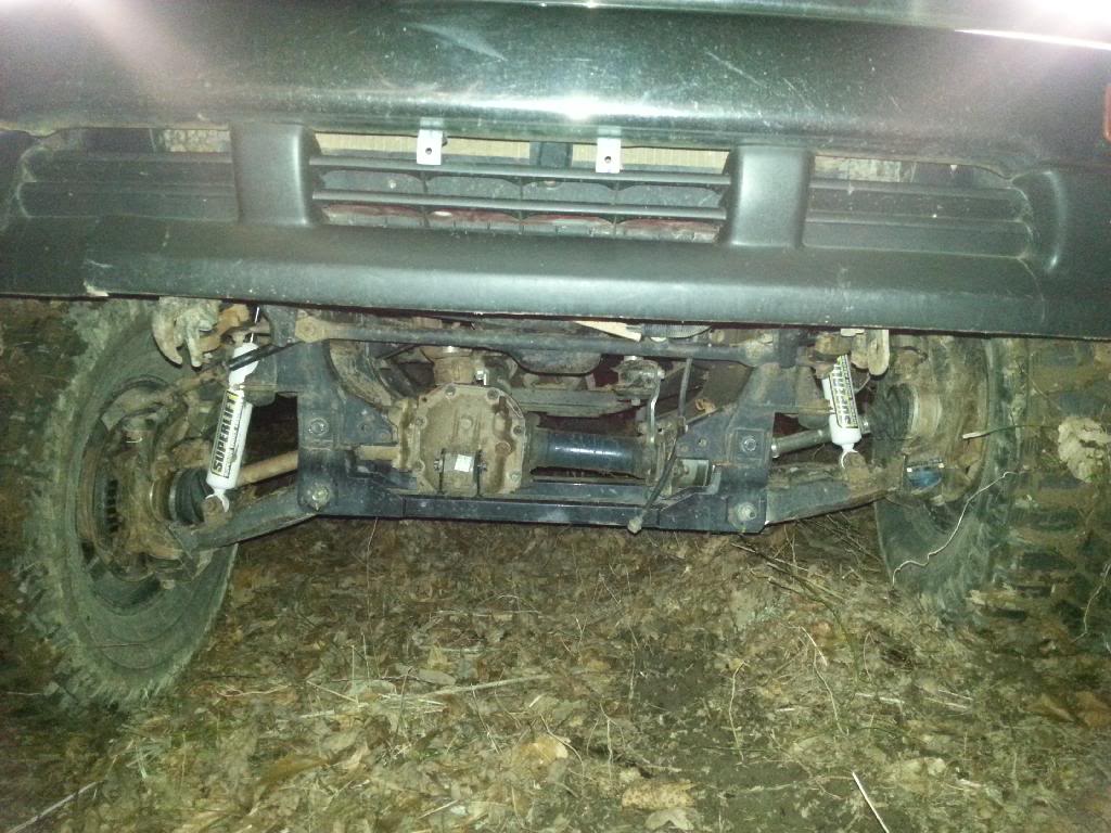

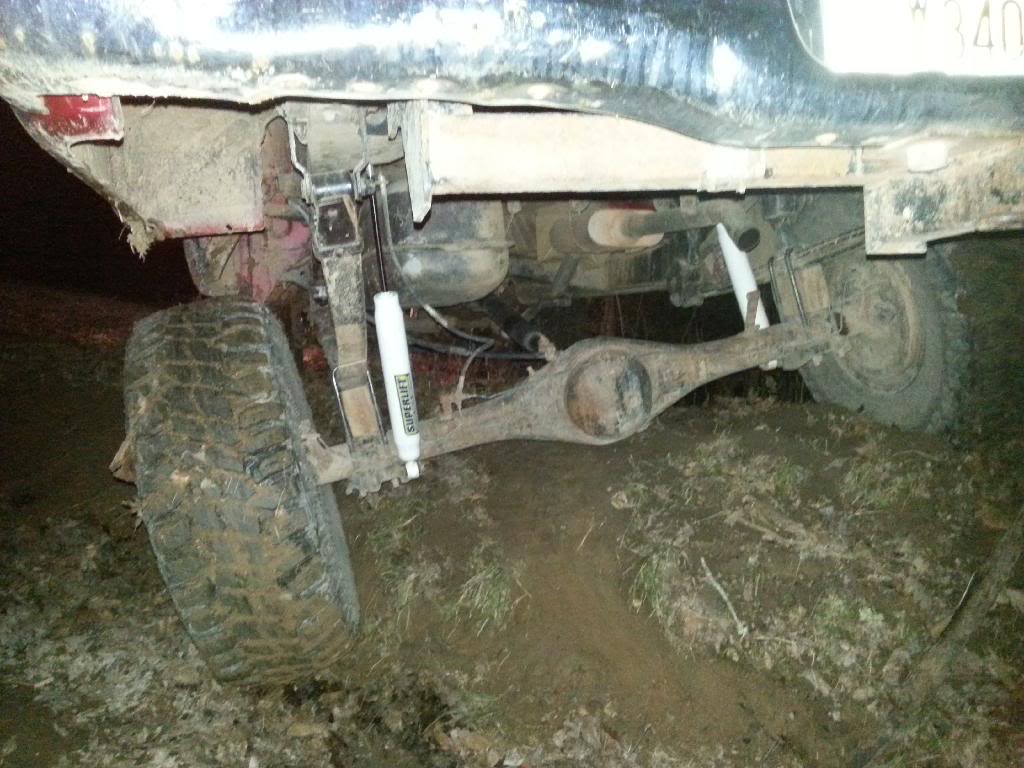

had the oppurtunity to take some pictures tonight as I was wheeling toward the end of the trail. This was my last hard obstacle before reaching the trails end. Sorry for the poor quality as it was dark and kinda spur of the moment.

That's some serious IFS flex!

Yeah it kinda bowed my mind when I seen it. I posted inn the IFS flex thread too
