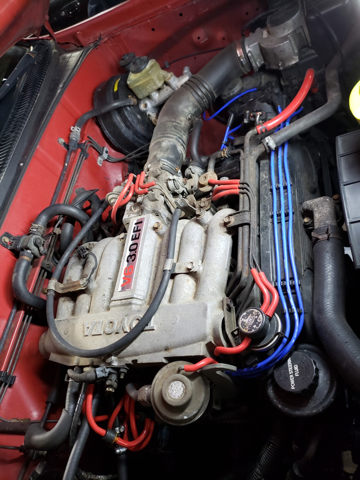

Replaced air filter and all spark plug wires, and spark plugs, however had issues with CYL 3 and 5, possible cross threading. Stopping until I have a spark plug thread chaser to try and fix them
Cross threaded sparkplug has been cleaned up and installed without issue. Replaced all easy-to-access vacuum lines with red silicon lines.
Oil analysis returned with more metals (99ppm lead) than desirable... will send in one more sample after this change, as old oil was used for ~4800 miles.

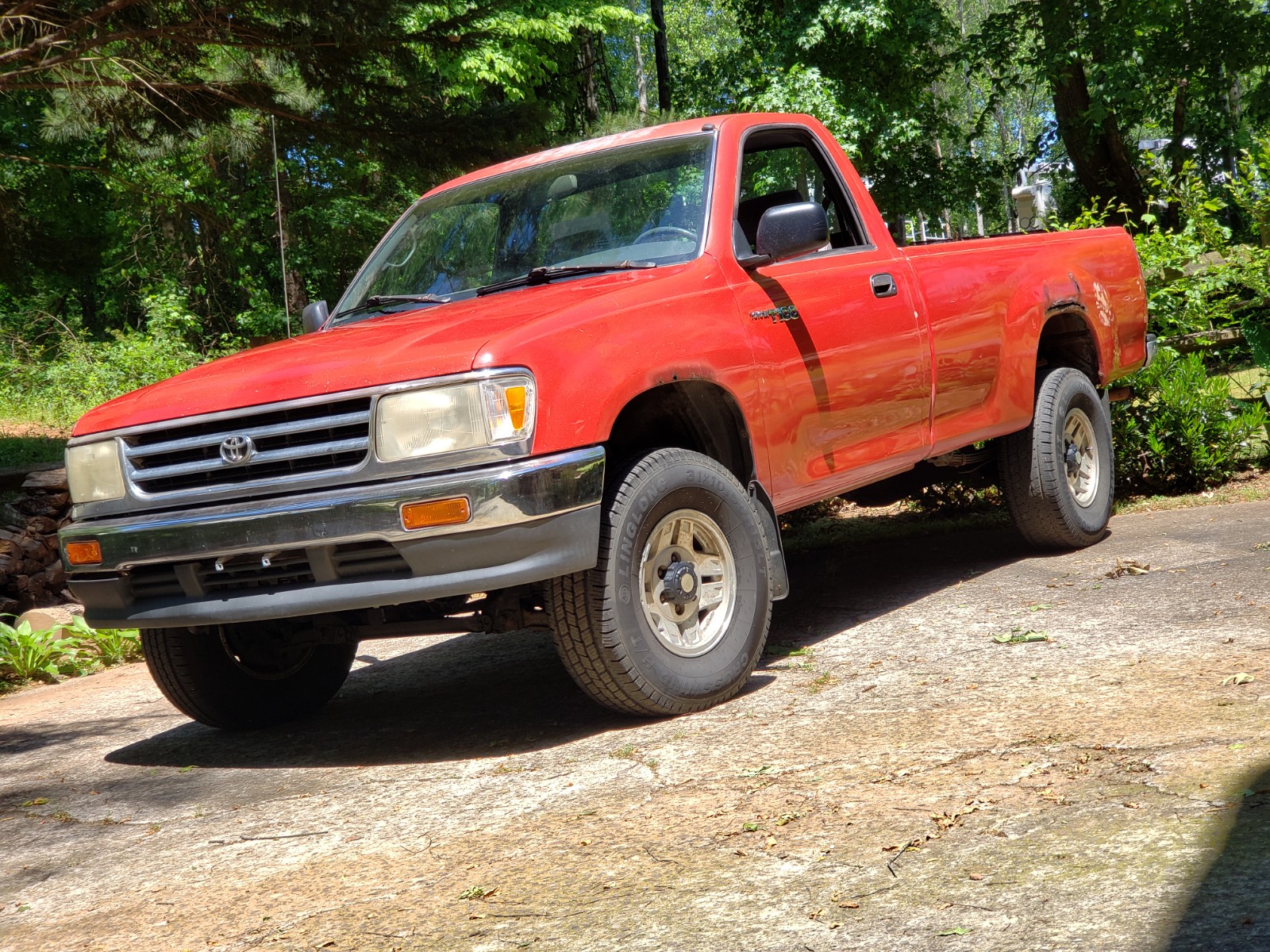

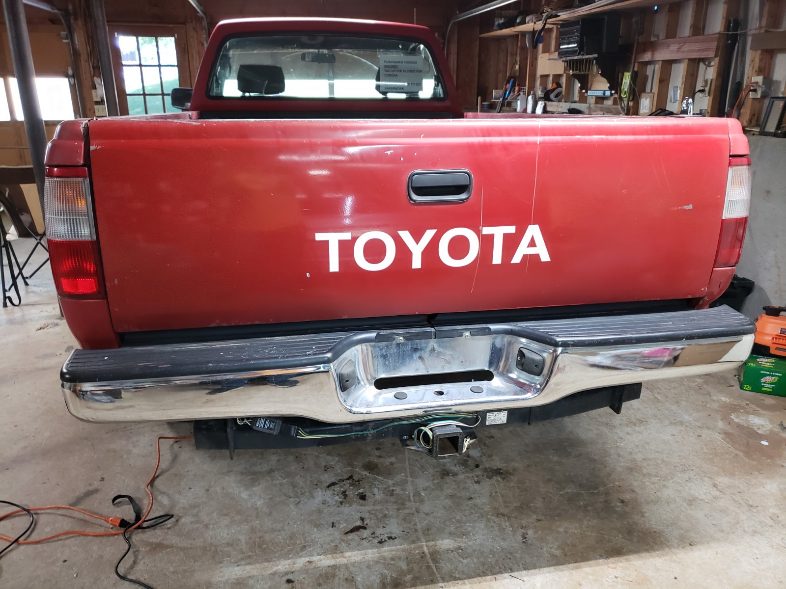

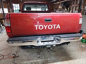

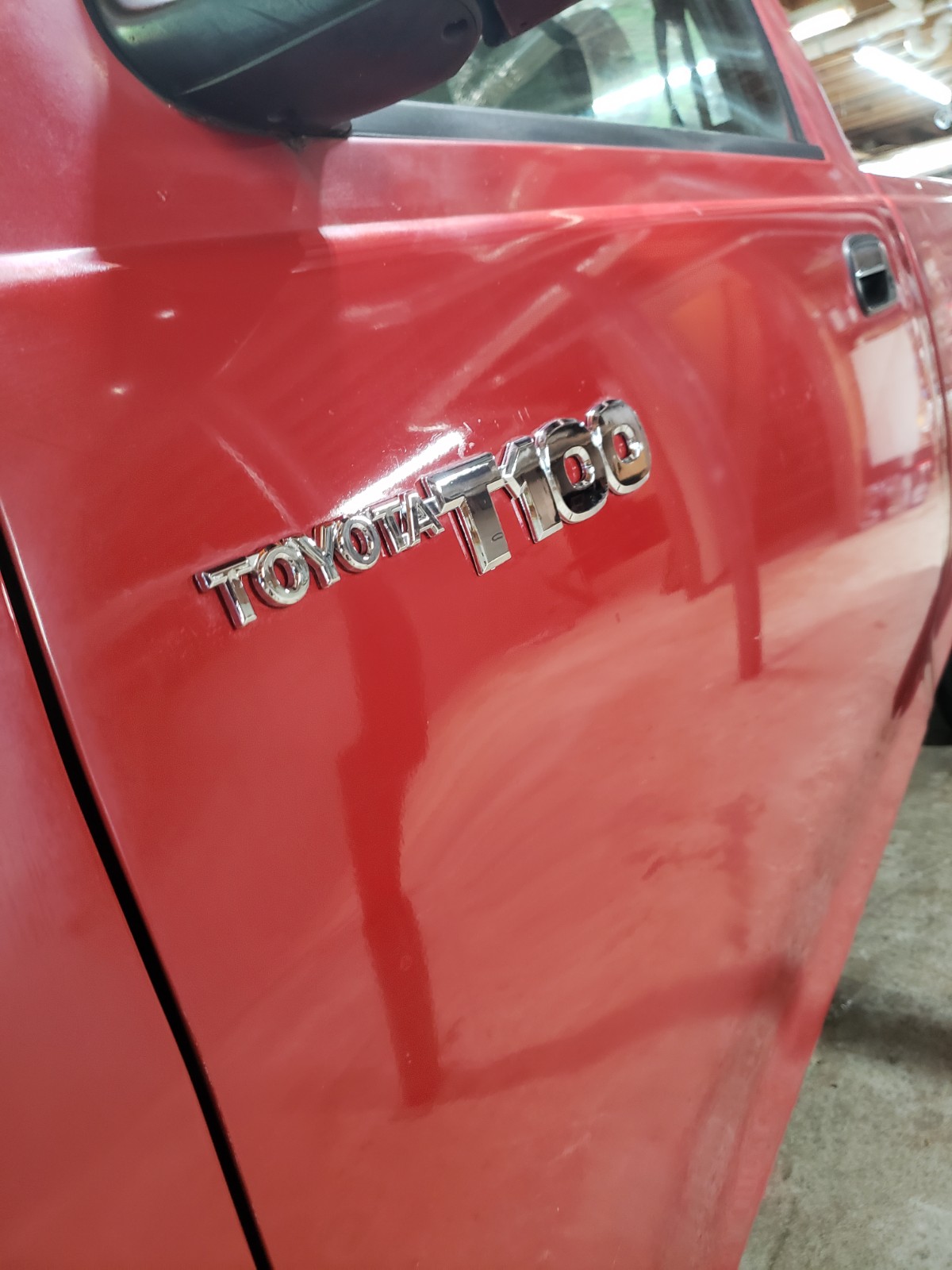

Finished polishing all paint, and applying "T100" side emblems, as well as "TOYOTA" tailgate vinyl, and 3.0 EFI engine badging.

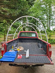

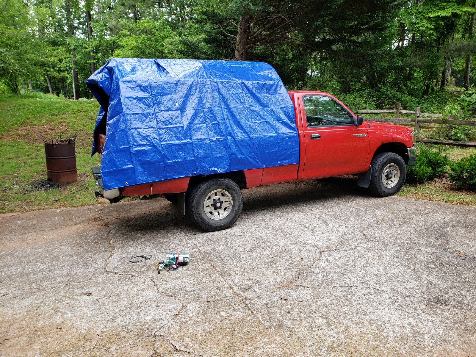

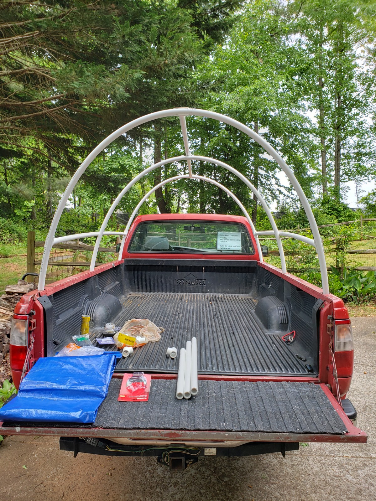

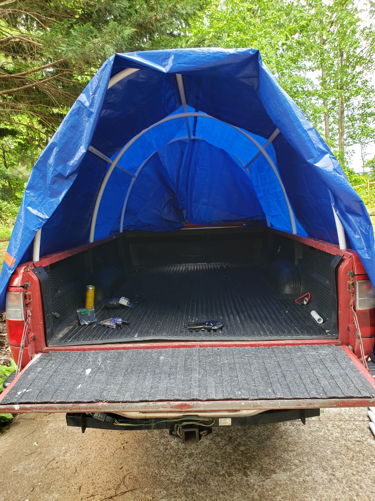

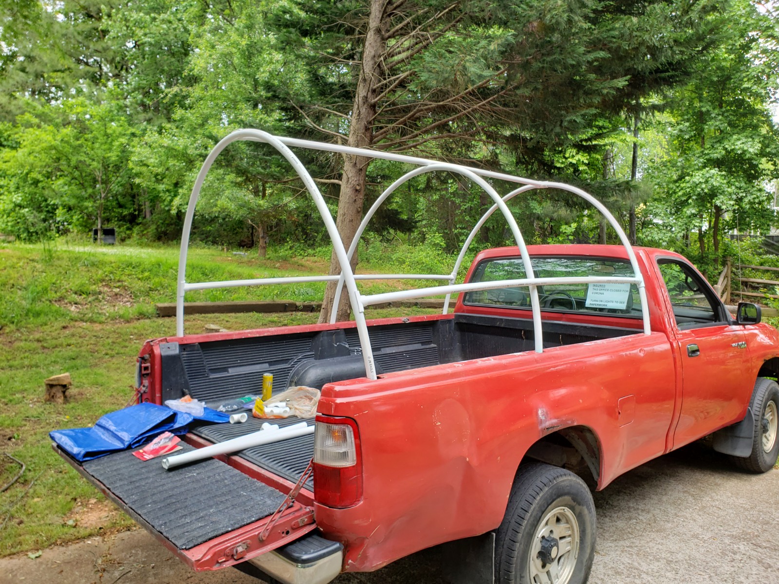

Built a sweet 'covered wagon' tent for truck camping - Cost $50

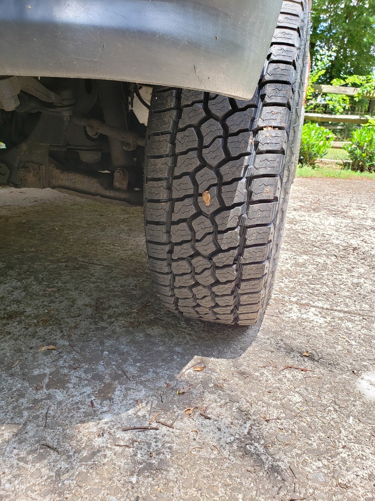

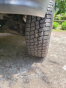

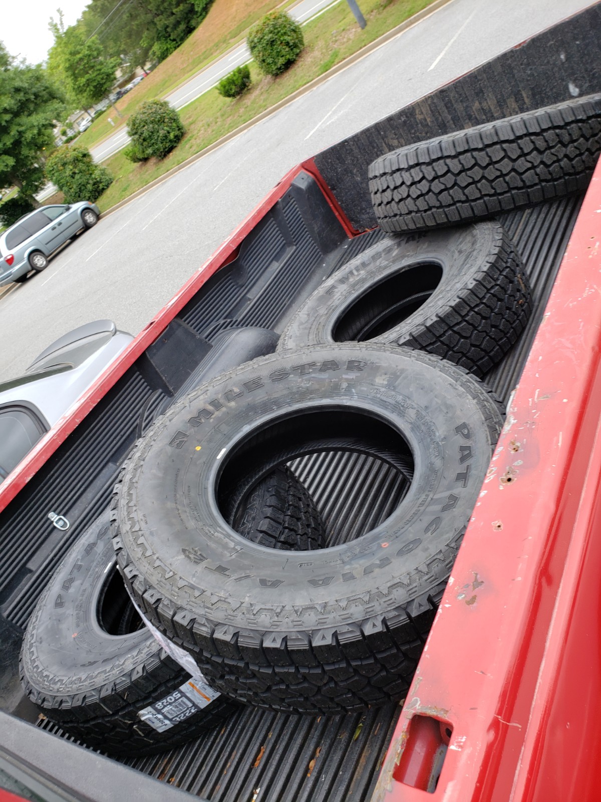

Replaced all 4 tires with Milestar Patagonia A/T-R - $510 installed

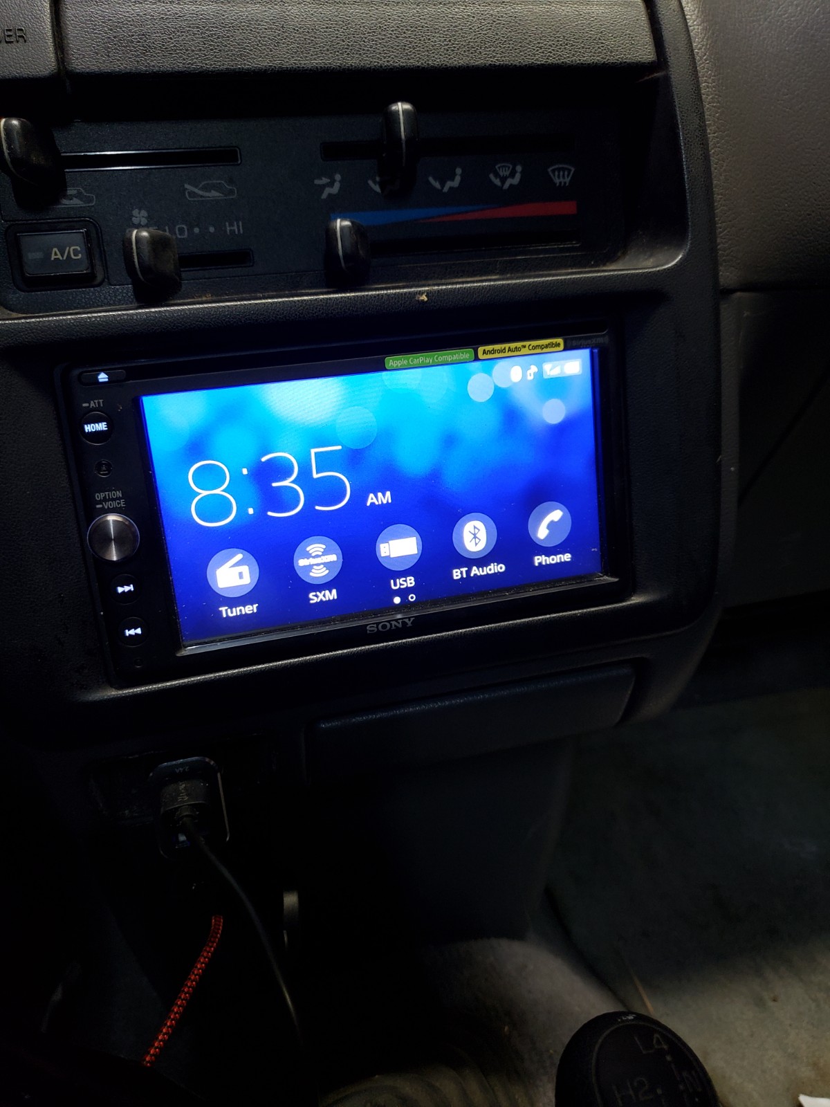

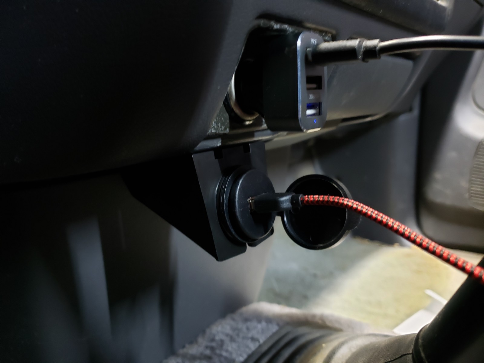

Installed Sony XAV-AX200 head unit, back up camera, microphone, and additional USB port for android auto. Grounded out parking brake to bypass brake restrictions. Only one speaker working at a time..need to investigate - $102 total cost
