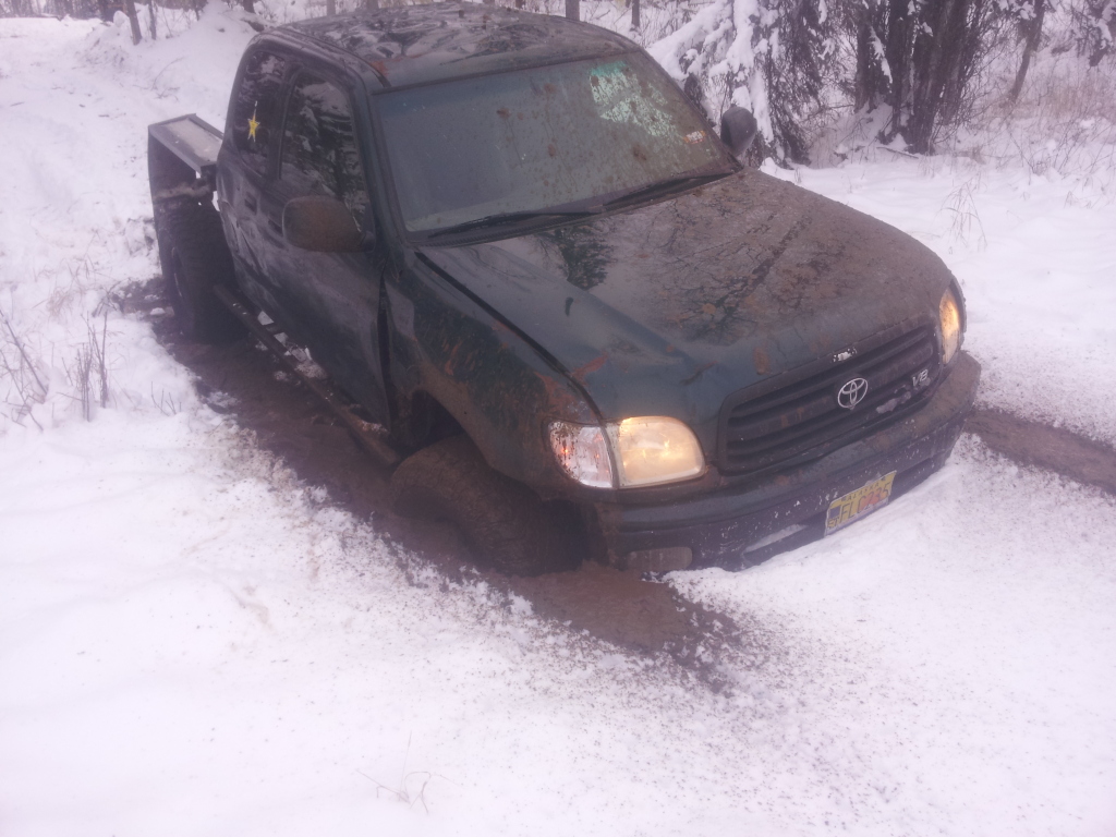

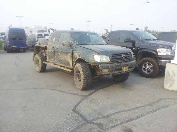

With 35"s after an 85 miles off-road rally.

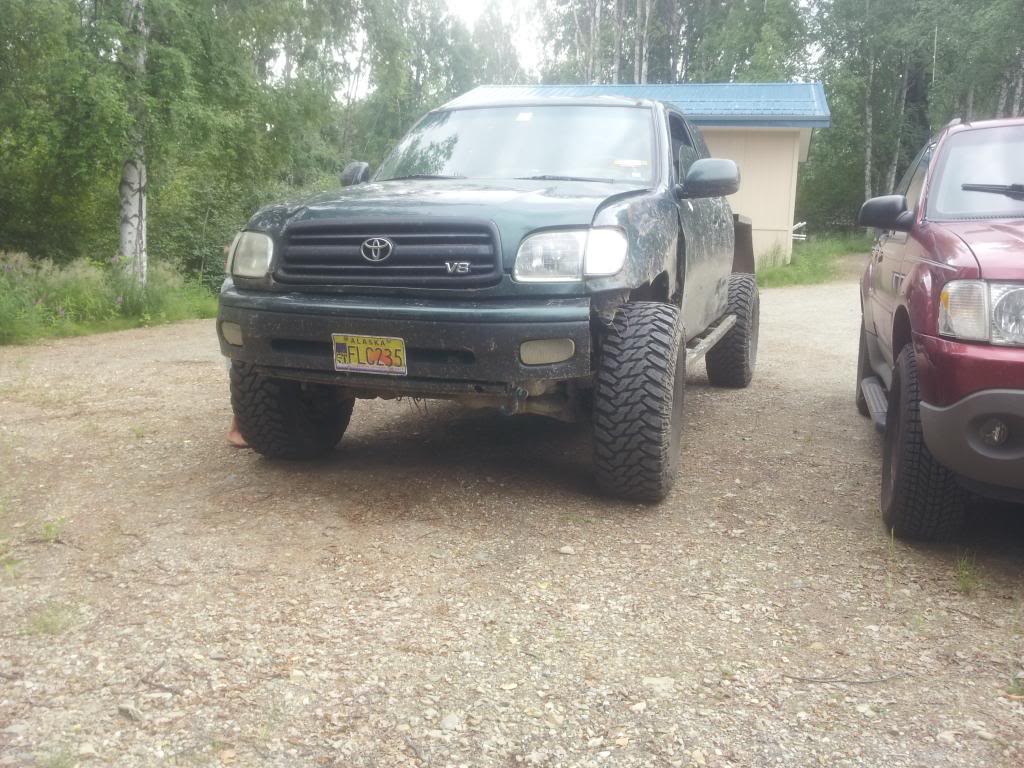

Heres a few better ones of how it currently looks. 315/75R16 Cooper STTs with 2" front coil spacers, ~2.5" lift in the rear with the ZUK Coil mod, and fender chopping in the front. And 1.25" wheel spacers on 16x8 wheels on all 4 corners.

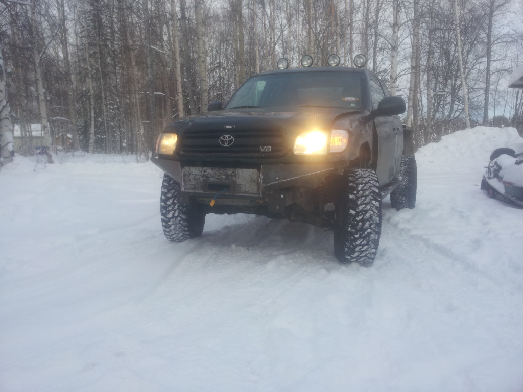

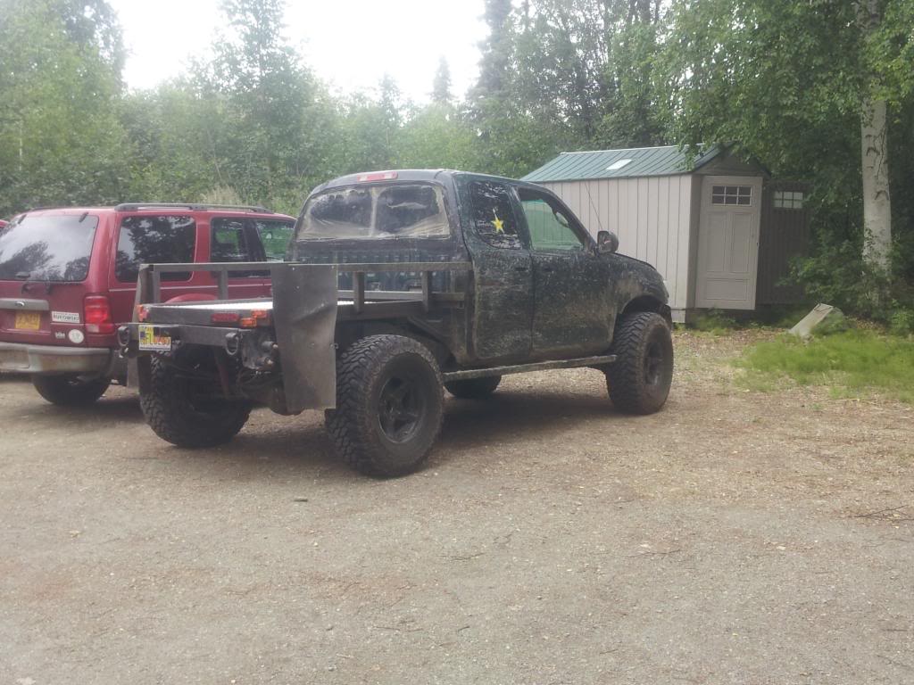

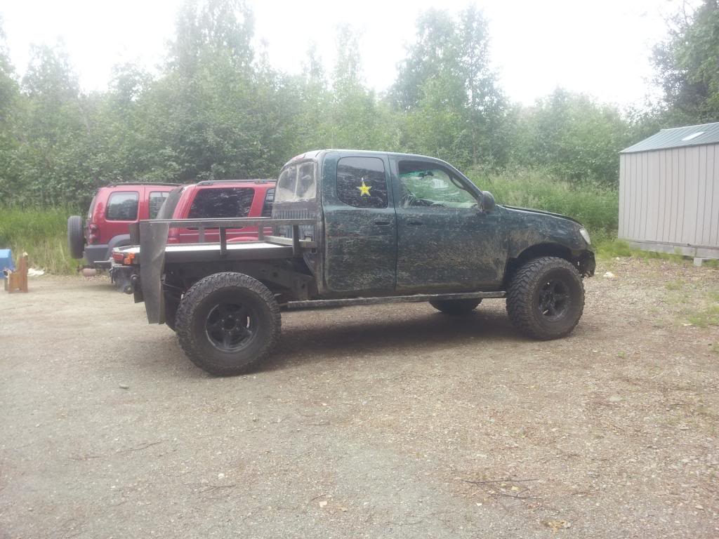

That was my update. Put sides on the bed, some aux lights on too and built a winch bumper

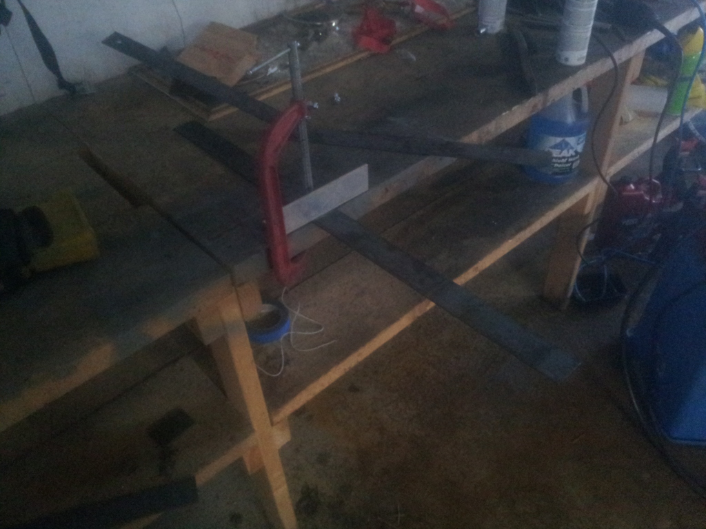

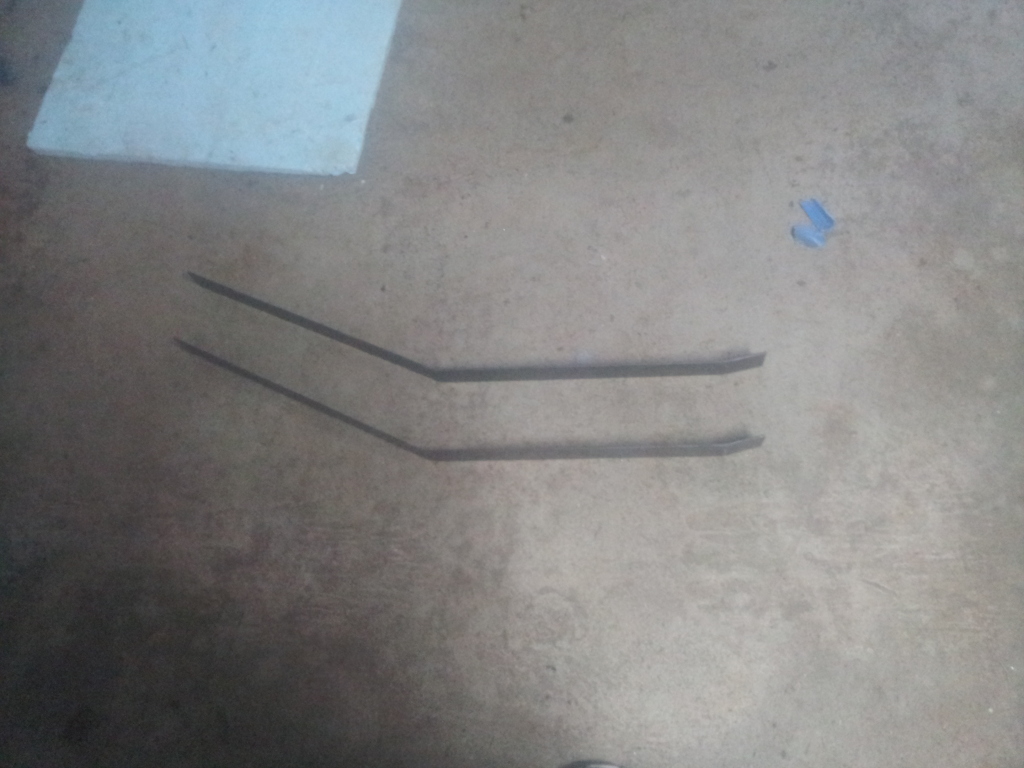

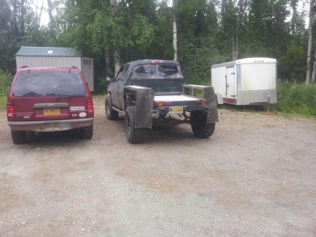

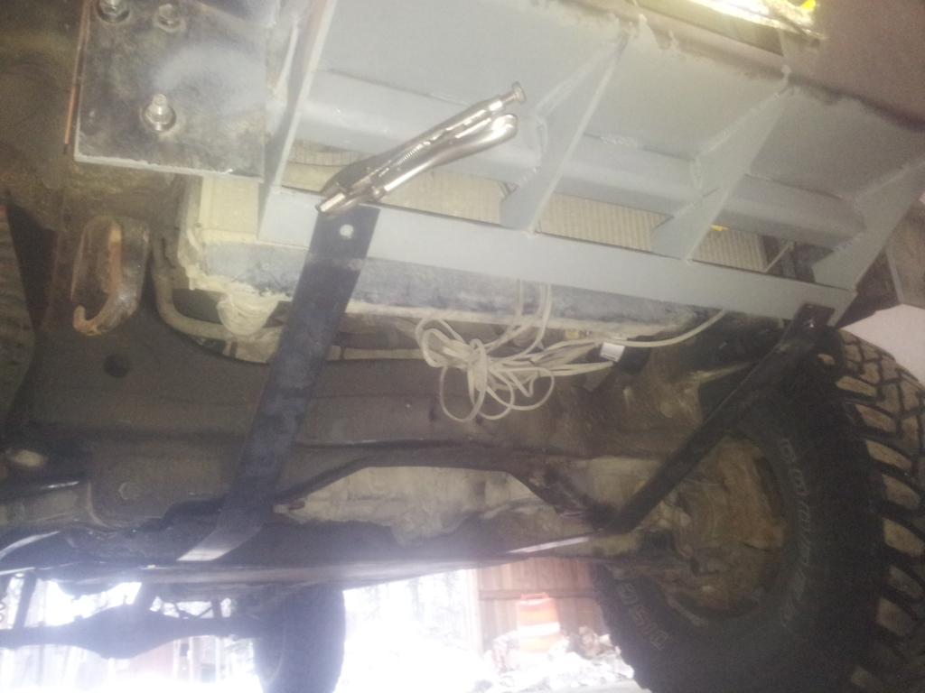

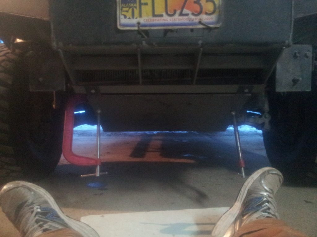

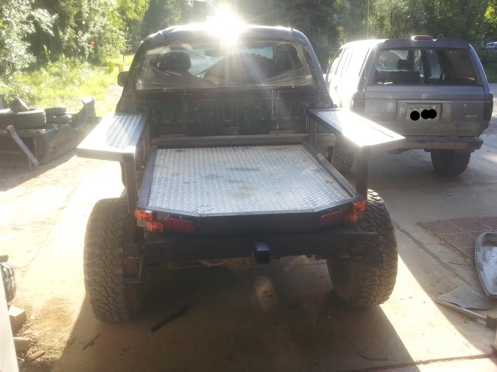

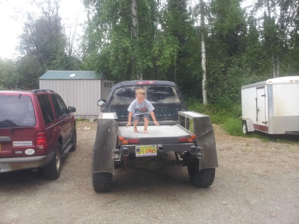

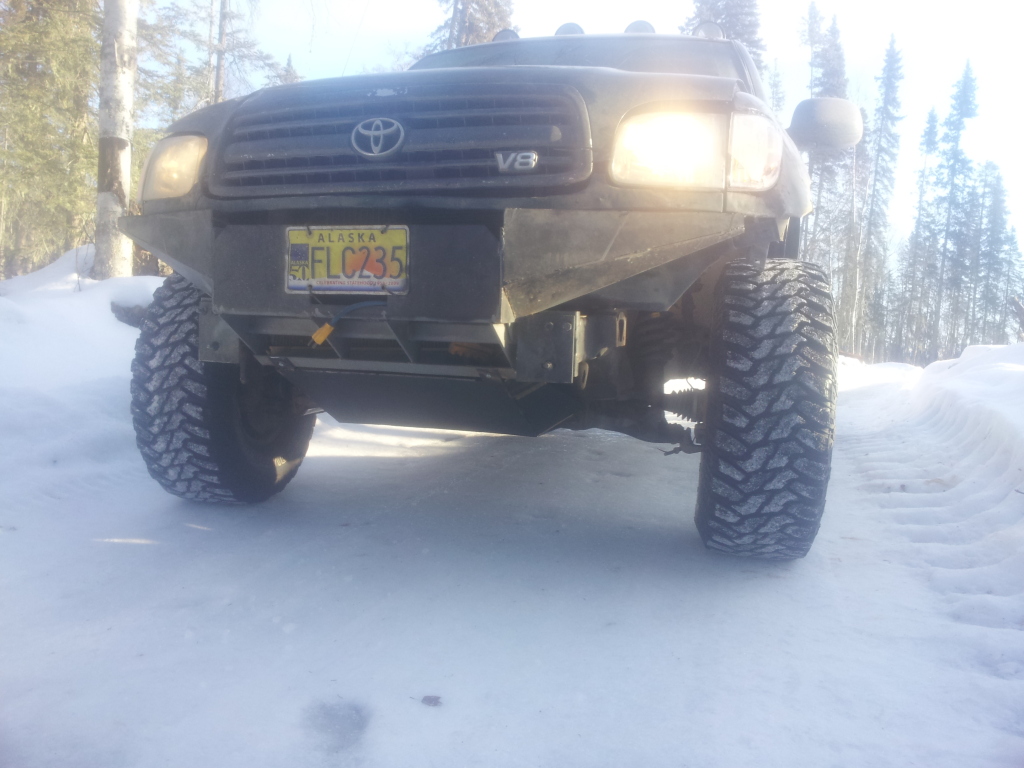

In February I finished the bumper and built a skid plate

this things lookin raw man im really into it! what are those lights mounted on? just a piece of steel you bent?

Tundraowner- thanks. The lights are mounted through the roof. A decision I thought was good at the time. Haha. I'm thinking about taking them off for the summer.

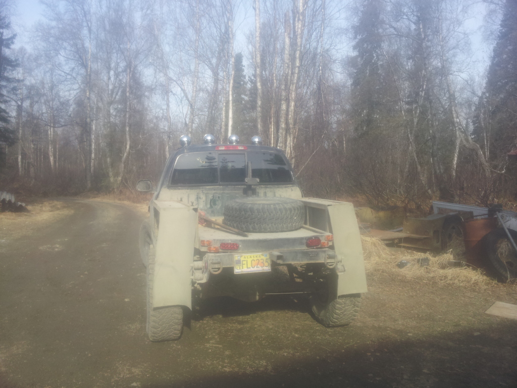

A few weeks ago I put in a real rear window.

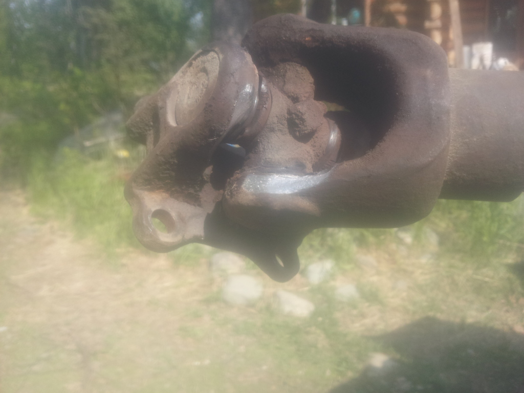

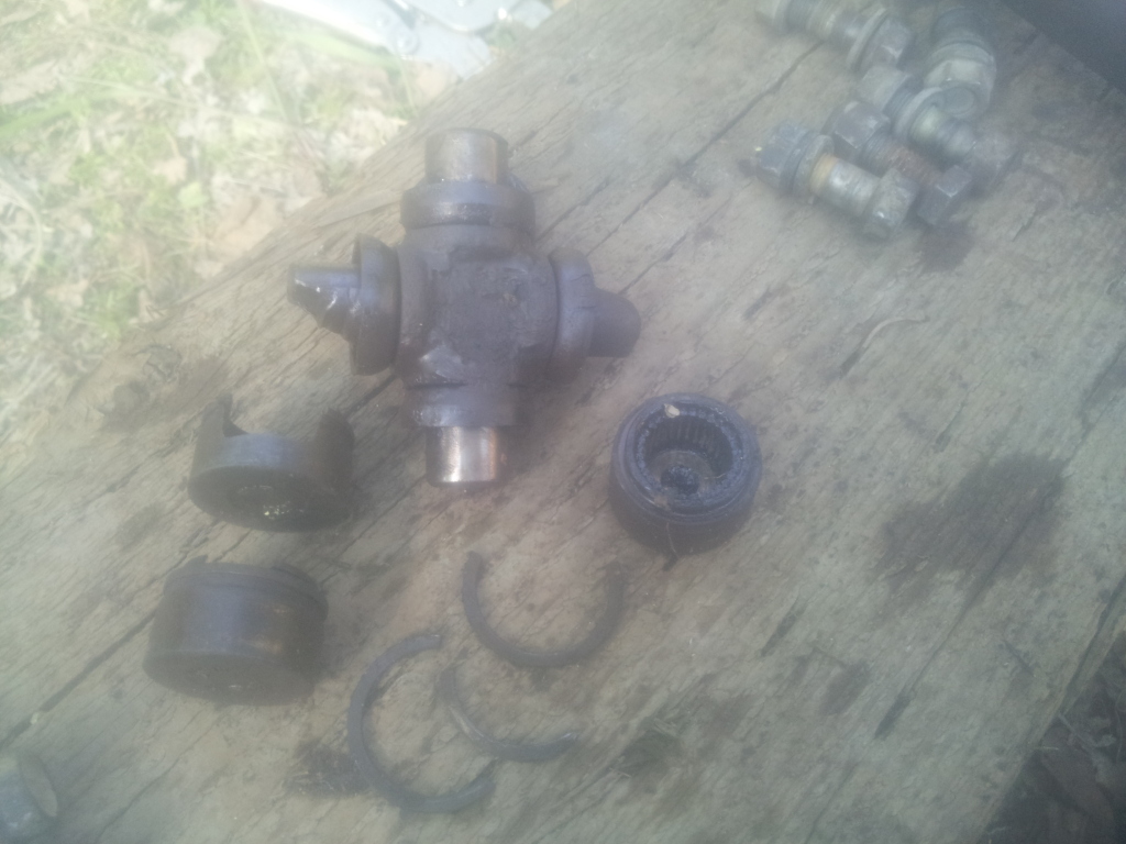

Then I destroyed a u-joint while showing off for some girls.

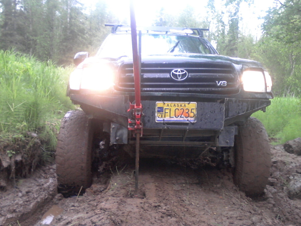

Last night I got stuck for 6 1/2 hours. Don't wheel alone.
