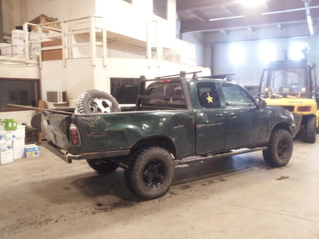

Got around to mounting the rack I made 2 months ago. It has just been sitting at work. Nothing special. I'm thinking about making a mount for the spare tire.

I havent been driving the Tundra lately. I dont need to. The 4Runner is better on gas. I have been using the Tundy to haul trash and what now, though.

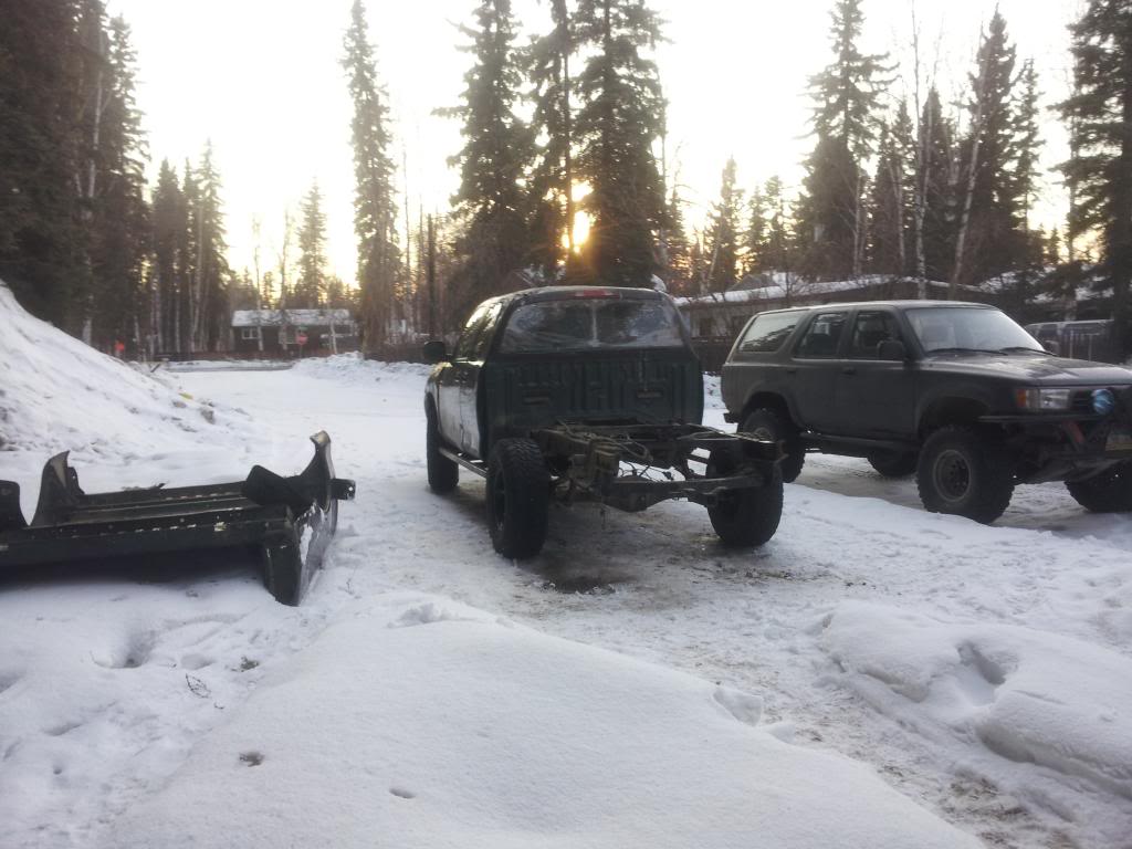

But tonight I took the bed off in the first stage of a flat bed Im hoping to bump up to 35-37" tires when I am done. I want to make it a dedicated off-road vehicle, but street legal, and a back-up for when my 4Runner is down. Or if I just need a truck.

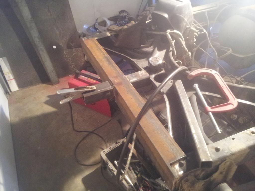

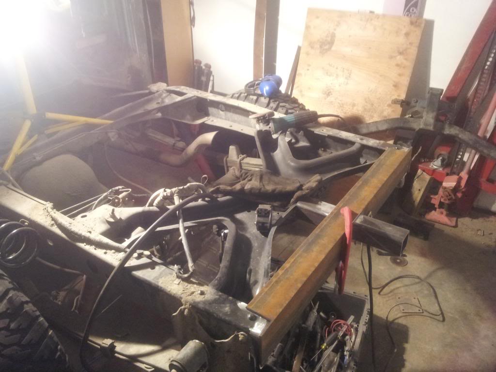

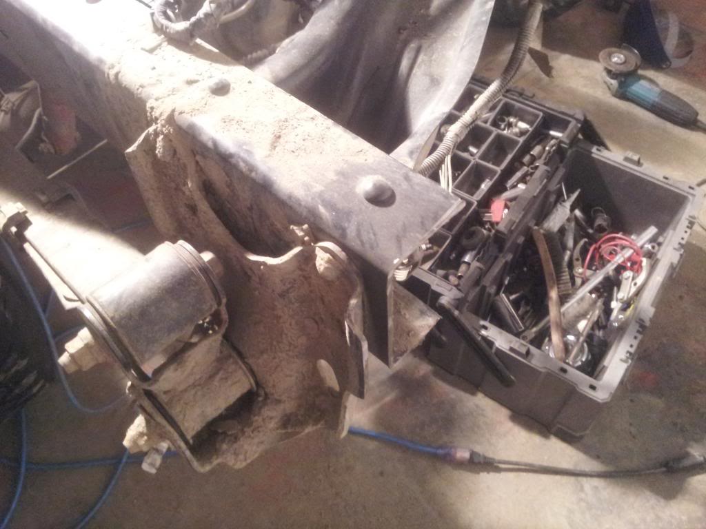

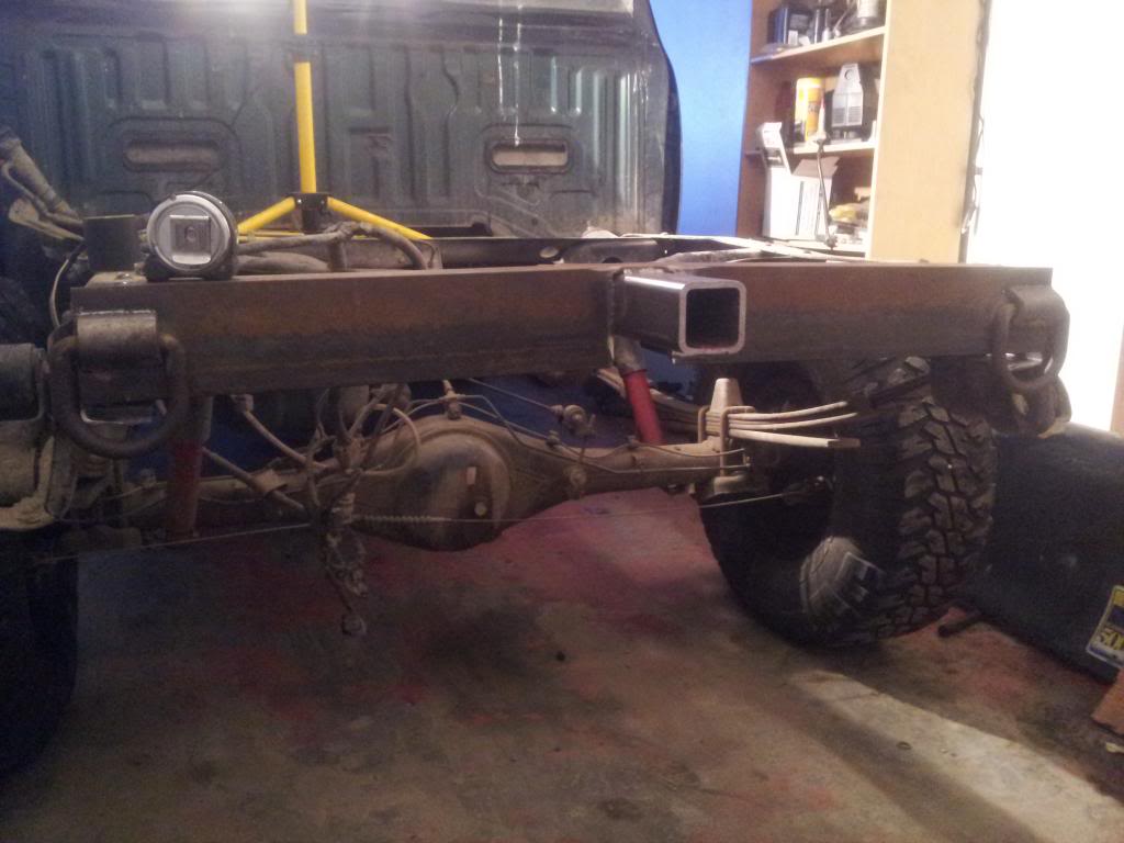

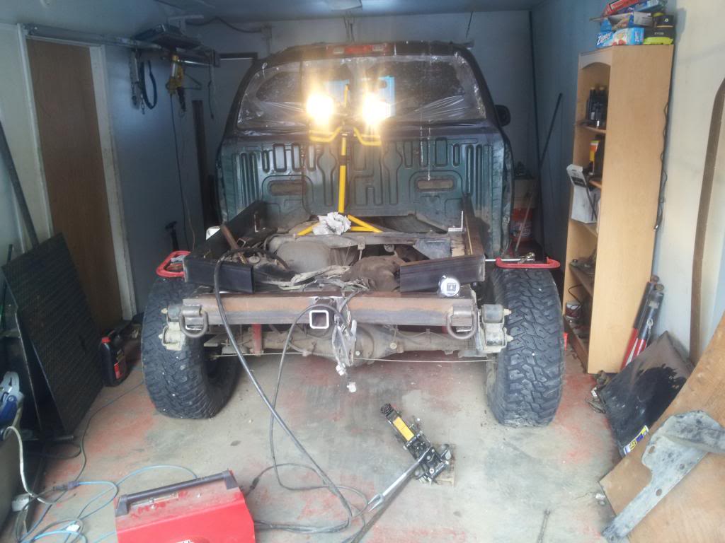

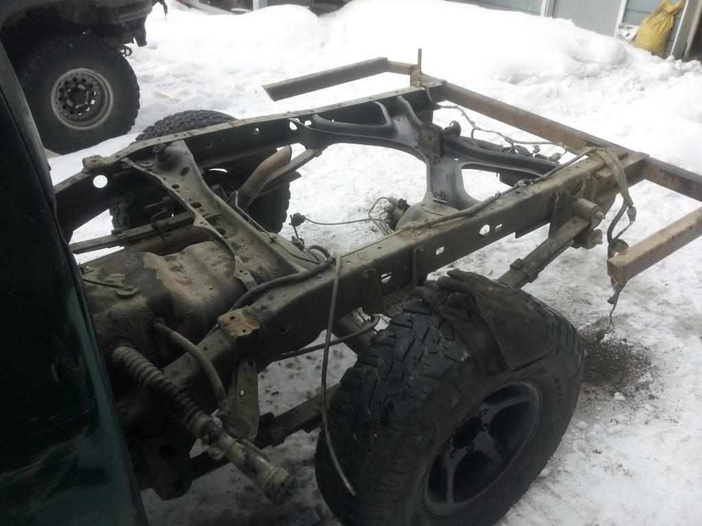

Cut the frame 8 1/2" to be even with the shackle perches.

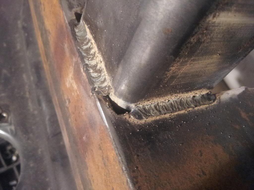

The welds look better now that I ran a wire brush over them.

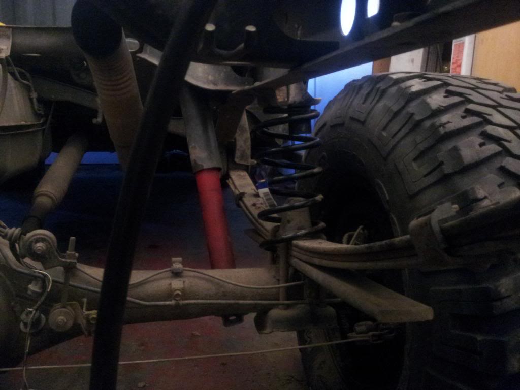

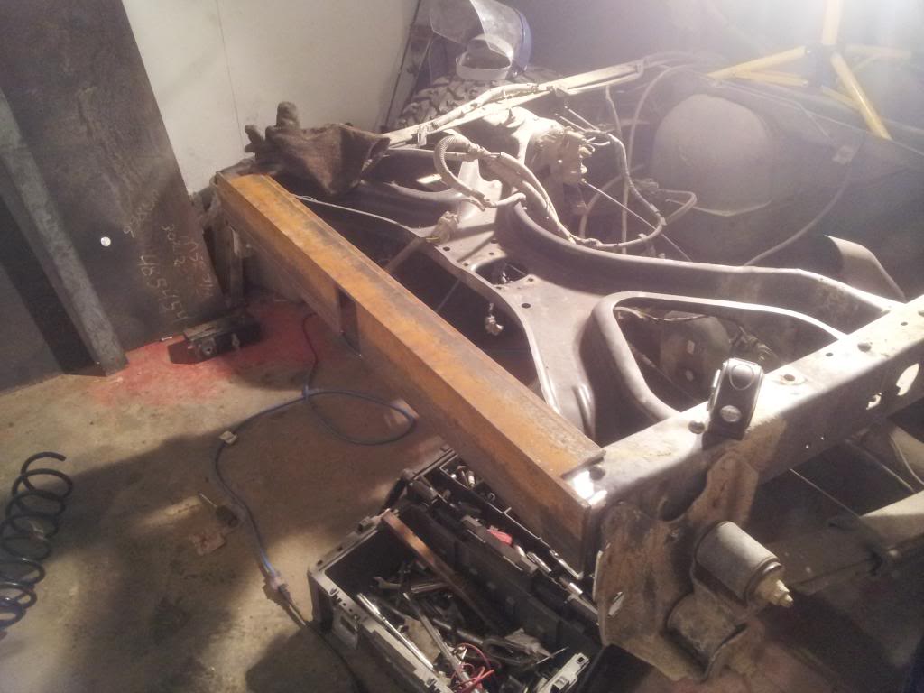

Then I put coils between the frame and leaf springs (ZUK Coil Mod!). Gained about 1.5". Perfect! I cut about a wrap and a half off of some jeep springs I bought a last summer. They are now about 13" IIRC.

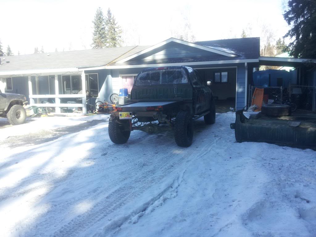

Lazy Sunday. Didnt work on it much.

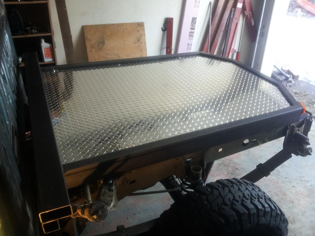

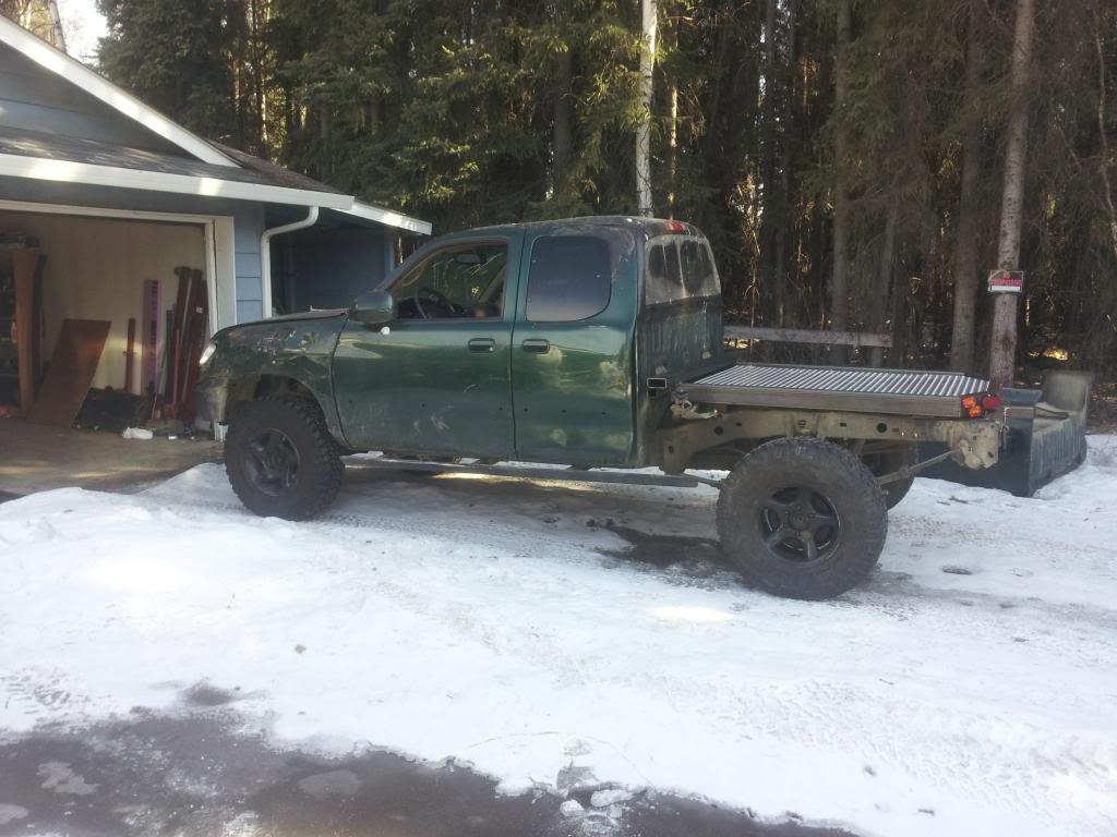

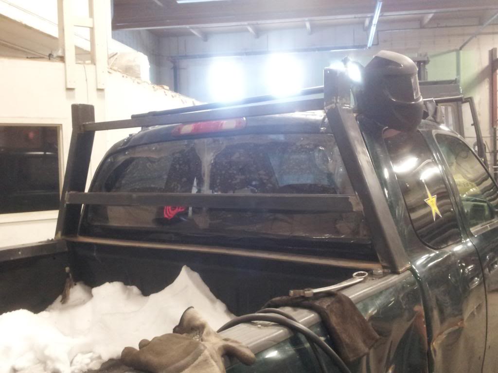

I cant decide if I want to put a headache rack on it or not. I have one built that I can modify to fit the flat bed. I still need to take the bed off to paint it, but considering its only 35* today, not this weekend

Also, paint the aluminum or leave it shiny?

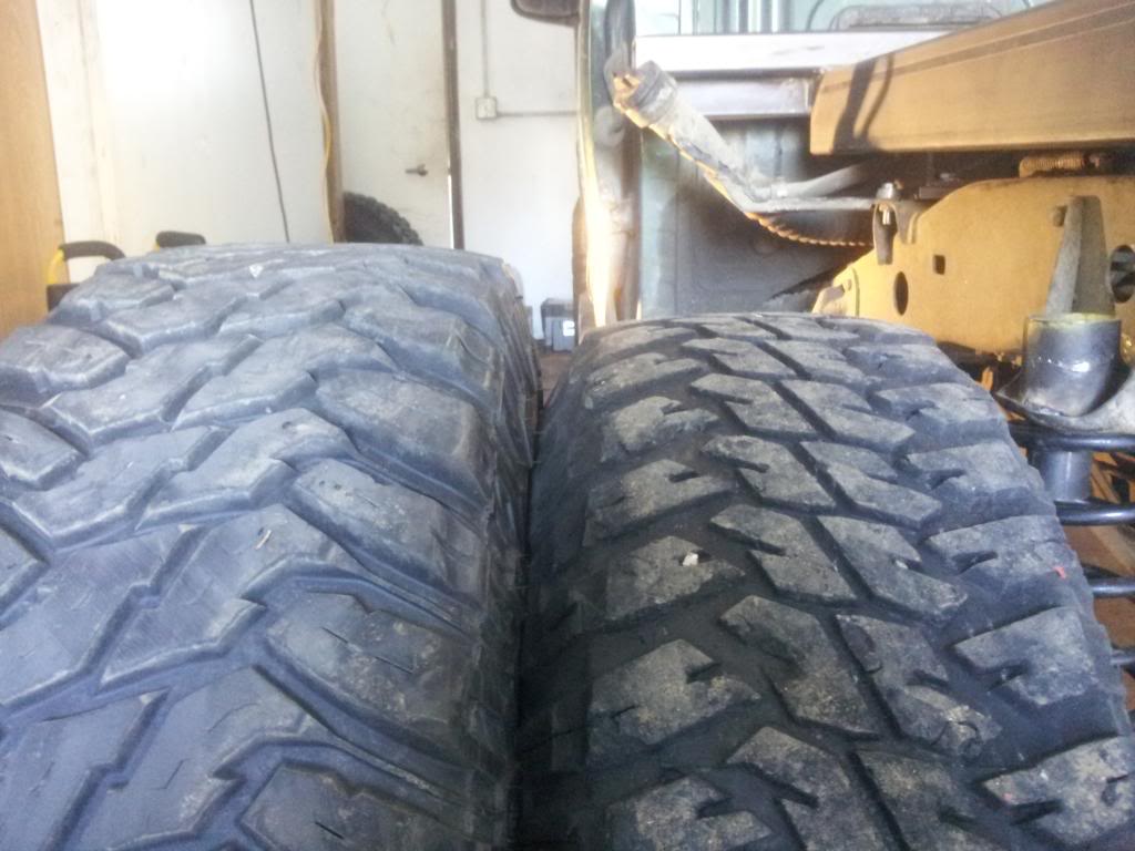

Bought a set of Cooper Discoverer STTs 315/75/R16 (35x12.5s )
