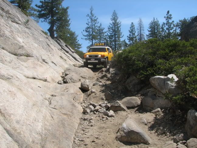

Made my own home made Rock sliders.
Testing the mods so far.
