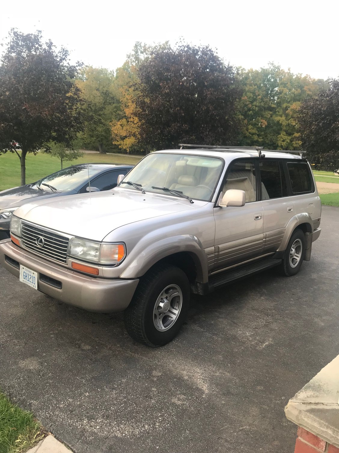

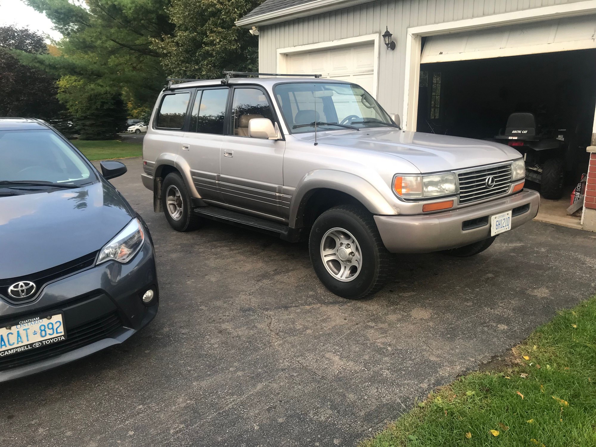

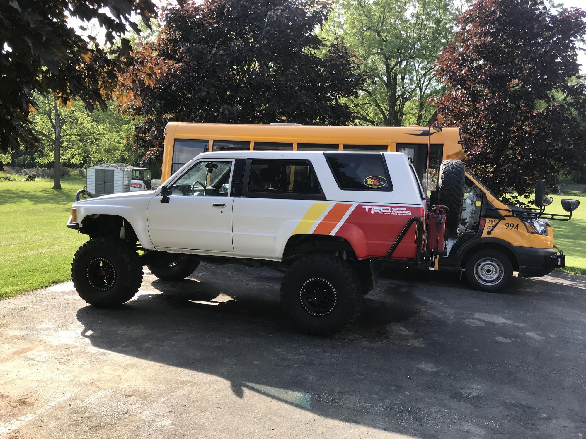

A few months ago I sold my first gen 4runner to build something a little bit different, I’m still In the regret stages of the sale but I found a 97 LX450 to help mask the pain. 210k Miles, triple locked and bone stock minus some janky old electronics.
Plans: the plan was supposed to be OME lift, 255s, build rear tire carrier, rebuild front axle and drive 2600 km to Moab. But we ended up cancelled the trip.

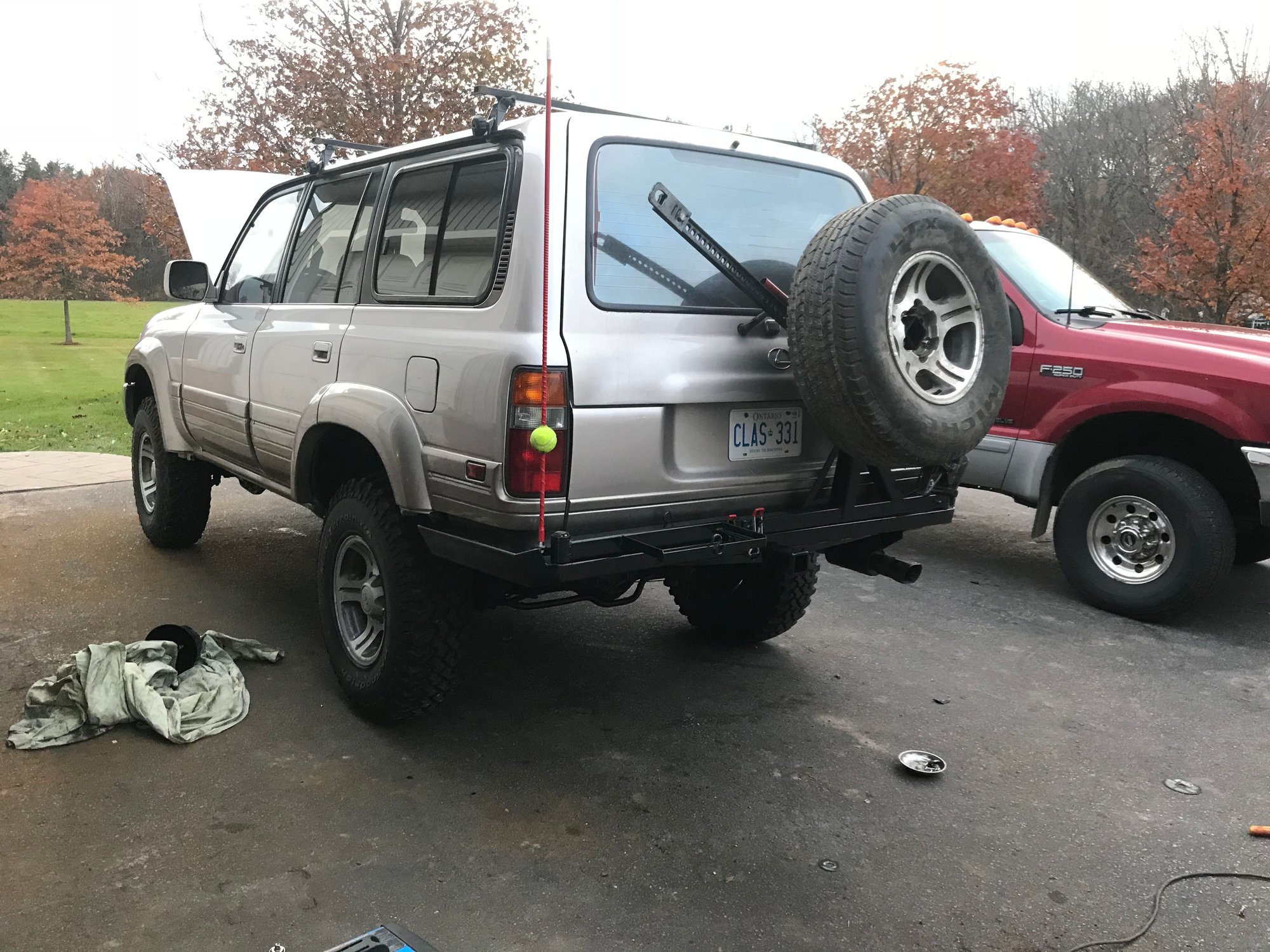

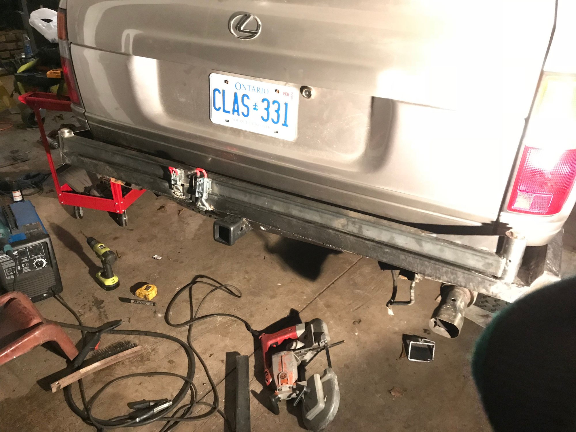

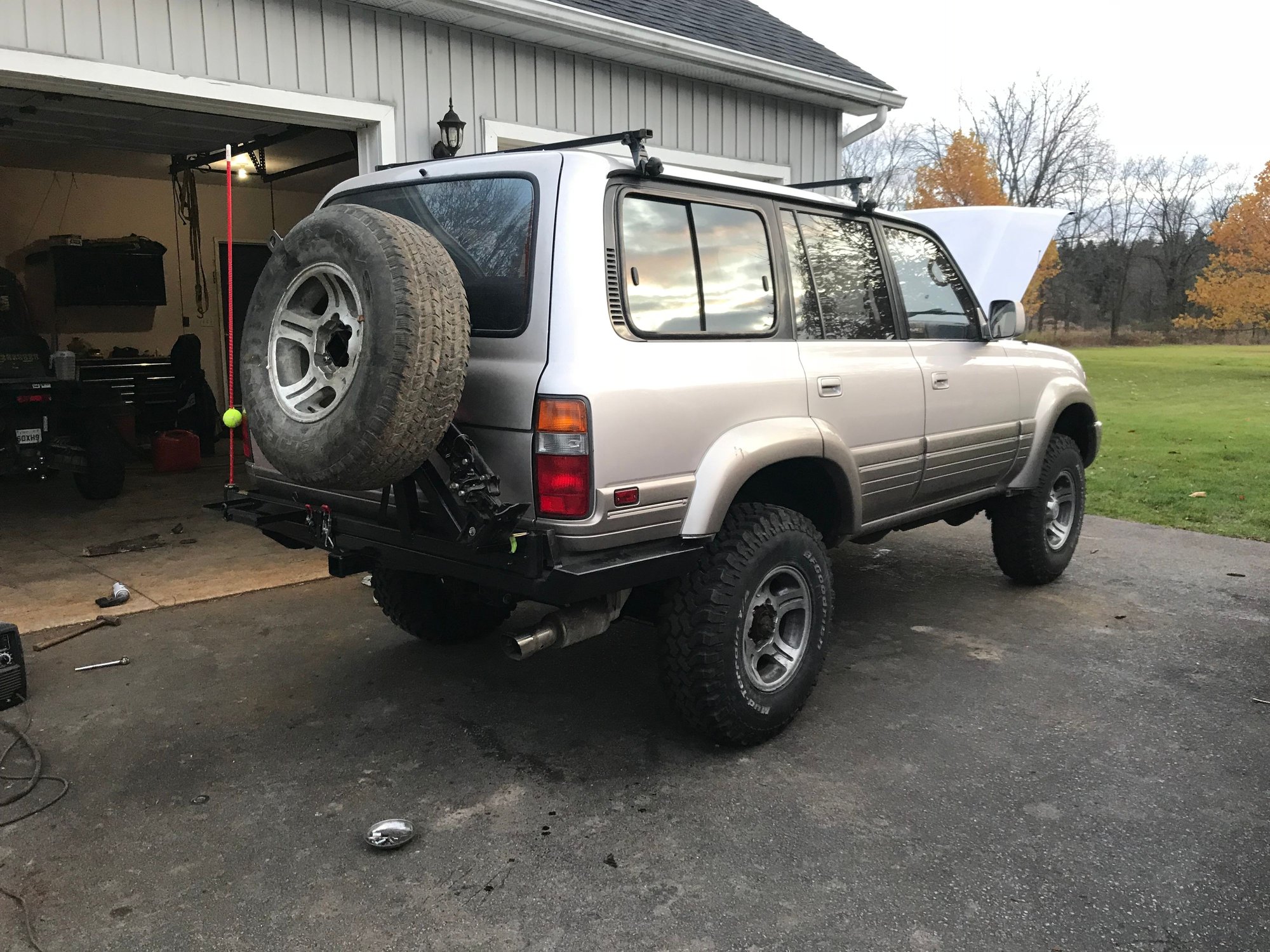

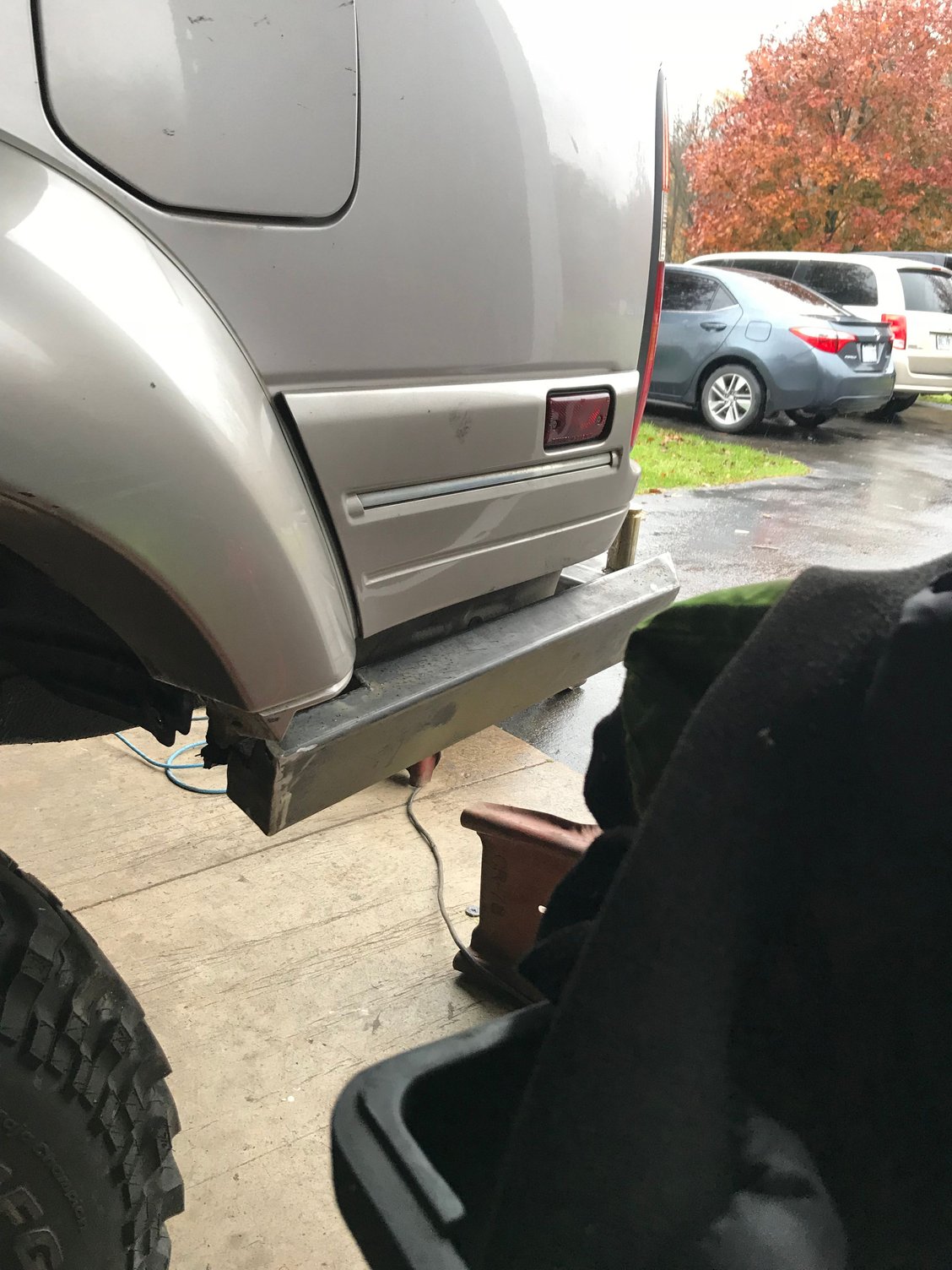

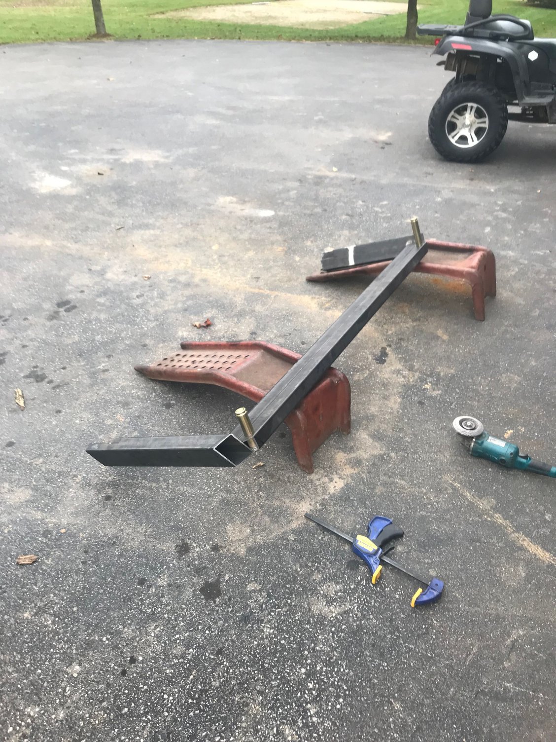

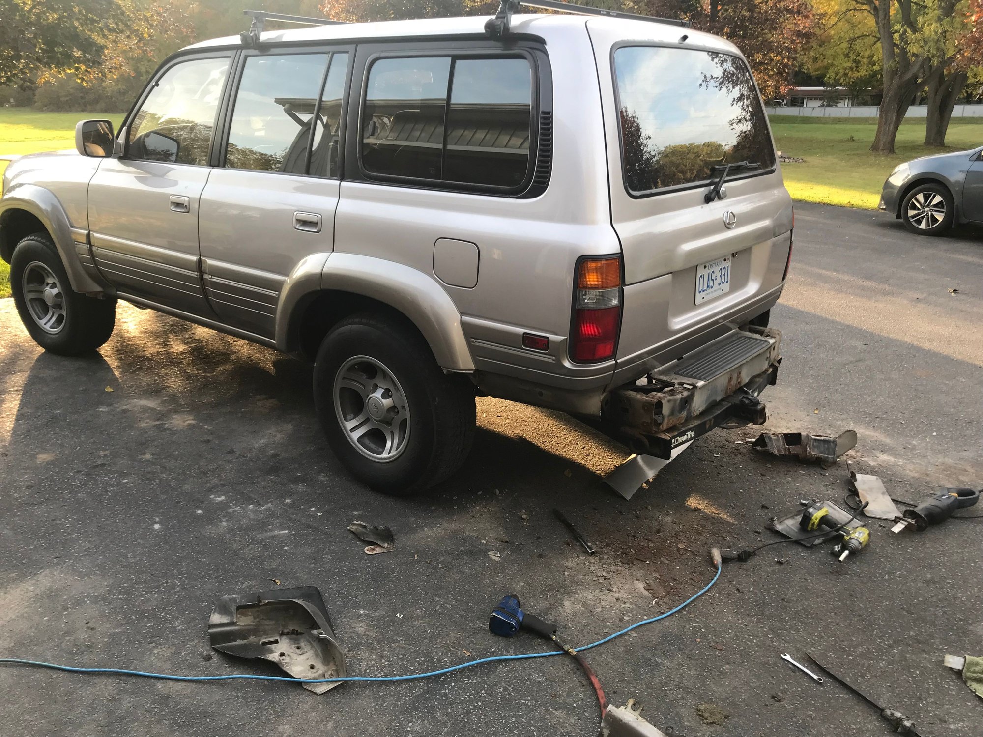

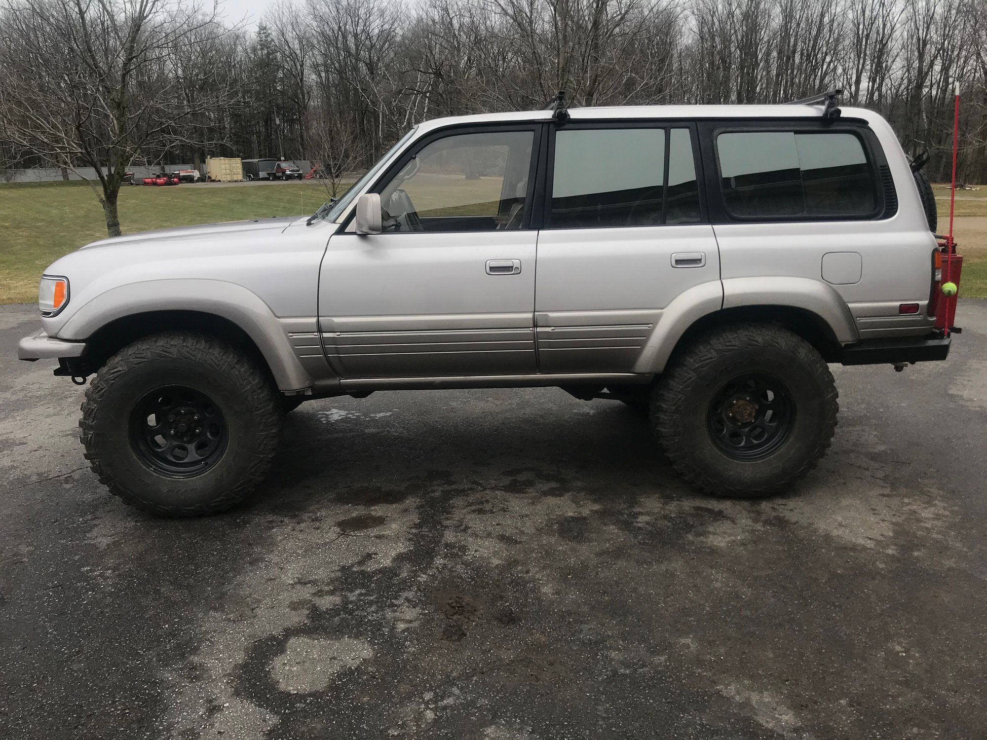

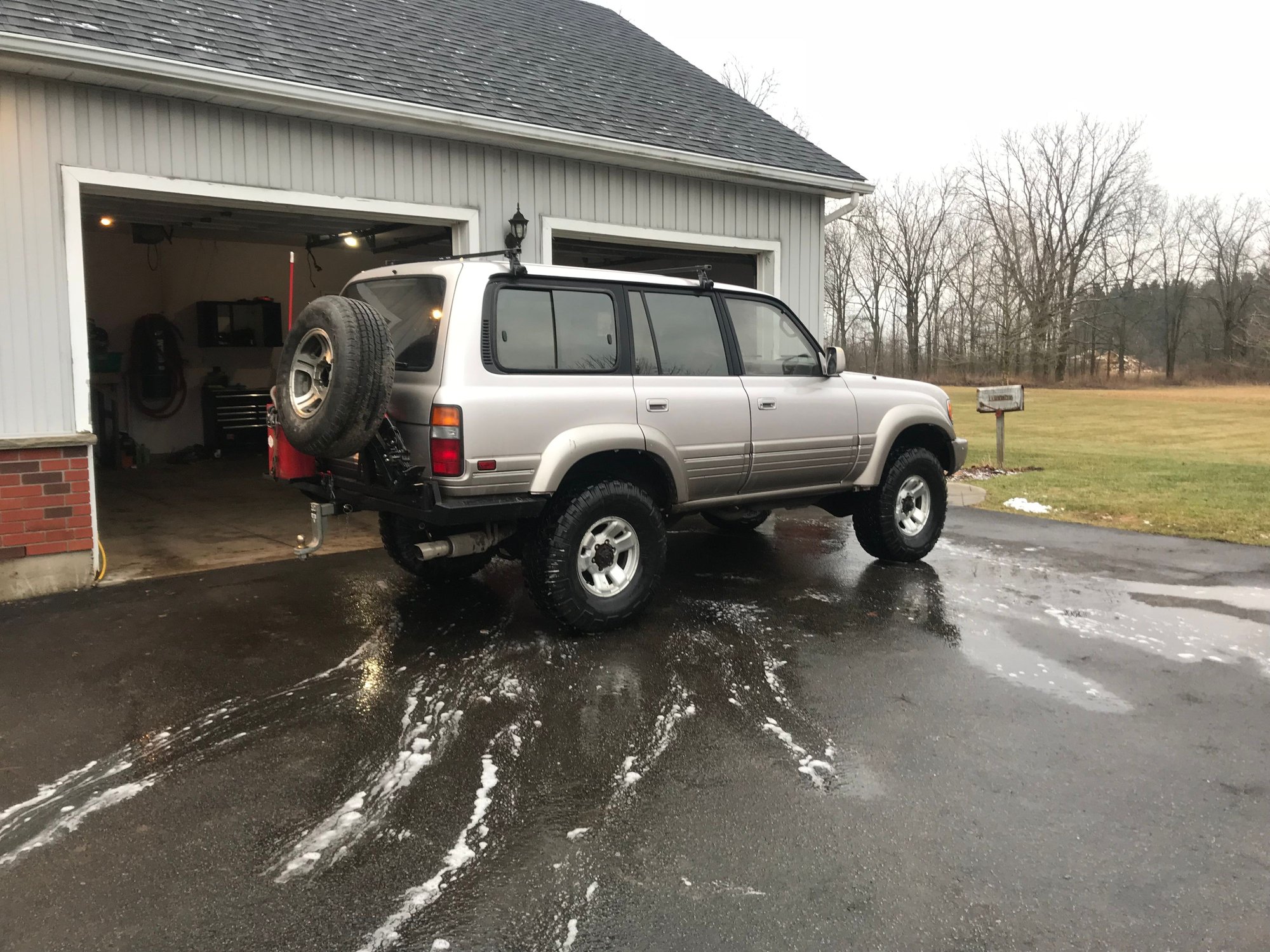

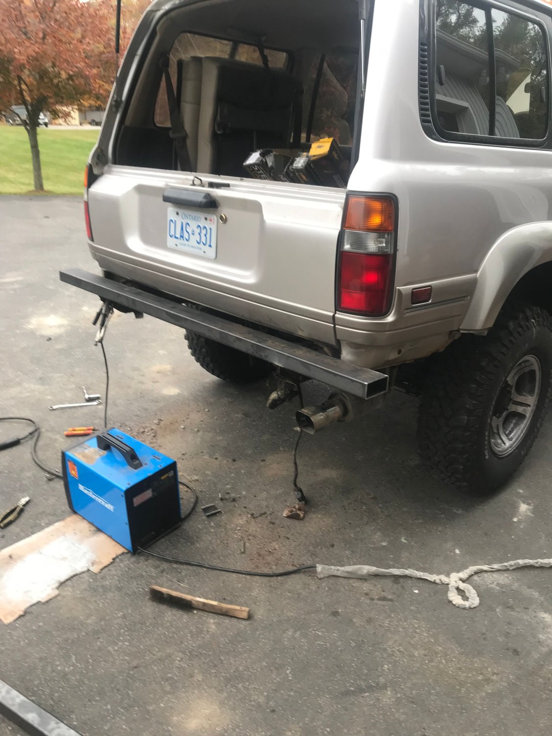

First things first, I started tearing off the stupid rear bumper

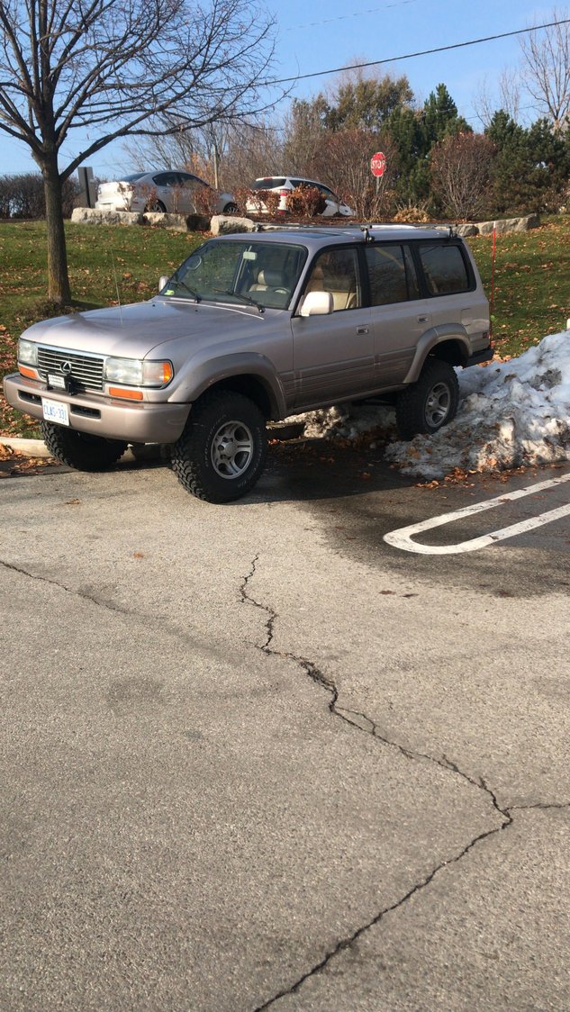

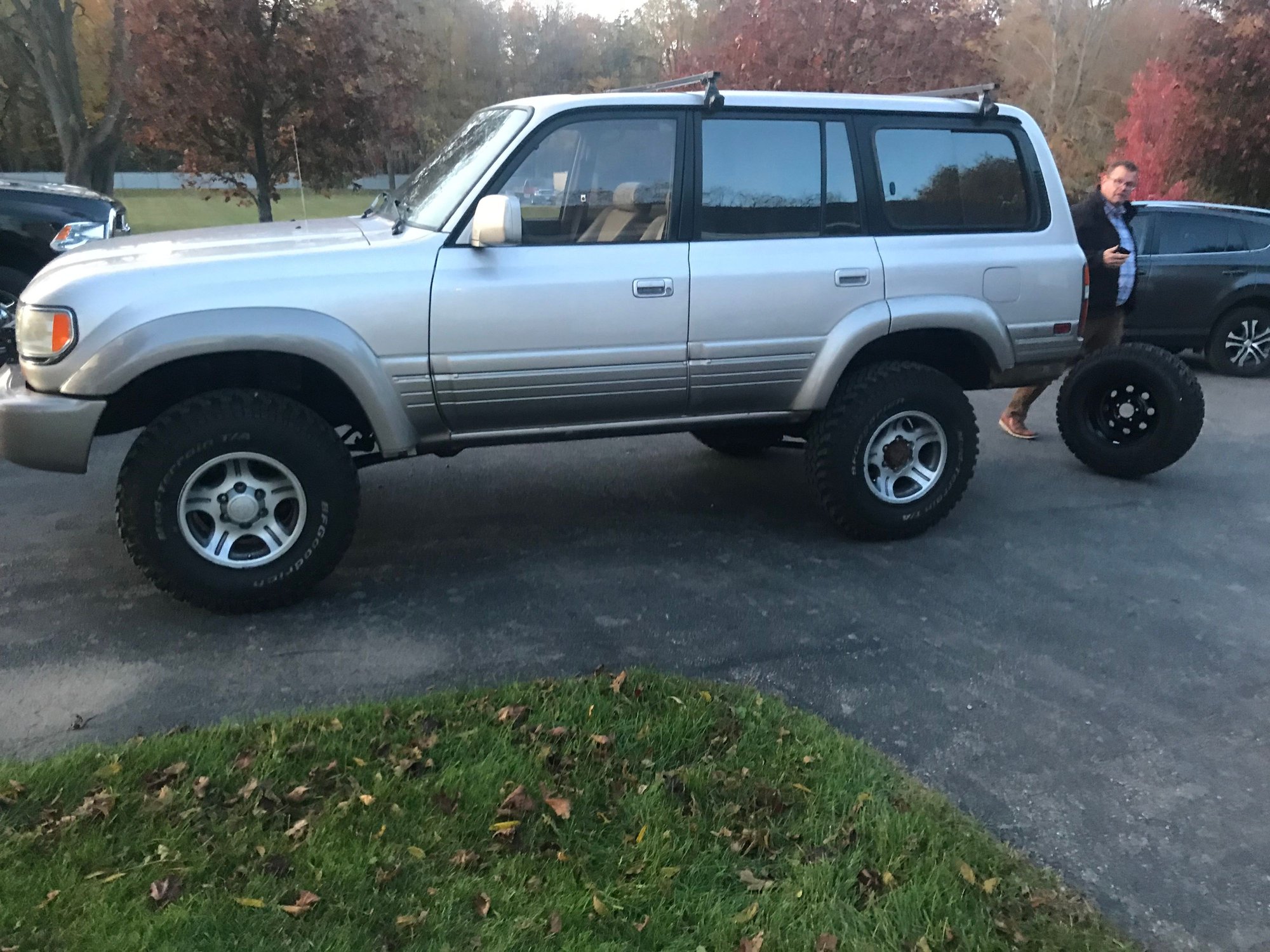

Then I got the OME lift all ready to go and installed, I got 2850J for the front and heavy springs in the rear

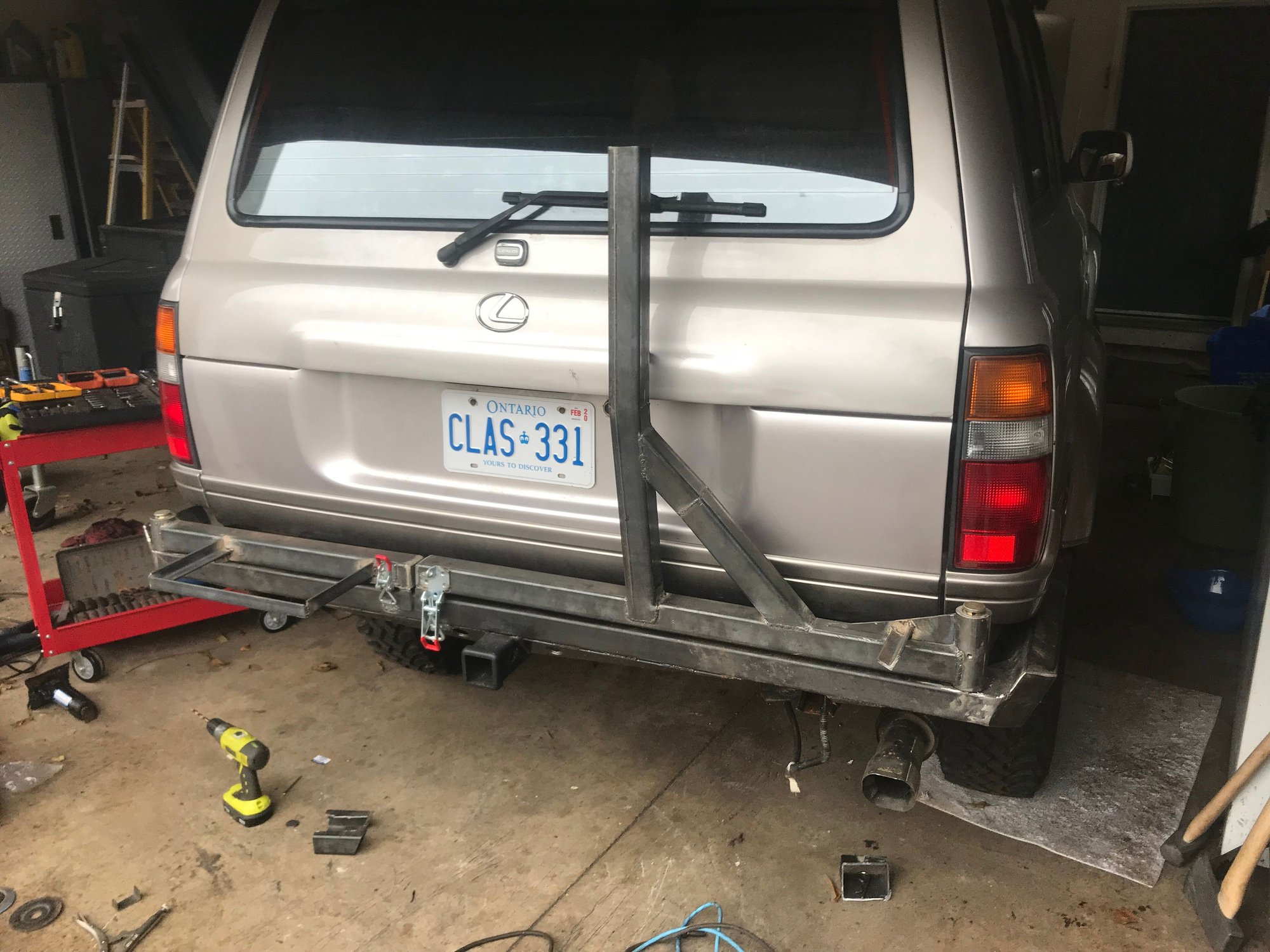

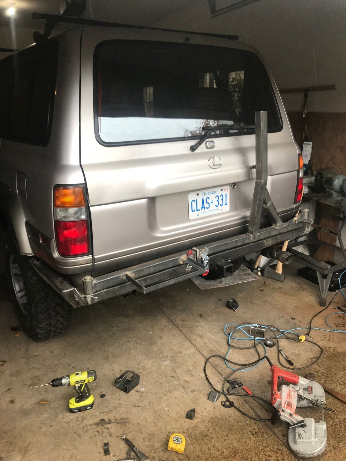

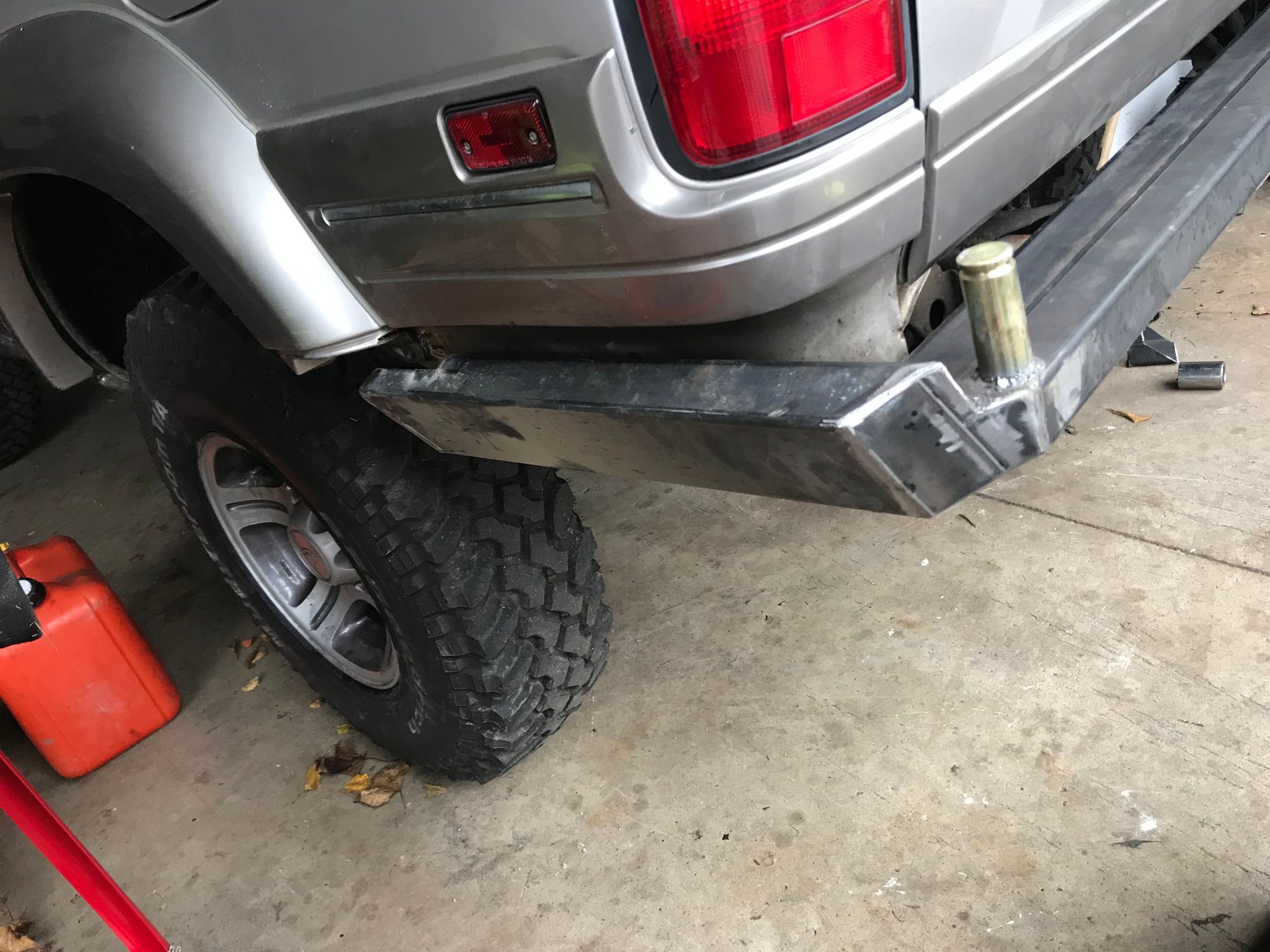

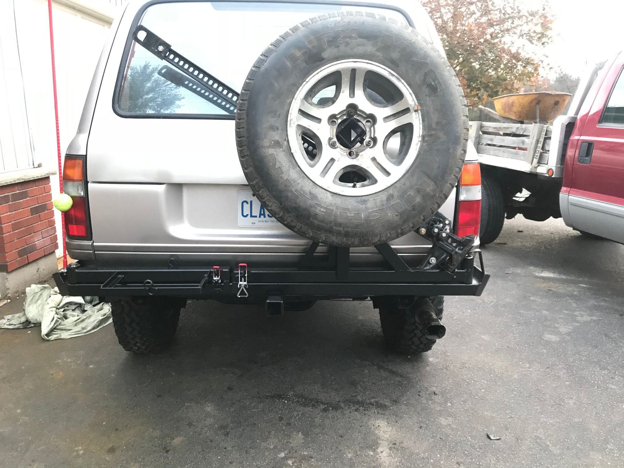

And started a rear bumper

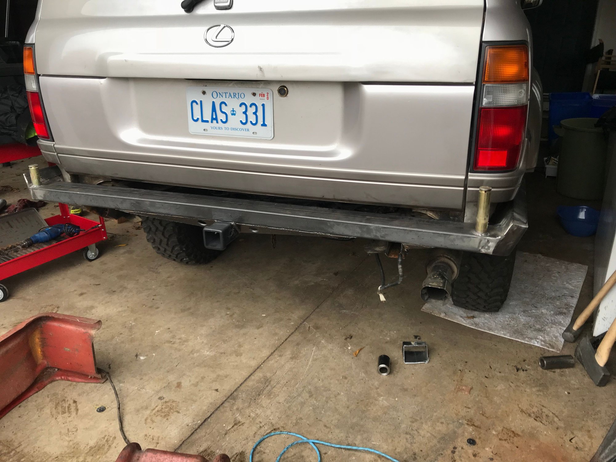

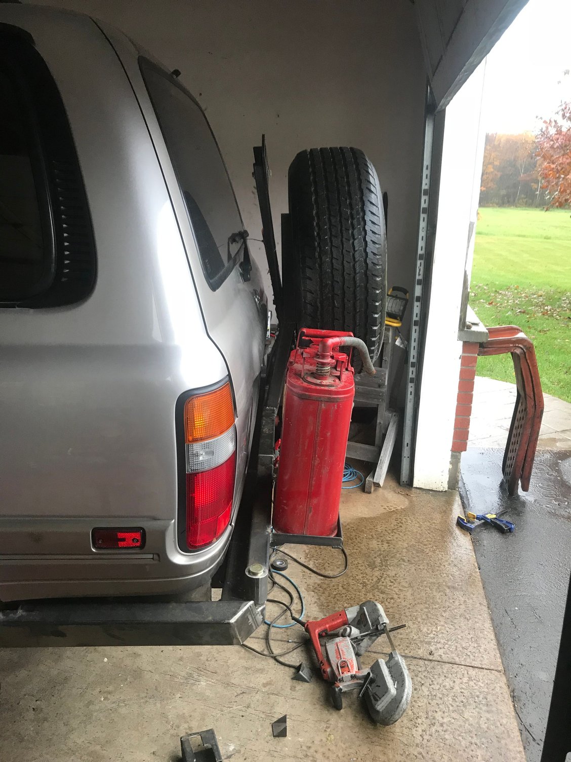

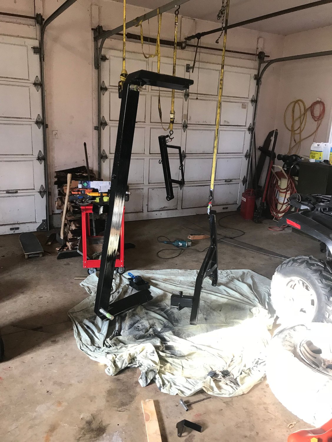

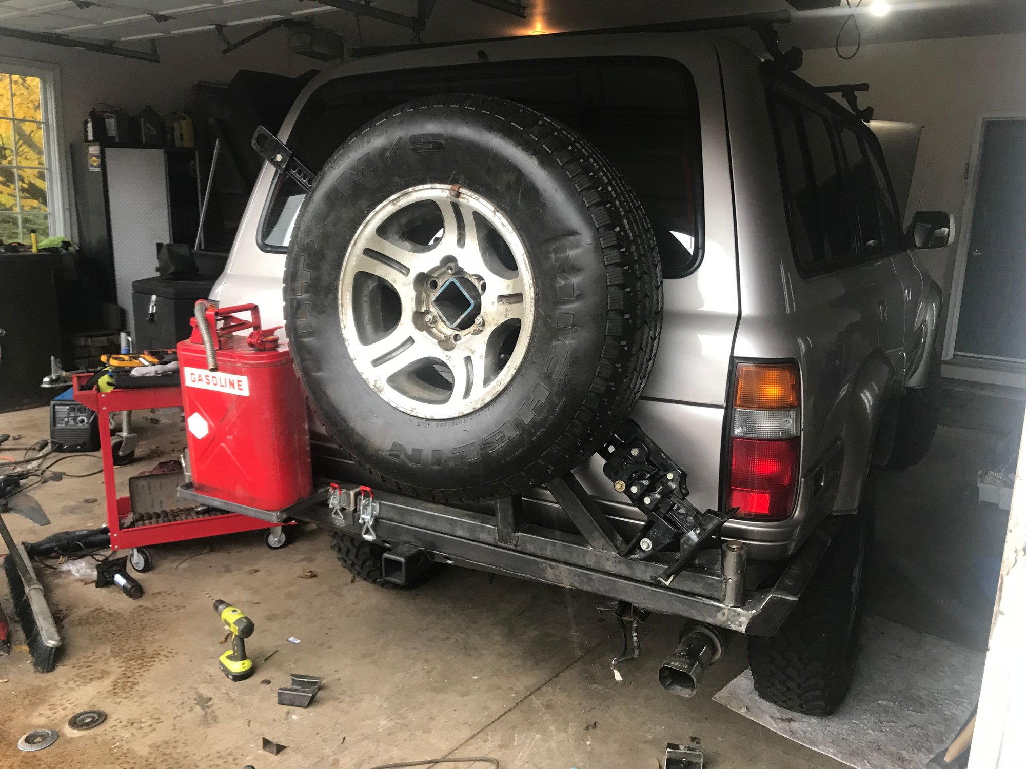

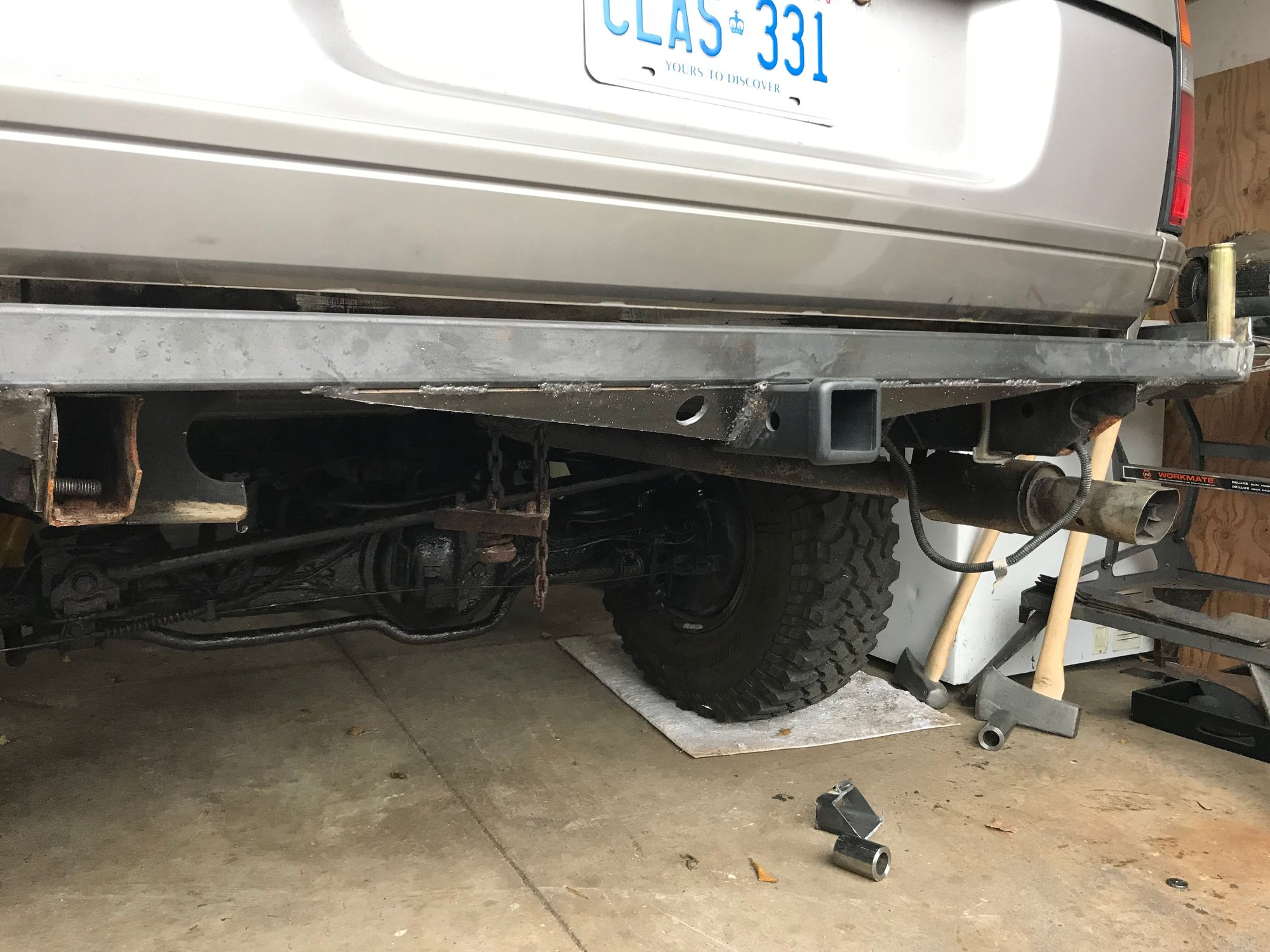

Test fit
Gussets for safety chains
Bumper building

Thanks for the move! Yeah it’s going good so far. Gotta do a front axle rebuild I’ve got all the parts I’ve just been slacking.

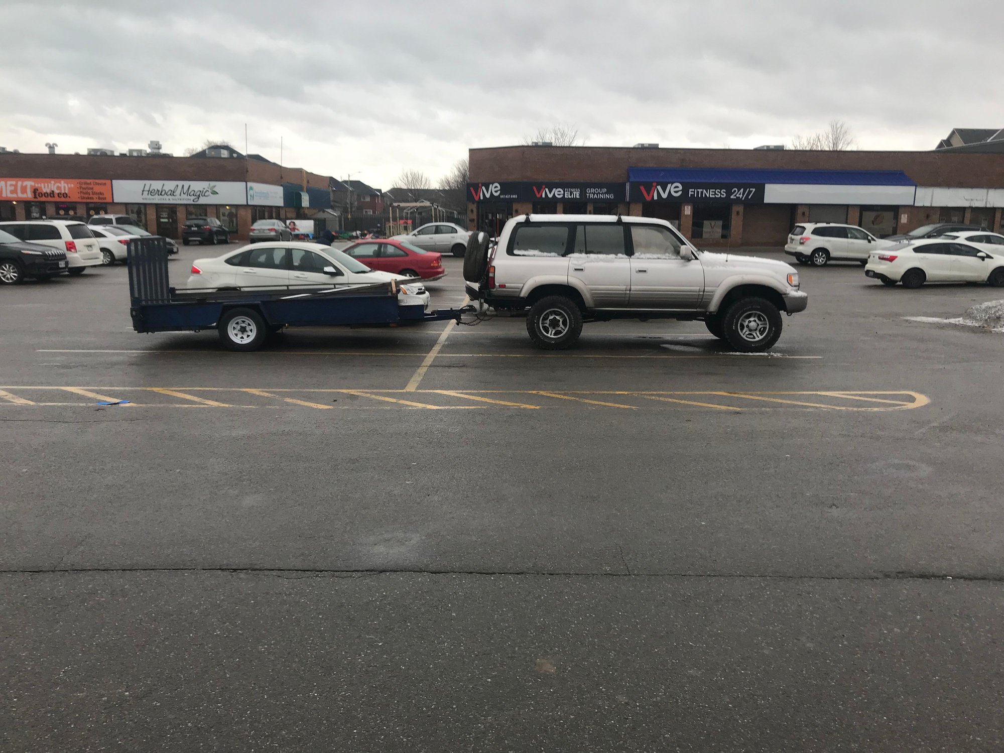

I really loved my 4runner, it was my dream truck once I finished it, it was really tough to sell, but it wasn’t my favourite truck to drive to and from trails so I trailered it a lot. so it’s nice to have something I can drive and still be capable on the trail.
Finding a space at Costco.

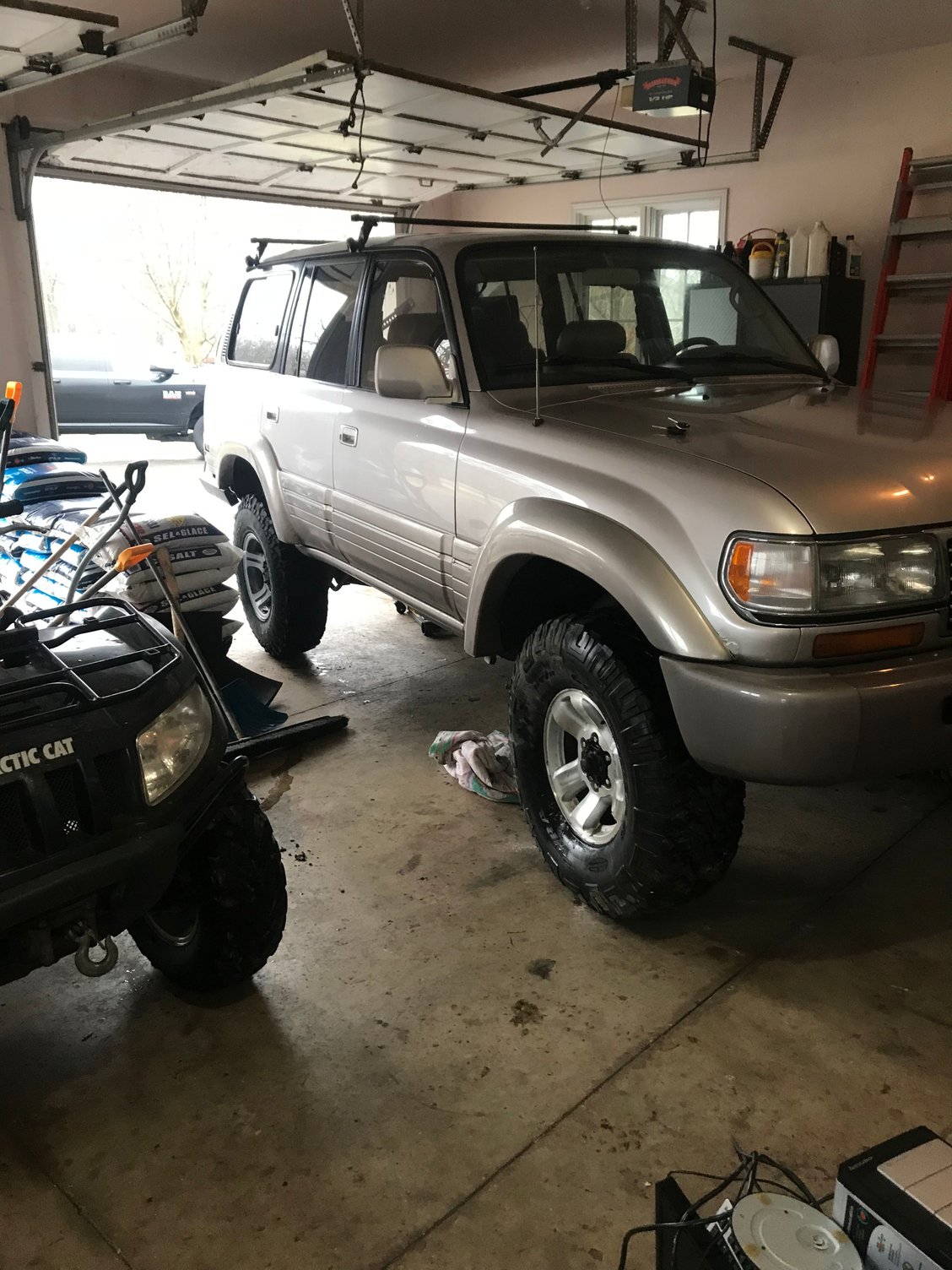

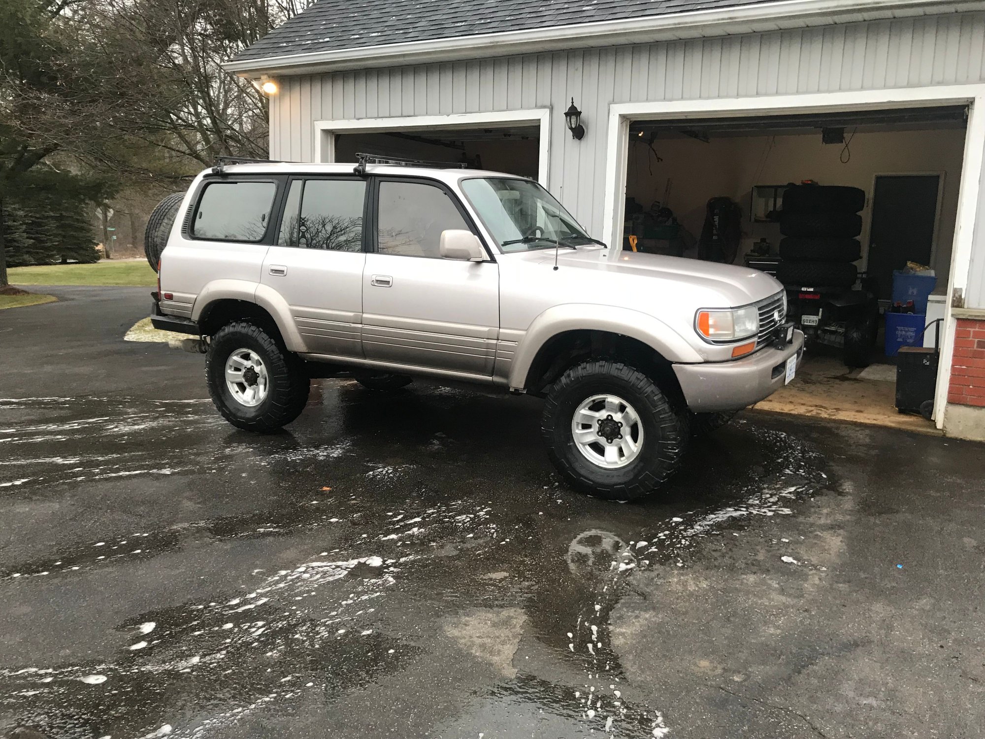

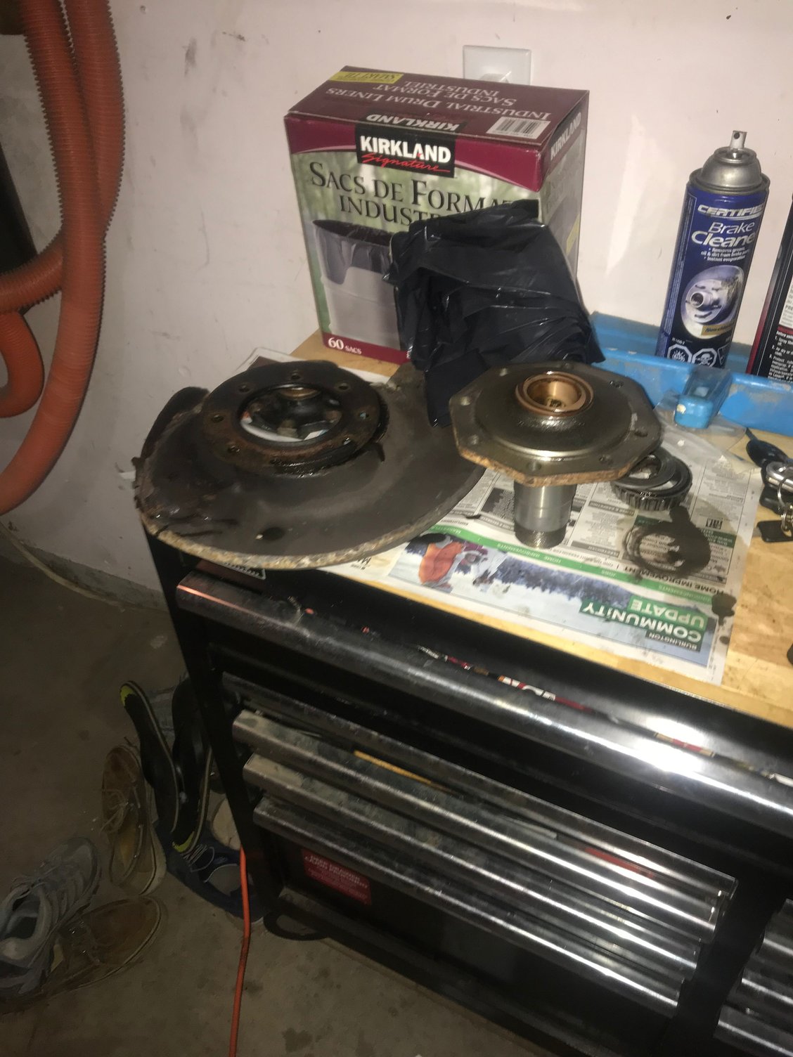

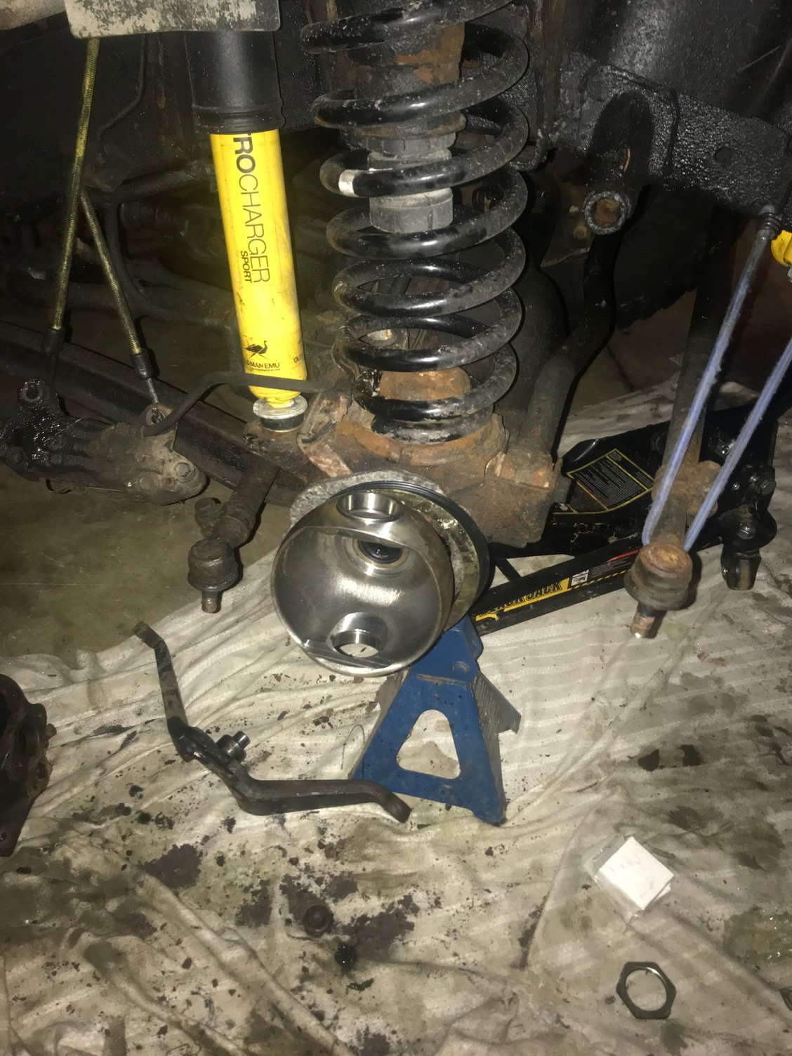

Moving along through the build! Finished the front axle rebuild which was a bit of a pain. I’ve rebuilt enough mini truck axles to know what I’m doing, but the landcruiser gave me hell all the way through. Happily got that out of the way, I just bolted up these 35s today.

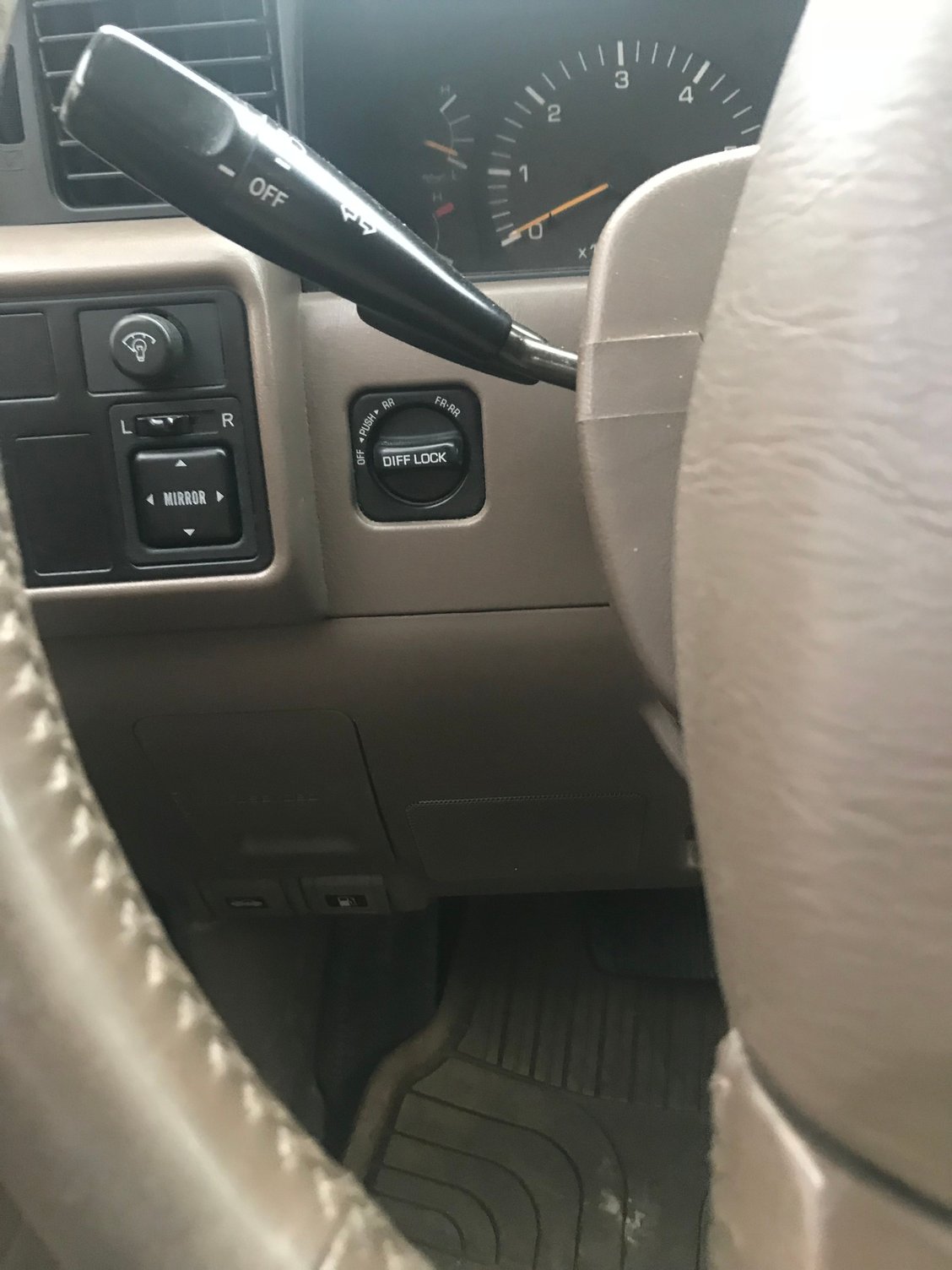

My next thing to do is figure out the Center diff lock light. It’s not coming on the dash anymore, so the F/R lockers won’t engage.
So many parts to one axle.
Cleaned up bird housing and new seals

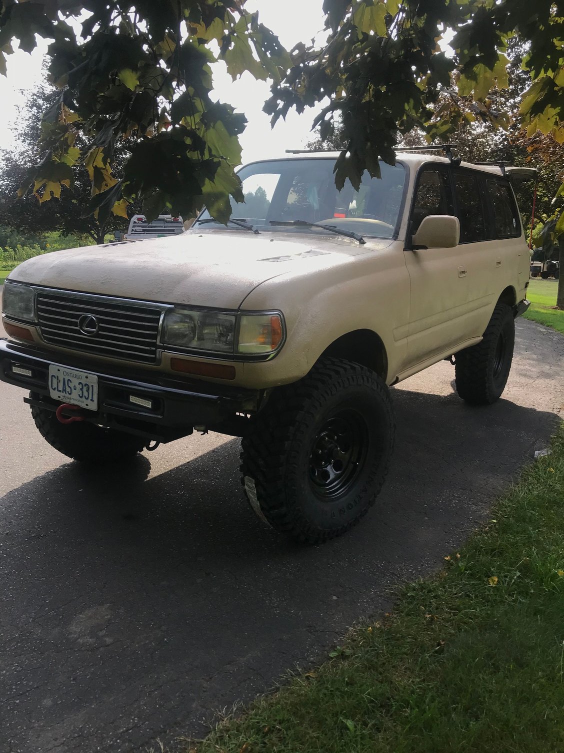

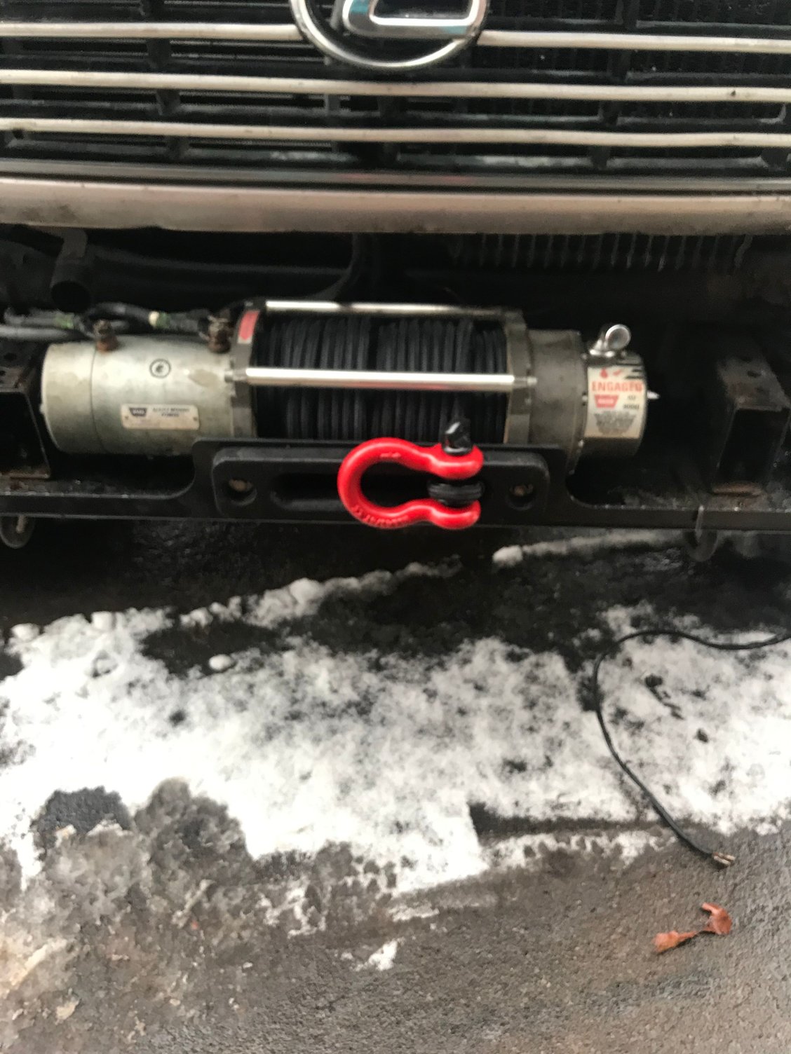

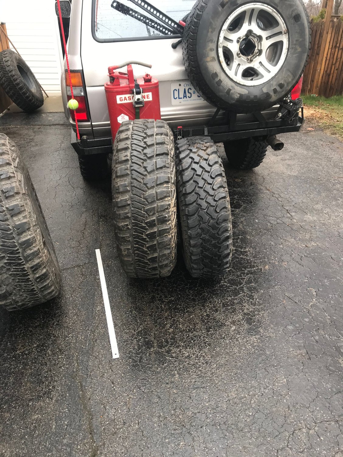

Got a warn xd9000 and synthetic line.
New 37s babyyyyy

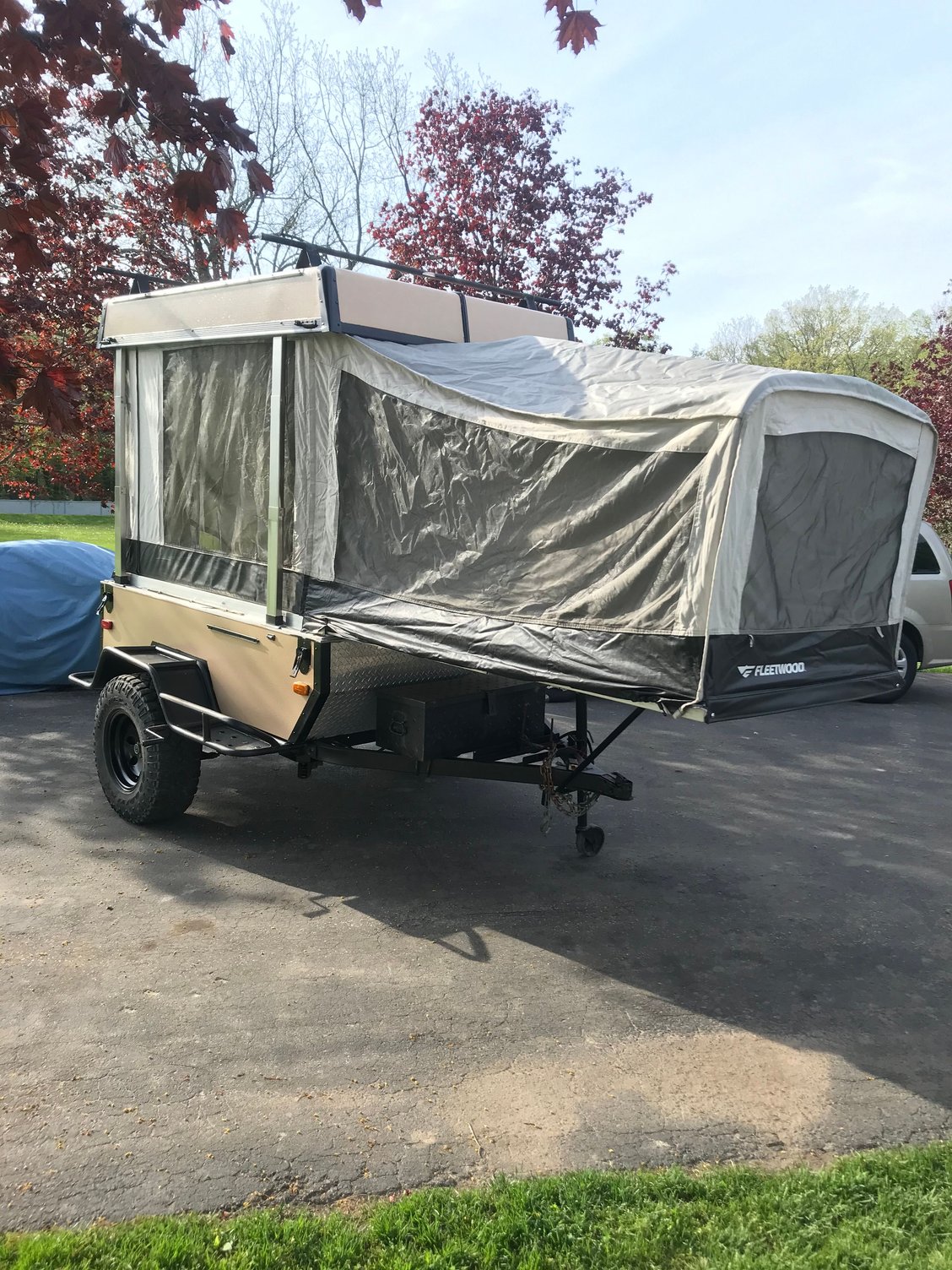

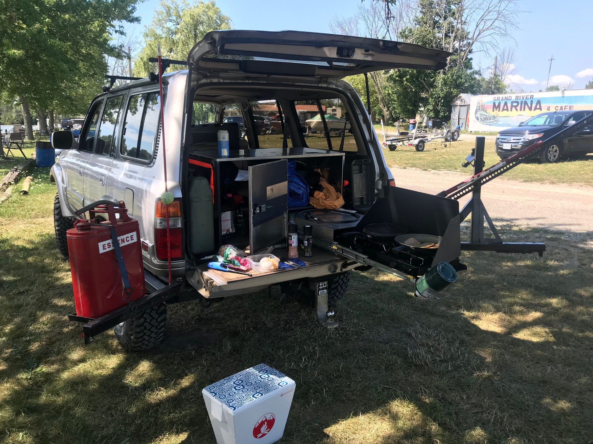

Starting to get my camper put together.

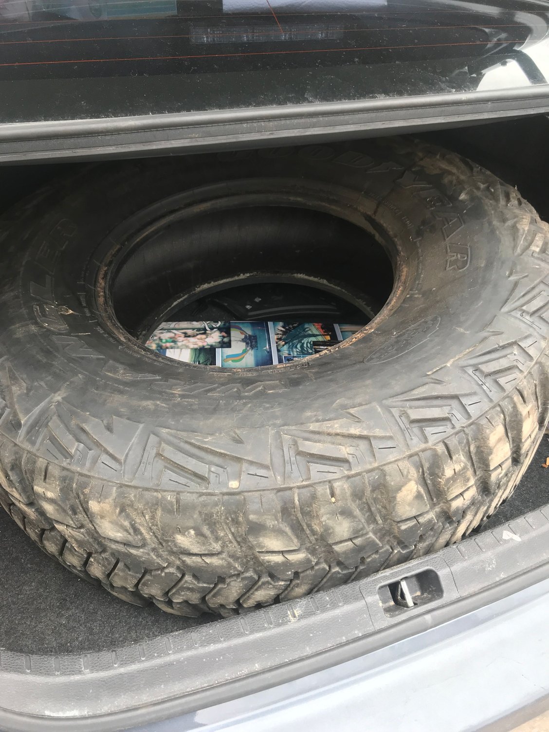

Found a 37” spare

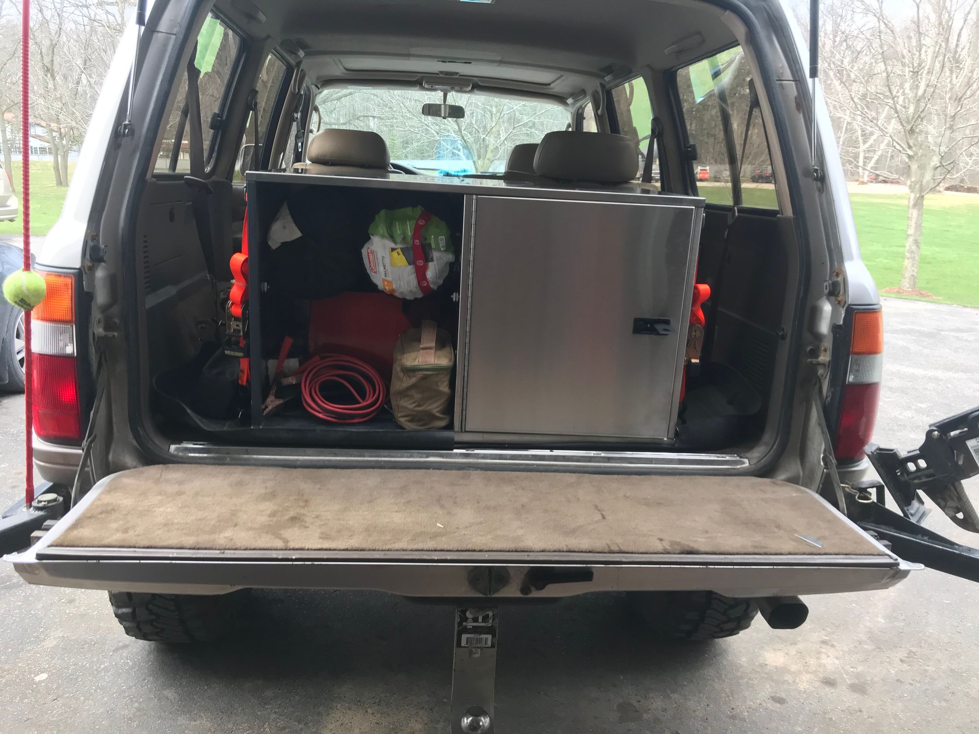

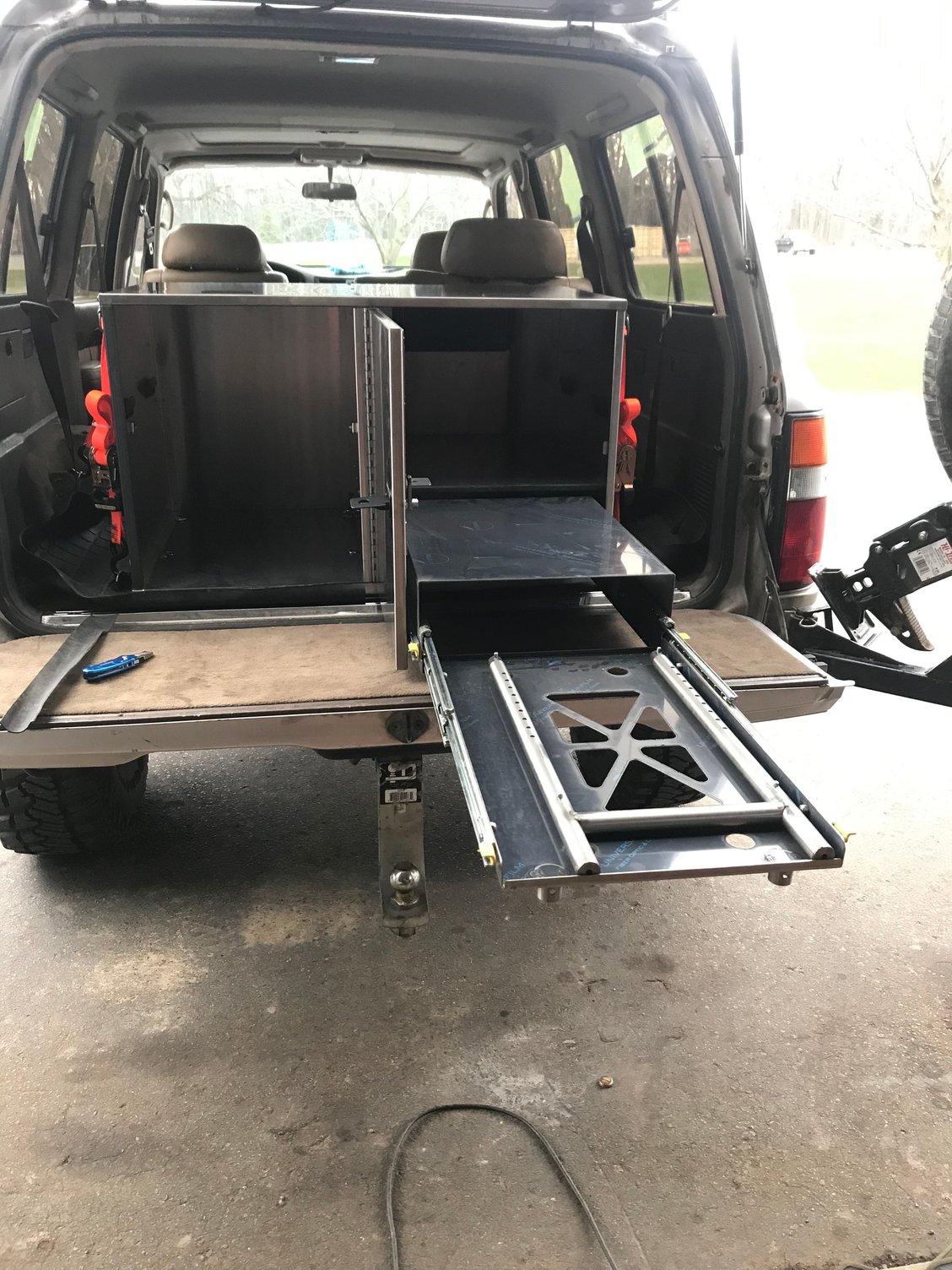

And got my rear storage solution and installed. Will probably modify it as the time goes on

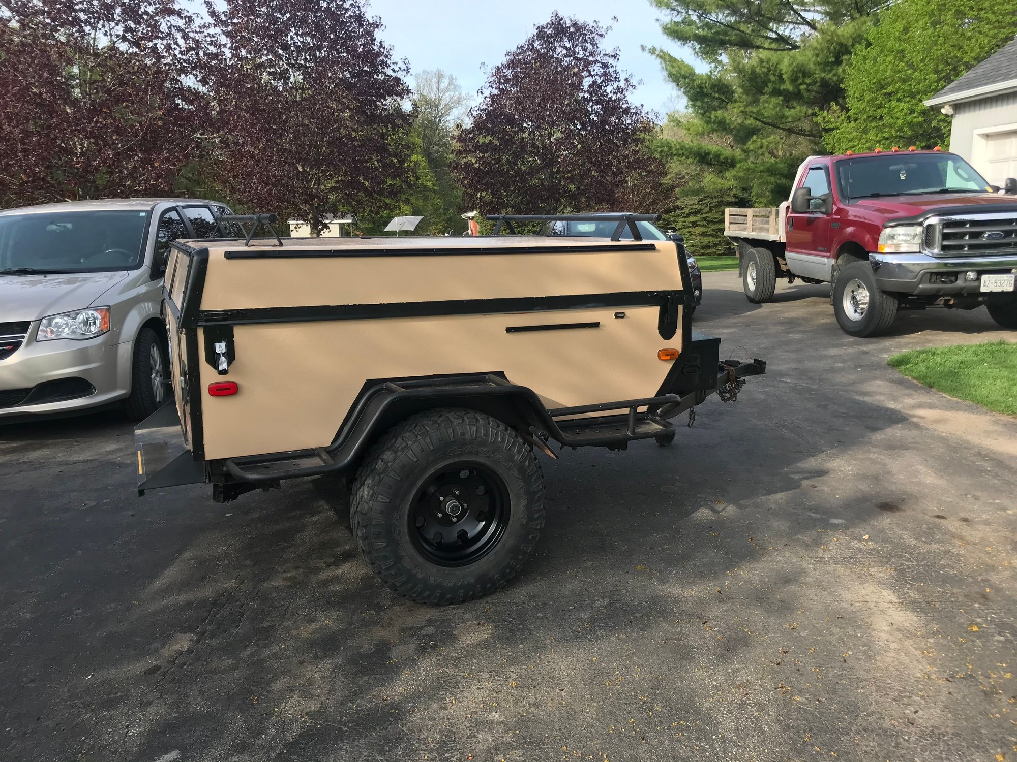

Cleaned up the Camper and painted it! It’s for sale if anyone is interested! Hamilton Ontario Canada

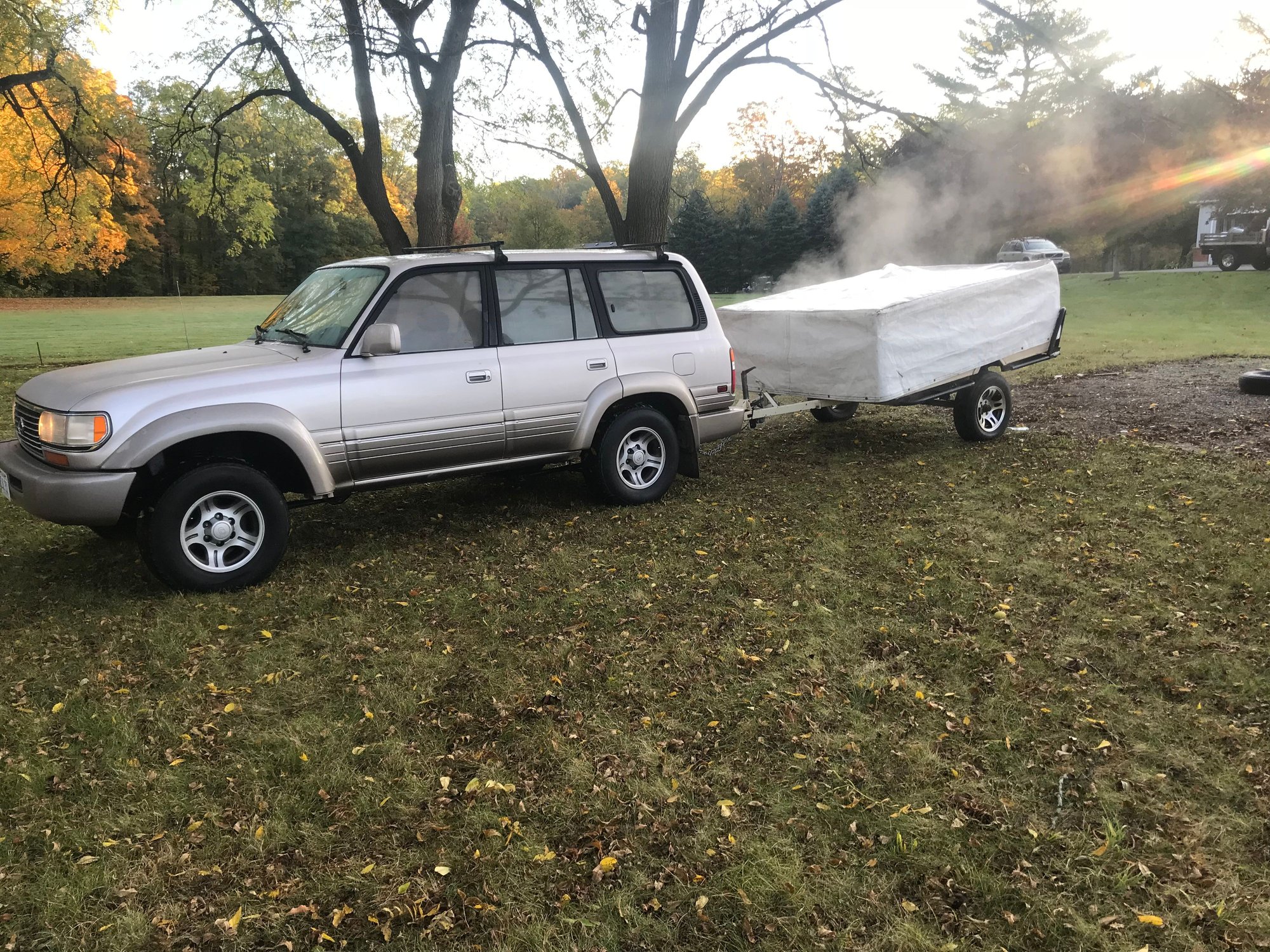

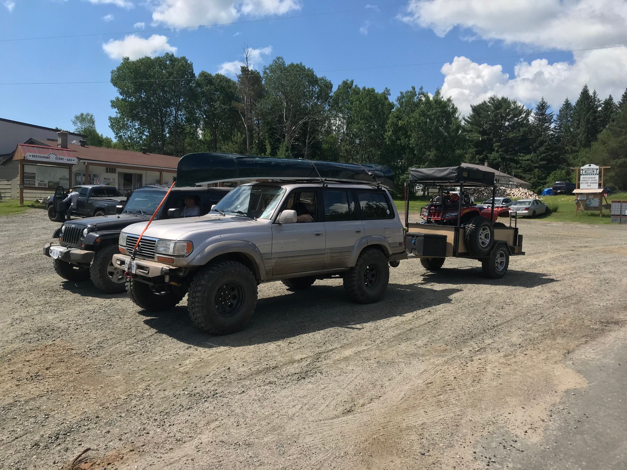

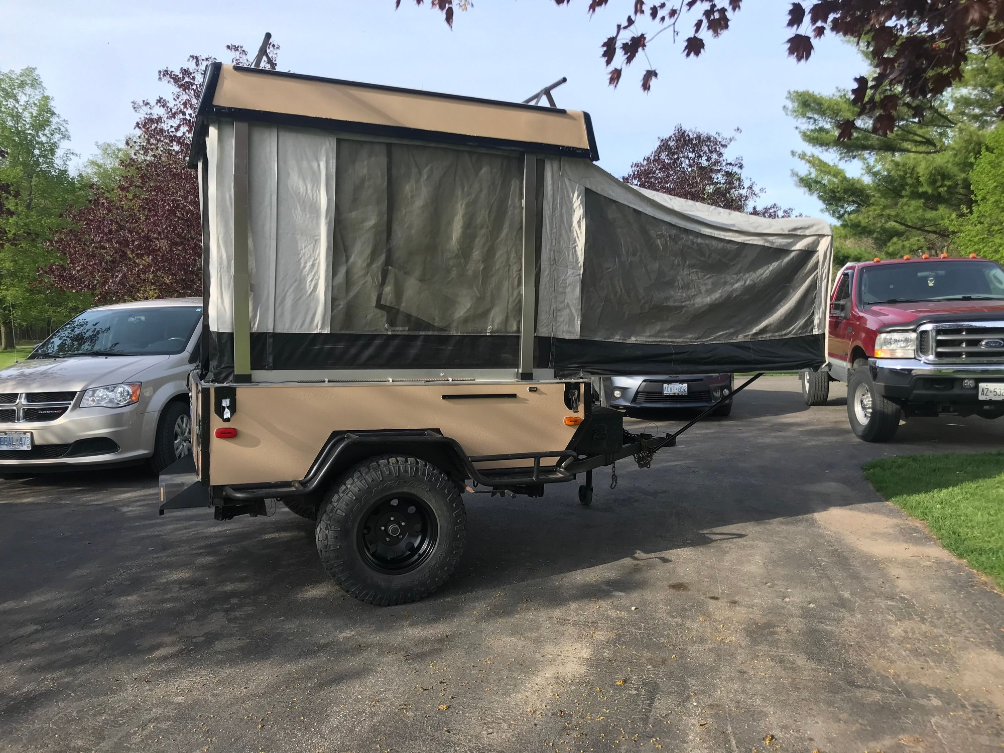

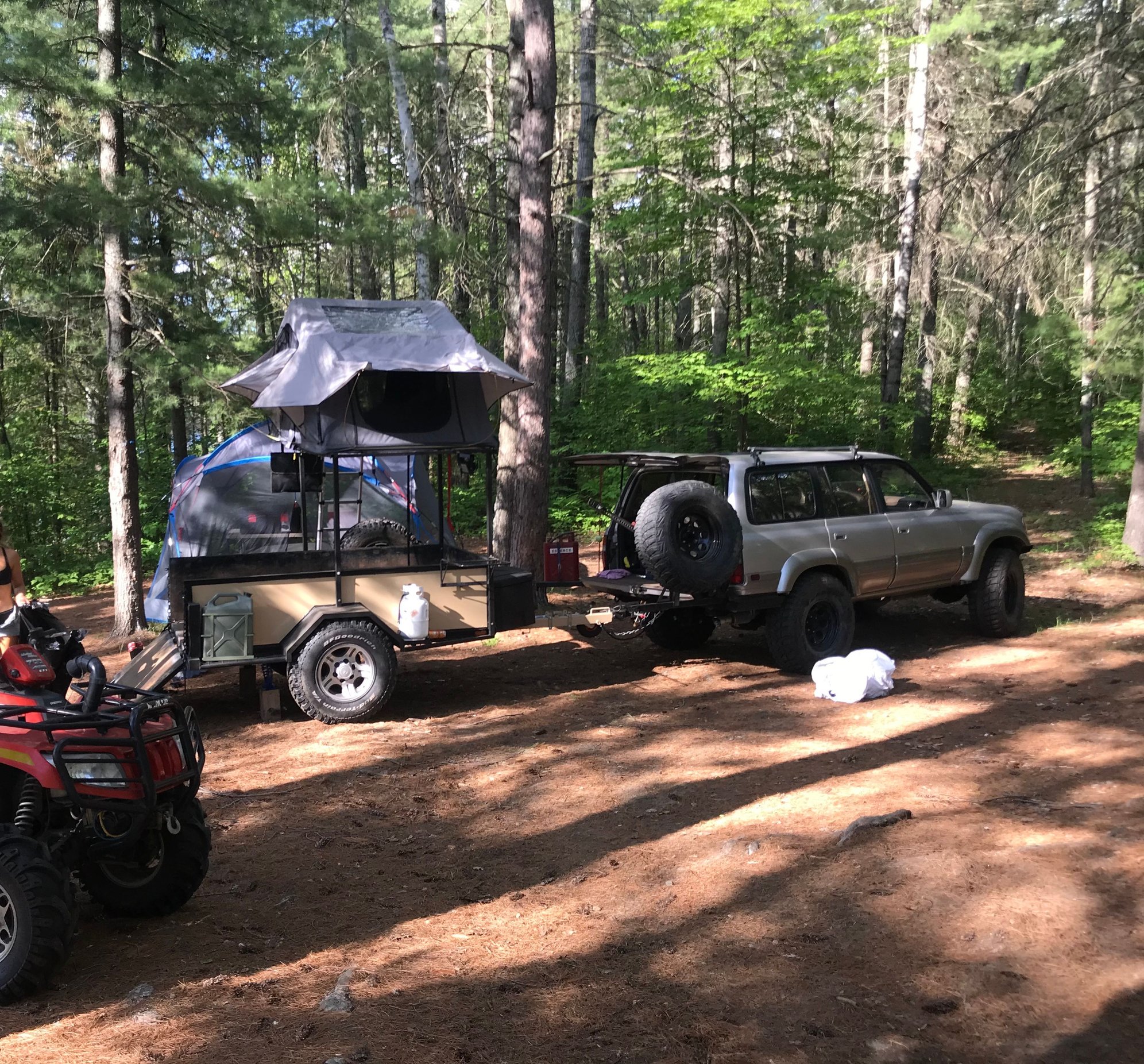

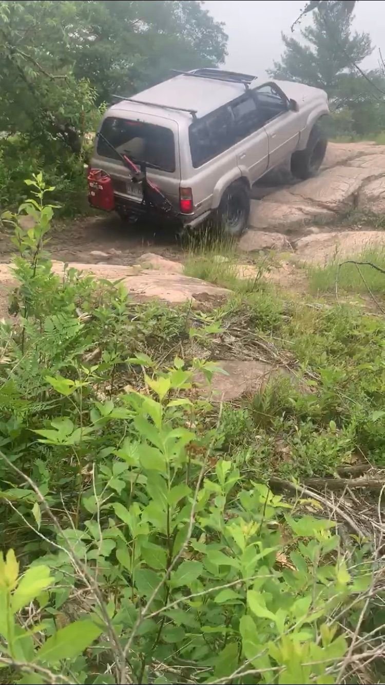

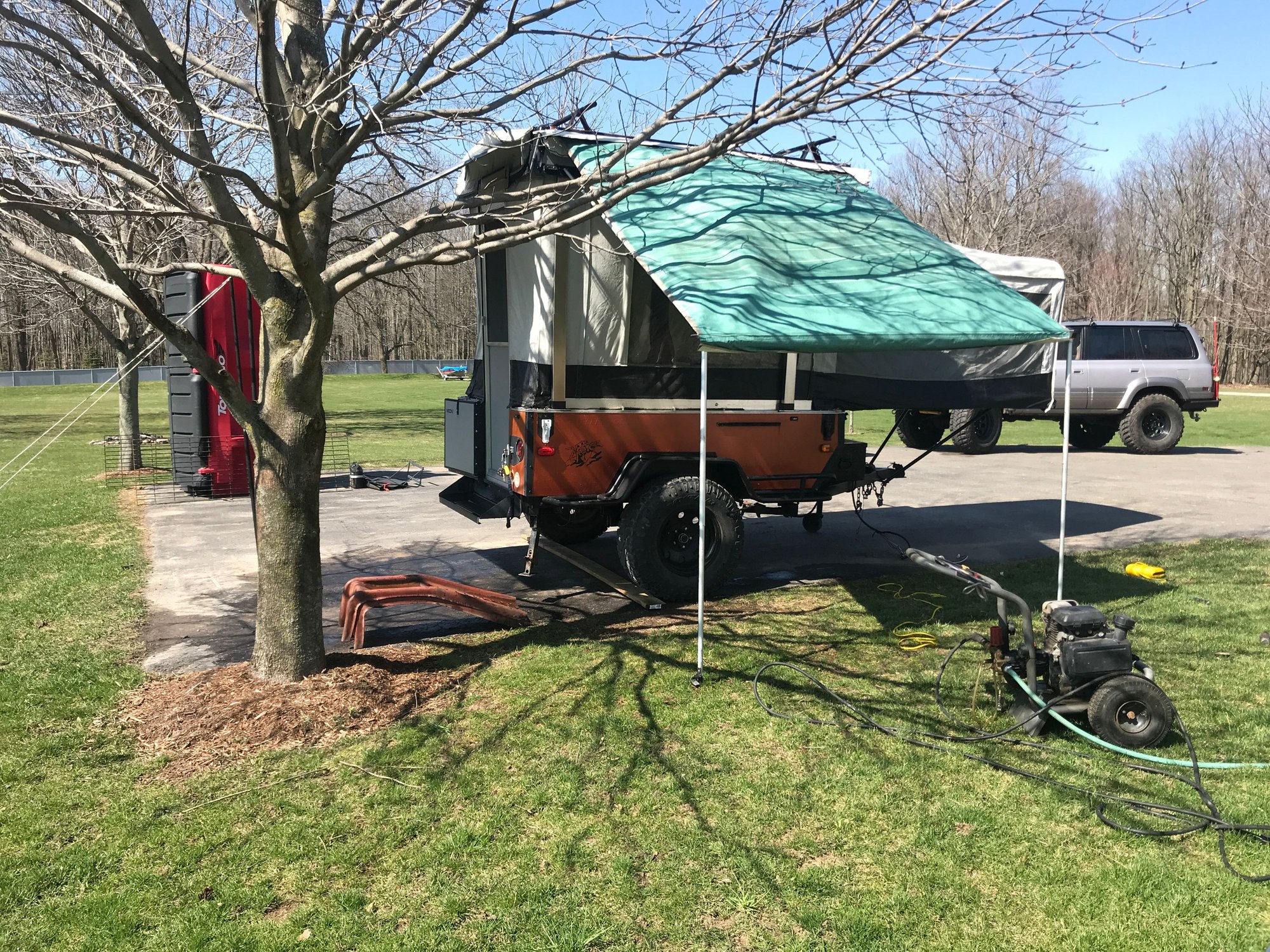

New camper setup I finished a couple weeks ago with Smittybilt Gen 2 Tent.

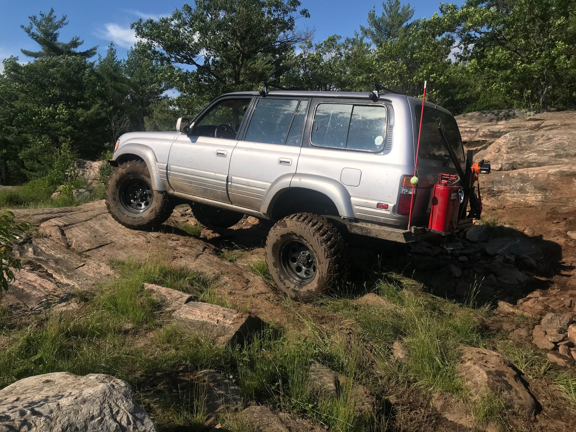

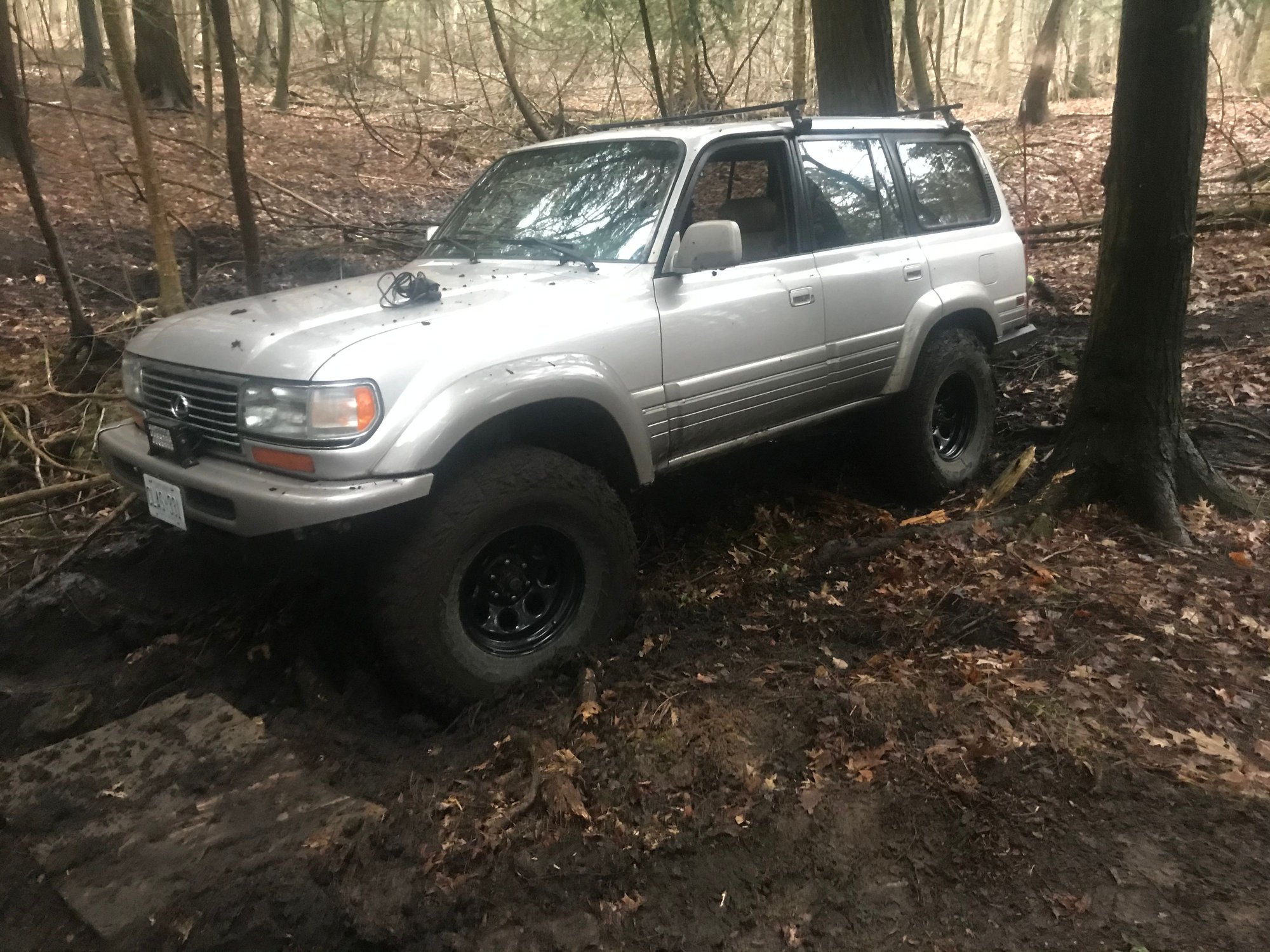

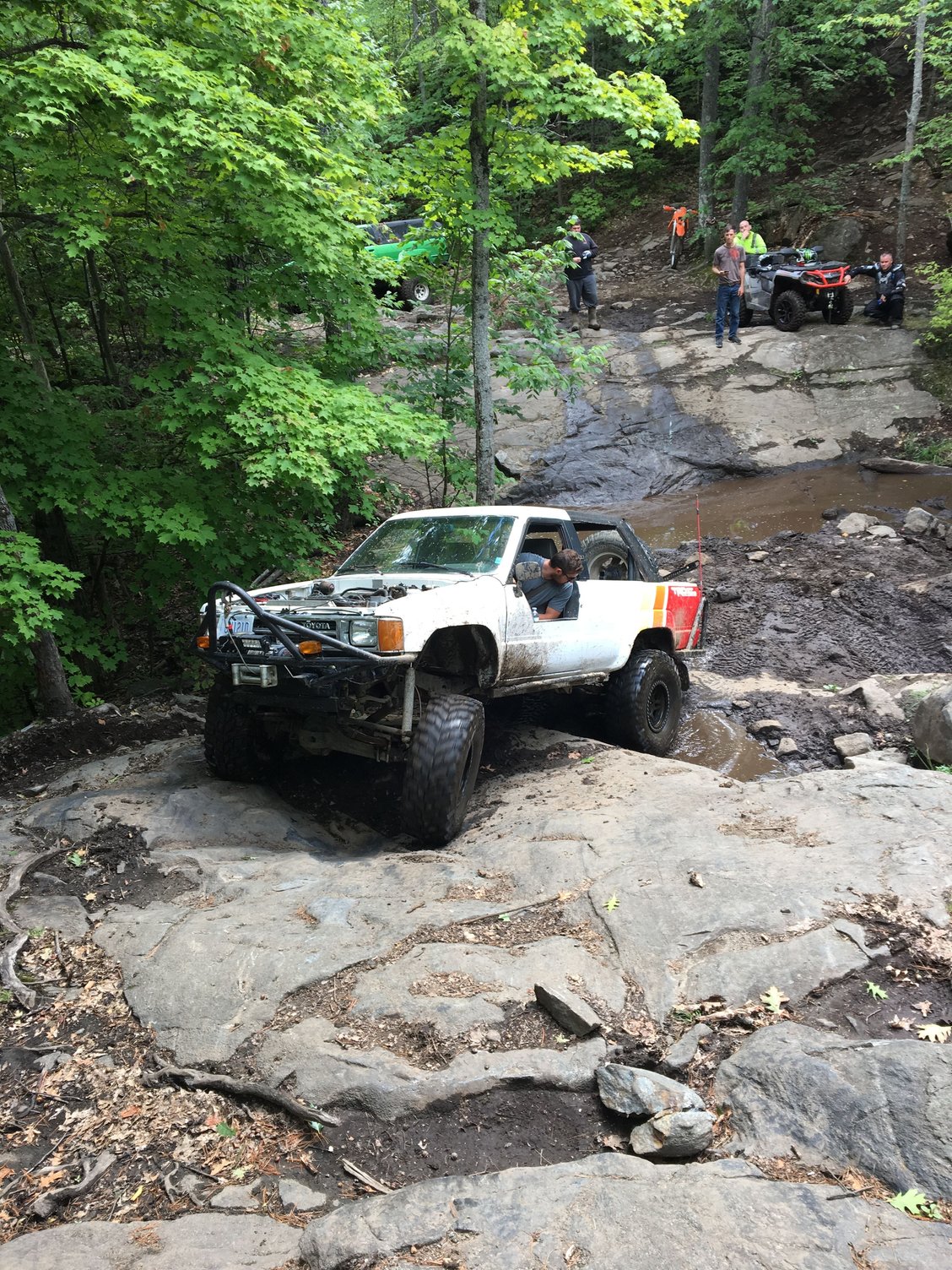

A few updates and wheeling pics

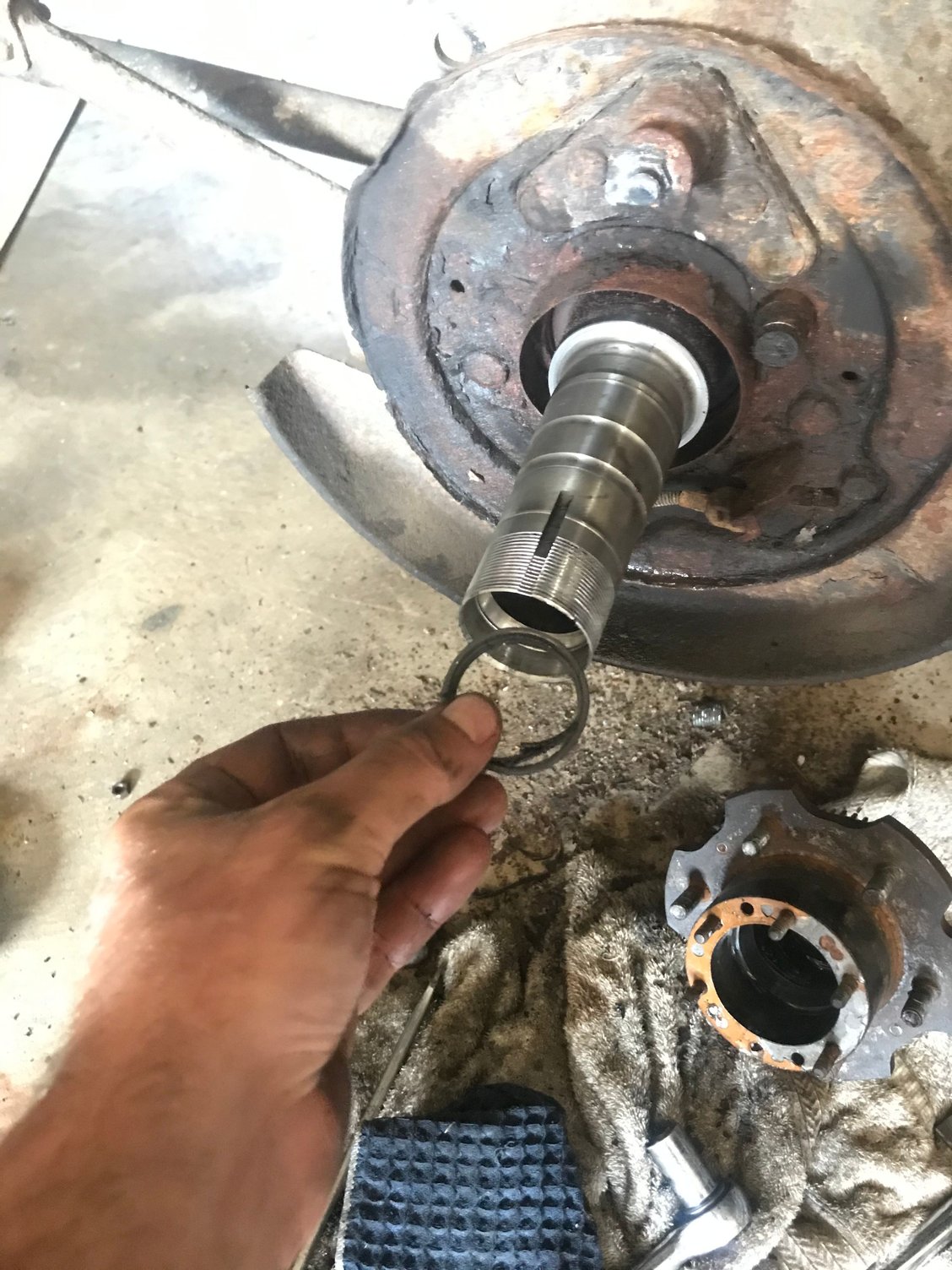

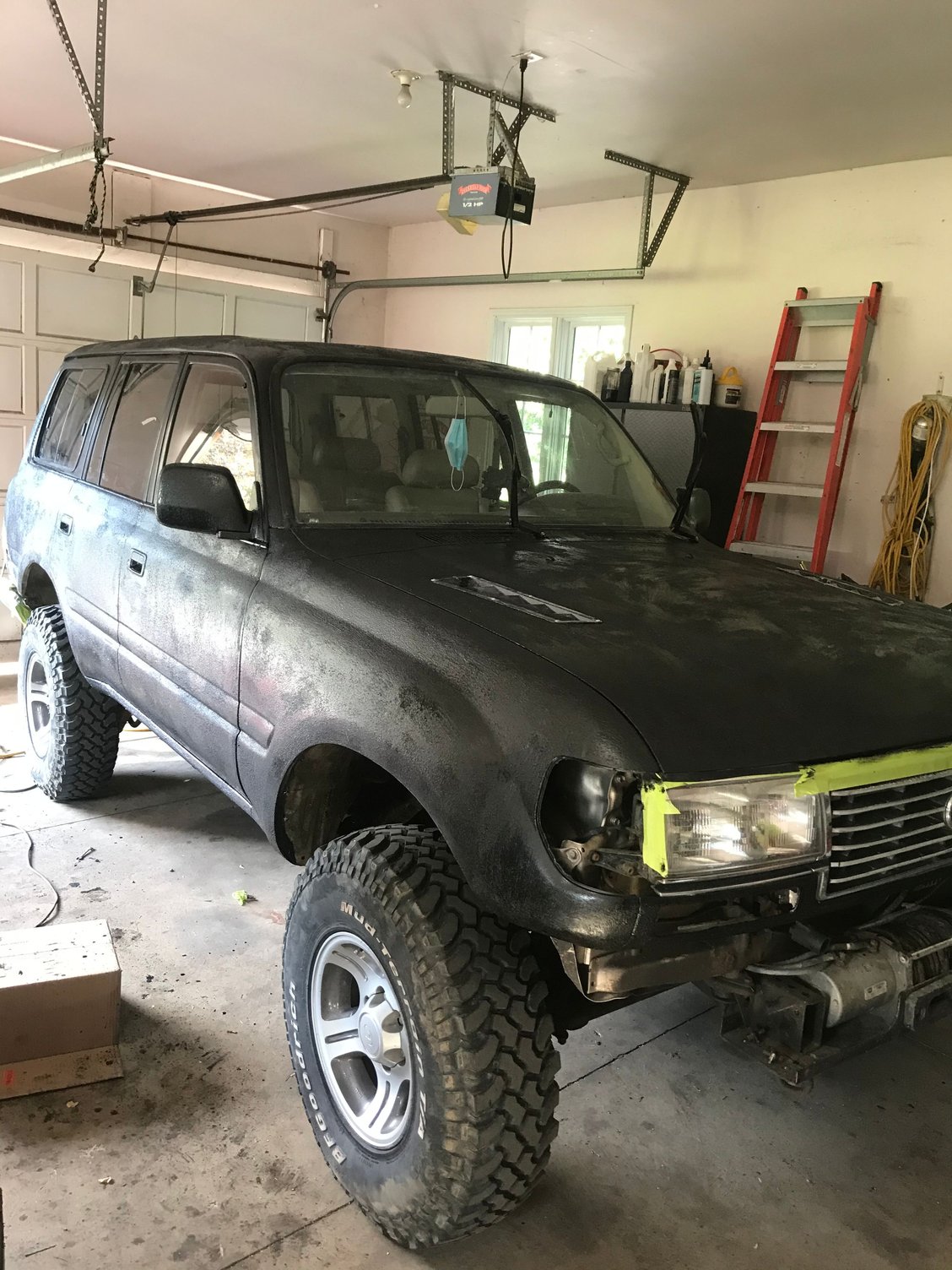

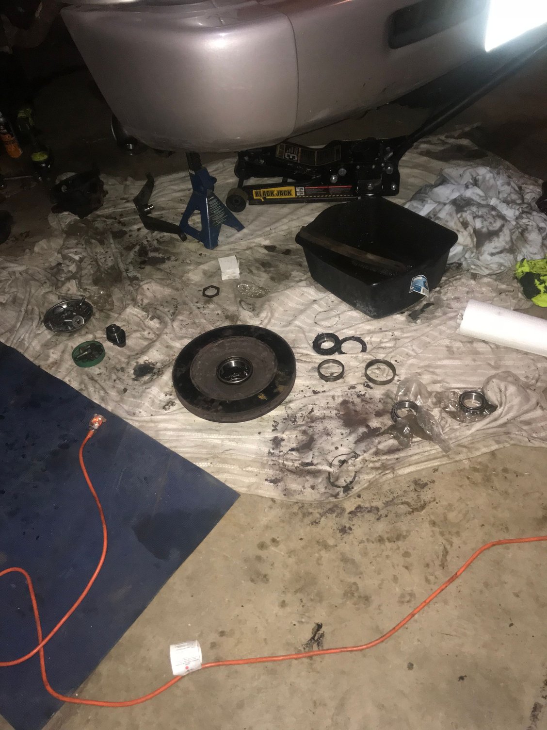

Did rear inner axle seal

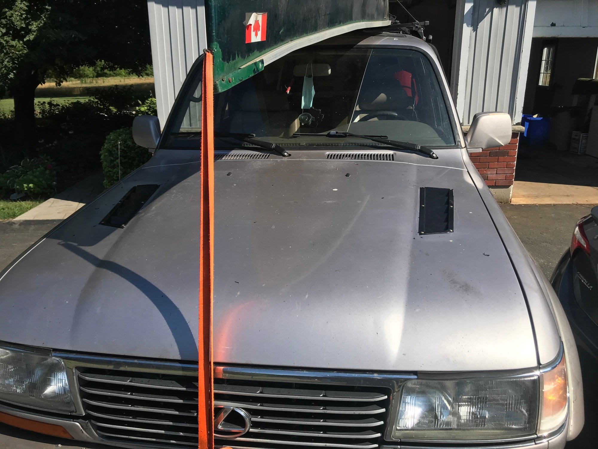

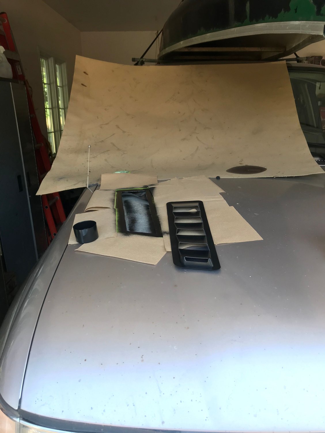

Cut in some hood louvers to keep the temps down under the hood
A few updates

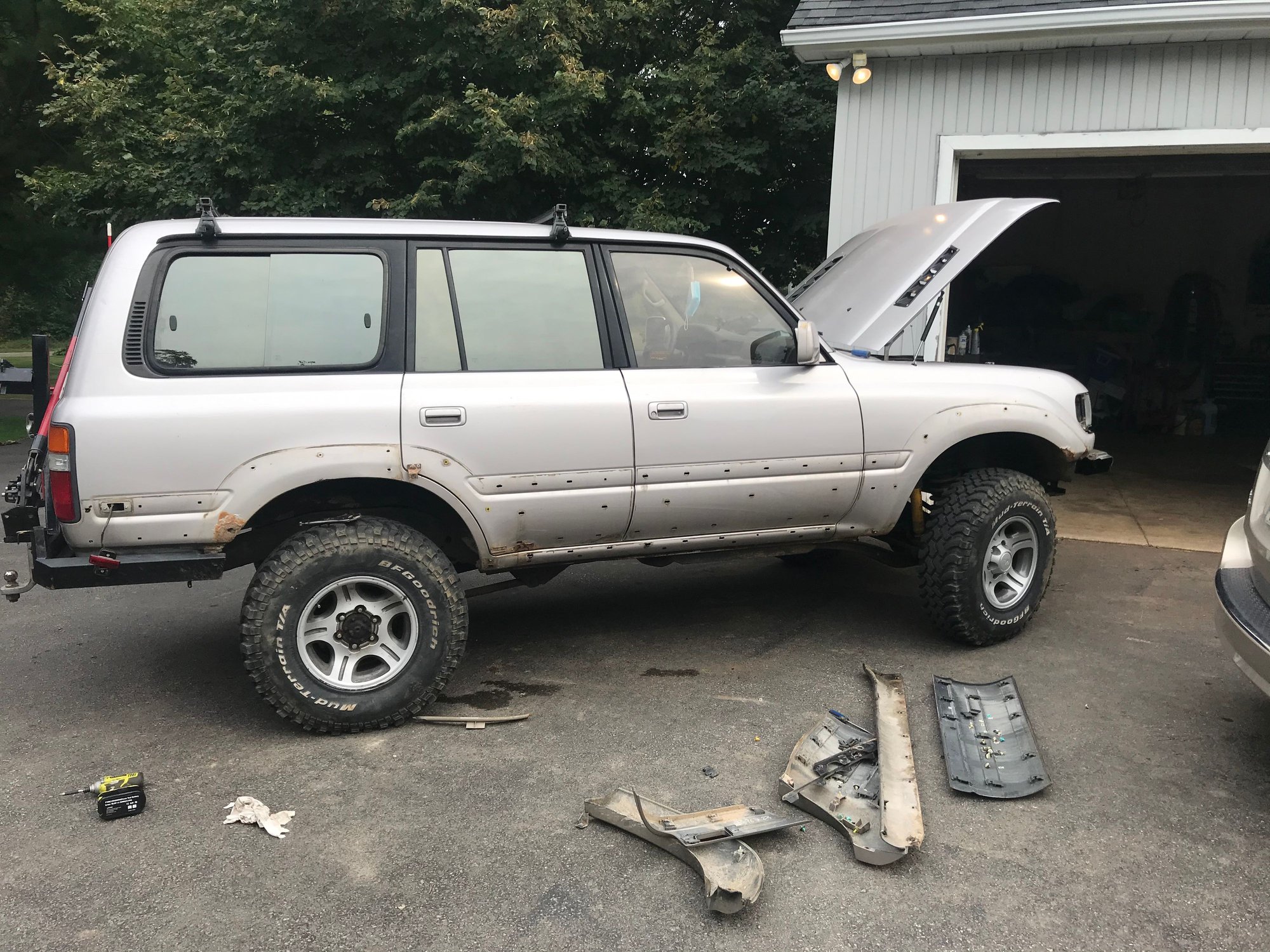

Tore a flare off on a wheeling trip

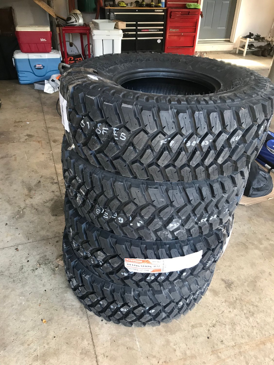

New 315/75r16 Firestone destination mt2
Tearing one flare off lead to this....

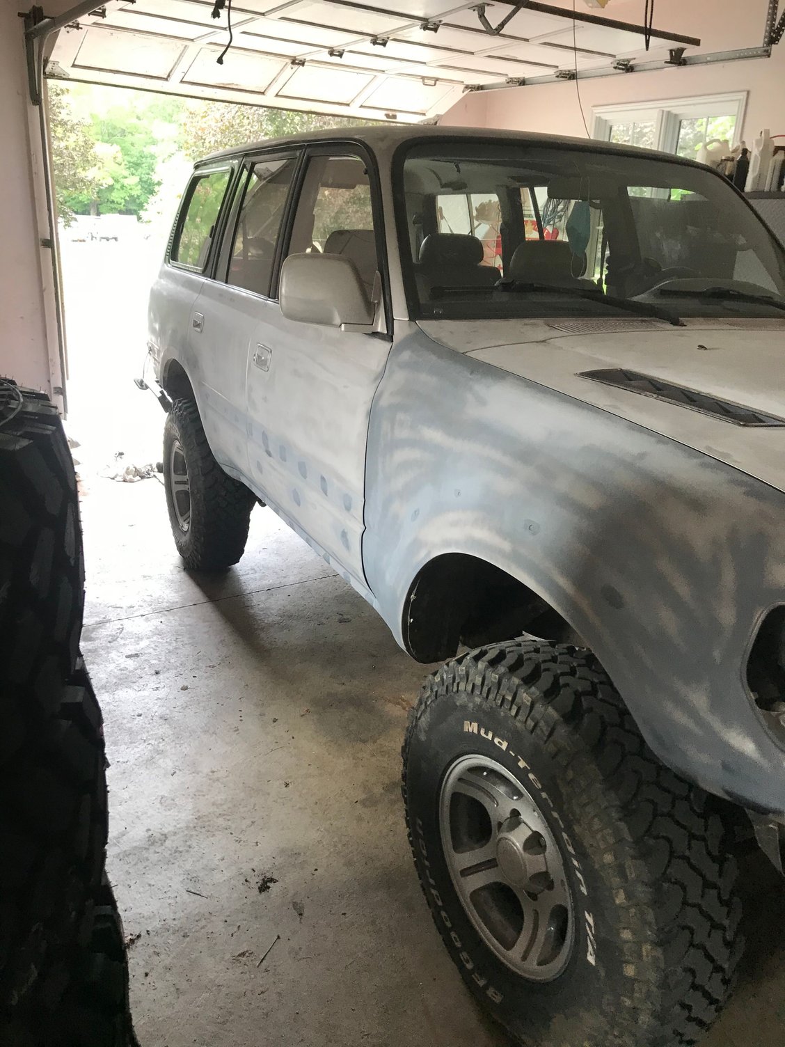

130 holes filled, primed and ready for...
Bedliner.
Final product

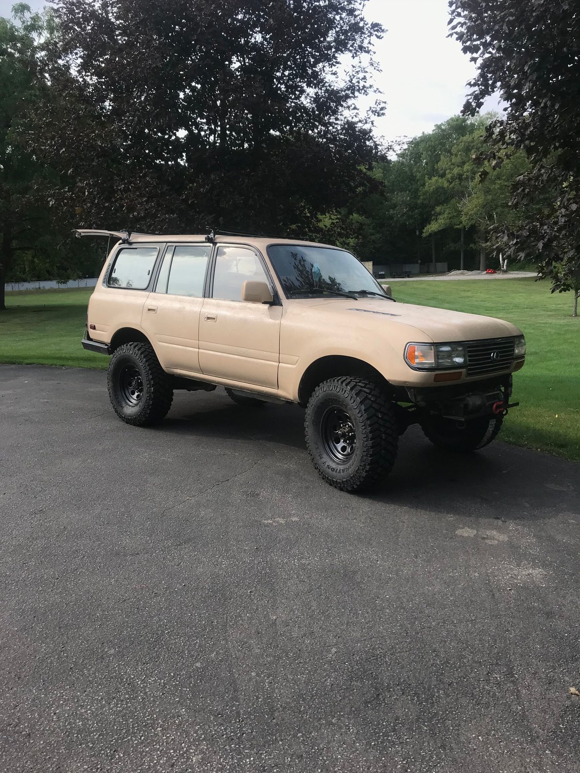

Updates.

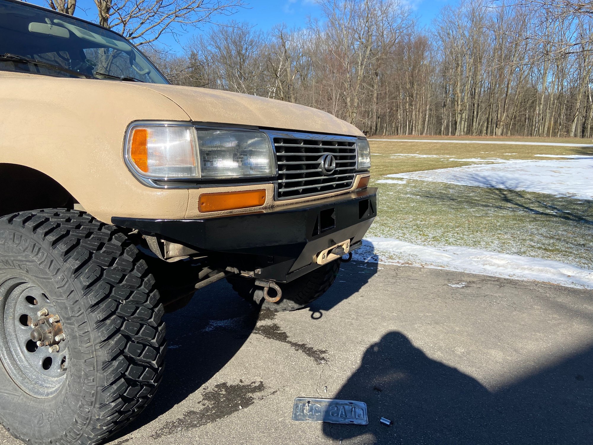

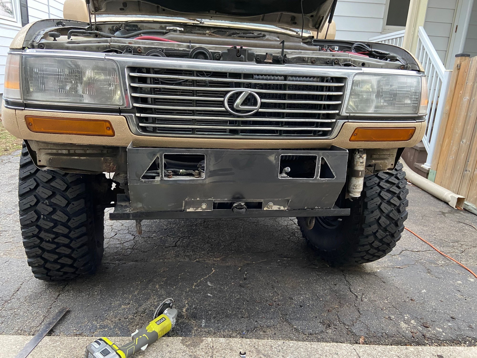

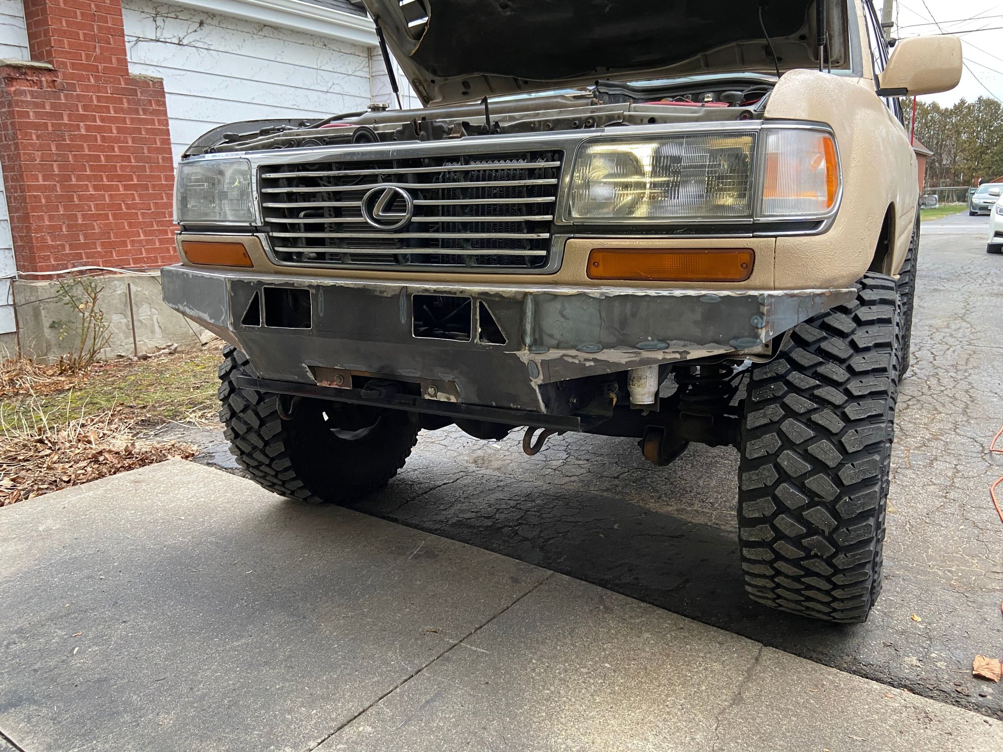

I’ve never built my own front bumper so I got a plasma cutter and made a project out of it for lockdown. I’m happy with how it turned out!
