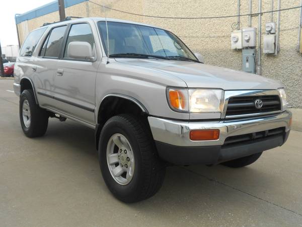

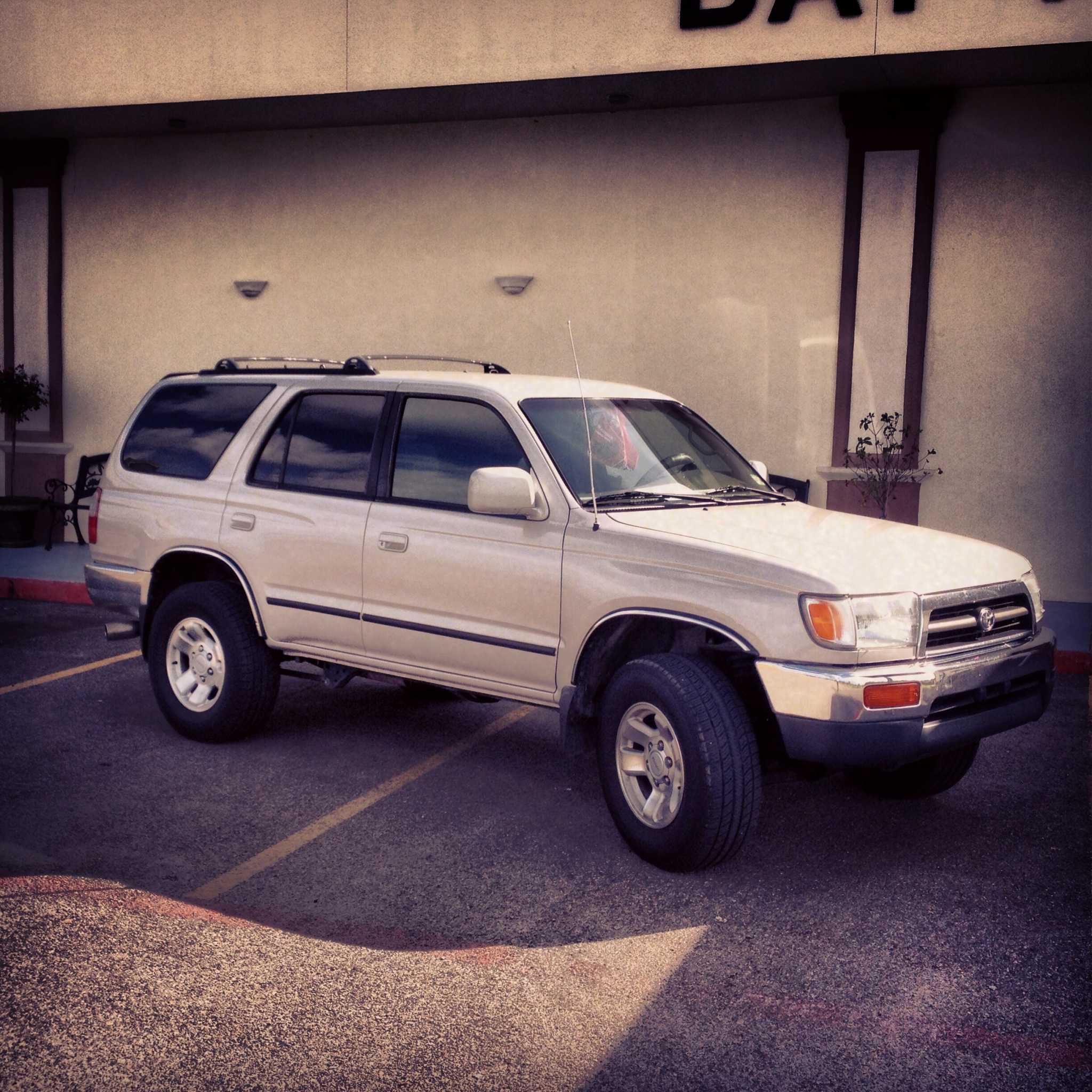

This is the new rig... She' a 96 SR5 4x4 5 MT. My plans for her are unknown at this point, usually this is how the best builds start... lol... However.
First I believe I'm going to do the Tundra Brake conversion, However, for the size wheels and Tires I want, I need about 2 inches of room. I was thinking I could convert to the 99 Tall Springs, with the Bilsteins, If anyone can offer any pointer's they would be greatly appreciated.
Secondly, she has about 200K on the clock, and a few stuck valves, I've actually bought a JDM 3.4 with about 50K, and its sitting in my garage until I find the time, and the help to replace the motor. In the meantime, I'm driving this one until it blows up.
Thirdly.... Cosmetics, I'm going to do the Satoshi Grill at some point. I haven't quite decided on what to do with the front bumper, I believe I'll more than likely end up with a bull bar, with the PIAA lights. I also would like a roof rack, and a rear bumper guard.
This is going to be a work in progress, and I'm a mortician (so the job takes up alot of my time, and the woman takes up just as much time as the job) so that leaves little time for the projects... However, like with anything else, I'll get there if it takes a year... or 5 years... Any advice is appreciated, Looking forward to many years of wheeling....https://www.yotatech.com/forums/imag...es/theking.gif

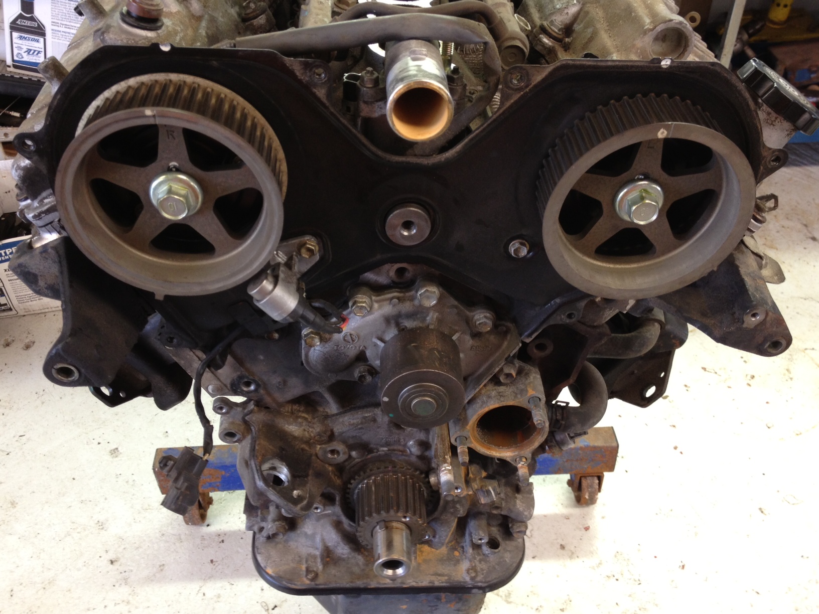

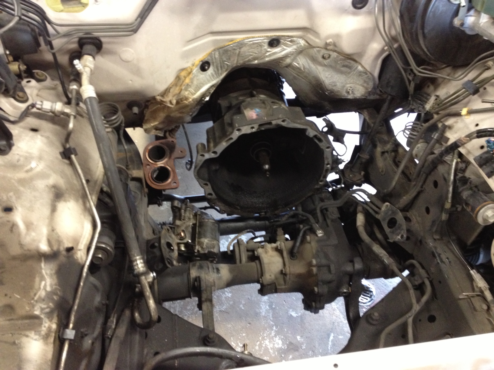

Well after almost 2 weeks of waiting, and about $3500 bucks, the new motor is in... I am just waiting on one more injector, and it will be back on the road again.... See Picture Below....
The First on is my empty engine bay...
The Second is the Old Motor... In all of its leaking Glory....
The Third is the replacement....
Attached Thumbnails Smitty's 96 Build Up, Advise needed and appreciated.-image-1-.jpeg   Smitty's 96 Build Up, Advise needed and appreciated.-image-4-.jpeg   Smitty's 96 Build Up, Advise needed and appreciated.-image-5-.jpeg

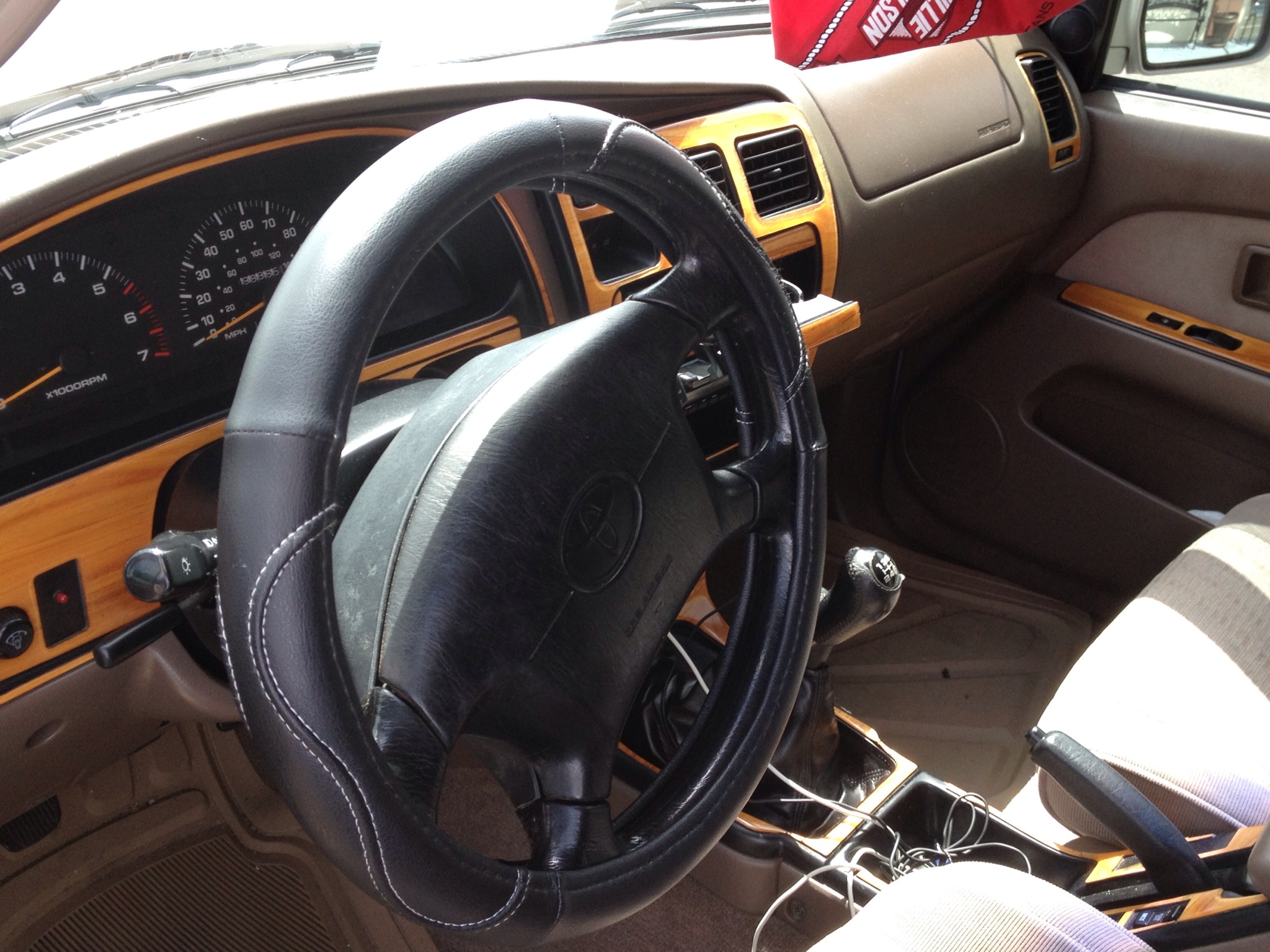

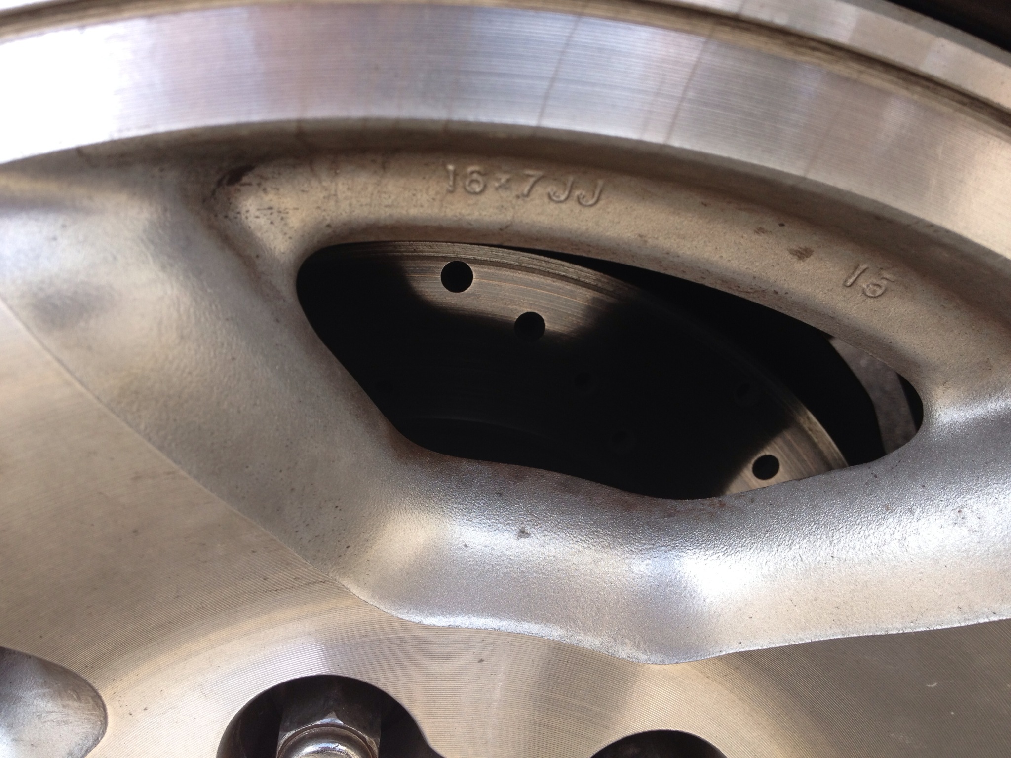

Window Tint, Steering Wheel, and New Brakes.
Yesterday, I had the windows tinted... the Texas State law is 35% on the front, dark as you want in the back ... so naturally I did limo tint...
Also, I replaced my steering wheel with one from a 98 4Runner.... Now If I could just get rid of the previous owners fake wood dash trim...
And I also added a picture of the crossdrilled rotors I installed, I ran out of day light so I couldn't take pics of me doing the work...

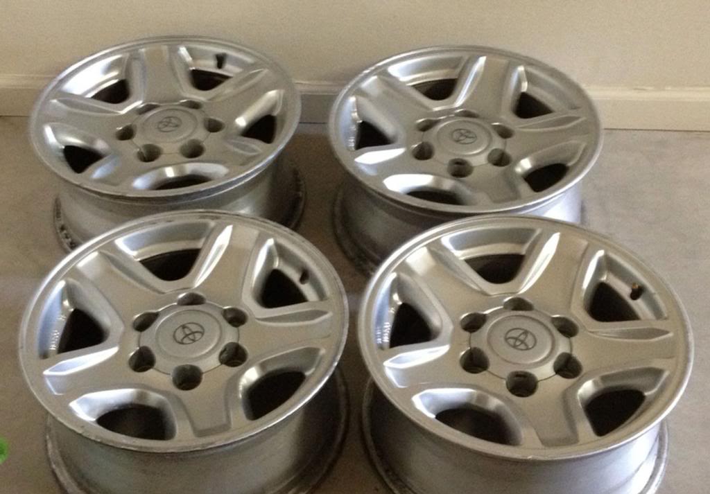

So I haven't done much but drive the 4Runner for the past few weeks however, I have been lurking through the classifieds, like a hawk looking for his next meal and I was able to find these....
I picked them up for $140, and I am having them powder coated dark grey, I'm sure I'll have plenty of pictures to post once I get them mounted with new tires... I am considering running Bridgestone Dueler A/T 265-75-16's, Any thoughts?
