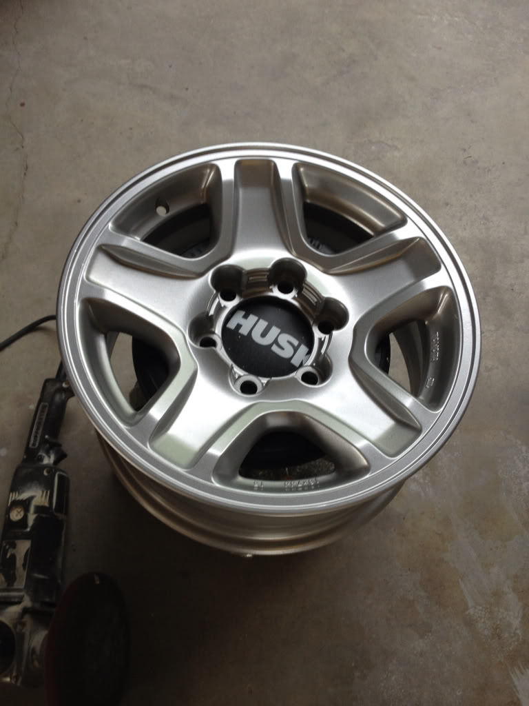

Wheels are powder coated... Will have paint for the center caps tomorrow...

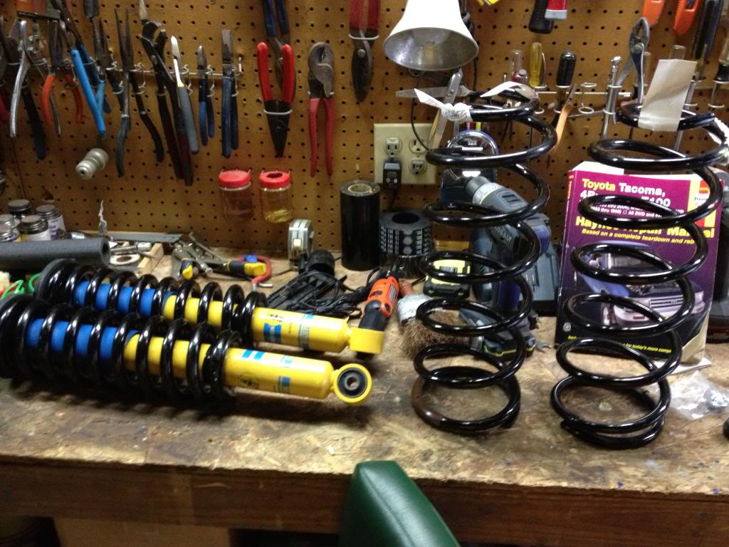

Well I got in a little wrench time yesterday, and everything turned out nothing short of amazing. I ended up going with the Bilstein 4600's with the 99 "Tall" Springs. I also replaced the LBJ's while I had it taken apart. I noticed that my rear passenger side axle seal was leaking, I will have that addressed this afternoon when I have the front end aligned.
Here is a shot of all the goodies before installation.

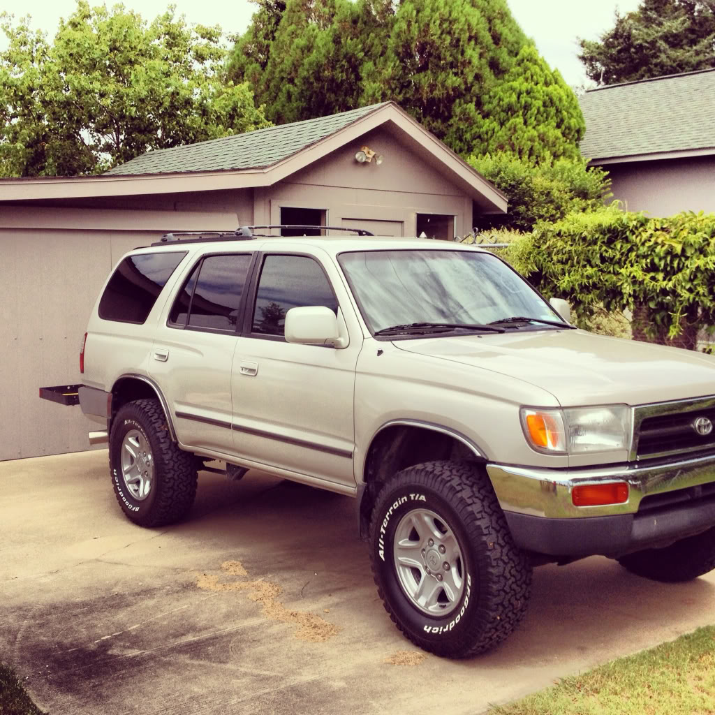

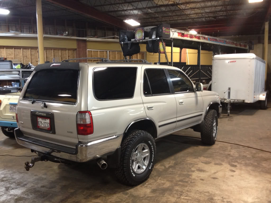

And here is a before picture
[IMG][/IMG]
And an After with my buddy Brice's 4Runner
[IMG][/IMG]
And Right before Happy Tire Monday
[IMG][/IMG]

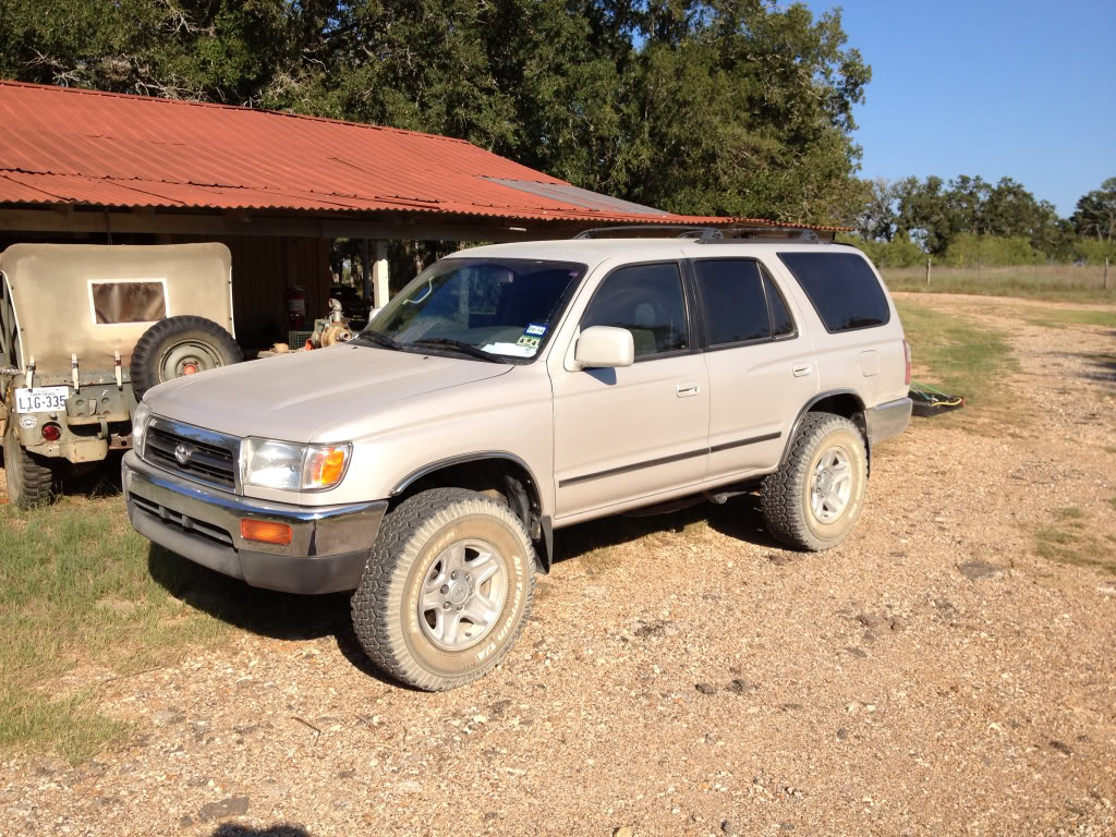

And the Finished Product... Running BFG All Terrain TA/KO 265/75R16's
[IMG][/IMG]

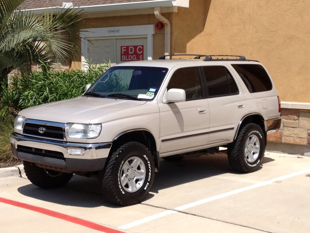

So after driving it with the new springs shocks and tires... the verdict is, it rides great... I actually ended up getting a little more lift than I had expected. The front Height from Ground to wheel well:
Before: 33.5"
After: 35.5
The Rear Height from Ground to wheel well:
Before: 34.25
After: 36.5
Since the 4runner is mostly my daily driver, this is the perfect height. I am very pleased. Now next stop figure out whats going on with the 4 wheel drive system, Audio, roof rack, and then... bumpers, and possibly another 4Runner... Stay Tuned folks...

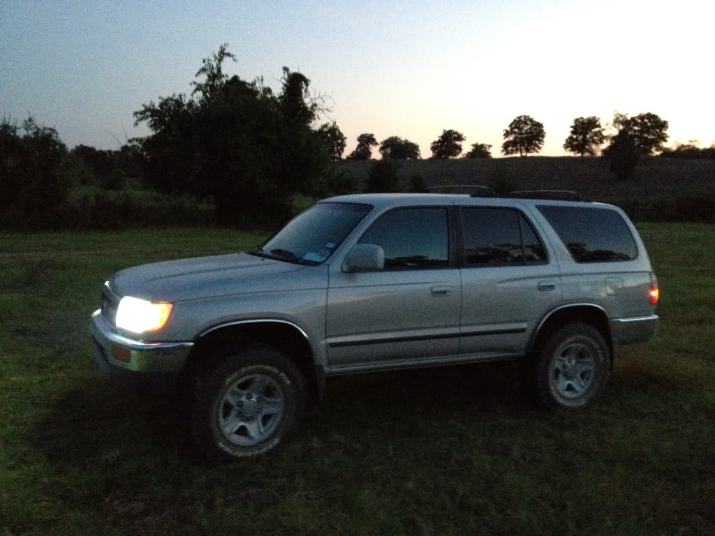

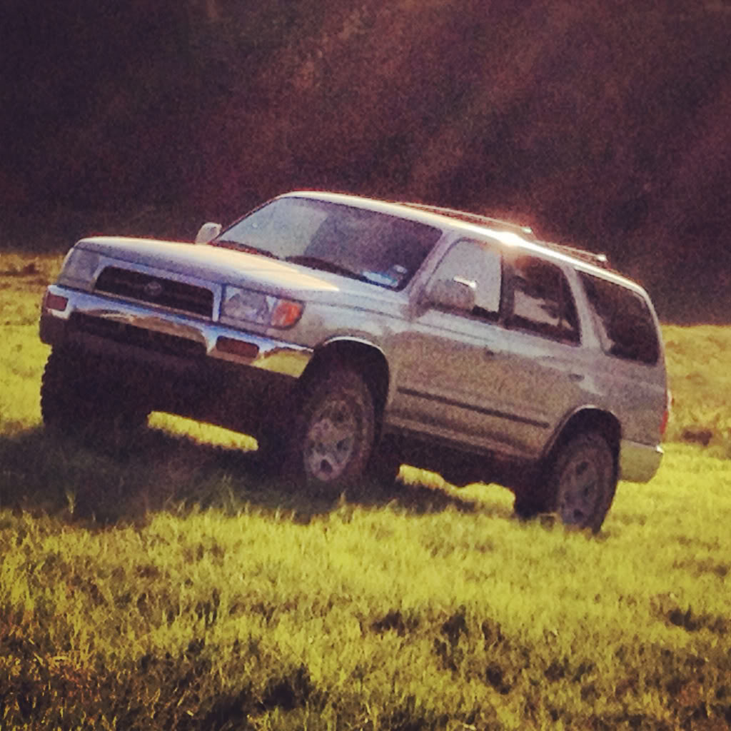

So the axle seal wasn't as easy as it sounds... However it is fixed, also the 4 wheel drive issue ended up being a bad wire replaced that, and it worked like a charm. Drove the truck 3 hours up to the farm, and 3 hours back... Ran like a dream, was able to snap a few photos from the journey, and I even did a little wheeling...

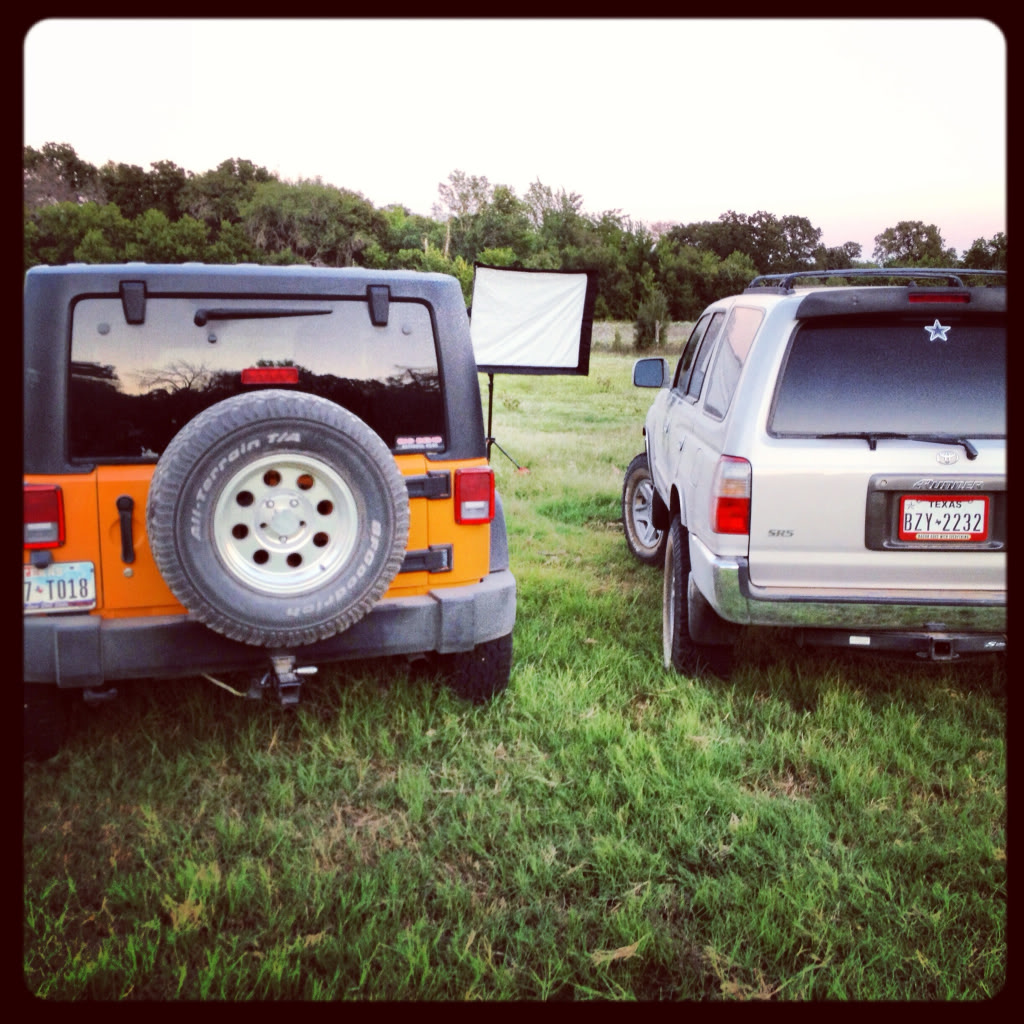

Photo shoot with my buddies Wrangler

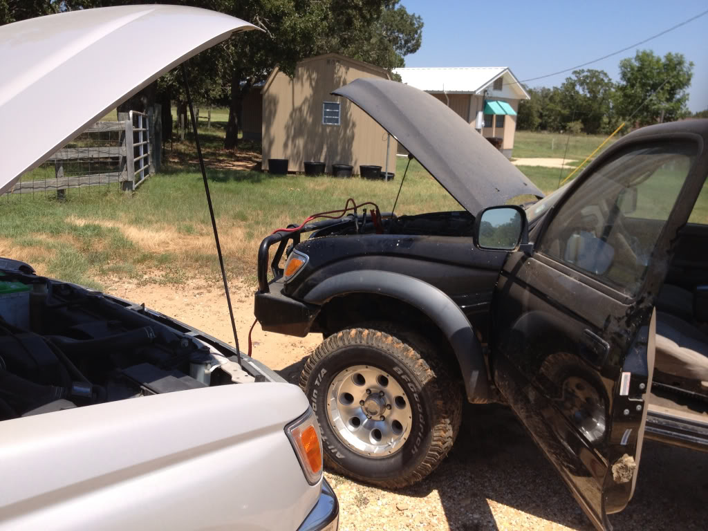

Rescuing the Tacoma

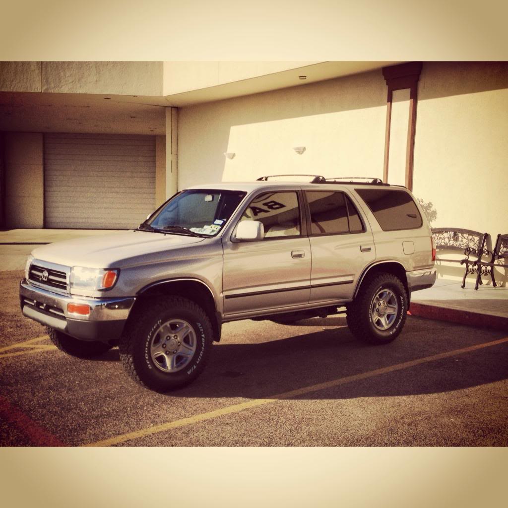

And after a little wash and wax action, and I finally got around to replacing those corner lenses....
So Roof Basket? Or No Basket.... To be determined....
