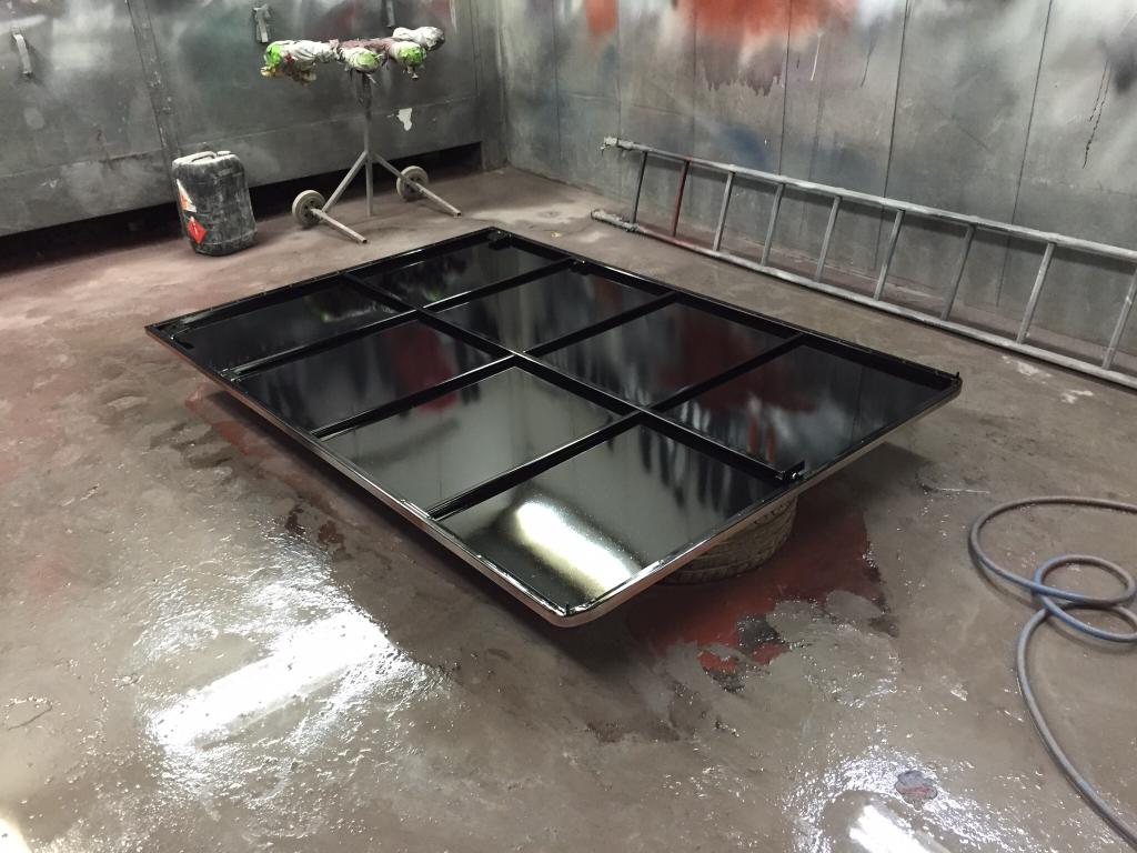

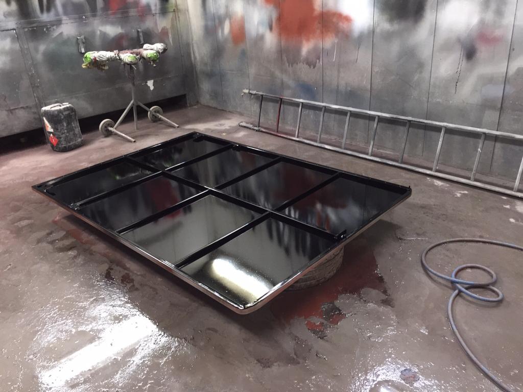

The lid was being painted when I left, and 2 coats of gloss black were applied to the underside, after 2 coats of zinc primer were laid down. The outer side has been in primer prior to today, so all covered. The outer side will be painted in a Kawasaki Green a Pearl on Monday.

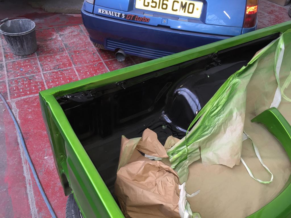

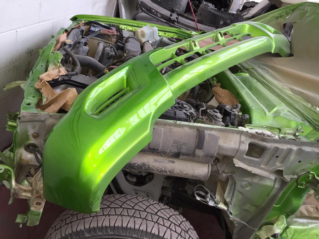

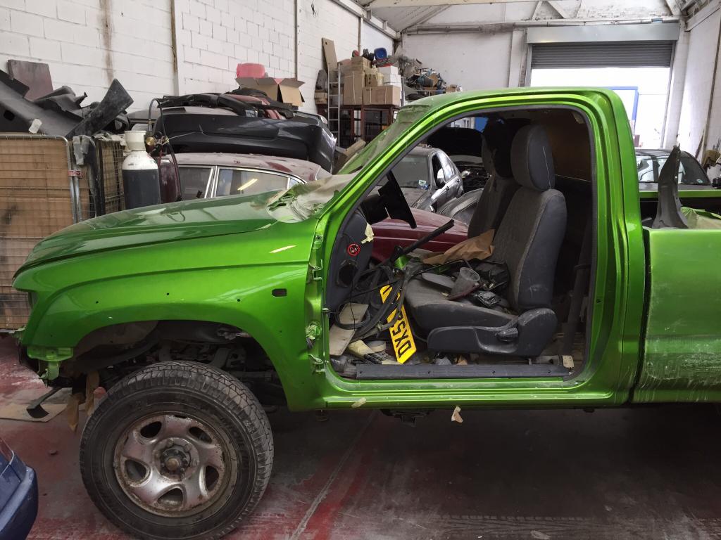

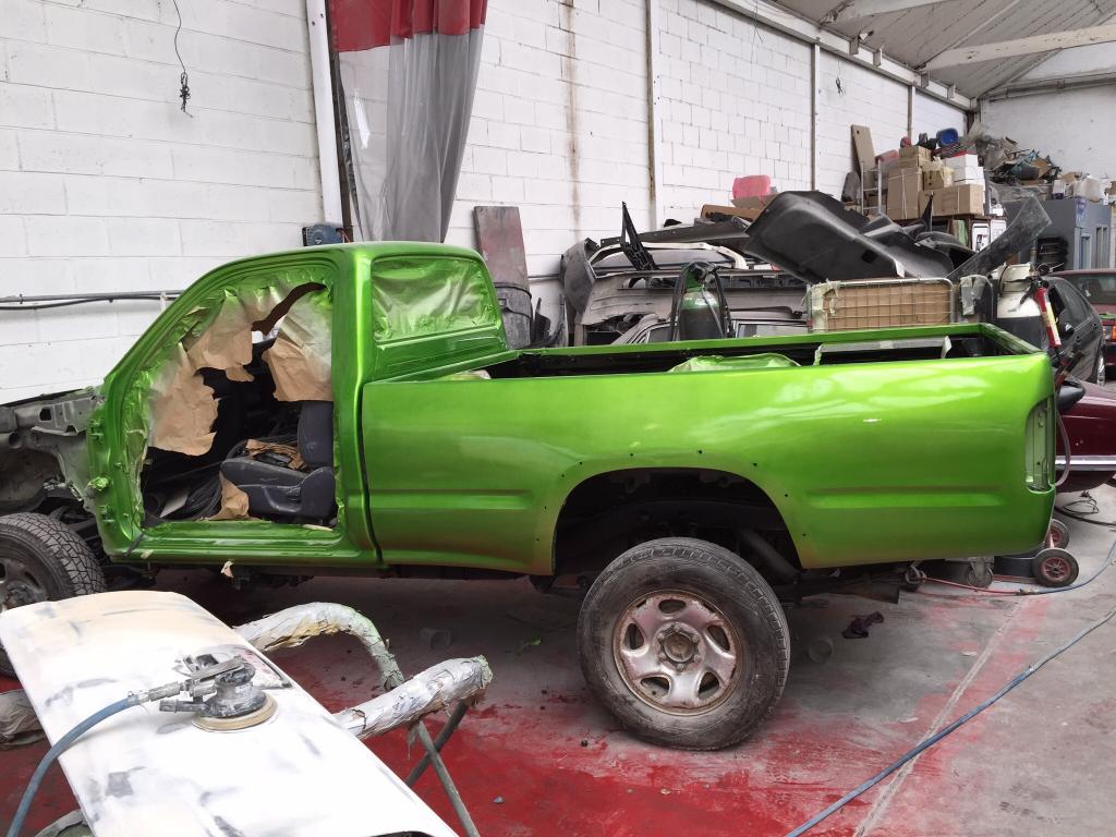

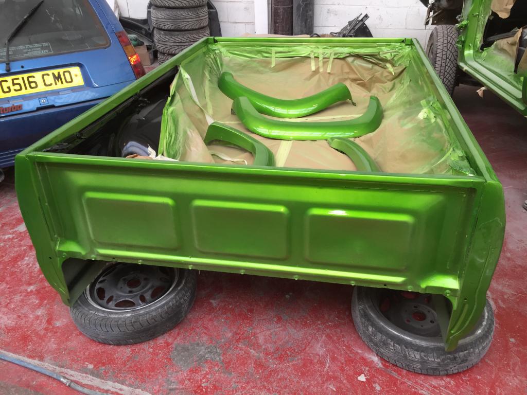

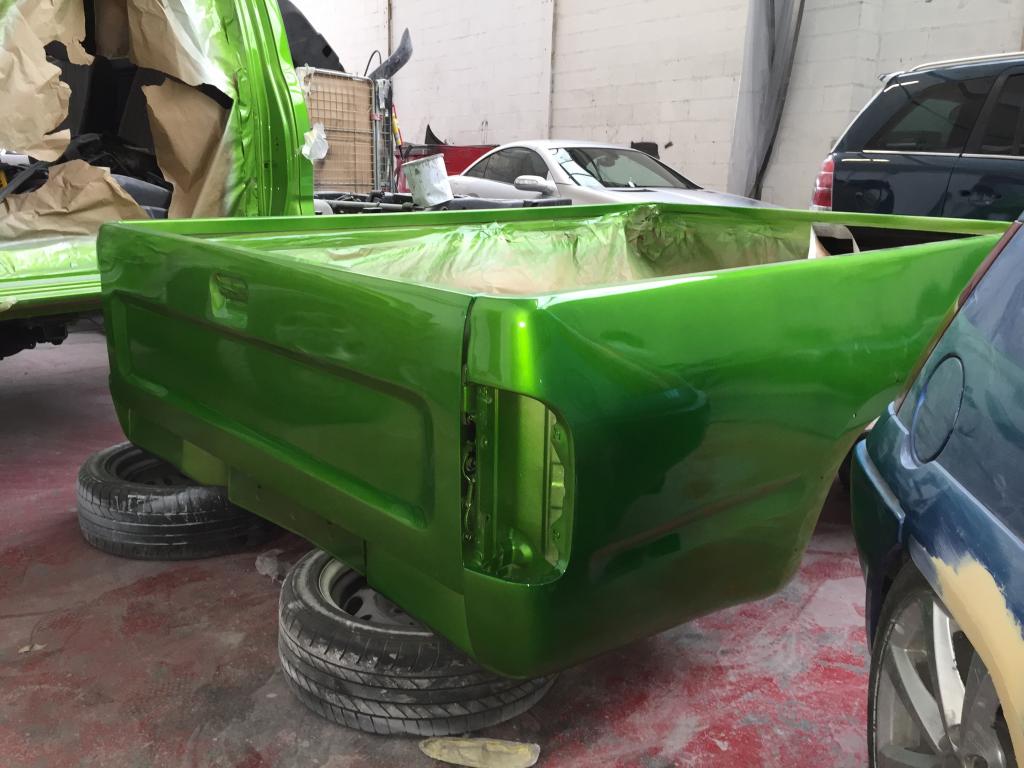

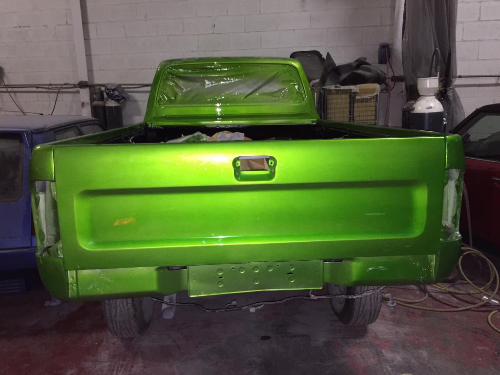

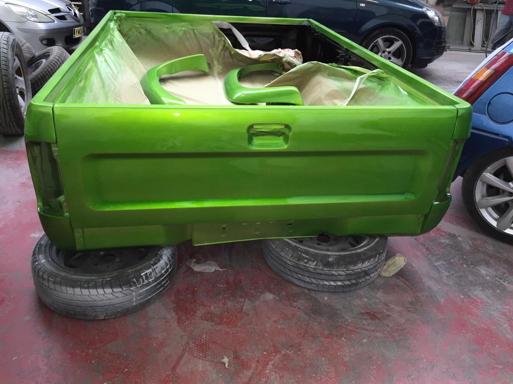

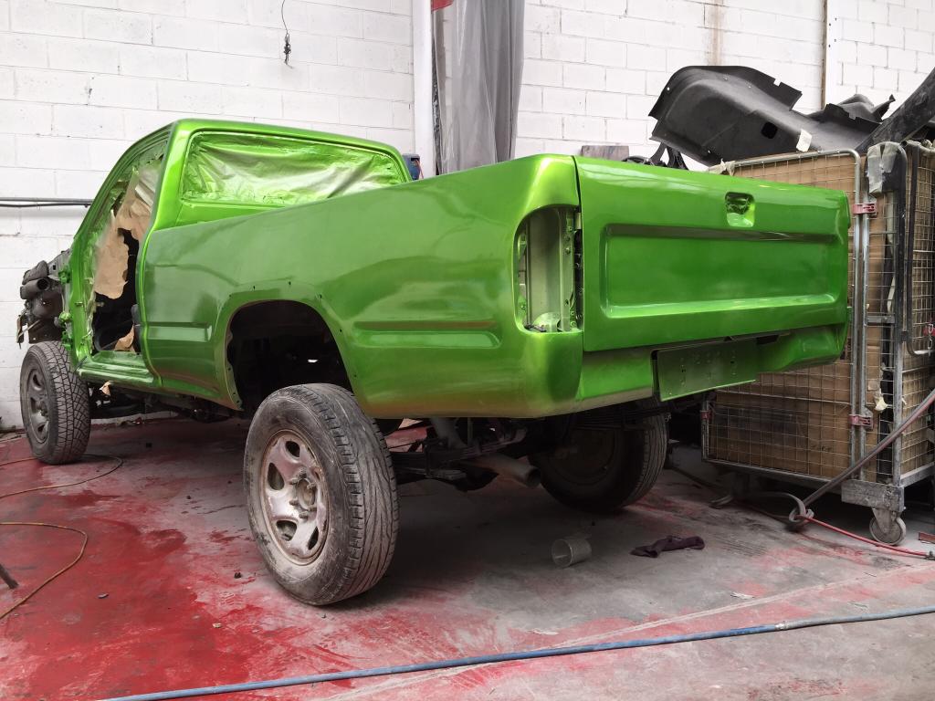

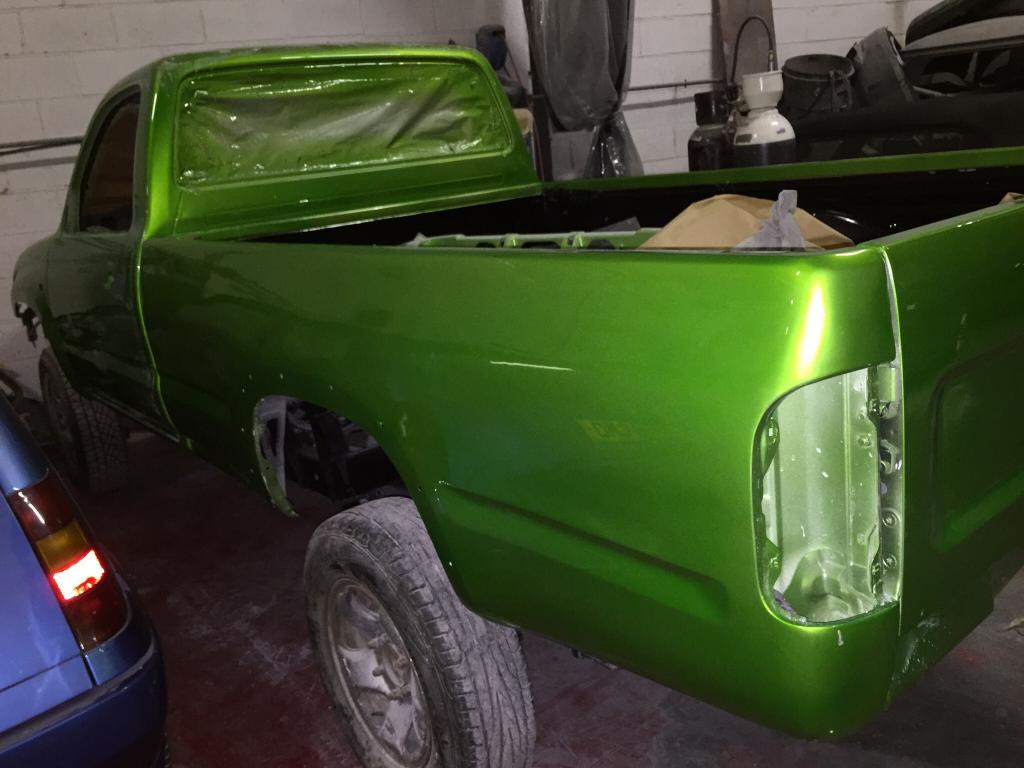

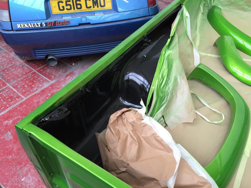

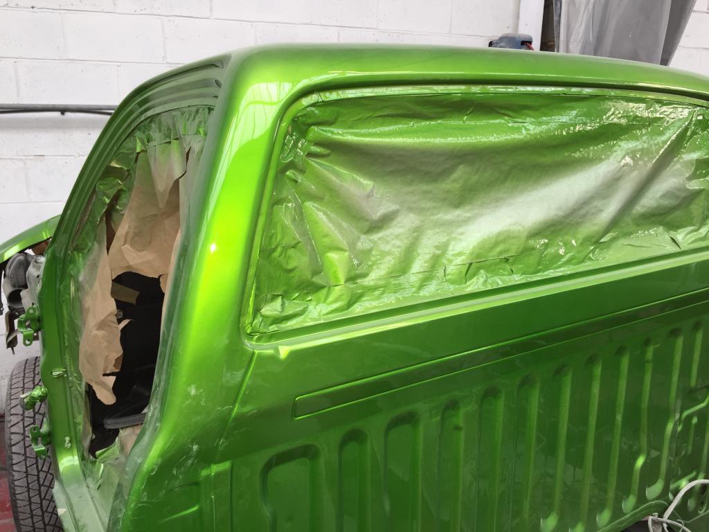

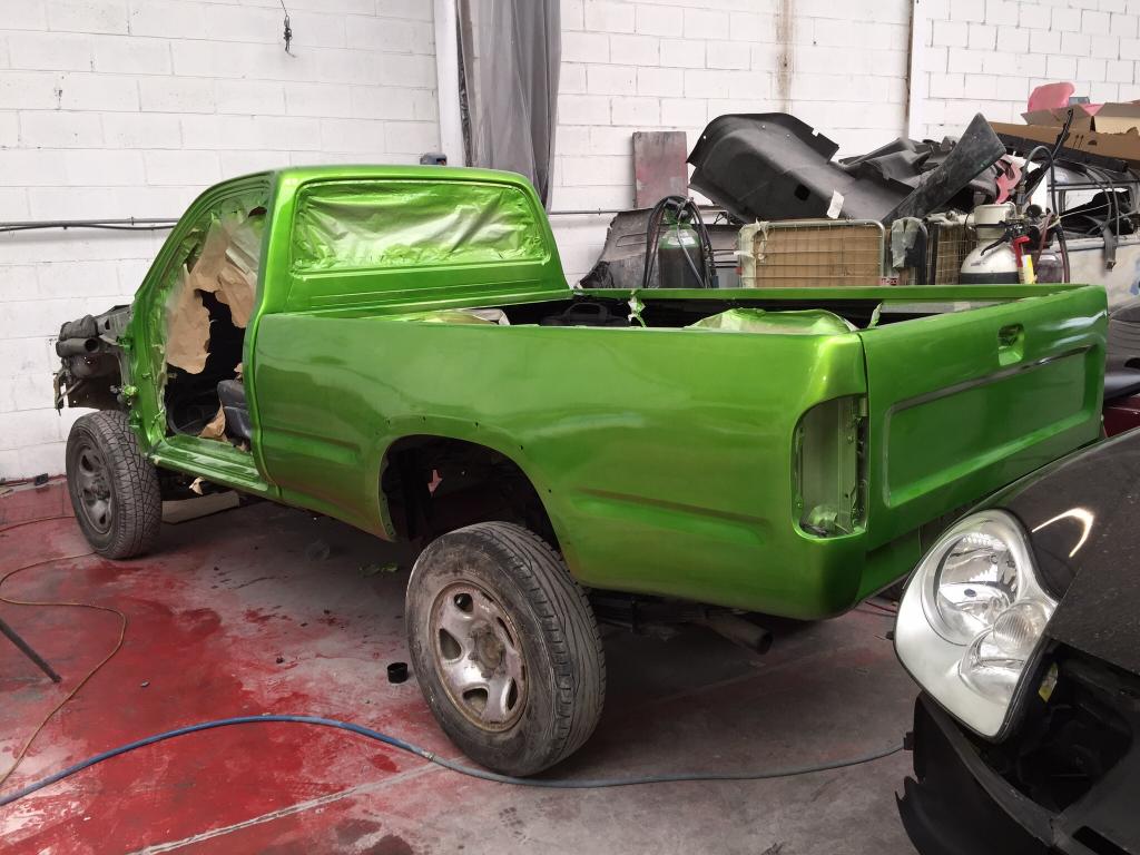

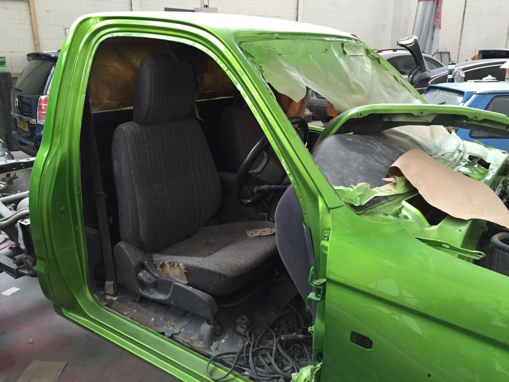

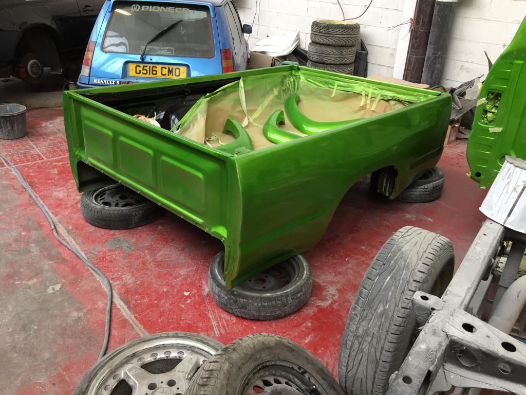

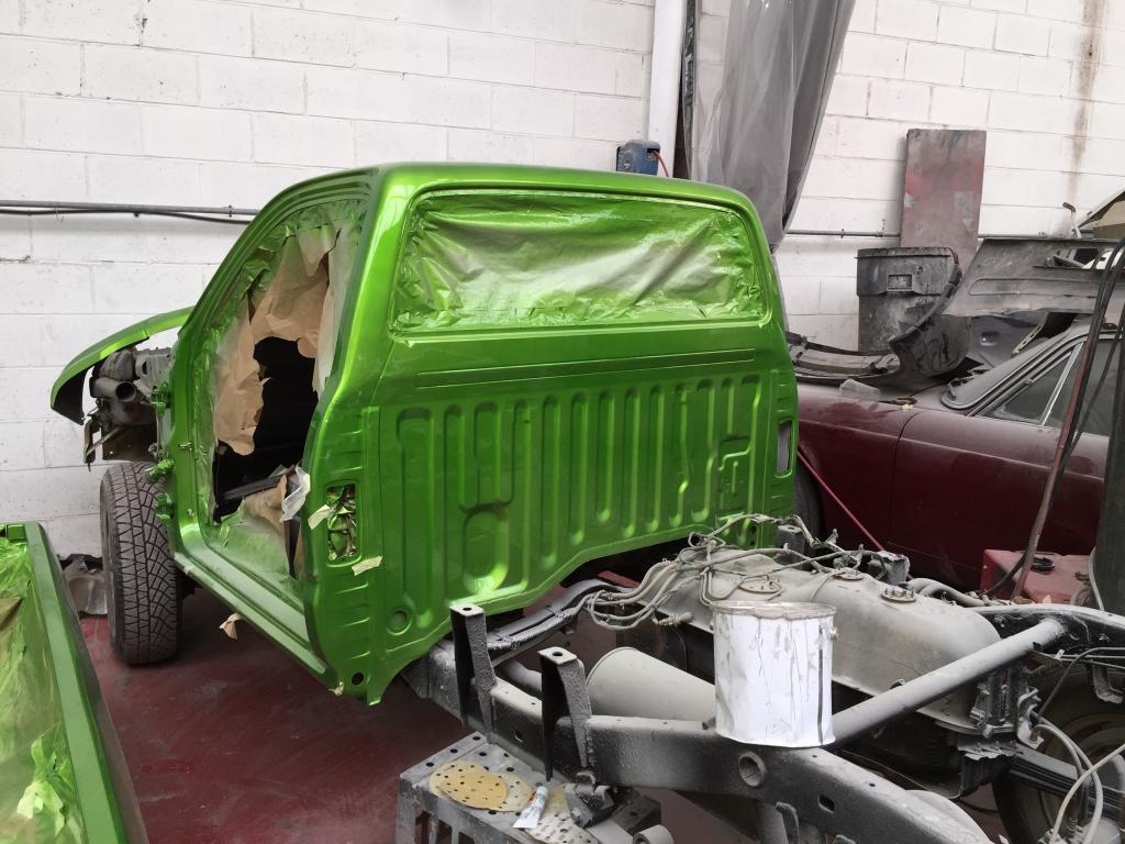

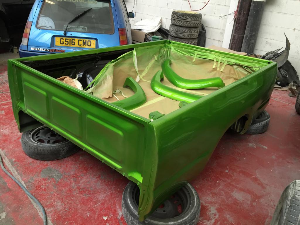

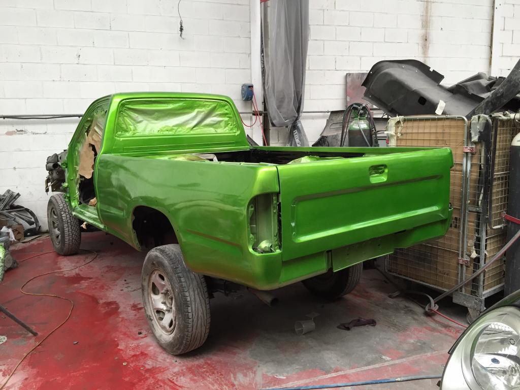

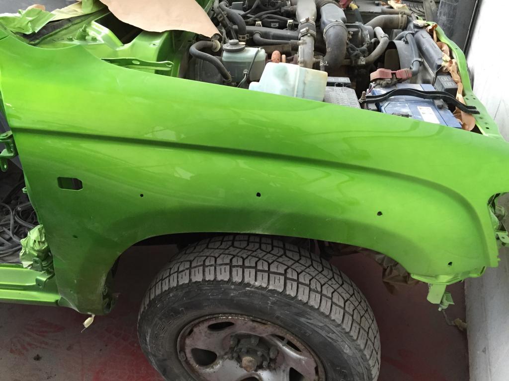

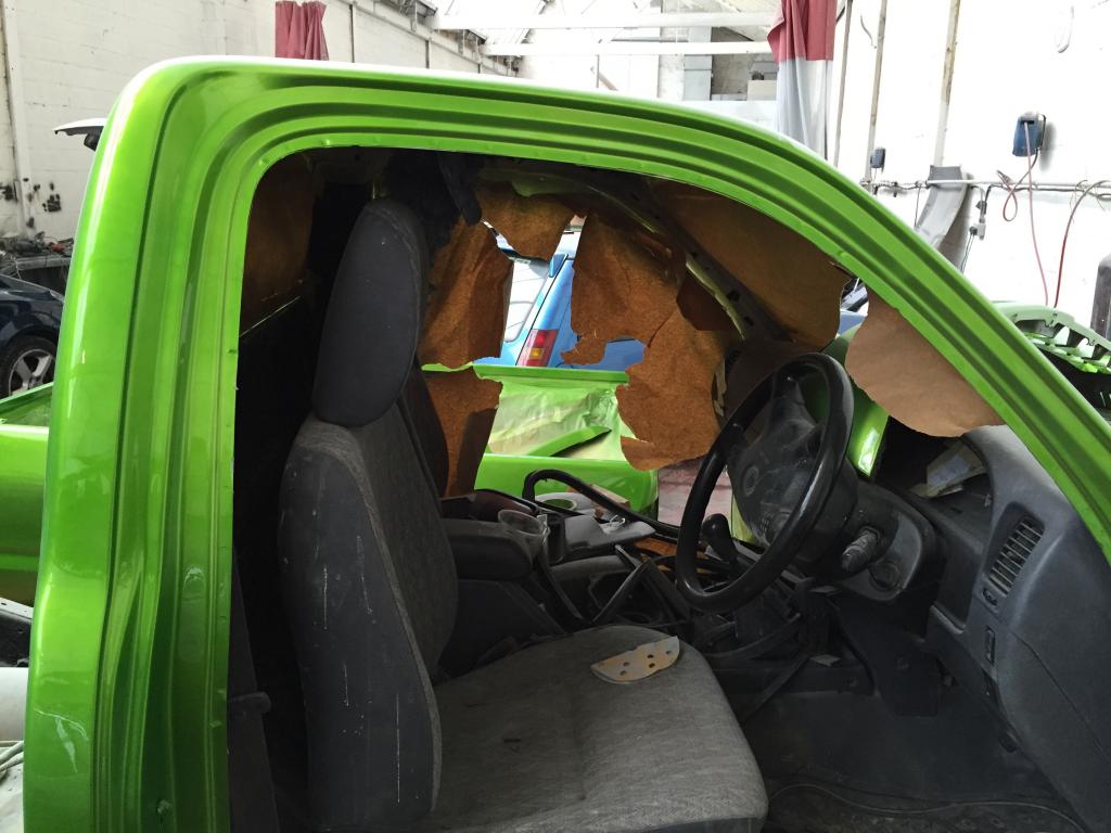

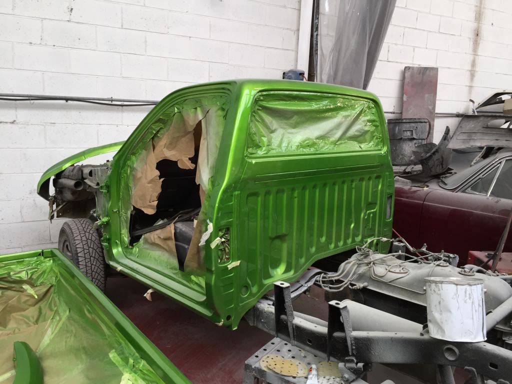

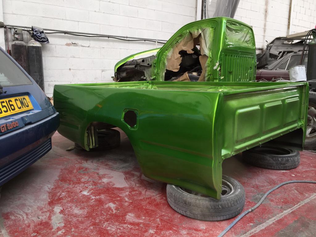

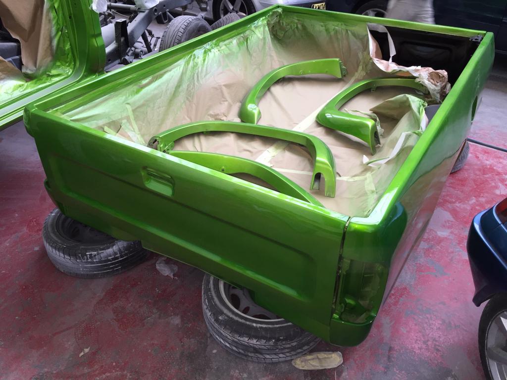

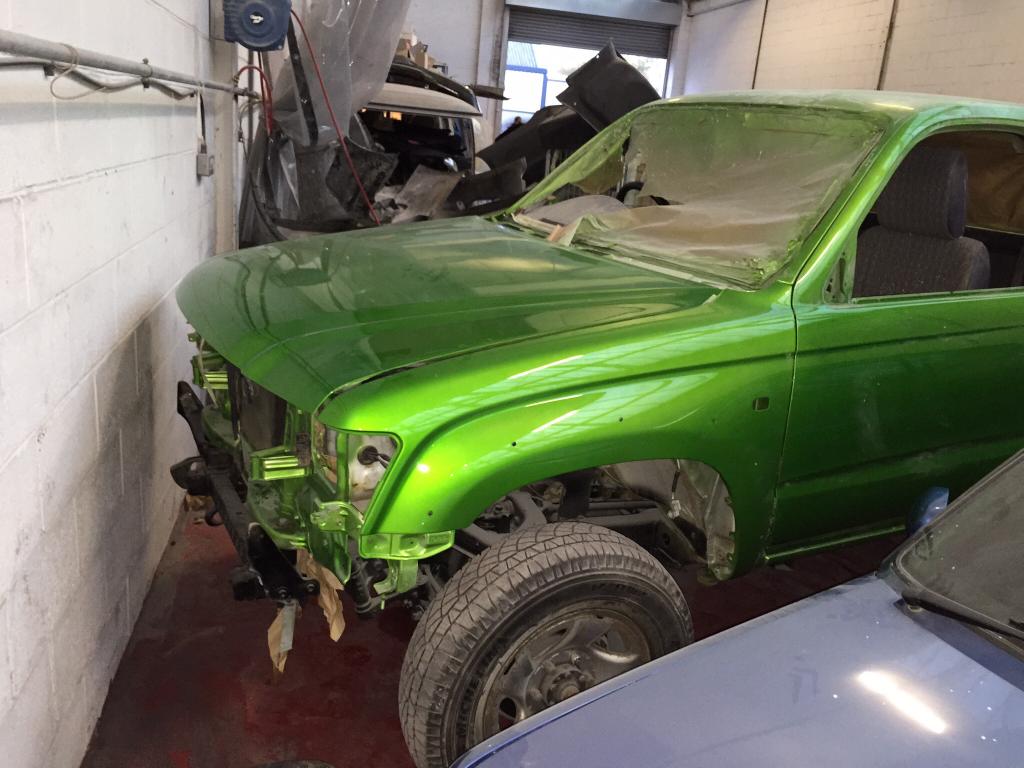

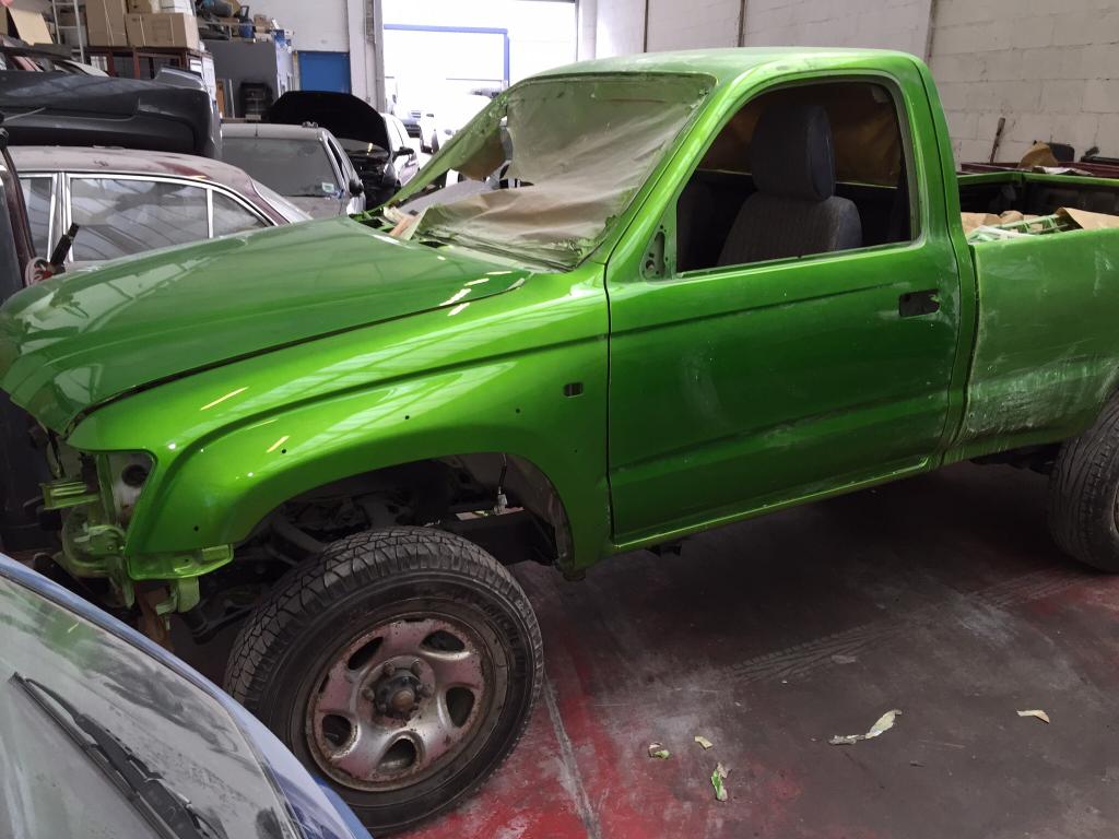

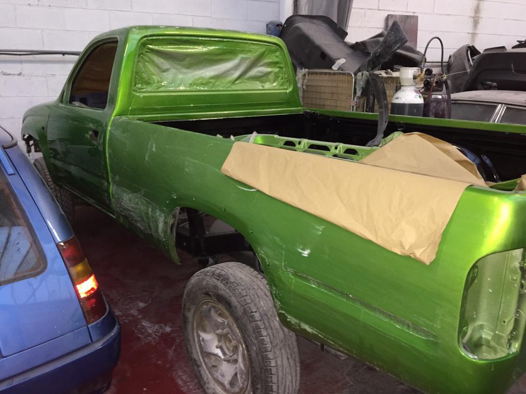

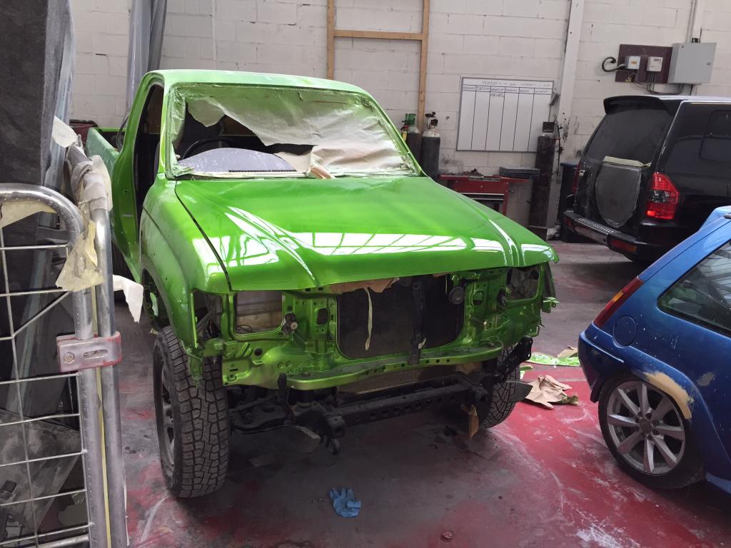

I've been a bit quiet on my Hilux project thread lately. Due in part to family joint projects (involving bricks and mortar) and just plain old work commitments. And also because with the first "bodyshop's" flop, I didn't want to tempt fate.
I got a call from the shop this morning, around 09:35 hrs, informing me they were going to paint today, and did I want to pop round? You bet I did! They were also gracious enough to allow me to view proceedings in the spray booth / oven.
This is the order in which things went:
Remove paint applied by first "shop".
Flat down original Toyota Hilux White.
Apply barrier coat to truck.
Prime truck.
These were done before Christmas, today things went this way:
Applied covering coat of aluminium silver.
Light flat down with 800 grade pads.
2 coats of Kawasaki Green Pearl Silver basecoat.
3 coats of Kawasaki Green Pearl topcoat.
2 coats of 2K clear lacquer.
Unlike the first shop, every part was painted at the same time. The fender flares were suspended from the mounting holes by wire, the front valence was suspended from the truck in the same way, and the 3 metal strips under the headlamps and grille were temporarily fitted.
I opted to have the original grille painted. This was just the grey section, painted in the same colour as the rest of the truck. The black sections had previously been refreshed in satin black.
The bed is just sitting on the chassis, moved backwards enough to paint between it and the cabin. The lid is being painted on Monday. This shop does NOT flat final paint coats, they simply give it a light double pass with a pad, then a good mop. I'm getting the windscreen guys out in the week, to fit a new front screen. The old one had a couple of chips in it.
I will be putting the truck back together next Saturday, and then driving her home. Next will be wheels.
Lots of pictures being uploaded. They are courtesy of my iPhone 6, so my apologies for the non high resolution quality.
