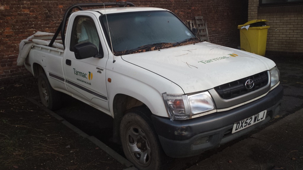

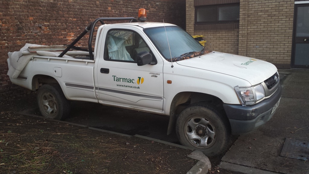

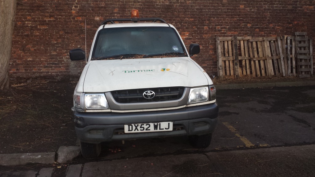

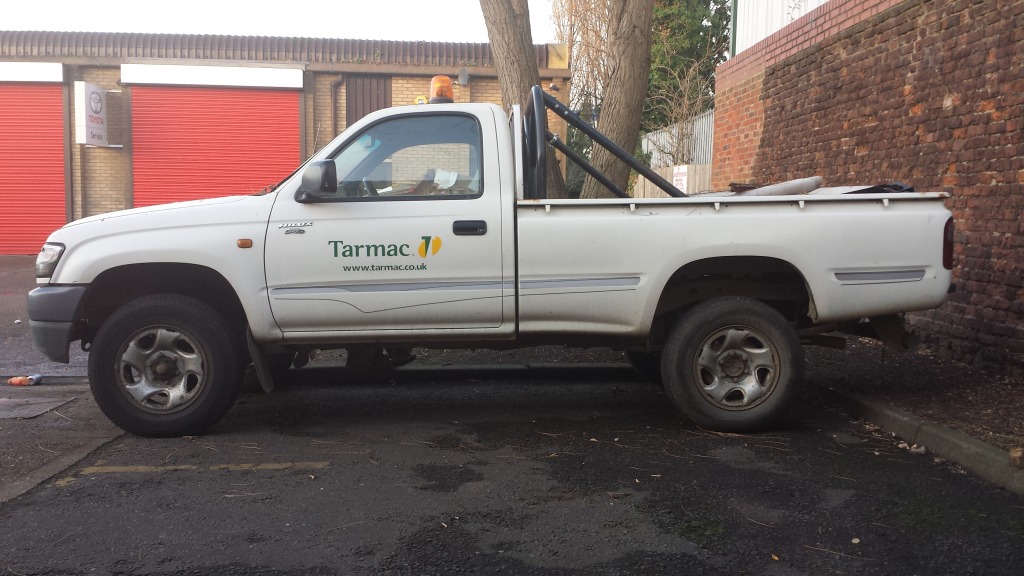

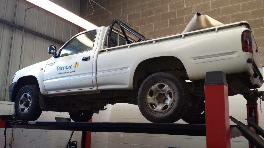

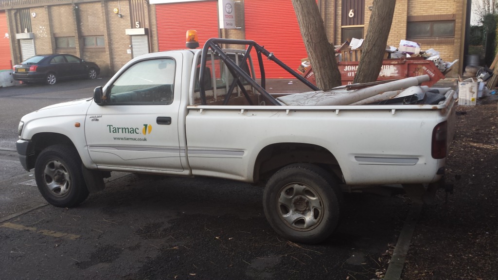

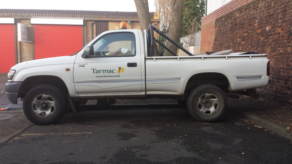

It was towed into my dealership with a bust rear driveshaft coupling, a defective heater, seized parking brake cable, ripped front axle outer joint bellows, and a host of other minor issues.
I looked it over, asked my boss what was going to happen to it. It belonged to a construction firm, that had branches all over the UK. The truck had 251,000 miles on the odometer, but was structurally sound. As the driveshaft had been pulled, I engaged AWD, and fired her up. The engine ran great, even after being standing for over a year.

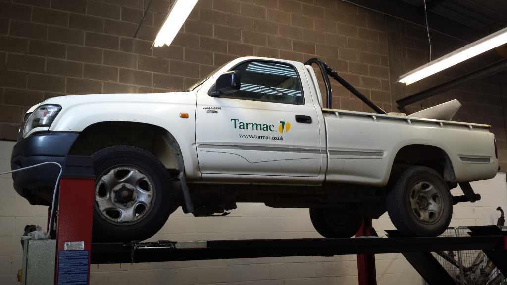

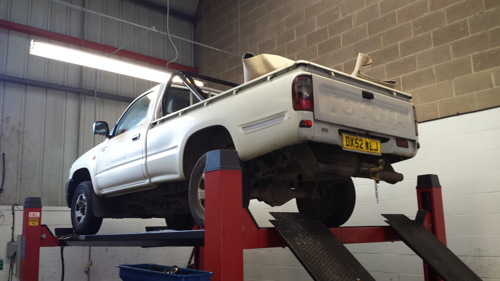

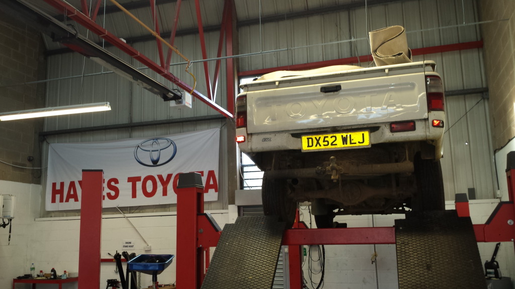

I drove her onto a vehicle hoist, and did a thorough inspection. A bit of surface rust, but otherwise in great shape.
The plan? What else other than a full build, and a 3UZ-FE bolted in front of the manual tranny! This was of course, subject to me getting hold of the truck.
Several phone calls and emails later, spanning 6 weeks, and the truck was mine, for the sum of $670. I was over the moon, what a steal!

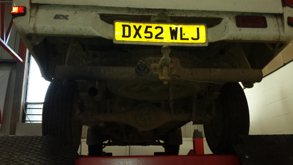

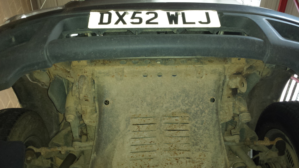

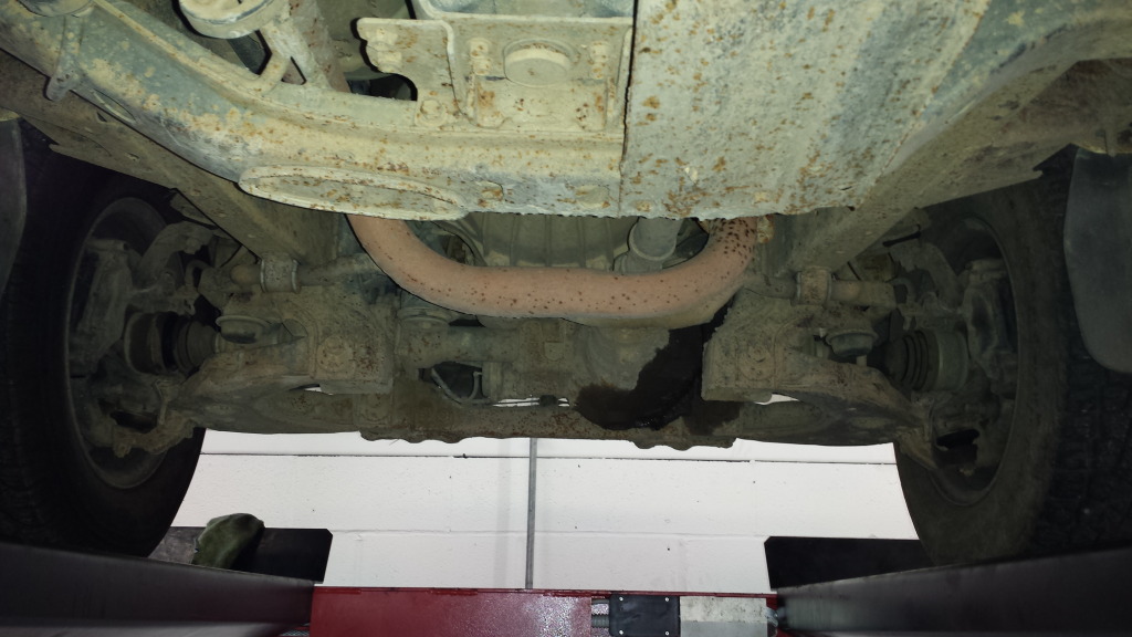

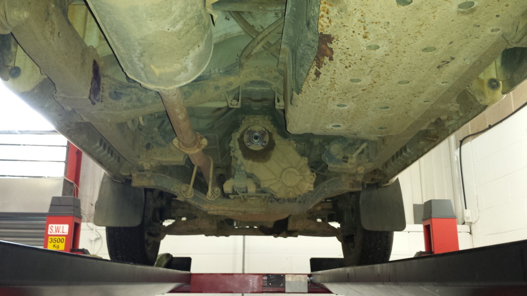

I put my truck on a lift, so I could assess what exactly is needed. Right now, the propshaft is bad, it's off the truck, so she can only drive if AWD is engaged. Meaning it's currently FWD.
Some pictures - note the brown stuff underneath is not rust, it's dried mud. The company she previously belonged to used her extensively off road.
All in, I'm pleased with the general condition. The bodywork is pretty solid. Not bad for a Toyota truck with over a quarter of a million miles on the odometer! 8)

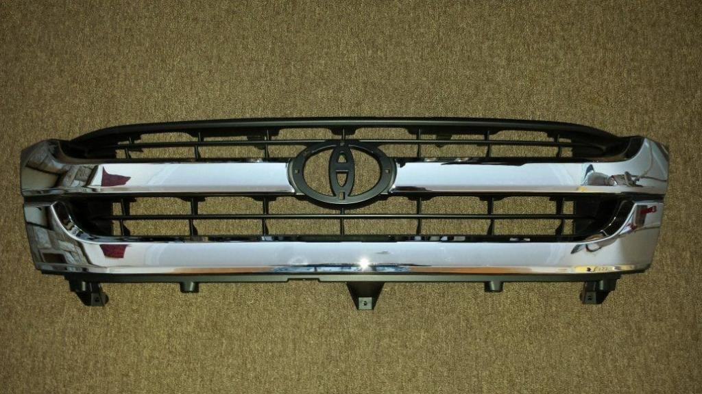

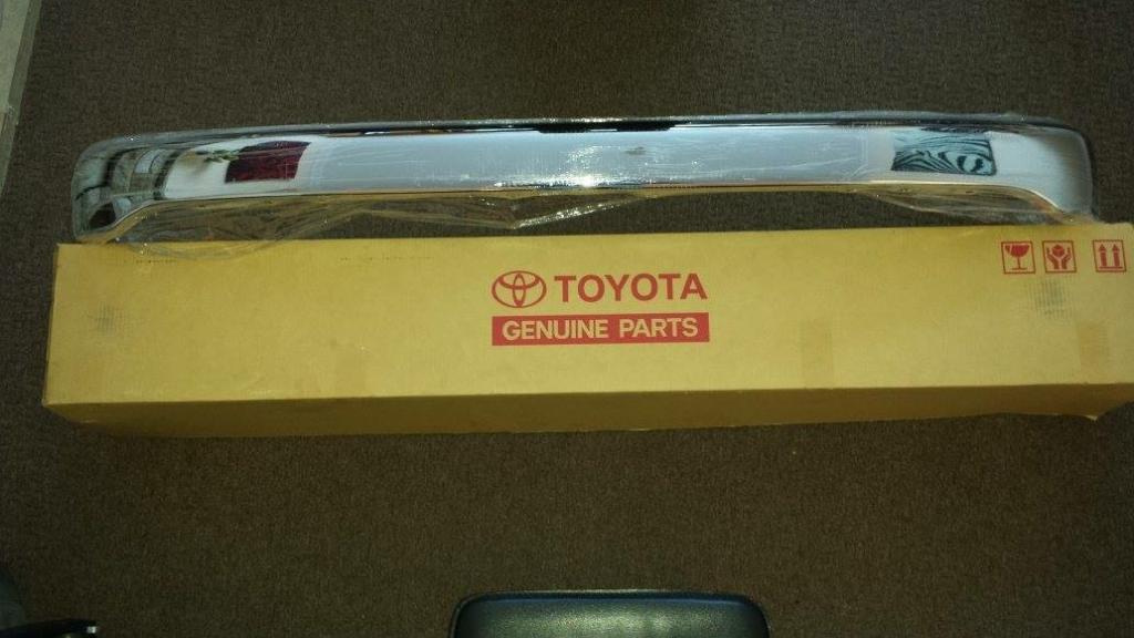

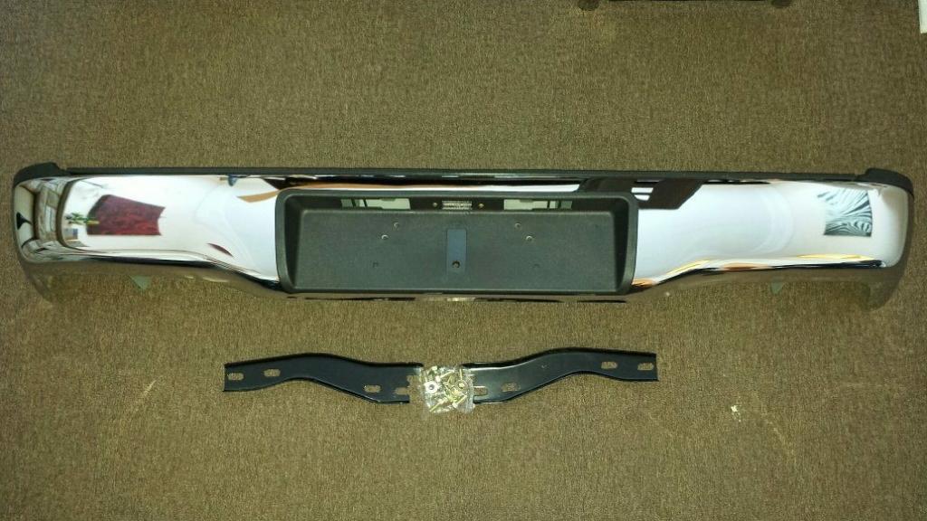

I opted to purchase the chrome rear bumper for the 2012 Toyota Hilux / Vigo, and modify it to fit. I also purchased the correct front bumper for my own truck, which has the model code KDN165, but in chrome too. Both front combined side lamps and indicators had seen better days, so I purchased a new set, as well as a replacement front grille, in chrome. I picked all these parts at ridiculously cheap prices. Working for Toyota has it's perks.

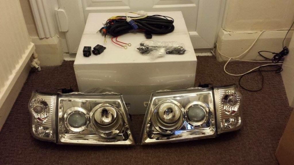

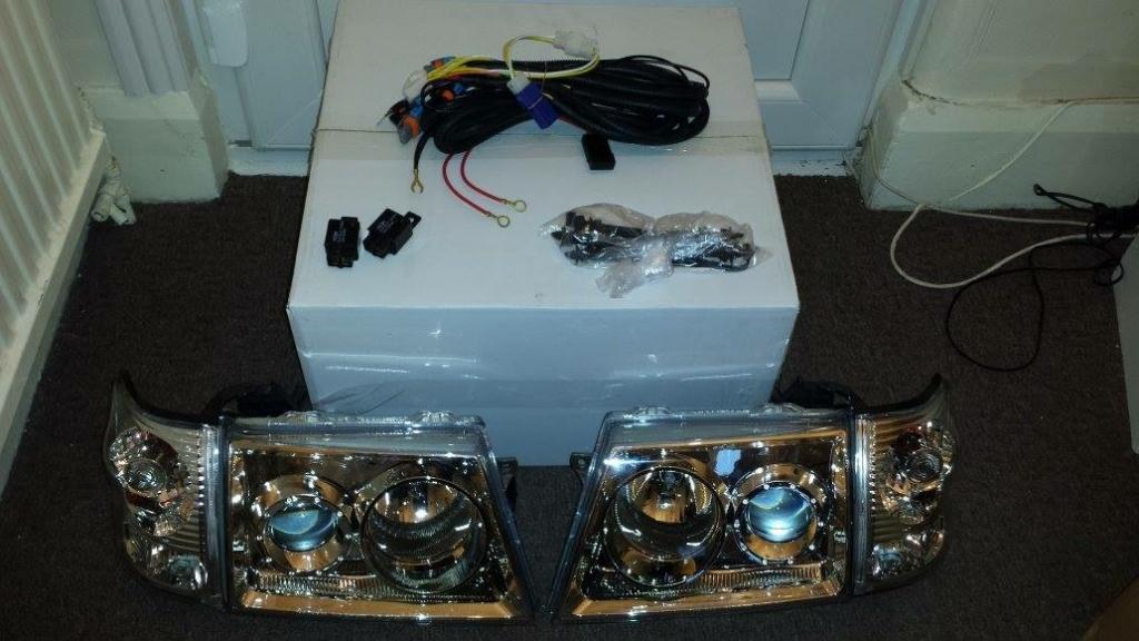

I got home from work today, to find a package had arrived for me, via DHL. I opened it up, to find my projector headlamps, and matching crystal indicators / side lamps. It's quite well made too, with a built wiring harness and a pair of relays, making the headlamps plug 'n play in my Hilux.

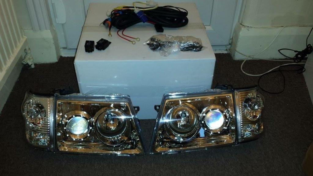

Remember, the OEM Toyota Hilux has just single headlamps, with a common bulb for dipped and main beams. The new set up has separate bulbs for dipped and main, with the outer projectors dedicated to dipped beams. Just needs a nice HID kit and it's good to go. Being used to my Audi's with their factory HID headlamps, I find the stock Toyota halogens way too yellow to live with.

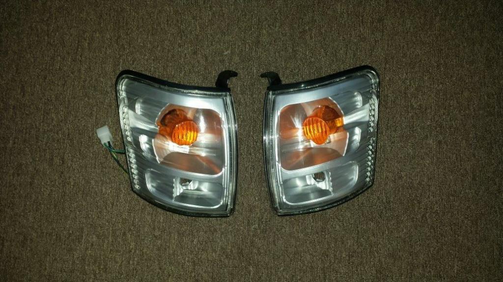

Still waiting for my LED rear lamps to arrive. I DID pick up a set of stock Toyota clear side repeaters, to replace the rather boring amber units. They look good, but seeing them against the nice fresh crystal front lights, they lack sparkle. So of course, a set of crystals has been ordered. Can't wait to get my hands on those sweet li'l suckers.

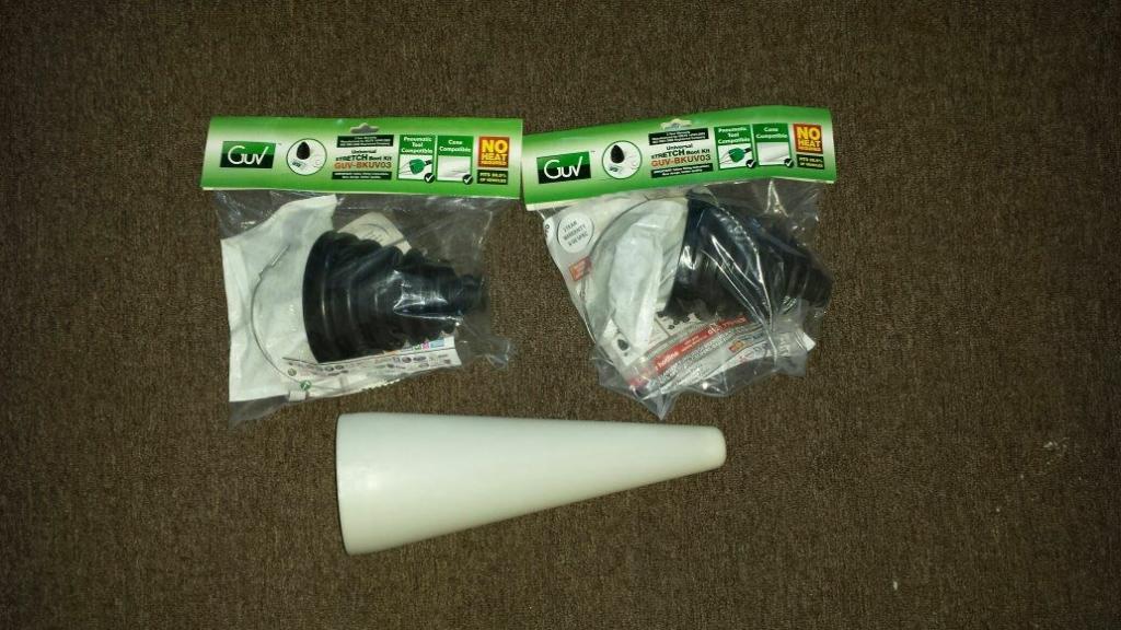

Having been laid up for a while, it was inevitable things would have degraded. Both front CV gaiters were shot, and the parking brake cable had seized solid.
Replacing the CV gaiters was not easy, very different from the procedure used on a regular FWD car, or indeed the Toyota Hilux 7, which is similar to a Toyota Camry, as far as the front driveshafts are concerned. Not a job to do on your driveway.

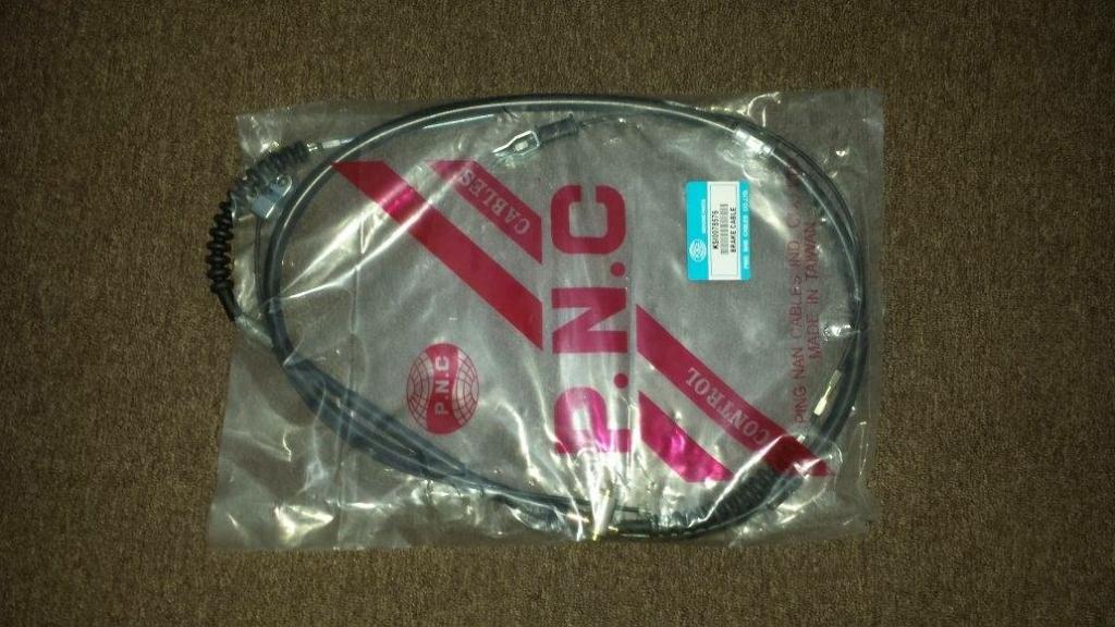

The handbrake cable replacement was another ball ache. The fuel tank needs to be pulled, to gain access.
All these were done on a Saturday, and the MOT carried out the following Monday. So for the next 12 months, she's road legal.
