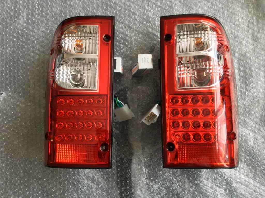

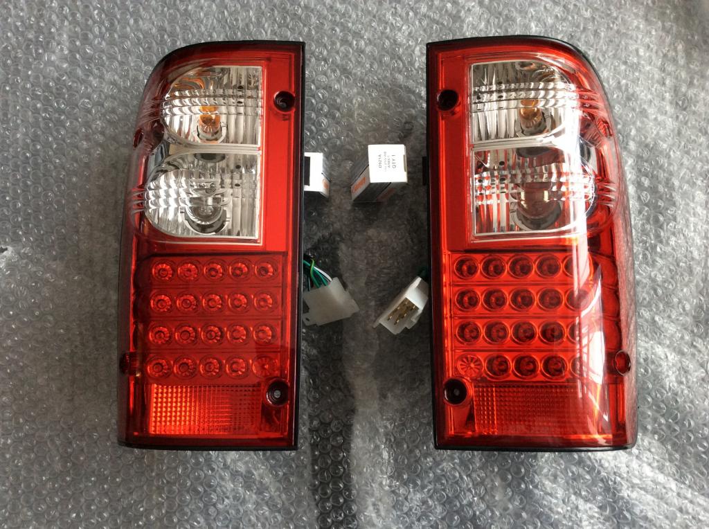

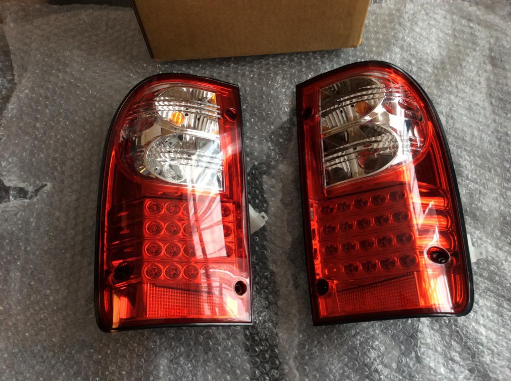

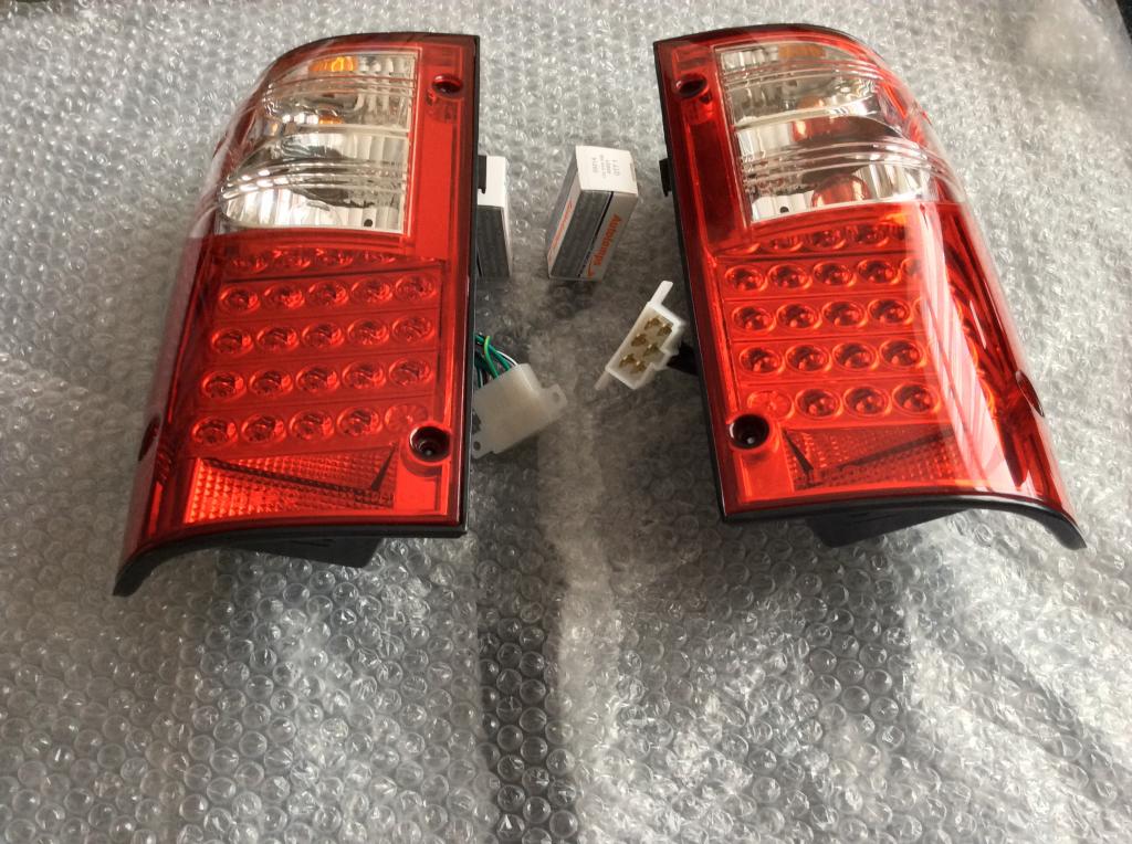

My crystal side repeaters have since arrived, the LED rear lamp clusters have been out of stock, I received an email last week, letting me know they are back in stock. Yesterday, I snagged a set, they were dispatched today, and should be with me tomorrow.

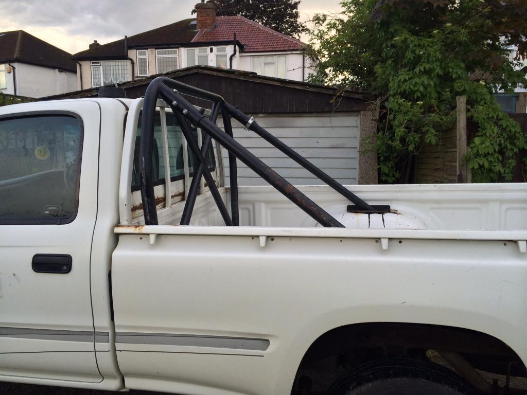

Losing the cage though, meant I ended up with 16 holes, where the cage was bolted to the rear deck - 8 at the end of the load deck, and the other 8 on the rear wheel arch tubs. Not a big deal, I'll simply have them welded up:

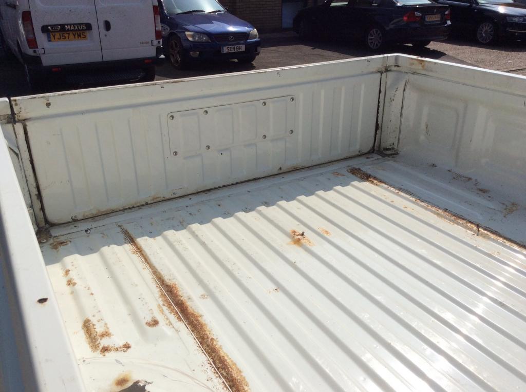

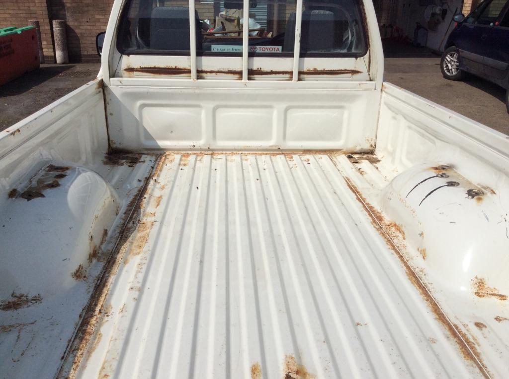

The rear tub was boarded out with 6mm ply board. Essential in keeping the rear load area free of dents and major damage. But not if my purpose is to build a show truck, which is what I'm doing here.
So last Saturday, I tackled the job of removing the lot. And an hour later, I had drilled out the last aluminium rivet, and removed the damp ply board. I was expecting to find the rear bed rusted through, with a view of the ground through gaping holes. Fortunately, all I found was light surface rust, just needs a rub down, priming and paint.
It was good to lose the wood, it was bloody heavy!

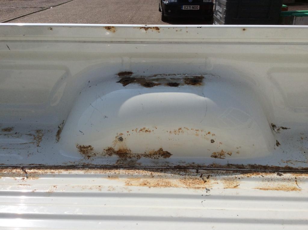

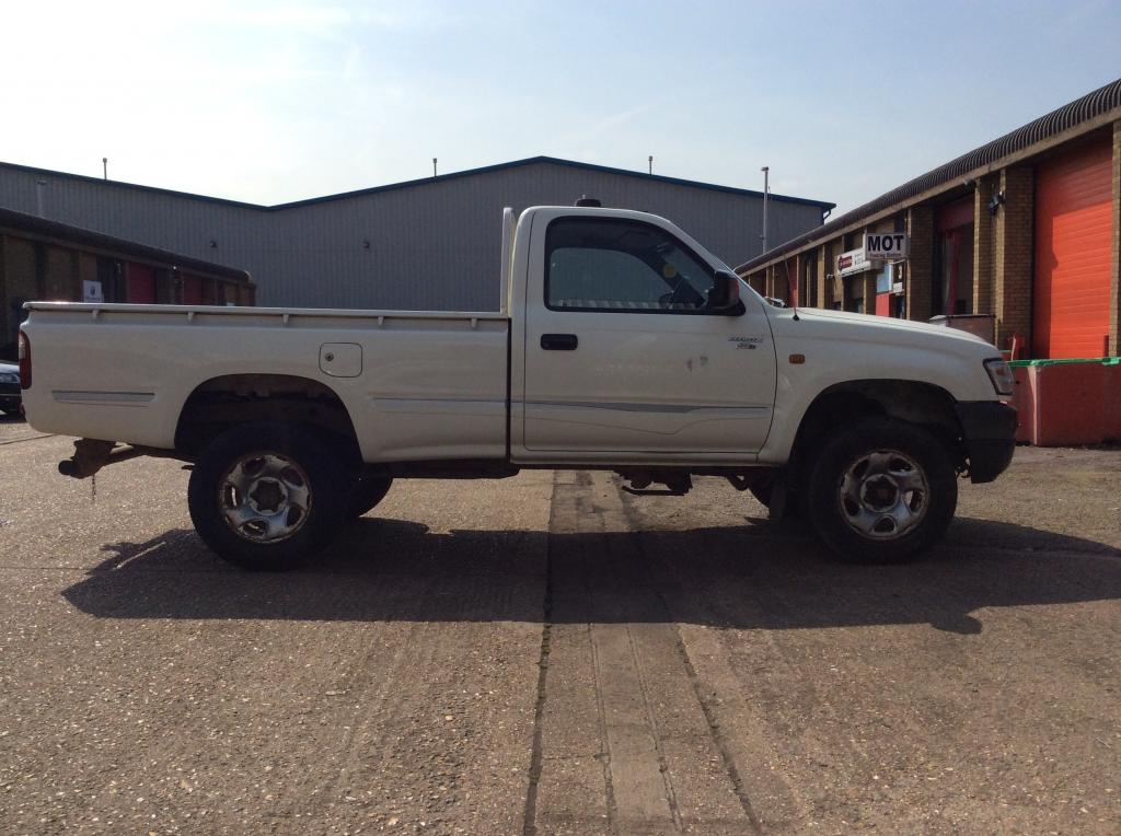

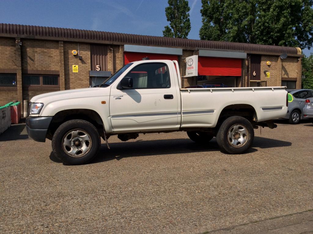

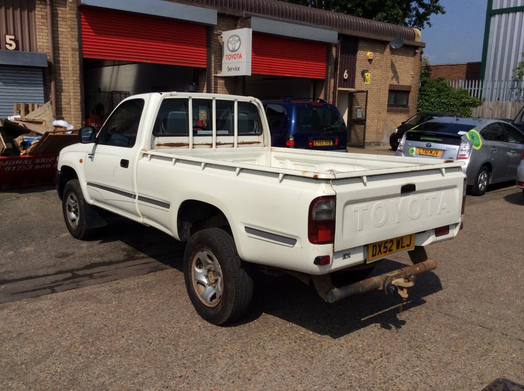

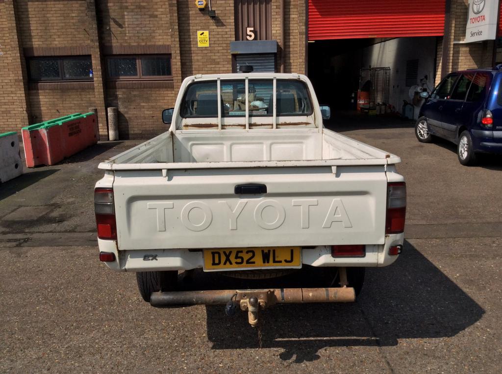

My Toyota Hilux is the Single Cabin, 4WD EX spec. So this means the rear tub has the hooks at the top, for tying down a tarpaulin tonneau cover. It also has the nasty groove all the way round. The tailgate also echoes this groove, and tie-hooks.
Since I won't be using a tie-down tonneau cover, I have decided to delete these. If it were just the hooks, it would have been a simple case of grinding them off. But the groove / recess means a more drastic approach is needed. The recess will require the entire area, on both sides to have new steel welded in place, filled, then sanded to shape. The rear tailgate is easier - simply replace it with the tailgate intended for Japanese-spec SR-5 models. This tailgate is smooth, and besides losing the recess and hooks like mine has, the embossed TOYOTA logo is deleted. The tailgate has been ordered from Thailand.
My truck has the recess and hooks on both sides of the tub the same on the tailgate, and the embossed TOYOTA logo.
Tailgate, showing recess, hooks and embossed TOYOTA logo:
Sides of rear tub, showing recess and hooks:

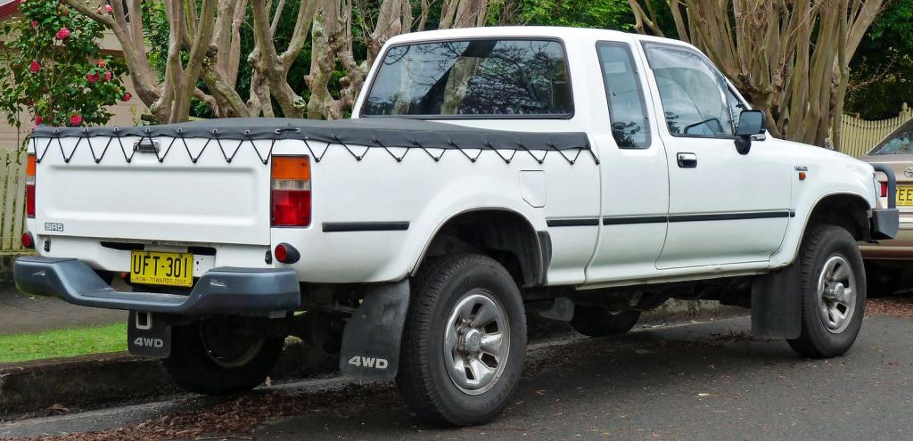

And pictures of the rear tub and tailgate with the look I'm after. The gold truck is an Australian model, pretty similar to UK-spec Hilux. The smooth sides (no recess or hooks) is only available on the double cab models. The white truck is a Japanese-spec SR-5 model. Note the tailgate lacks the upper recess, hooks and embossed TOYOTA logo.
Tailgate, showing smoothed look, no TOYOTA logo:
Sides of rear tub, showing no upper recess, or hooks:

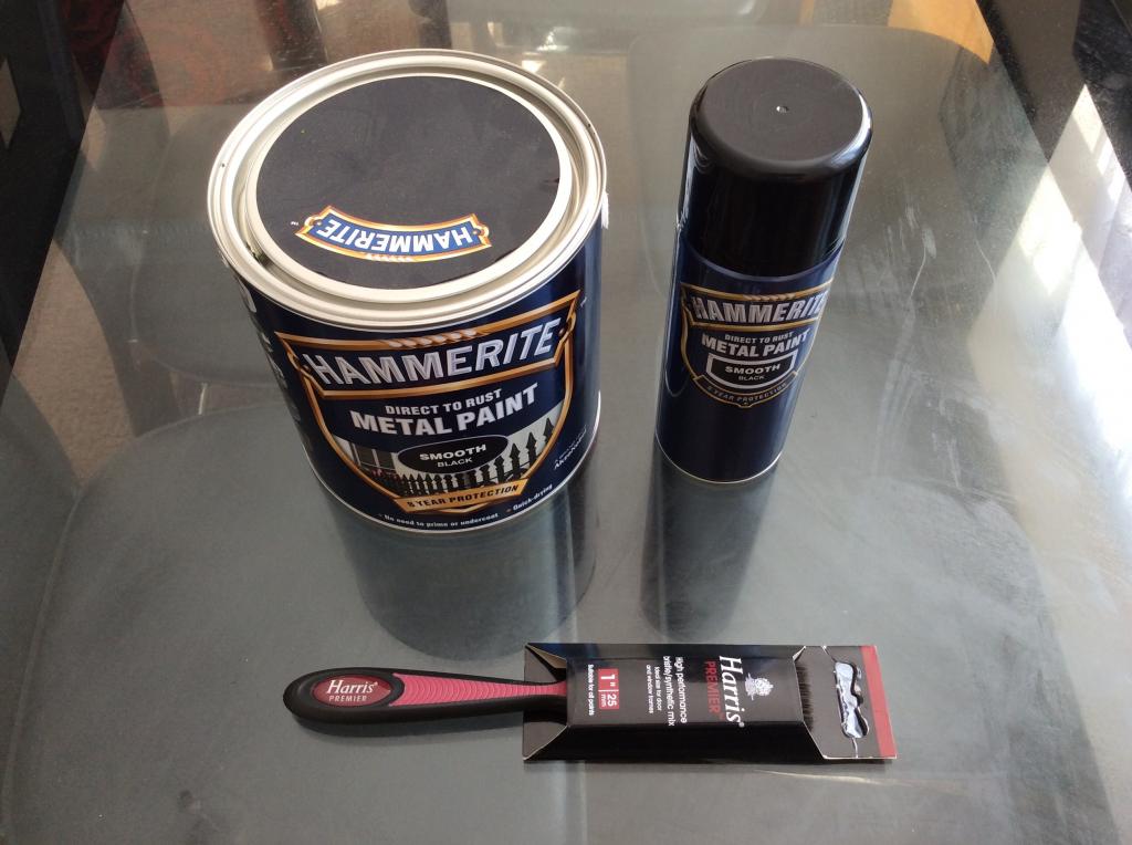

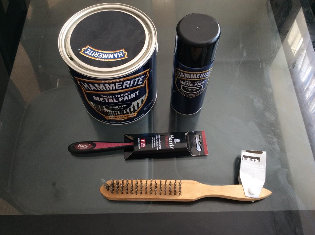

Whilst the chassis and general underbody of my Hilux are in good shape, nonetheless it could do with a new coat of paint. Being a 4WD model, it has much more ground clearance than the equivalent 2WD version. This means most of the chassis, suspension and underbody components are visible.
I decided to paint it back to the factory black satin, using not ordinary paint, but Hammerite Smooth / Satin black. This paint gives 8-year corrosion protection against the Red Terror - rust. I opted for a large pot of brush-on, as well as in aerosol form. The aerosol is to get into those hard to reach areas. I'll simply wire brush off any loose dirt or rust, and paint directly. Hammerite requires no primer or treatment before application. It can also be applied directly to rusty metal.
That's a job for a weekend, and the usual updates will follow in text and pictures.

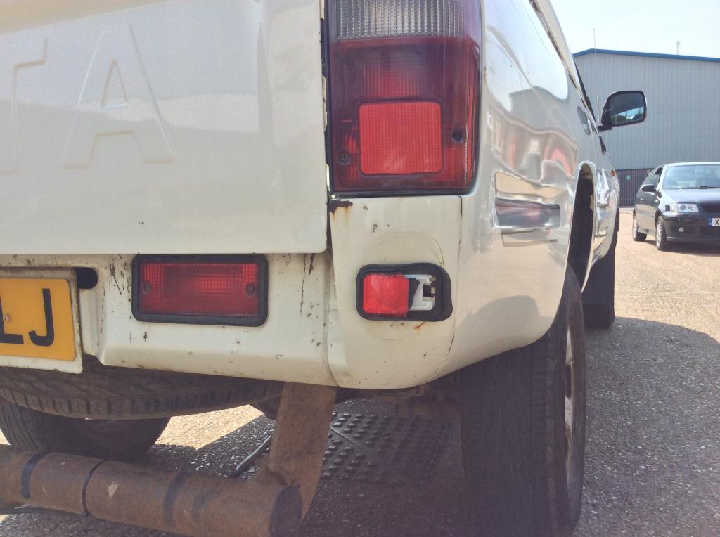

Another aspect of the Toyota Hilux KDN165 I don't like, and have decided to change...
...the pesky rear fog lamp in the lower panel, beside the licence plate. It looks home made, like a last minute after thought on Toyota's part. Echoing it's Japanese origins - as fog doesn't exist in Japan, fog lamps were never fitted to Japanese-spec Hilux's. So for export markets where fog lamps are mandatory, a rectangular foglamp was fitted to the left or right, depending on country.
On my truck, as is the case with all UK-spec Hilux's, the rear foglamp is on the right lower panel. Not very pretty, it looks like a cheap universal unit, similar to the foglamp on a car trailer. The rear reflectors too are very cheap looking, and not part of the rear lamp clusters:
As I have purchased more modern-looking LED units, I have decided to lose the factory rear foglamp, and the reflectors. The LED units have reflectors built in. As for the foglamp, I'm using a red bulb in the right hand side reverse lamp, I have swapped the pins in the connector accordingly. So I end up with just one reverse lamp on the left. The holes left by removing the solitary rear foglamp, and both reflector holes will be welded up.

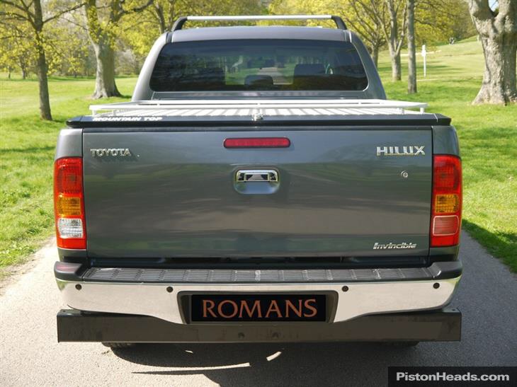

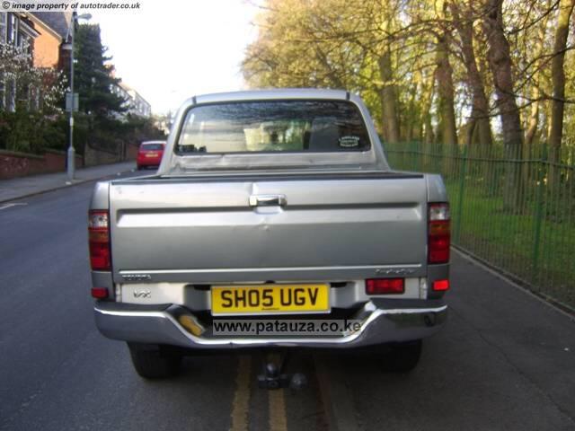

The Toyota Hilux KDN165 had two, or shall I say three options for the rear bumper:
No rear bumper (EX, FX utility models).
Grey rear bumper (EX, FX, GX utility models).
Chrome rear bumper (VX Hi-spec models).
Whatever bumper was fitted at the rear, for some odd reason, Toyota chose to fit it way below the lower rear valence (licence plate area). Probably due to the fact the early MK3 and MK4 models had a similar rear tub, and the MK5 (KDN165) was based upon the earlier models. As the licence plate area was the same, and no rear bumper existed on early trucks, a bumper would have obscured the licence plate, rear foglamp and reflectors.
So a bumper was designed to keep the critical areas visible. Thus, the bumper for the KDN165 was born. It had a centre dropped section to clear the licence plate, and to keep the rear foglamp and reflectors visible, was mounted low down. The result was a sagging, / drooping abortion, that Toyota classed as "rear step". It looked horrible, I actually prefer NOT to have a rear bumper than be stuck with that!
I opted for a chrome bumper designed for the Toyota Hilux KUN25/26. I took measurements from a truck at work, and in terms of width, it was a perfect fit. It incorporates the licence plate too, so that would clean up the rear of my KDN165 a treat.
Saggy rear bumper on KDN165:
Straight rear bumper on KUN25/26, which I opted to retro fit:
