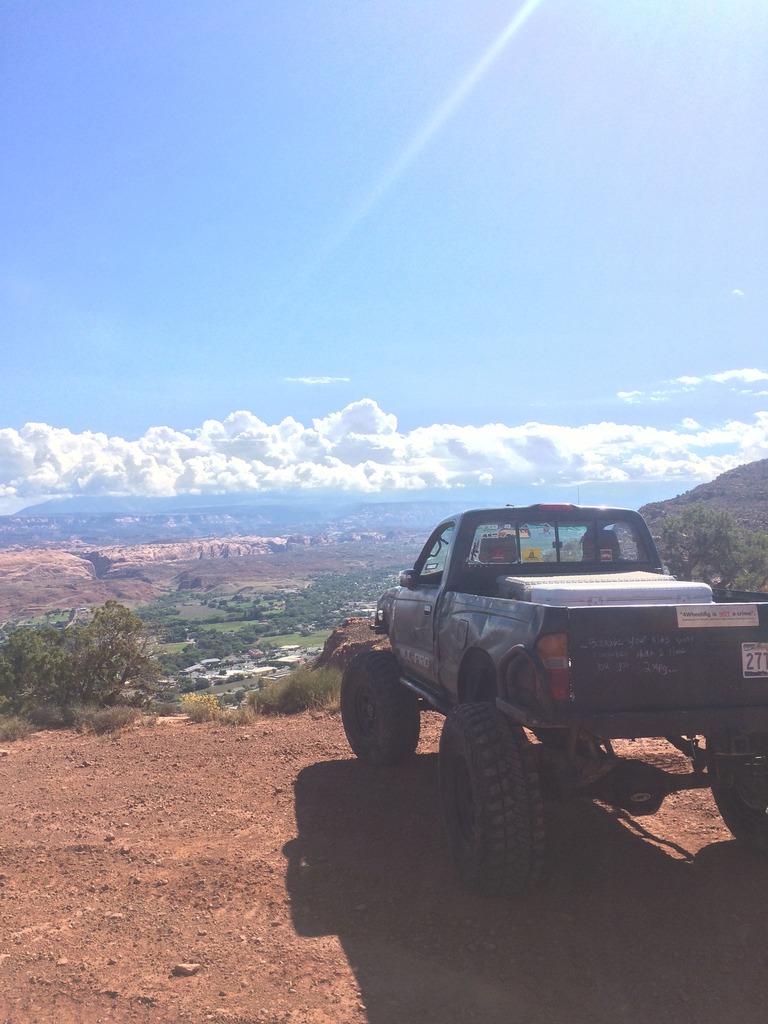

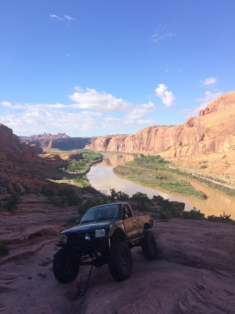

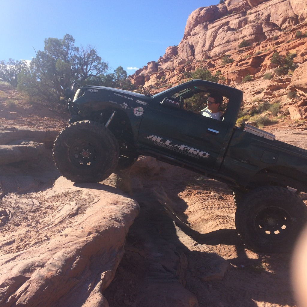

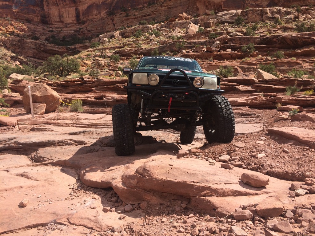

As for the truck, I'll try and start where I think we left off.. Shortly after the SAS I went to Moab back in late 2014..
It went pretty well. Truck worked great. Had to add a power steering cooler at camp one day because the PS was overheating and leaking everywhere..
Truck died on the way back near Lubbock. About 300/ 1200 miles remaining it appeared like there was an alternator failure. I swapped over to my spare, but still no charging. Had a friend come from Austin and trailer me home. It ended up being a faulty connection at the charge signal plug on the fuse box

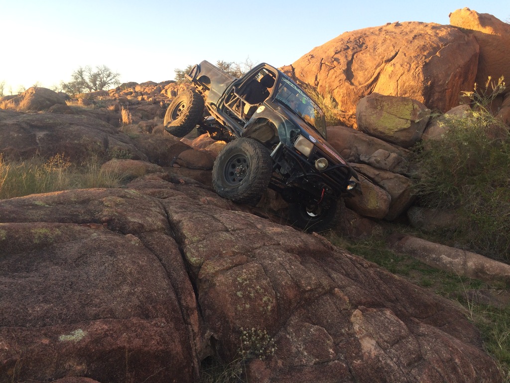

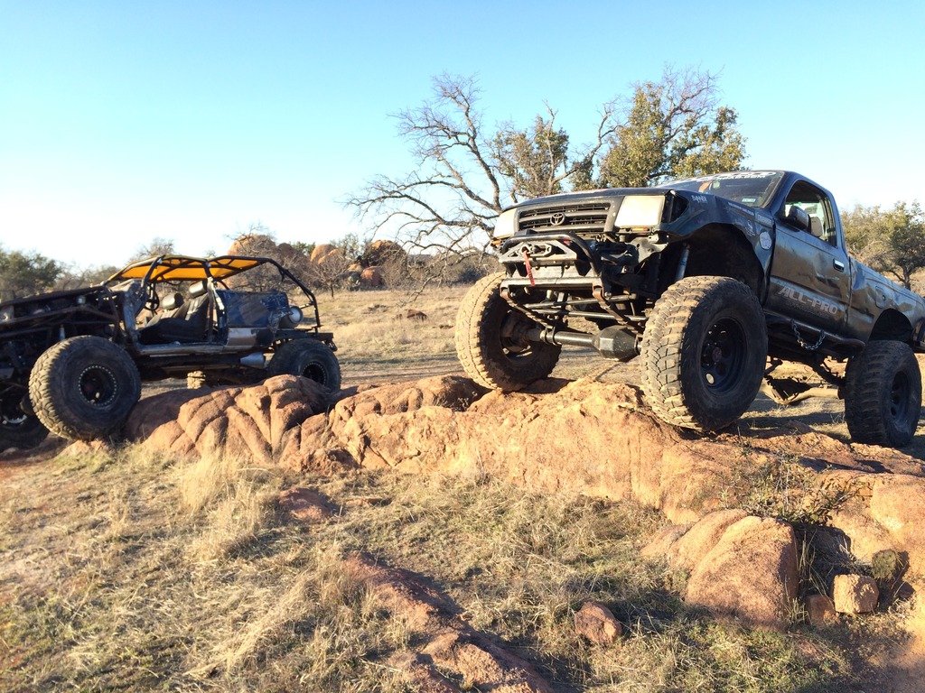

K2 a few months later..

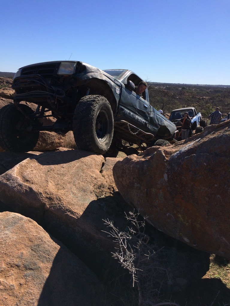

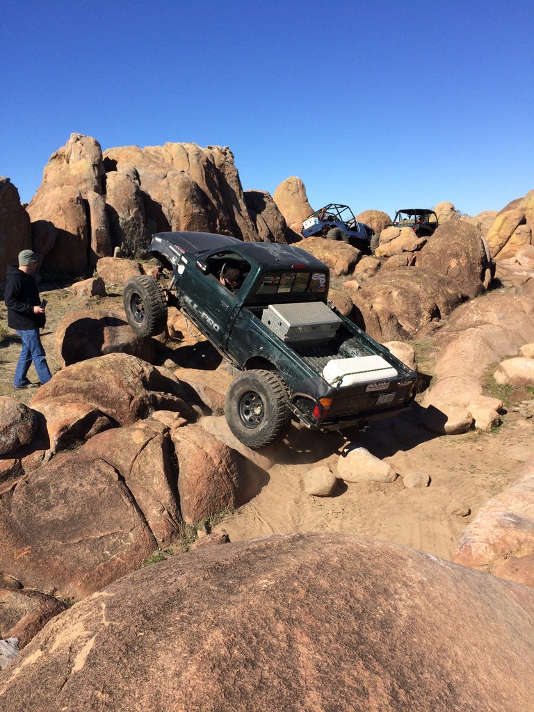

More K2 a couple month after that (Early 2015)

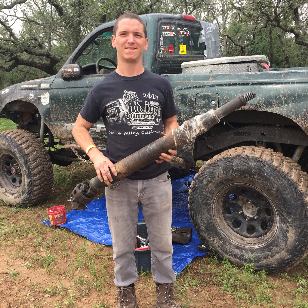

Threw the rear shaft on that line^^

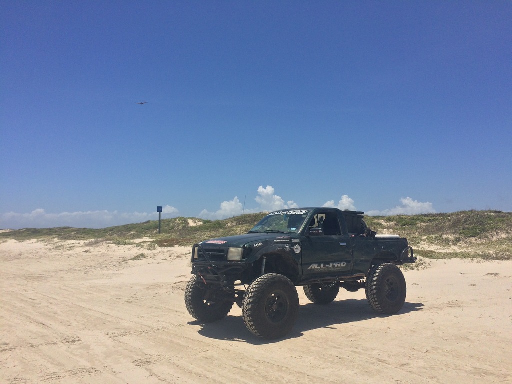

Padre Island Nation Sea Shore (July 2015 Birthday trip)

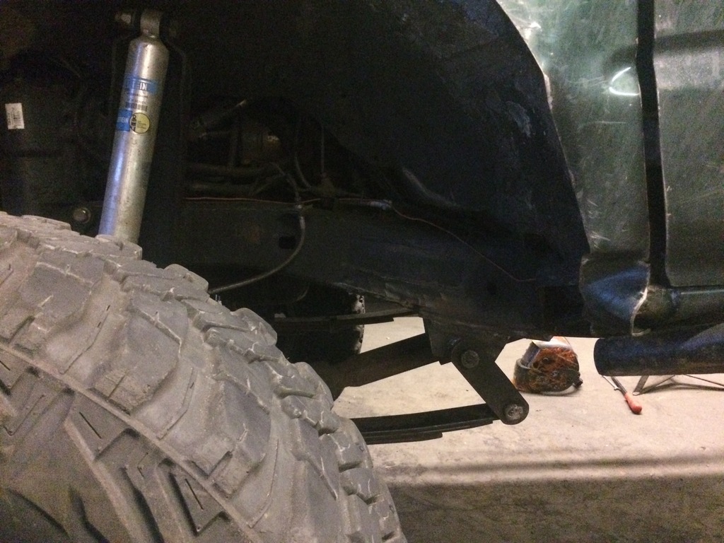

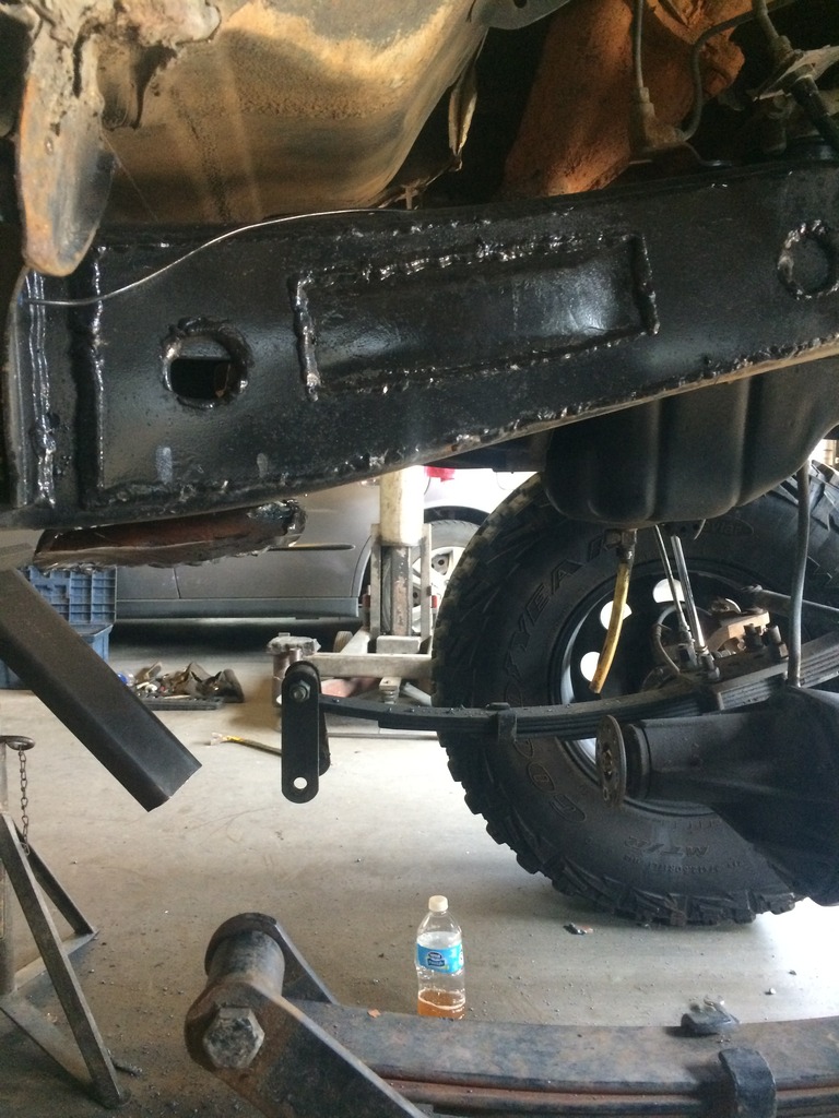

Cut off and Re-did the shackle mounts for the front.. The shackles are closer to 45* at ride height. A tad bit lower ride height.

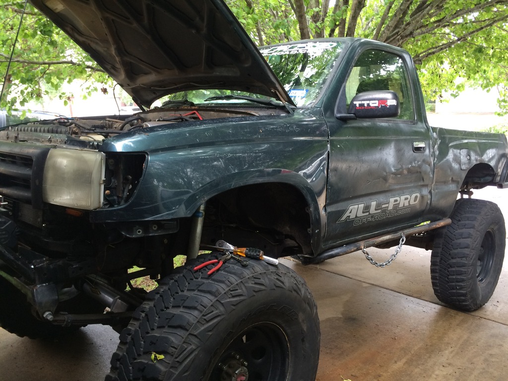

Front fenders.. Summer 16..

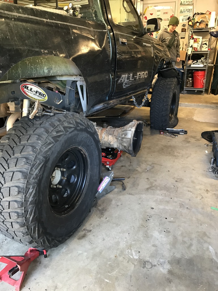

Clutch.. November 16.. This was a 1200# trans jack from Northern tool that was about 2" too short so we deflated the front tires.

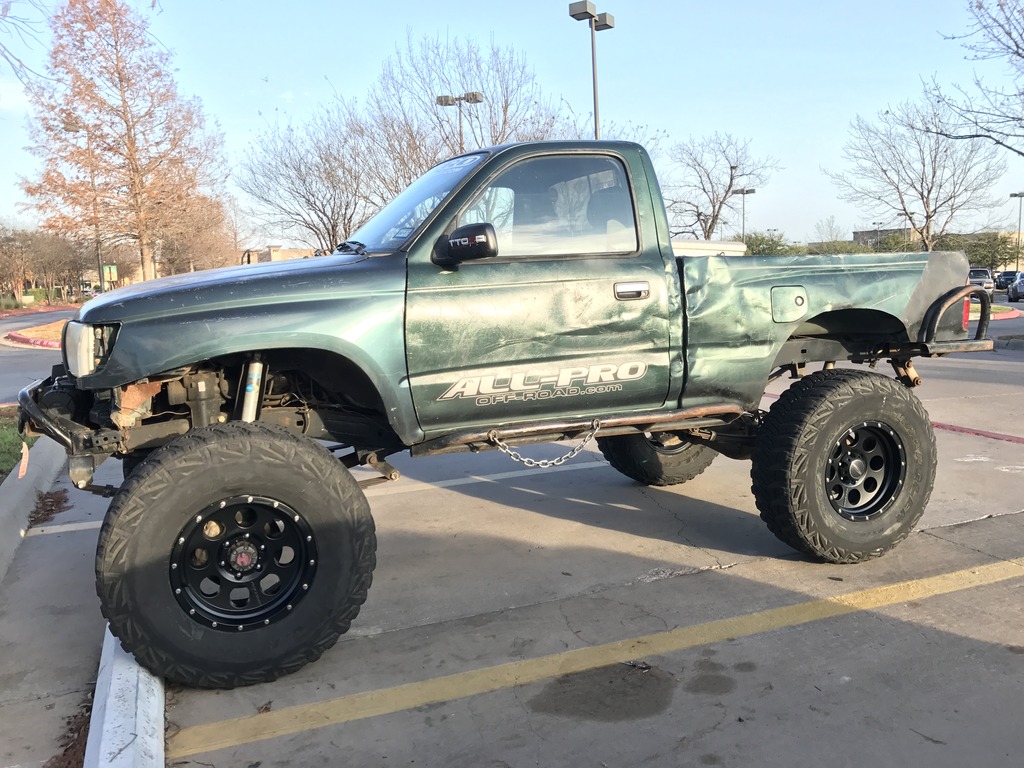

Recently put on some new wheels to drop some weight from the old steelies. They weighed 41 #'s each. These weigh 24 #'s. They are Pro-Comp Proxy Series 45 17x9 -6 offset. Clear the Tacoma brakes really well

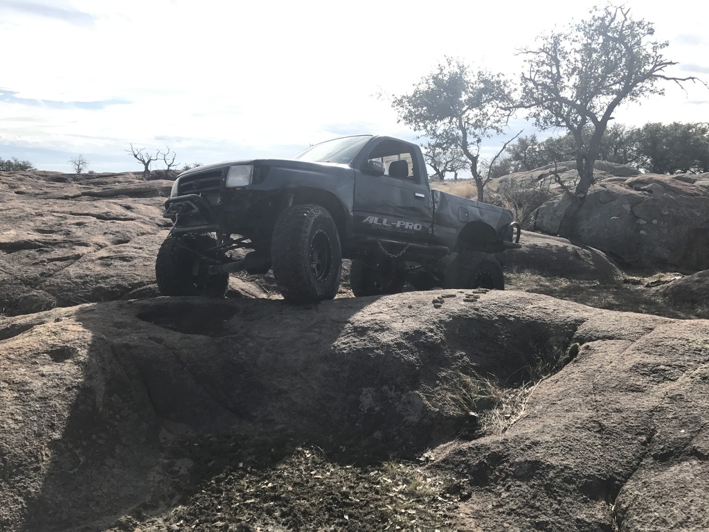

Me and some friends went to Wolf Caves on New Years Eve. Wolf Caves is a new park that is directly on the other side of K2.

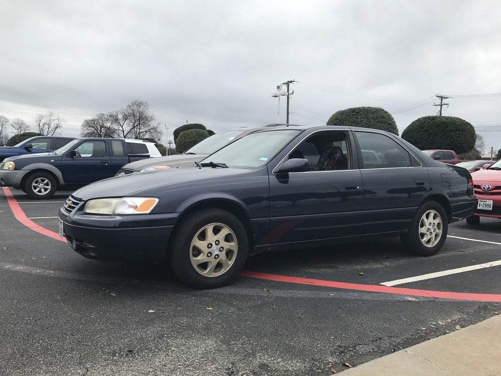

No updates on the truck, but I did actually buy myself a decent little 99 Camry just yesterday. I needed a commuter and a baby hauler. This one was the right price. $1300
V6 auto XLE, 165k. Runs and drives great. Lots of power. Shifts well.
Current issues: oil leak, probably rear main. Desperately needs rear struts. Paint sucks. Typical Toyota clear coat. Can't change vent selection on AC control.
Just put tires on it today ($300 w/ my employee discount). Old ones were horrible.
Re oil leak: I may pull the engine and do the TB/ water pump at the same time. It's not a horrible leak but I of course want it to stop.
