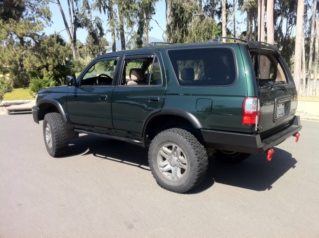

Buddy of mine named Jay gave me his old bumper, but it had the holes on the sides for flares and the paint was history. I decided not to use it.
While surfing T4R.ORG, I learned that you could buy the factory grilles already painted. I shat a brick and bought a green one.
This left me with a chrome bumper left, no more chrome but that. Finally, I decided it was time to learn how to do some body work. Brother helped me, filled in the fender holes with a welder. I bought some Bondo and smoothed it out (not well.. oh well, first try). Primered and painted with good ol' Imperial Jade.

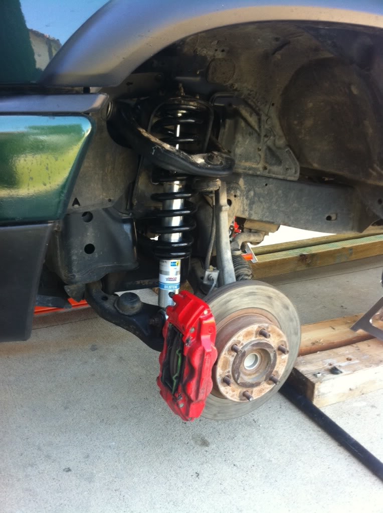

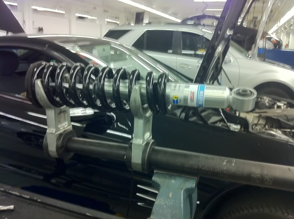

Bilstein 5100's, bushing kit, and OME 883's!
Will go great with the OME 890's and Rear Nitrochargers. I am considering swapping to 891's if anyone wants to trade (maybe the stiff ride isn't to your liking, 891 owners?). Bumpers are heavy.
They say not to couple these because the ride is stiff. I like that
To my dealership to compress these springs,
///AWAY!!

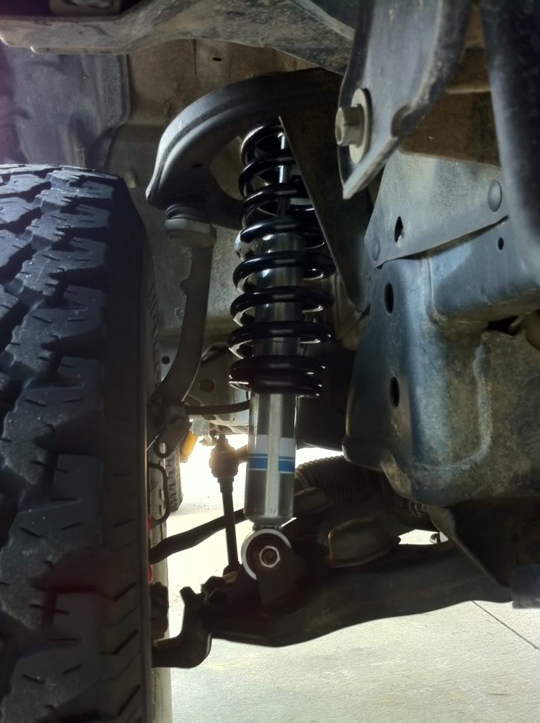

05-03-2011, 03:54 PM
Done!

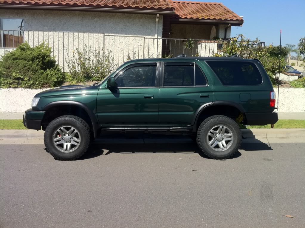

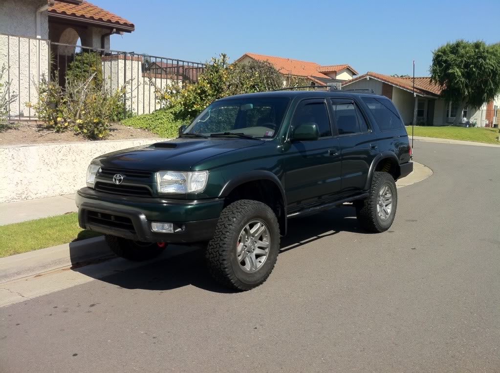

Measures about 39" ground to fender

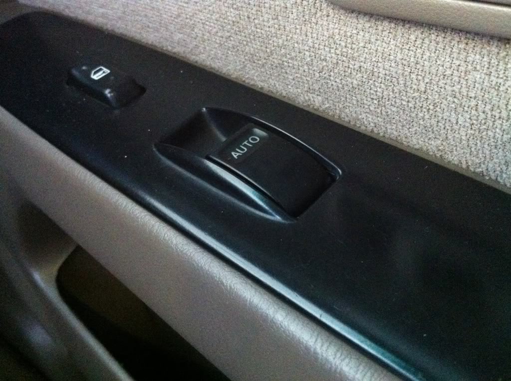

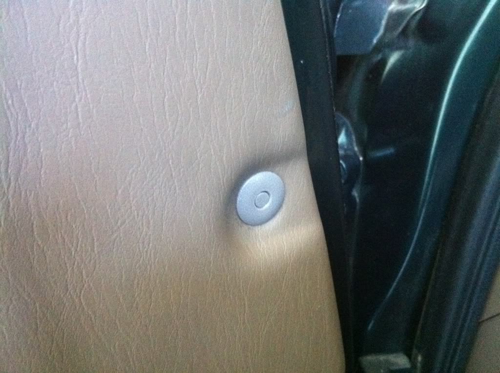

Contrary to popular belief, my 4Runner has never been buffed other than after the paint was done. It's never even heard of wax.
I decided to finally treat it. We have all of the detailing tools at my dealership's body shop. It had some gnarly scratches all over the sides from branches, the hood has some scrapes, and the overall condition of the original paint was very sub-par. The pictures don't really show it, but it looked really bad up close. It was dirty from a little wheeling trip last Friday, so I washed it, clayed it, buffed it 3 times, and all of the scratches are gone. I am in love with the way this thing looks now.
I also took out all of the seats, then cleaned and shampooed every inch of the interior, even the seat belts (THEY ACTUALLY RETRACT NOW!).
On another note, my steering rack has gained too much play. The actual inner bushings have gone bad and it is now leaking a storm of ATF. I went to Ferman's Minitruck in Santa Ana and pulled a steering rack out of a wrecked IJM 99 3RZ 2WD (familiar... eh?) and I will swap that in once I get my new steering rack mount bushings from Wheelers Offroad. Alignment afterwards.
I also got a new set of bumper lenses for the signals from FoneRunner. One of mine cracked from a rock.
Next up is either a new LSPV or a manual proportioning valve, and then fixing my seat mount on the drivers side which has been broken for some time now.

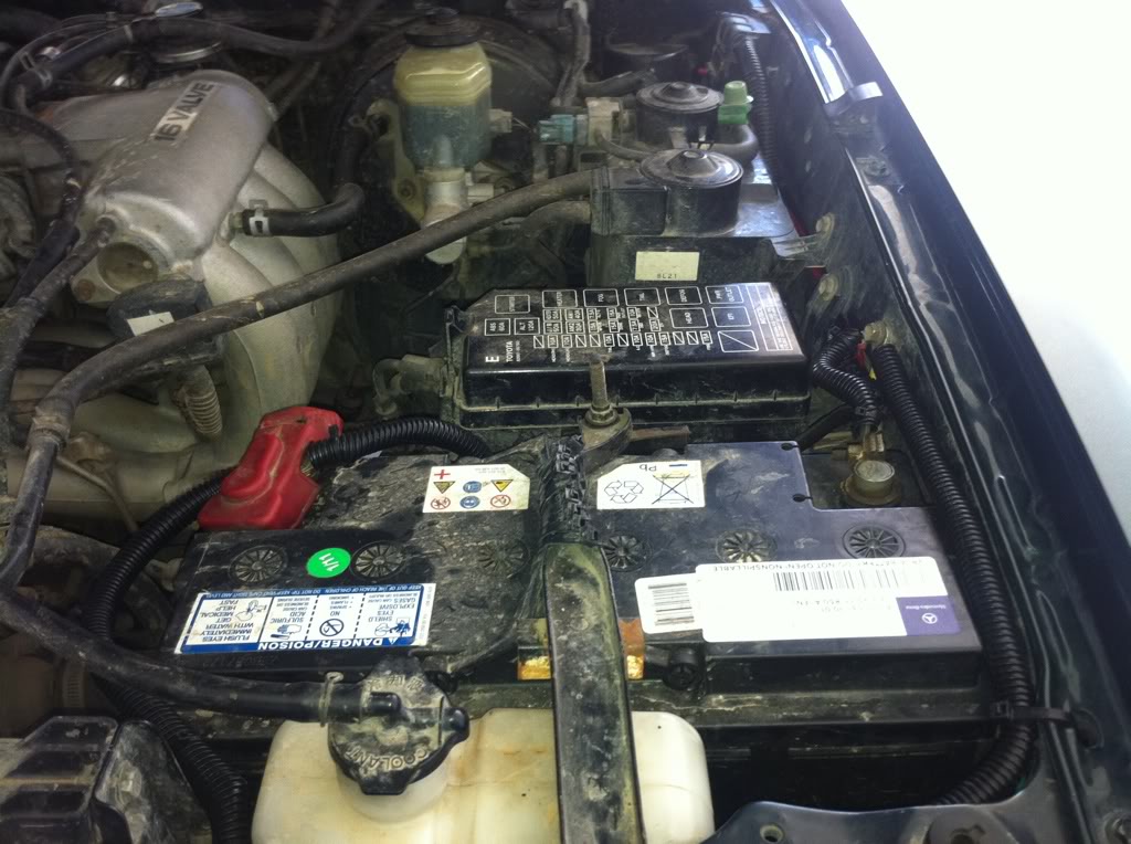

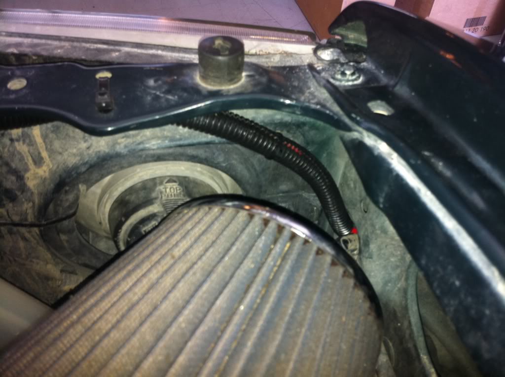

My Energy Suspension Steering rack bushings are here and I will undertake install on Monday.
And some loom cuz I was bored and it was free. (Zip ties on the battery mount aren't holding the battery, they're just there for insurance.)
More on the underside covering the fog light wires. Cool stuff if used for actual wires and in moderation, can't stand people who loom the whole engine bay.

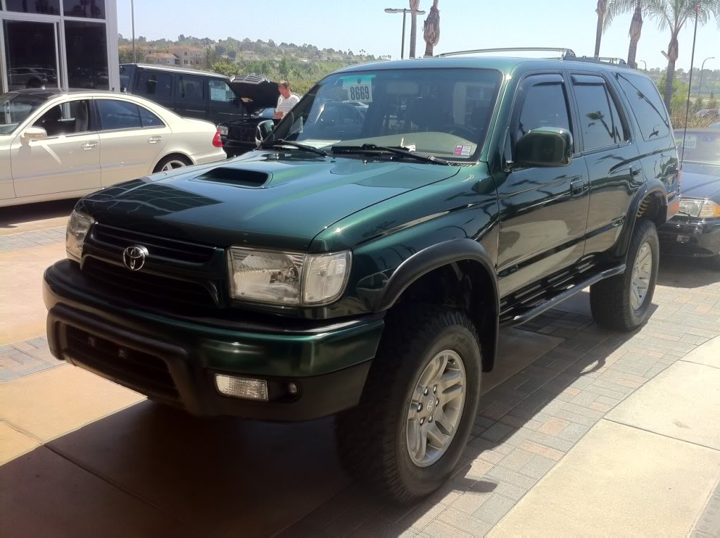

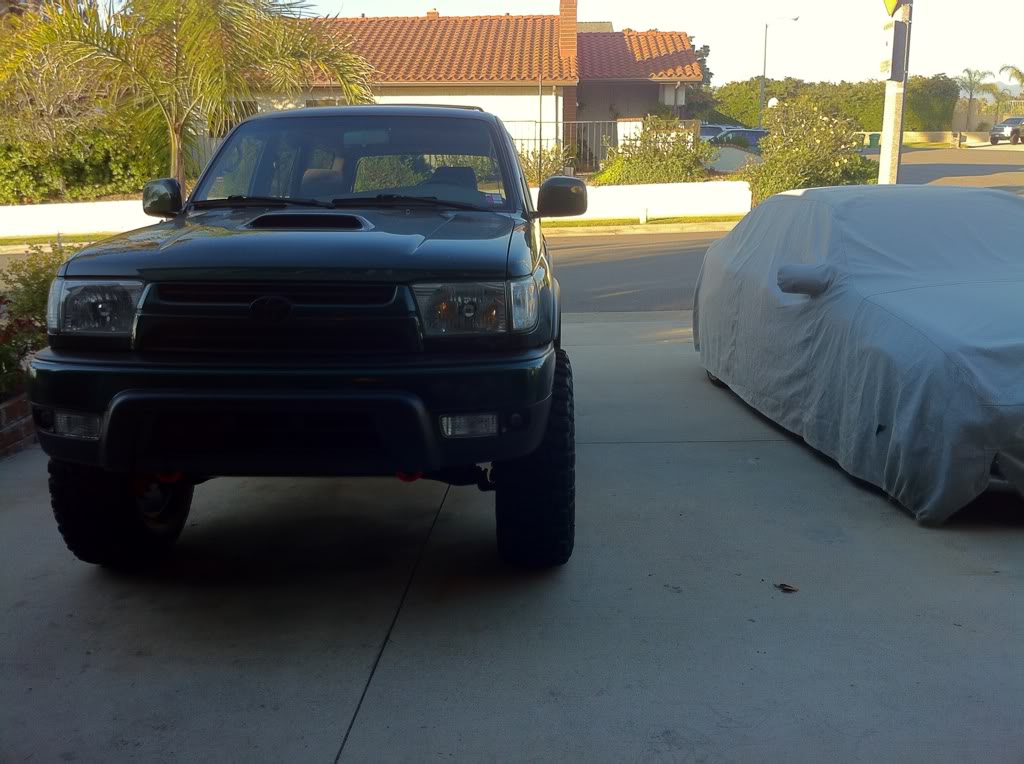

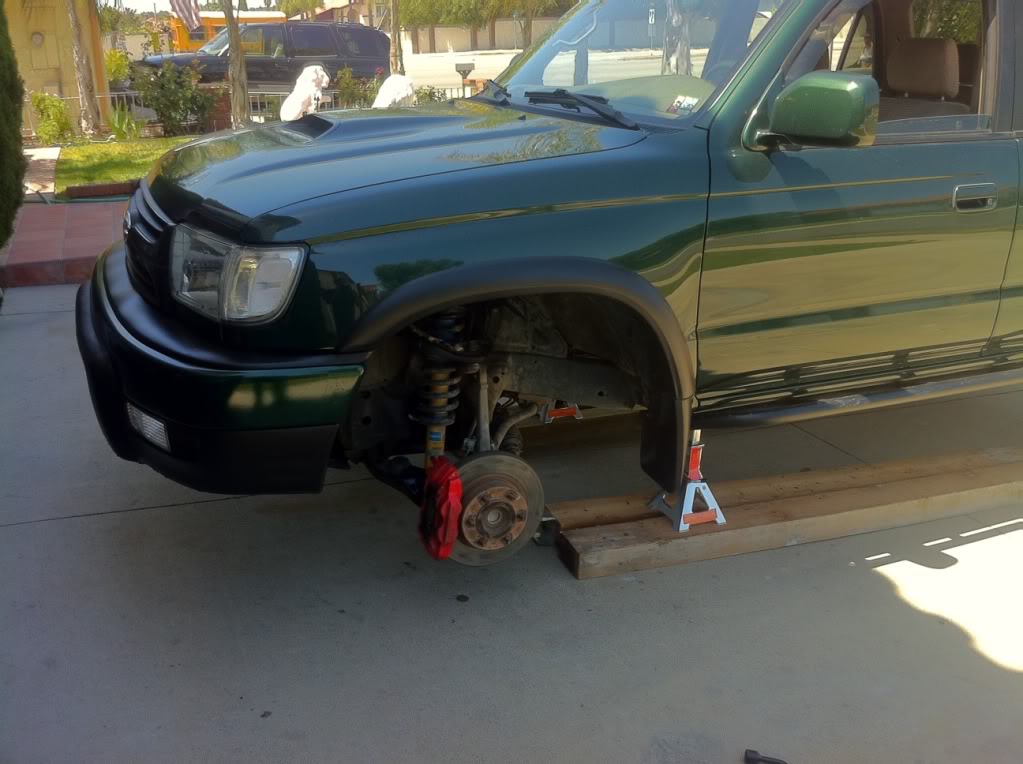

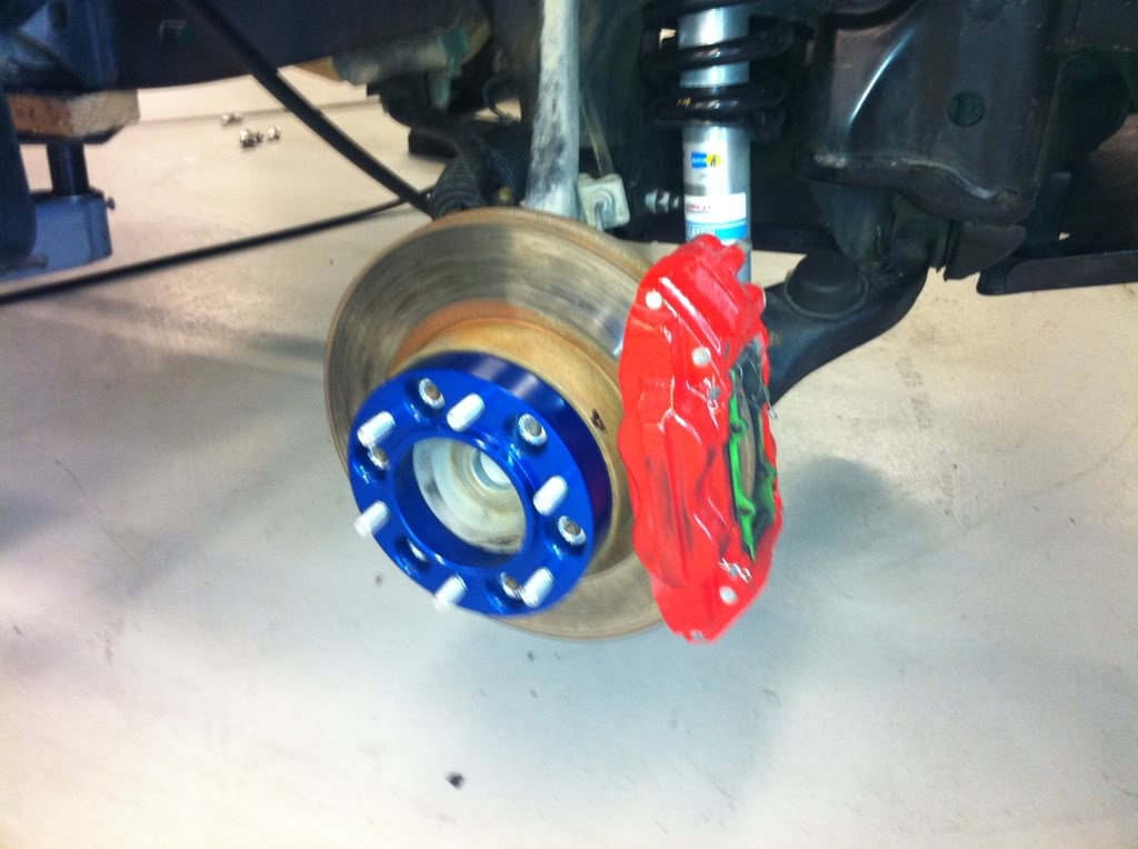

Ordered 4 1.25" Spidertrax Wheel Spacers. Will be here on Tuesday.

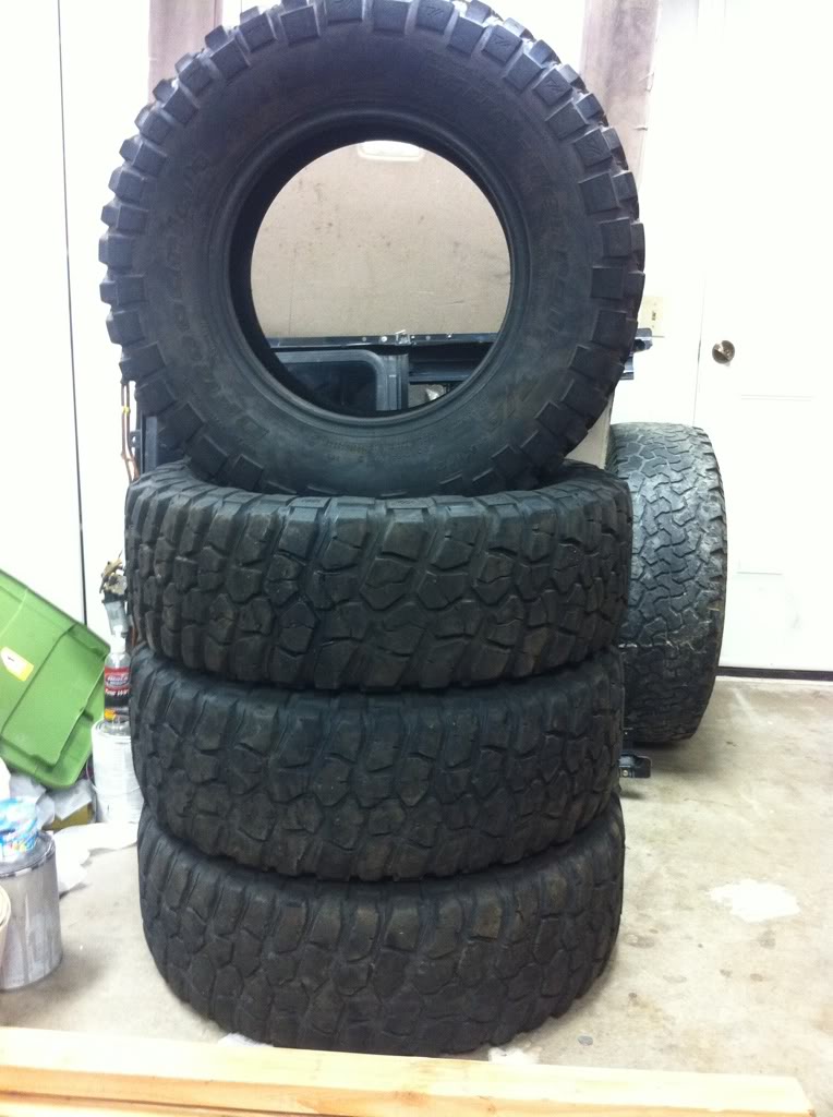

Scored 4 285/70/17 BF Goodrich Mud Terrain KM2's on craigslist. They will go on as soon as I get my spacers. ETA Wednesday.

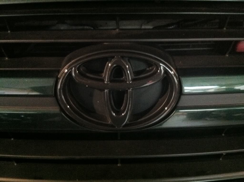

Also ditched my flat black emblems for some genuine Black Pearl emblems I found at the junkyard. Painted the front to match with Testors #1813 Black Pearl. I just need the black pearl antenna nut and I'm done.

Well, here's what's next
I began payment on my new 2.7 Alpine/TRD SUPERCHARGER!

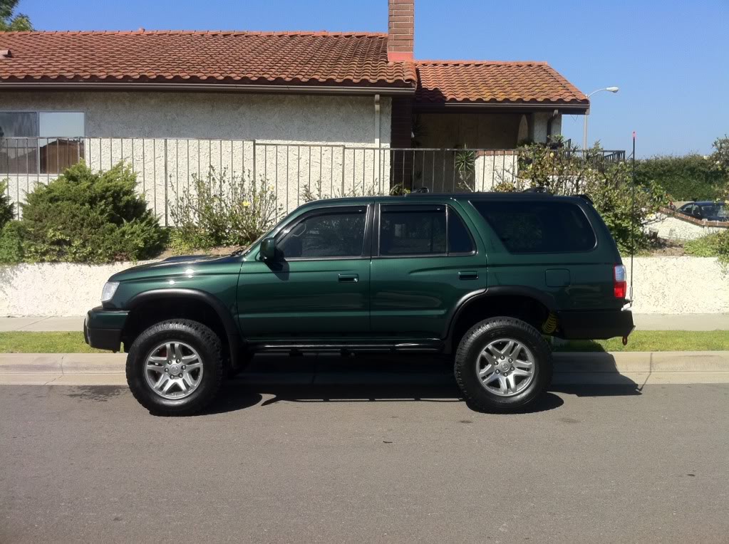

Today's installs.
1.25" Spidertrax spacers

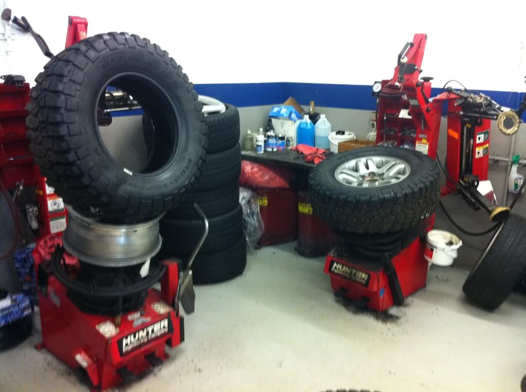

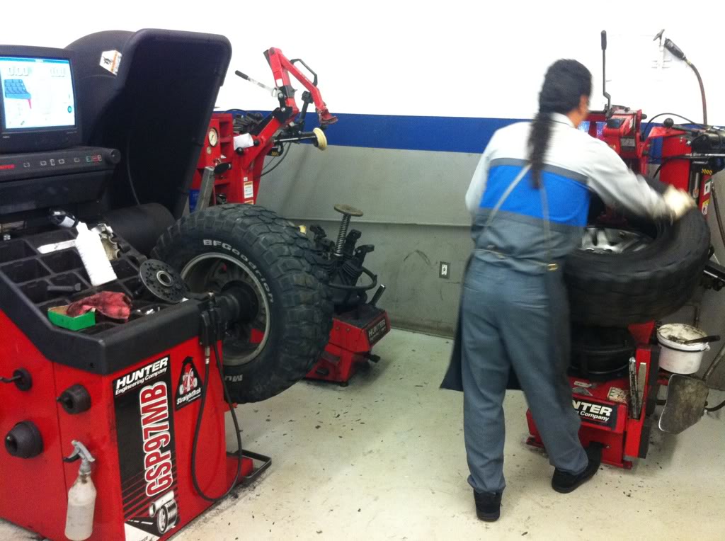

285/70/17 BFG KM2'S

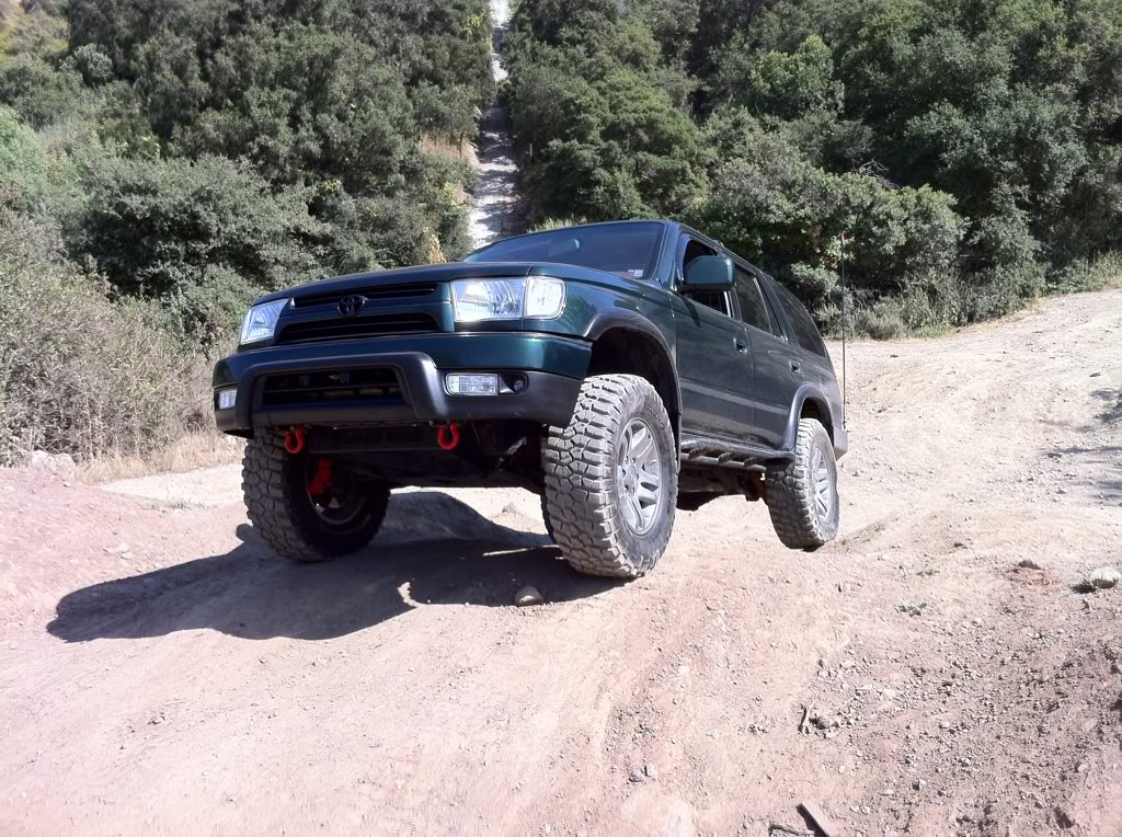

I took the 4R to the trail and immediately found that my driveshaft was hitting the gas tank skid. A few minutes with my angle grinder and a hammer fixed that quickly. I cut about a 3x2 inch piece of metal off of the skid. Works great now, no rubbing. I also went over an obstacle I could never clear before. It's a large dirt barrier that is about as tall as the truck itself. I didn't get a photo, but I will next time. I scraped the CBI on the ground, it's so steep.

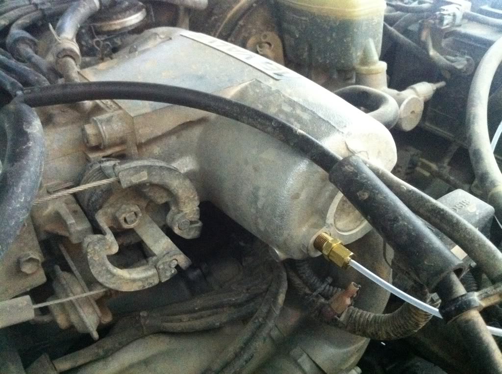

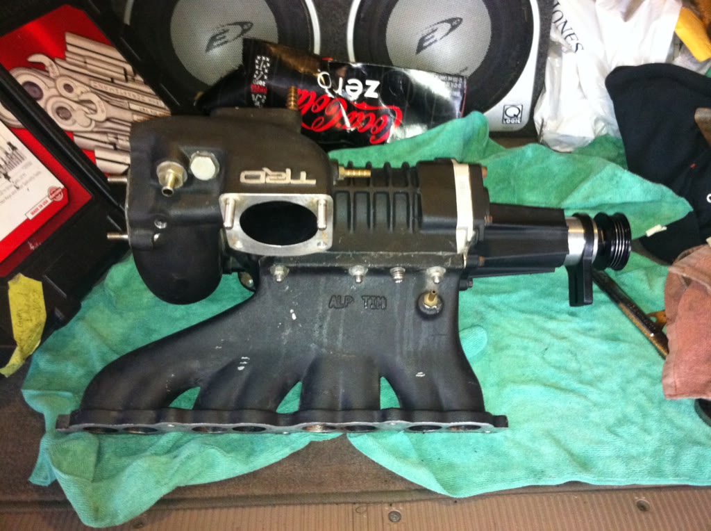

Next up are a set of ARP Intake manifold studs. ARP 400-8013 = ARP 400-8013 - ARP Stainless Steel Accessory Studs - Overview - SummitRacing.com
They're pretty pricey, but from what I've read, totally worth the cost.
It seems the 5th injector that is currently supplied with the LCE Superchargers is actually fitted into the elbow of the supercharger, as shown here, sticking out on the top left:
I will either have to purchase a new elbow or modify mine to accept a new fifth injector. Modification seems the most economical route.
LCE also uses a Split Second controller. I have been to Split Second's shop here in Costa Mesa. My brother had his 92 22RE tuned there for a MAF conversion. I will go to them when the time comes.
Also, here is what the seller is including with the sale, 2.4/2.5/2.6 pulleys, dynamic tensioner for 2RZ, and UniChip are not pictured. It appears all brackets and power steering pulley bracket, etc, are present. So far, so good! I'll just be picking up the ARP Studs and LCE Teflon gaskets before install. The teflon gaskets are basically isolators that keep heat away from the intake air. By keeping the heat out of the intake manifold, the incoming air is cooler, therefore making more power. I also need a TRD Boost Gauge and pod.
(Picture shown is for illustration purposes only. Actual isolators are white.)
Looks like I am doing well with my eBay sales and craigslist sales that I can get the unit early.
The Intake Plenum on the supercharger has been gasket matched already, so I thought a 4mm increase in TB bore would be helpful. I might buy one.

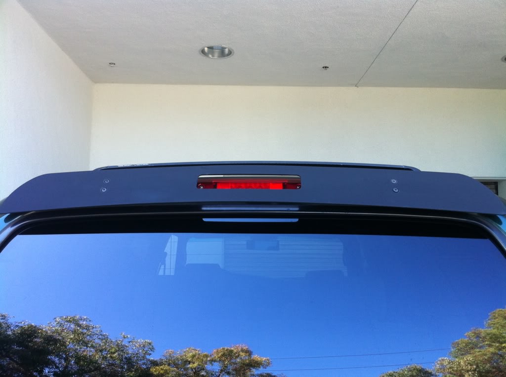

06-19-2011, 11:44 PM
Random stuff:
100W H3 bulbs instead of 55W for fogs (left 100W, right 55W)

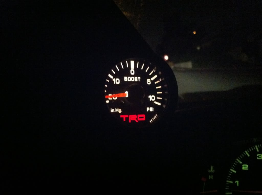

TRD Boost gauge and pod, Thanks A.Wilson013! Ready for that supercharger... though I'll obviously have to find another vacuum line later lol.

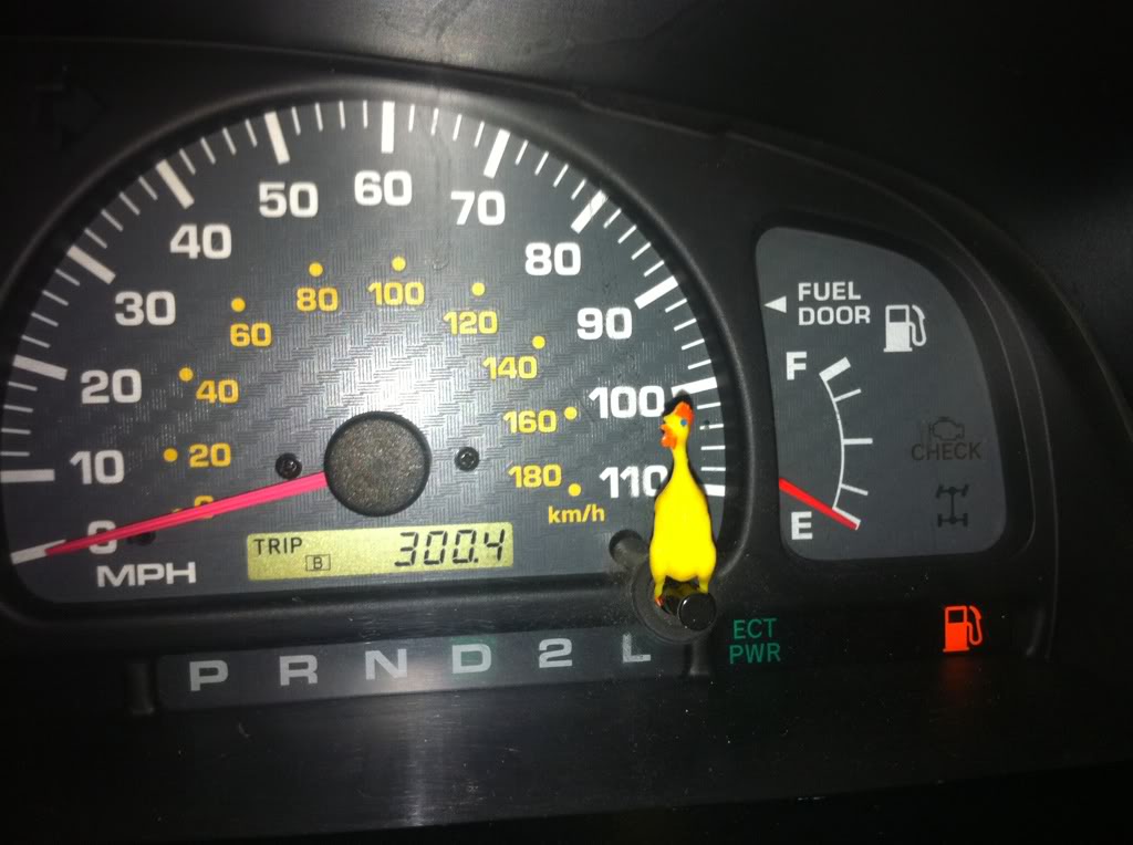

33 inch tires and 4 cylinder and still 300 miles per tank. :thumb3:

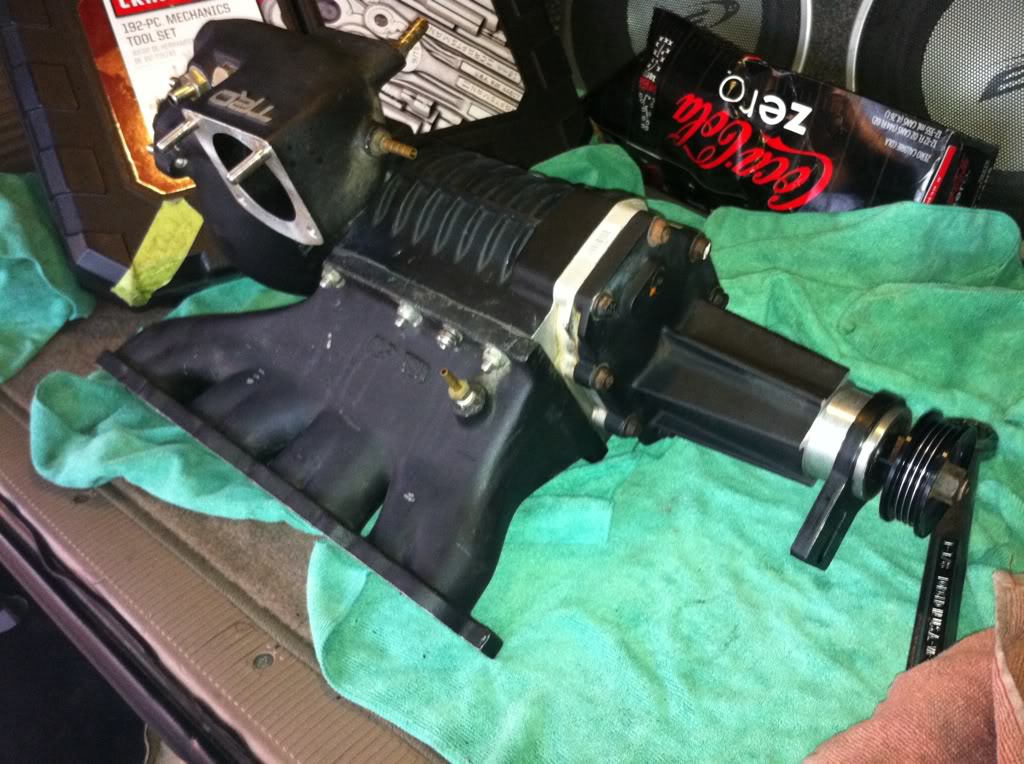

In other news, the UPS man dropped off a hefty package full of happiness and awesome today. Accessories included, not shown.
Picked up a URD interstitial ECU harness for adding a piggyback ECU. I can retain my stock harness without modification. $80, normally $160.
Waiting for funds to order ARP Intake Manifold Studs and a Teflon Gasket set. Next paycheck. Then, install.

Replaced my passenger's side auto switch. The original somehow broke and became really super sensitive. Swapped in a "new" one from an 01 Sport Edition. Switch only, same bezel.

My 4Runner never came with a rear spoiler, running boards, roof rack, tow hitch, or any of that fancy stuff. I bought a used rear spoiler from a junkyard back in 2009. The paint on it wasn't excellent, so I repainted it twice. Since my last paint job, it started fading pretty bad. It was also pretty scratched up (beyond paint work). I decided to swap it out, again from the 01 Sport.

Other randoms include teflon tape for the boost gauge, which is still making noise of leaking at about 7Hg and 3Hg (IDK WTF WHY, it's annoying!)

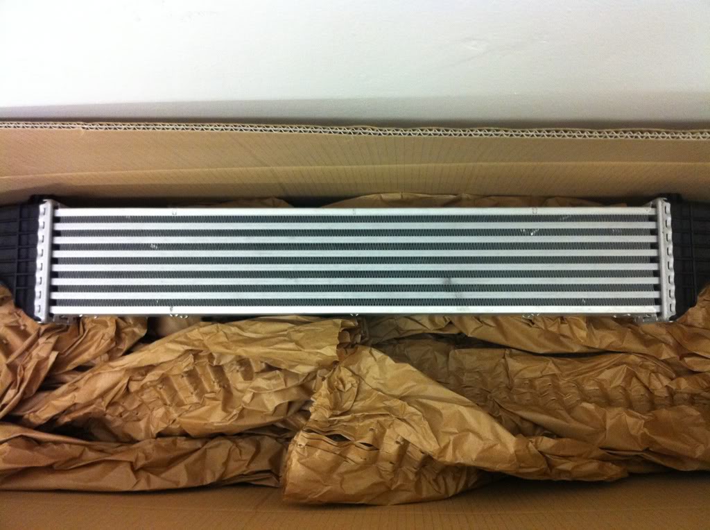

Picked up this possible intercooler for future use, from a Mercedes-Benz. Fits beautifully behind the fat lip.
