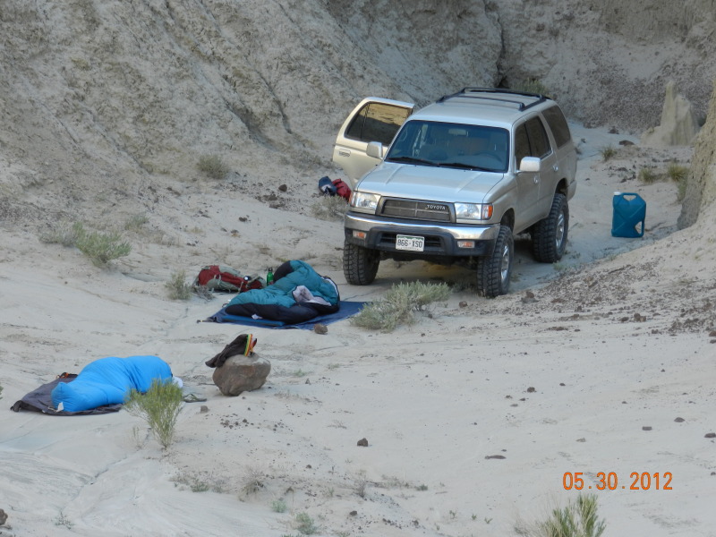

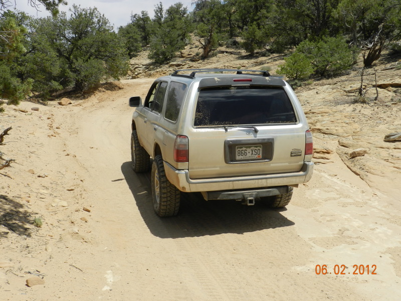

I first took the truck out on a road trip with my brother through the southwest. Hit up Engineer Pass
New Mexico
Canyon de Chelly
and Grand Staircase
After that, I didn't do much with the truck and daily drove it. I wasn't sure if I was going to sell it for another rock crawler project, so I didn't want to invest much time into it.

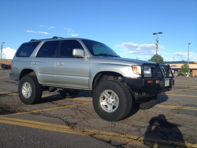

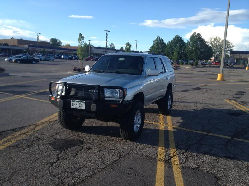

I first added some 285/75 16 Yokohamas. They were a great price for 5, with certs, and some classic MT wheels. I sold the classic MT's and stuck my stock alloys on, which I prefer.

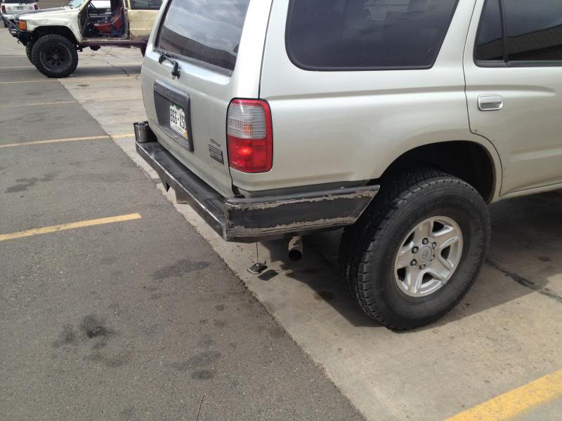

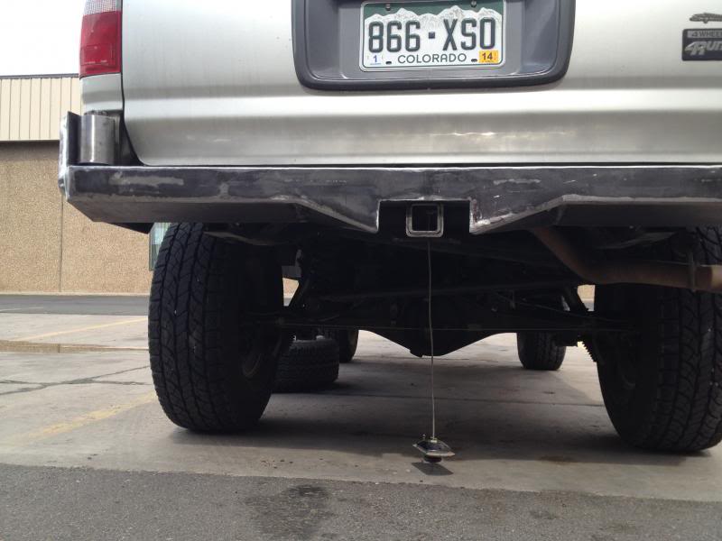

I also added an ARB bull bar. It was easier to bolt it on than fab something, and I didn't want to spend my whole summer in the shop, but rather out and about

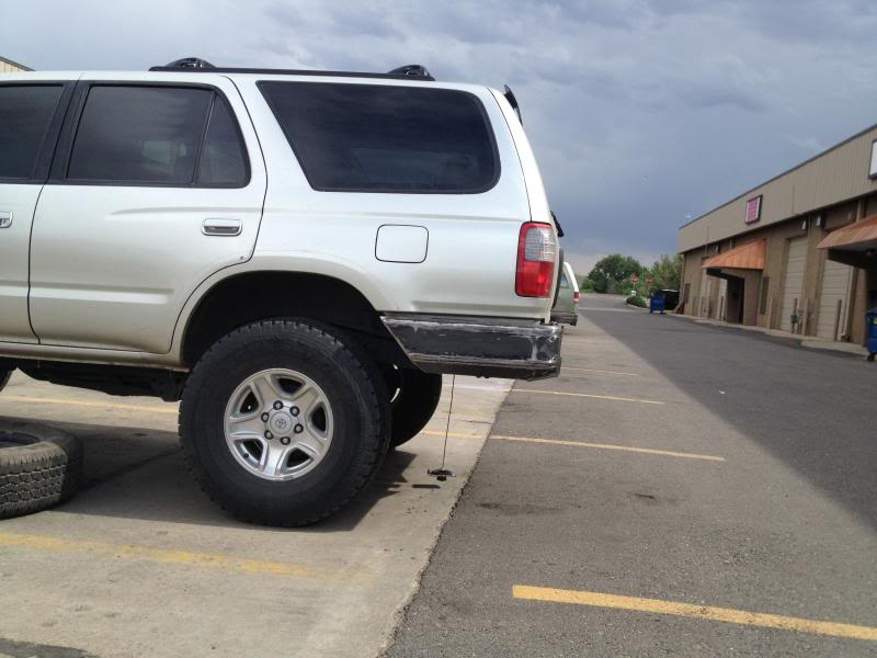

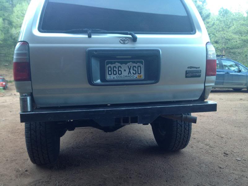

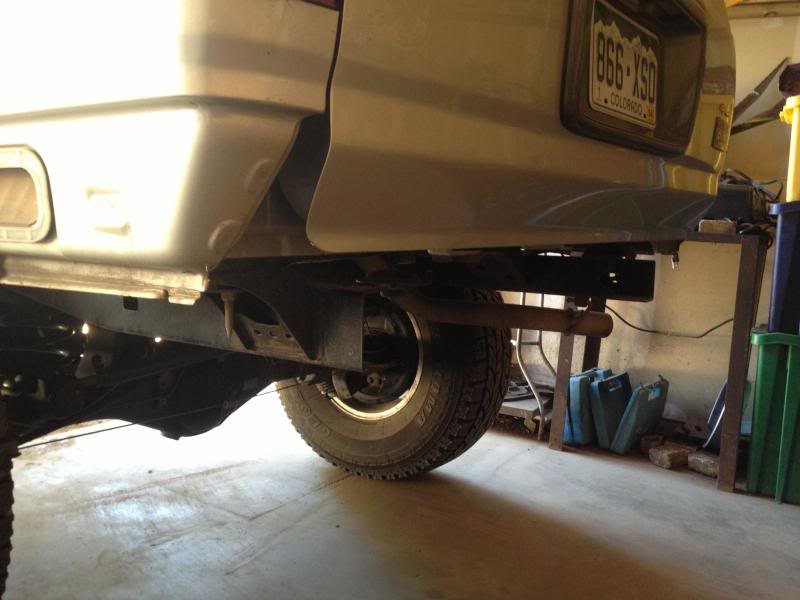

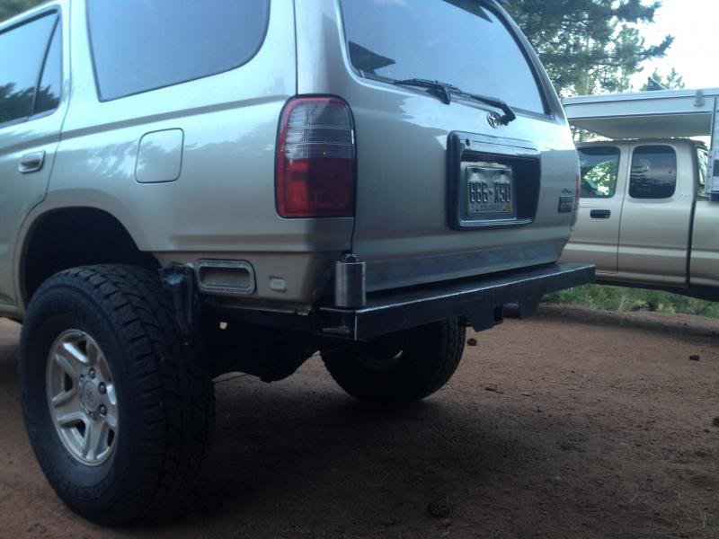

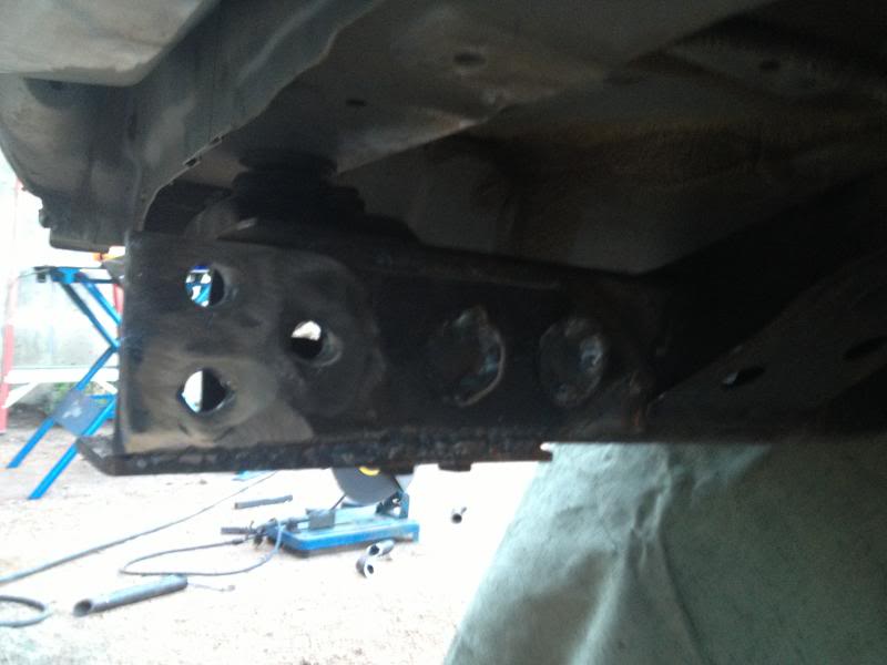

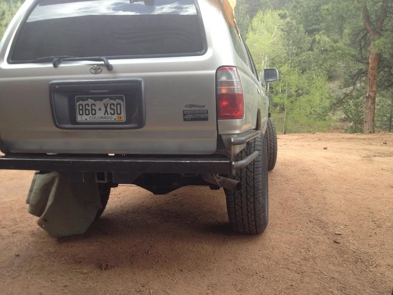

I then started work on my rear bumper.
I first cut the frame off at the rear body mounts, and welded in a new section out of plate. This is to help re-inforce the rear end as well as mount the bumper. Sorry for the blurry shots.

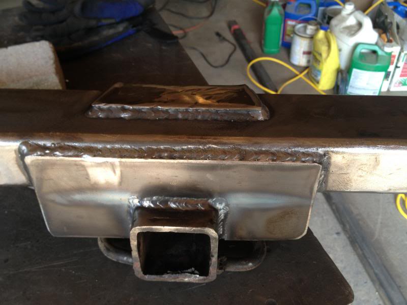

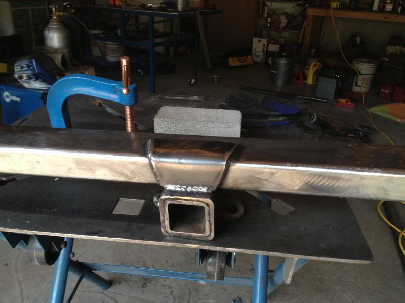

I cut the old hitch up to use the reciever portion, and made a new hitch, which will also serve as the backbone of the bumper.

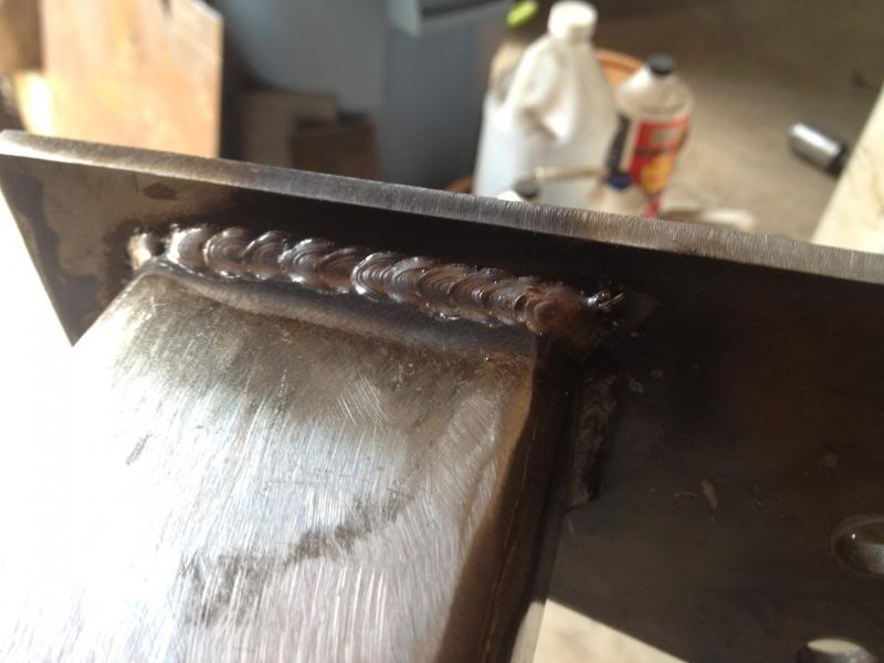

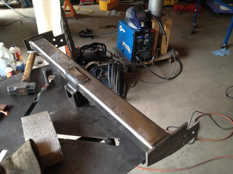

I then started working on the main bumper frame. The lower portions are 3/16, and the top plating and wing plating is 1/8".
I thought long and hard about how to do the wings, and eventually decided that Scotty and Addicted Offroad had the best idea for doing these side wings, and that is to cap the main end with plate, and use bent tube to make the wings. Just wanted to cite my references here.

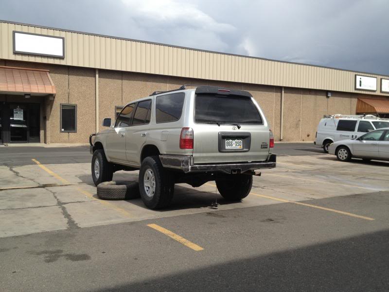

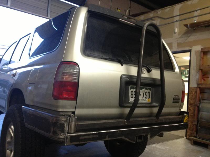

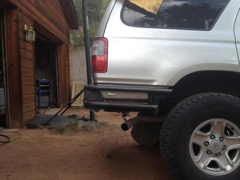

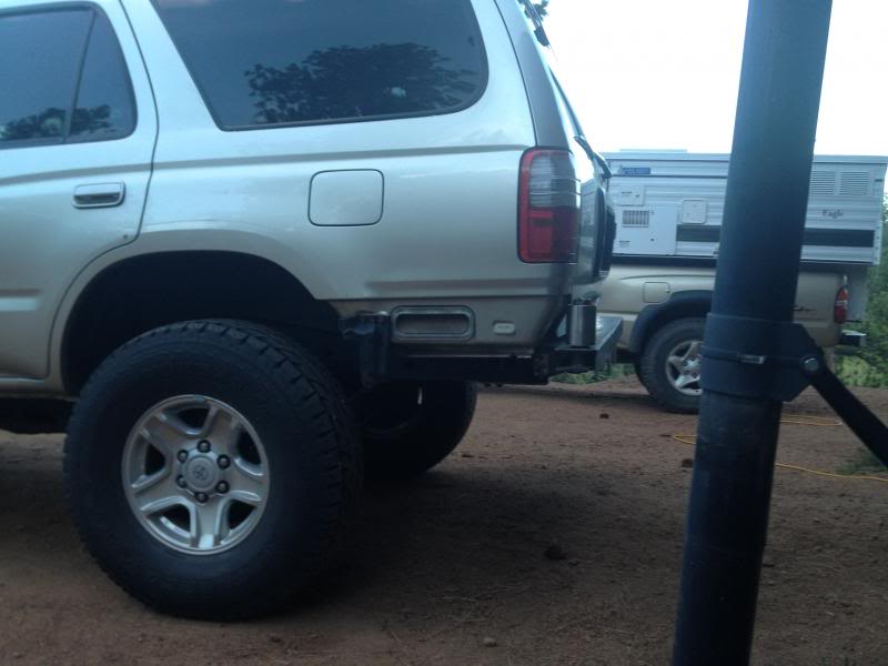

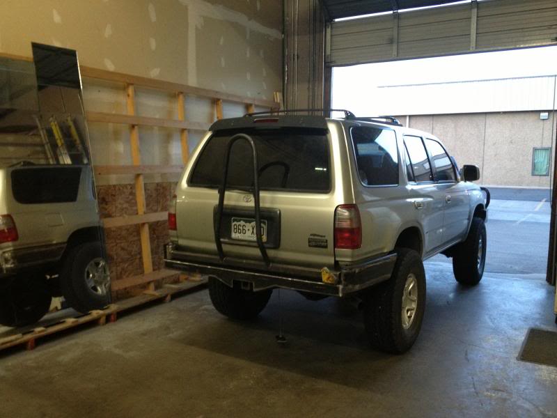

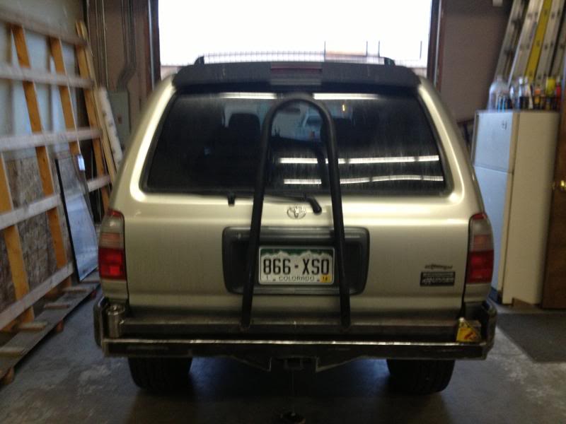

And that brings me to now. 2 nights ago I started working on the swing out and tire carrier. Got things mocked up in place and tacked in.
I'm working on gussets and plating now, and I'm thinking I will cut the swing arm down a bit to help with access when a trailer is hooked up, as well as just in general, not having to walk around as long a bar would be easier.
