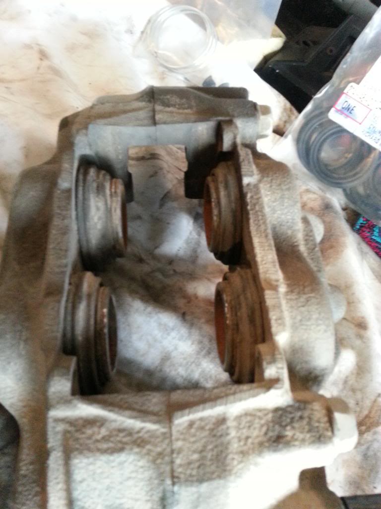

I startered with the brakes since there were vibrating really bad, did the tundra 13wl brake set up. I bought eveything from toyota till I realize the calipers are 400 a piece so i called yota yard(Yota Yard - Used Toyota Parts) bought some used ones for 60 each Name:  2012-12-29133040_zpsdb318b06.jpg
Bought toyota rebuild kits and rebuilt them

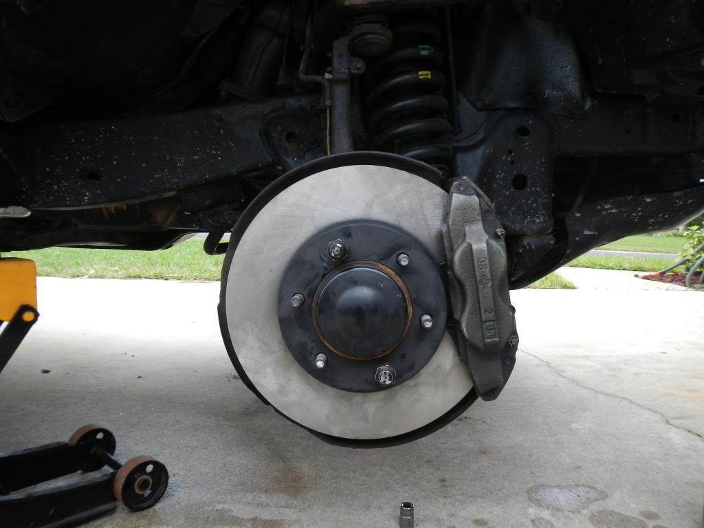

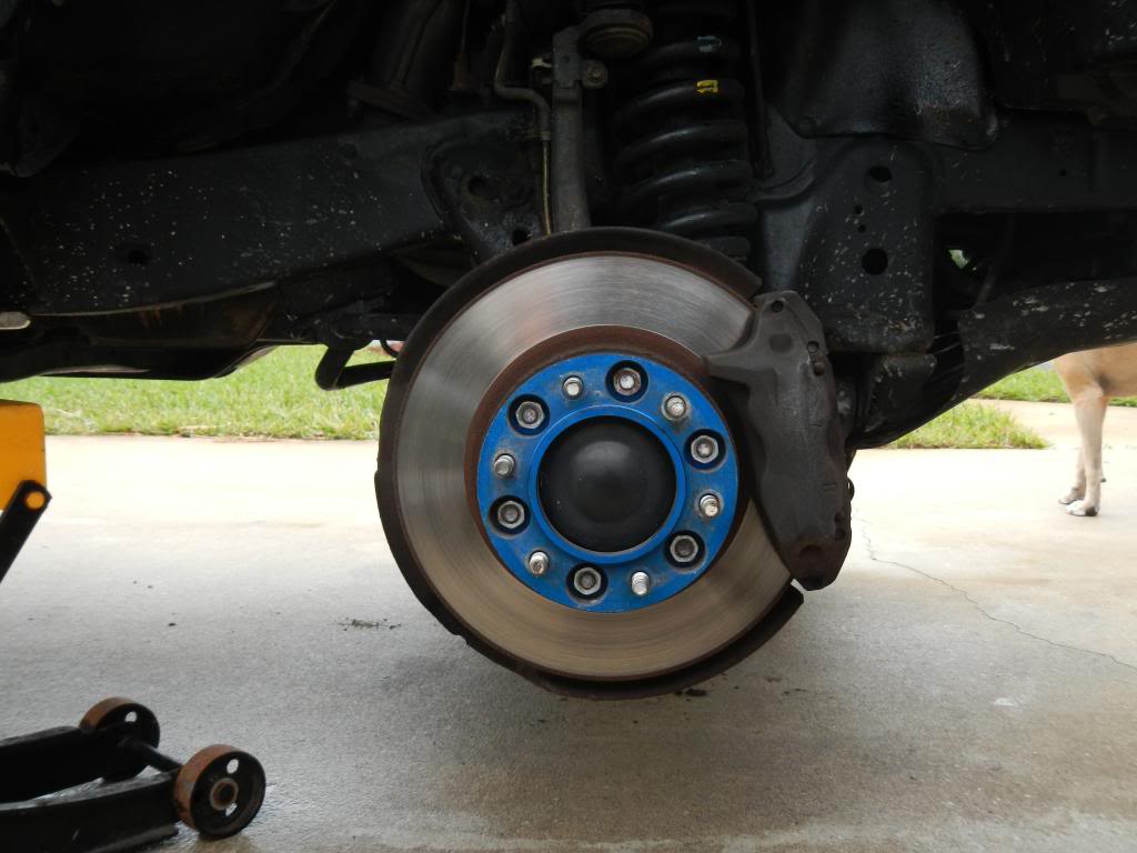

So I ended up going from this
to this

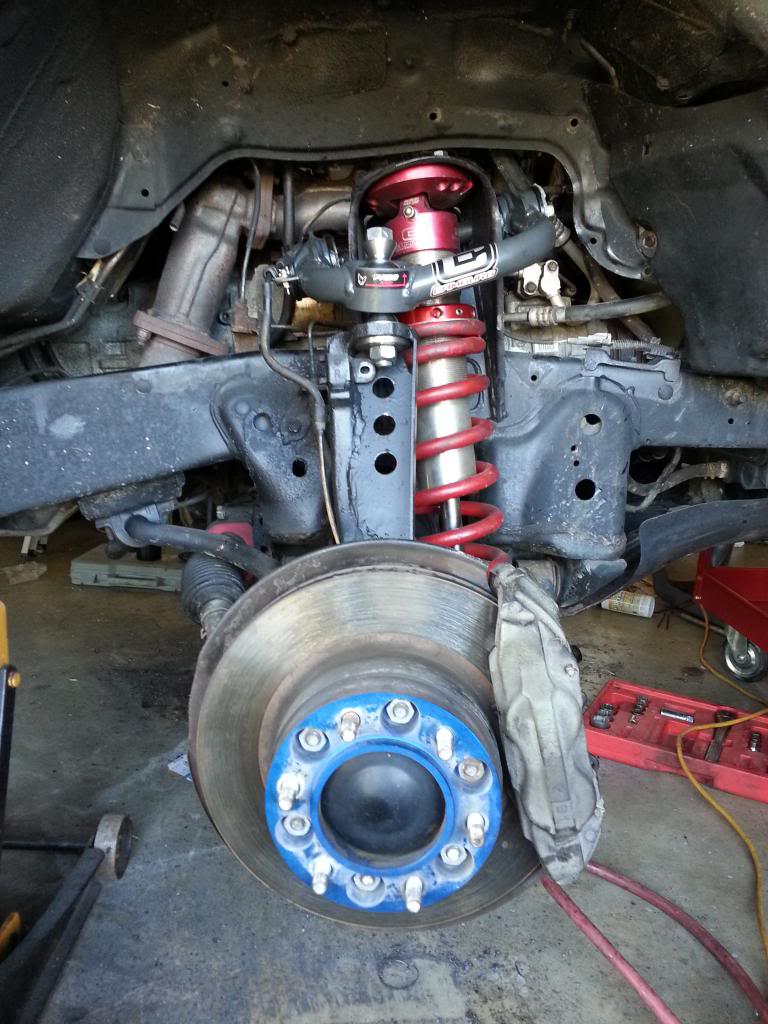

Next I stumbled on a crazy deal that i could not pass up for a pair of camburg coilover! i just had to rebuild them! sounded way easer the it was, probably took me over 2 months between ordering parts, parts not getting shipped on time, and trying to find some one to fill them with nitrogen. I started to get a steering wheel vibration, so I looked under the truck and the rack look like it was gonna fall out so i put energy suspension rack bushings in and made a world of difference!!! Once i finally got the coil-overs on i realized I needed the camburg uca to correct caster and get some more travel out of it. since i was doing all that i figured why not do the gussets to so I ended up Name:  2013-03-13092101_zps7add0338.jpg
