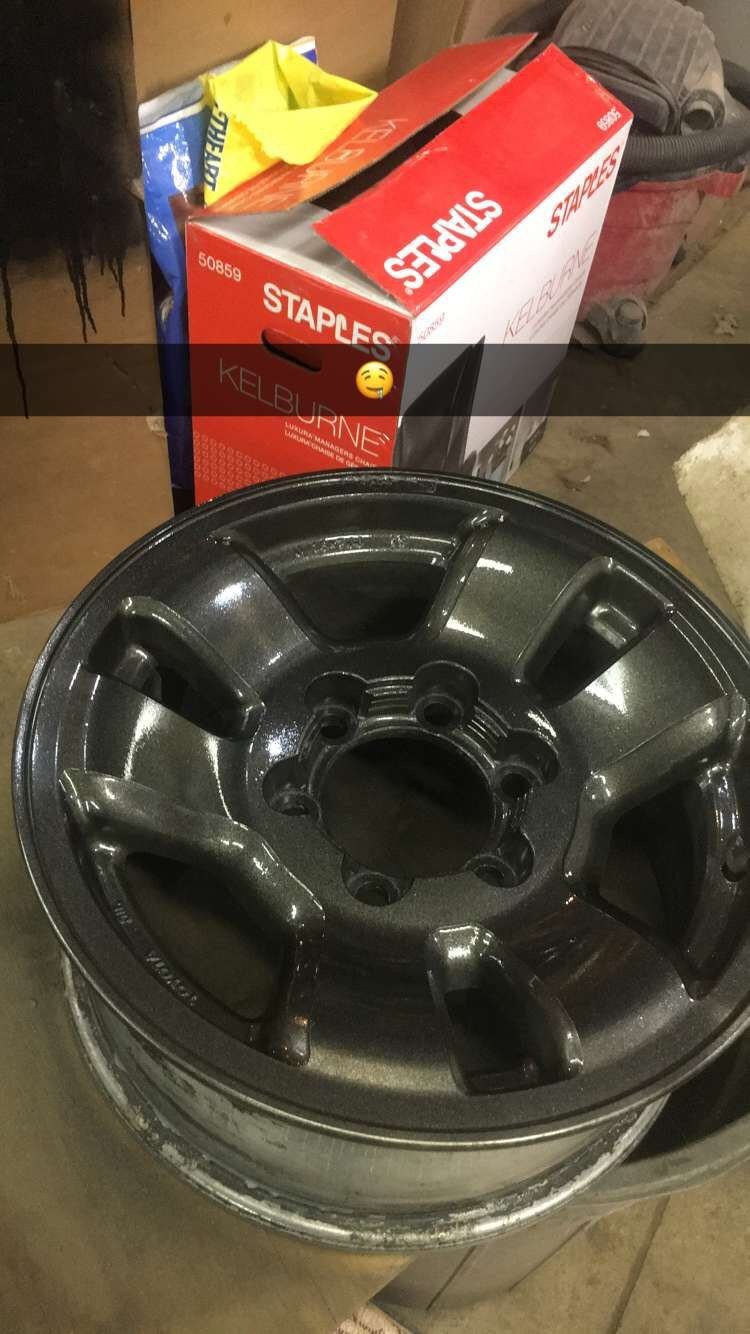

The first modification I had to do was to fix his bald street tires and terribly peeling wheels. So a little elbow grease and some left over 265 duratracs transformed the 4runner for around $40
