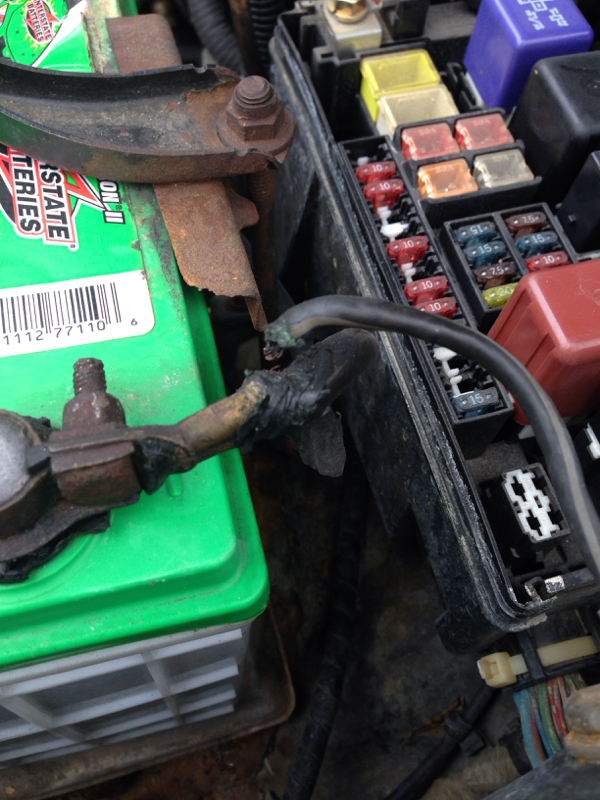

Are you having any electrical problems?? Is there anything happening that causes power interruptions or low battery voltage?
I have never heard of anything that keeps all those readiness monitors stuck at Not Ready. EVAP and CATALYST can take a while, and it can be hard to hit the Drive cycle but the sensor monitors should set ready almost instantly. That's why I am thinking there may be something systemic, like low voltage due to failing battery or alternator or bad battery cables or a ground problem. Speaking of that last, check the engine ground by the diagnostic plug, just for fun.

Reckon this is the problem?!?!? Sheesh....

Old Feb 5, 2014 | 02:59 PM
TheDurk's Avatar
Joined: Feb 2007
Posts: 1,262
From: New Jersey and Sao Paulo
Hehe, I bet it is. I'm thinking I called it.
Old Feb 5, 2014 | 08:22 PM
Nuthuts96's Avatar
Joined: Feb 2007
Posts: 419
From: Shelburne, VT previous: Everett, WA; Bellingham, WA
Damn Durk! killed that diagnosis!
