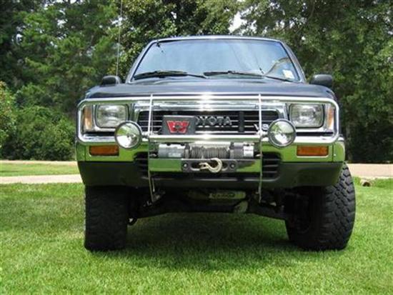

Anyone know where the cheapest place for a roller fairlead is? I found some on ebay for about $60 but I'm not sure about the quality. I'd prefer Warn.
