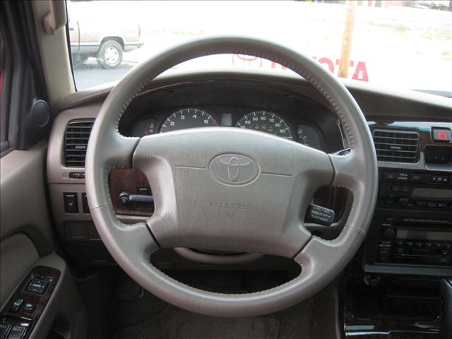

This is a 2001 4runner Limited. I see through the steering wheel a button where the RR Diff Lock woudl be (but I thought that wasnt an option on 01's), and then to the left, two more buttons.
What might these be, based on teh year and the locations?

I'm willing to bet, the button where you think the RR Diff lock switch is, is actually the Center Diff Lock switch (same switch on mine). This switch looks the center diff when in 4wd. '01 and '02 4Runners had no oem rear locker option.
The button to the far left of steering wheel looks like the oem alarm light.
Can't tell what the other switch is...too hidden.

If you hit the button on the transfer case shifter you have put it into All-Wheel Drive. Once you hit the Center Diff Lock button you put it into true 4-Wheel Drive.

The two buttons grouped to the far left are for heated seat controls. The one more to the centre is the centre diff lock

Center diff lock provides a 50/50 torque split between the front and rear. A rear locker does just that, locks the rear axle.

The question has been answered. They are seat heater controls.
