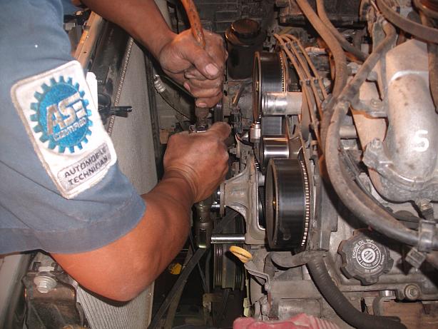

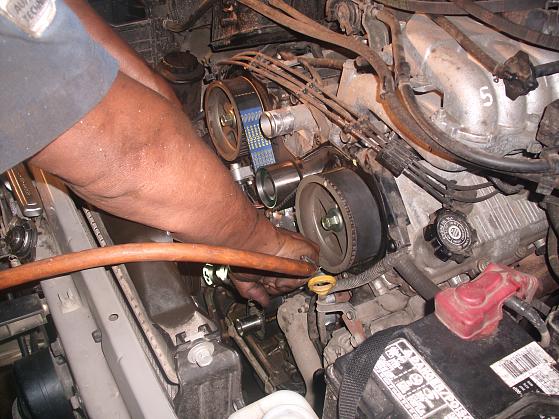

Did another t-belt and 90k service interval on a 2001 4-runner 3.4 V-6 today.
And the t-belt sang a song... i think the noise is called harmonics. i just tried to take-up a little bit too much slack in the belt at the tensioner itself.
And i was'nt about to take the tensioner all back out again cause' one of those bolts are a pain to get to.. ha!
But the jobs done and there's goes another happy toyota owner!
Here's a peek of the job in progress.
Attached Thumbnails What is this noise-01-4runner-t-belt-005.jpg   What is this noise-01-4runner-t-belt-024.jpg
