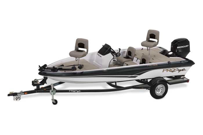

I pull a procraft 165 (approx 1300lbs) with my 03 Tacoma 4x4 with the 3RZ,auto trans and no mods but a K&N air filter. On a fairly steep grade it will barly do 50mph and is almost tacked out in 2nd gear. I can swear you can see the gas guage move also! I figure I get about 10 MPG. On the highway going 70mph it will kick out of overdrive on overpasses alot as well.
Attached Thumbnails What Can You Pull/Tow with your 3rd Gen. 4Runner-procraft-165.jpg
