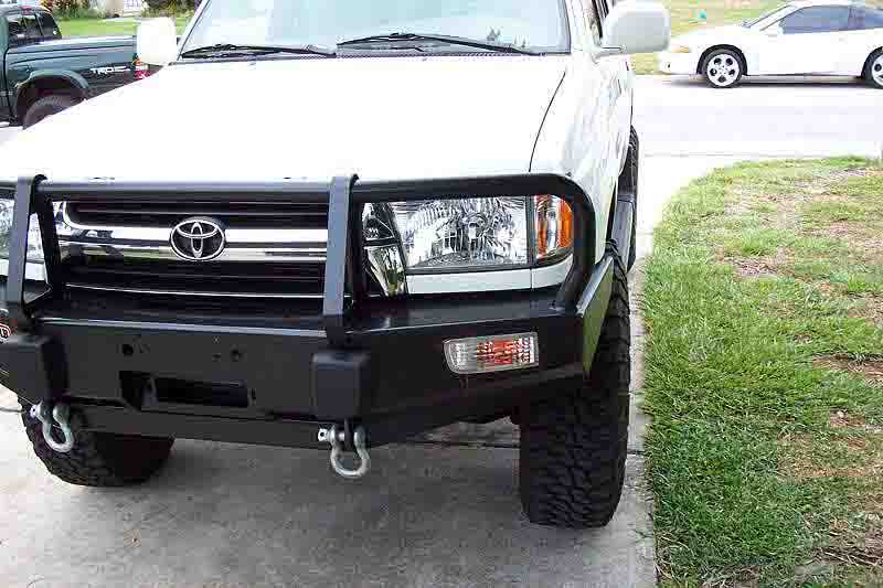

Heres a shot of TacoRunners 4Runner w/ARB Taco bumper and Taco turn signals fabbed into it. All you'd need to do is add aux lights.
