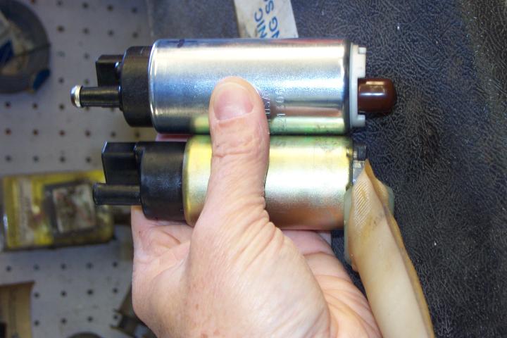

The Walbro fuel pump install is complete and I took some pictures but they are really of little importance. I may post the picture that compares the two pumps that supports the fact that you have to cut off approximately 1/2" of the fuel line to compensate for the taller pump. My mechanic wanted to know why the suppliers of this pump kit could not go the extra mile and supply a complete harness instead of expecting the installer to cut and splice the Walbro connector. I can assure you that my guy has no problem making up any kind of harness but he was curious as to why the half measure when everything else was included. Of course, if the tube cut is the same on every vehicle, that also could have been part of the instruction sheet. I agree since you never know what level of expertise the person installing the pump has. I am not criticizing, just suggesting. I have not driven the car yet but will tomorrow but I do not expect to notice anything enlightening.

Here is a pic of the two pumps so you can get a fairly clear idea of the outlet variation.
