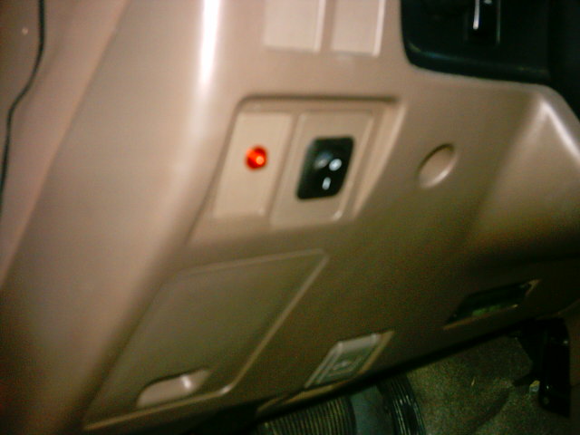

Finished Project
Here it is...the completed switch on the Andymod! It works great! Thanks Andreas!
Attached Thumbnails VSC / TRAC defeating - is anyone closer?-imag0081.jpg

emptypockets,
The switch looks like a clean installation - good job! Now go behind the nearest WalMart and lay some rubber!
Andreas
