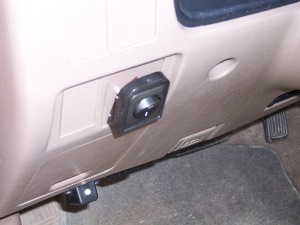

My Trac off switch
Here are a couple pics of my trac off switch, not as pretty as Andy's but still satisfies the goal. Straight line is trac on, circle means its doughnut time!
Attached Thumbnails VSC / TRAC defeating - is anyone closer?-100_0266.jpg   VSC / TRAC defeating - is anyone closer?-100_0267.jpg

Sweet!
AndyMopd
AndyMod™
Andreas
