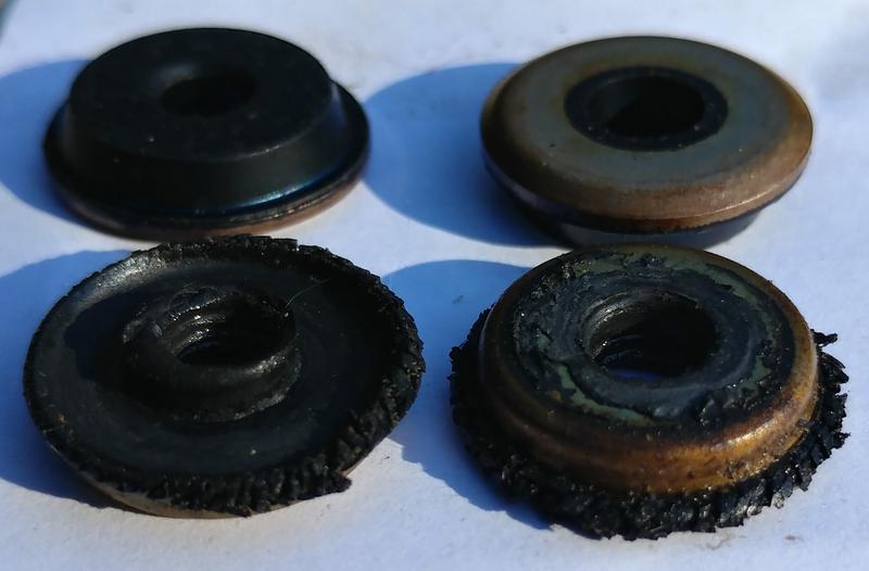

The grommets from a 96 3.4 after 282,000 miles...
(pay no attention to the bolt in the pic, it's for the plastic wiring cover)
Compared to above, you can see what Jomoka is talking about.
I also measured the new vs old valve cover gaskets. The old one was also compressed to a shorter height.
Re-using the old bolts has been no worries, but with a torque spec of something like 6nm or 53 inch lbs I didn't expect any.
There is a pattern when you are tightening them.
When you tighten those bolts stick to the spec, have seen people manage to break the valve cover with too much torque.
Note: Toyota valve cover grommets were shaped differently than the ones that came with my Yotashop headgasket set. When I pulled it apart for a head gasket job with 30,000 miles on the valve cover/toyota parts job it was dry. I used the yotashop grommets supplied, those lasted less than a year.
Toyota in back, Yotashop (brand unknown) in front with about 6,000 miles on them:

Guys, thank you for the responses. I won't worry about new bolts then, but I will make sure to replace the cupped, rubber seals/grommets.
