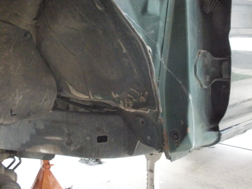

The offending area is the triangular spot:
I mocked the tire up at full stuff, drew some lines, and got to cutting. I drilled some holes where my lines where so I could triple check on the inside that I wasn't going to be cutting into anything.

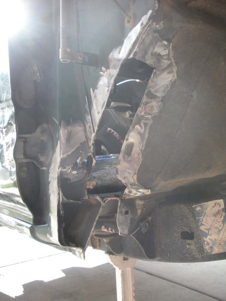

This is what I ended up cutting out. If you look closely at the bottom of the cut near the floorpan you'll see a > shape. With that area cut out the rest of the fender well had some good slack that allowed me to massage the fenderwell back with my rubber mallet. Which is part of the reason I didn't have to cut the whole fender well out like Steve did.

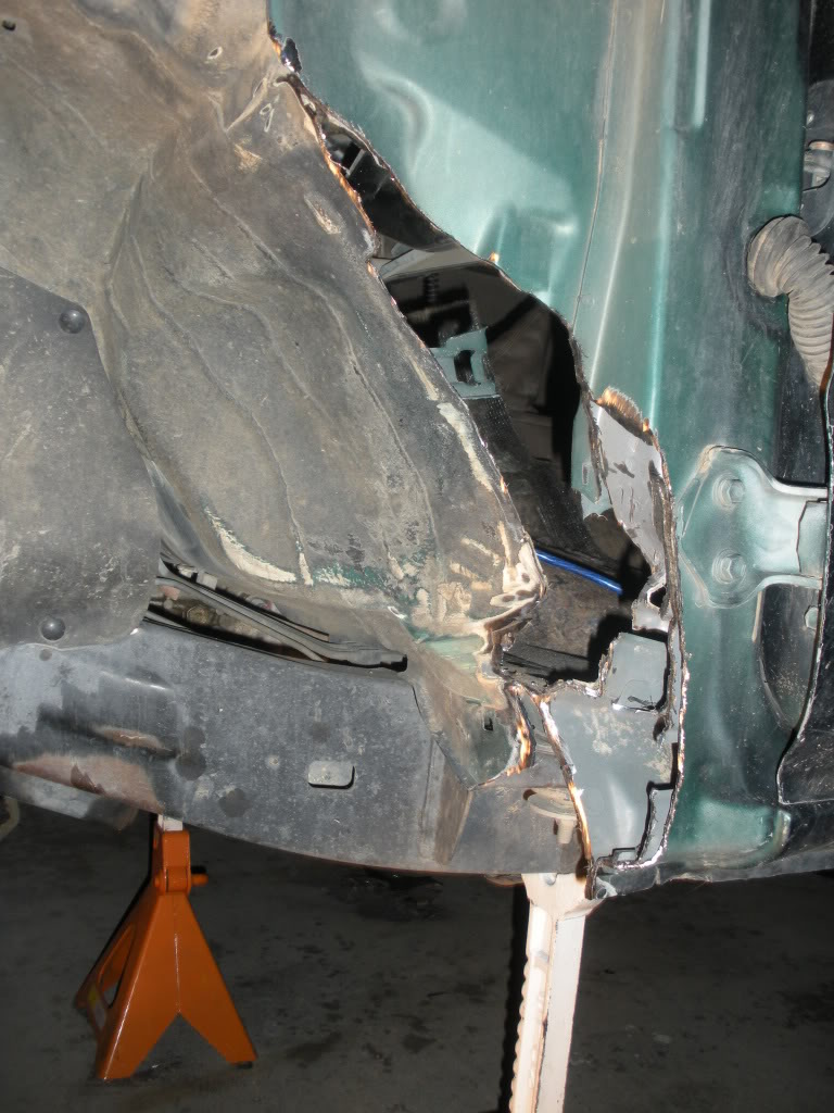

I decided to cut out everything and do all the plating/ welding at once. So I moved to the drivers side and let loose. The drivers side was already miss shaped by my rubber mallet to keep my old 33s from rubbing, it looks weird.
But I made some more lines, did some and this was where I was at.

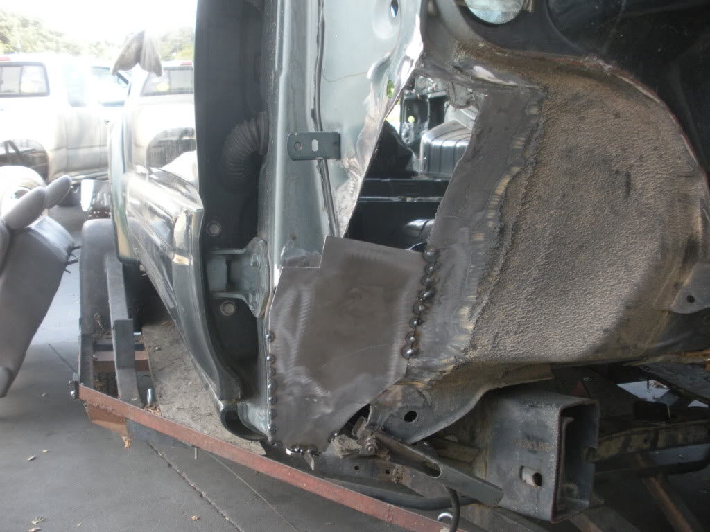

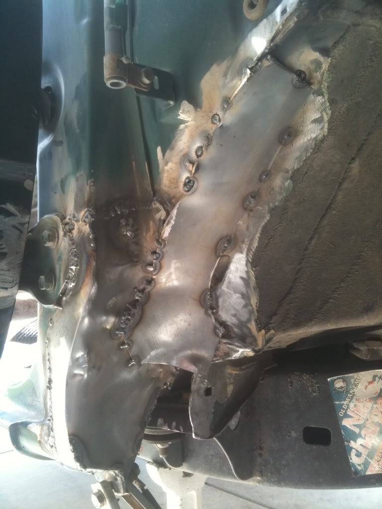

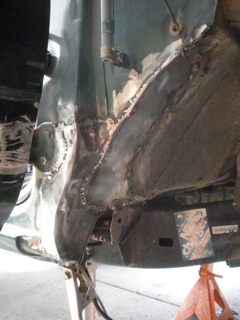

The next day it was on to the plating. Started with the passenger side. I did it in two steps, first the lower outside part. Wrapped it around the side as well.
Then the upper:
Here it is all done.
Yes that door hinge is now welded on. If I need to remove the door by the bolts I will pull the bolts from the door. Or I'll just use my quick pins.
I ended up putting a bunch of silicone on it. Inside and out. I'm going to get some herculiner and put over it at a later time.

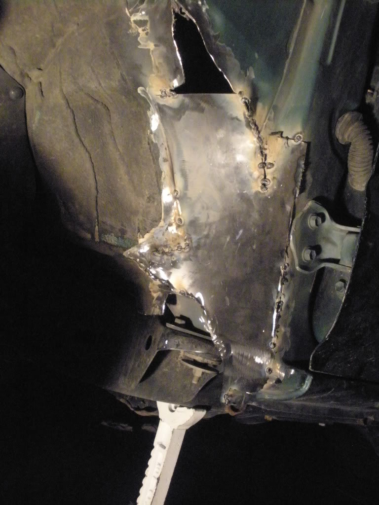

Then it was onto the drivers side
I did this without the wrap around. I had to cut more from this side so I didn't have much room to wrap it around. Burnt through a couple times but got it all covered.
Once I got to this upper part, I did wrap it around. BTW, When doing this part I'd advise to put a wet rag inside the truck to keep the flames down.

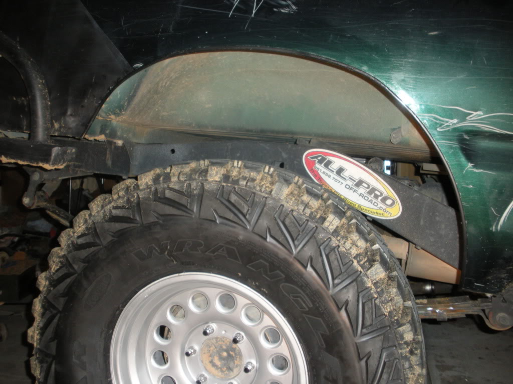

The rear is done at this moment in time. I took out 1" and it was good on the first try. Lined it with some door edge stuff per the TLT 4Runner clearance writeup. Going to be pulling that and using some pinch weld primer and then put some of this stuff on: http://www.mcmaster.com/#edge-trim/=9ftrl8
Not only does the edge keep the sharp fender from messing up the tire, it also helps to smooth out the lines.

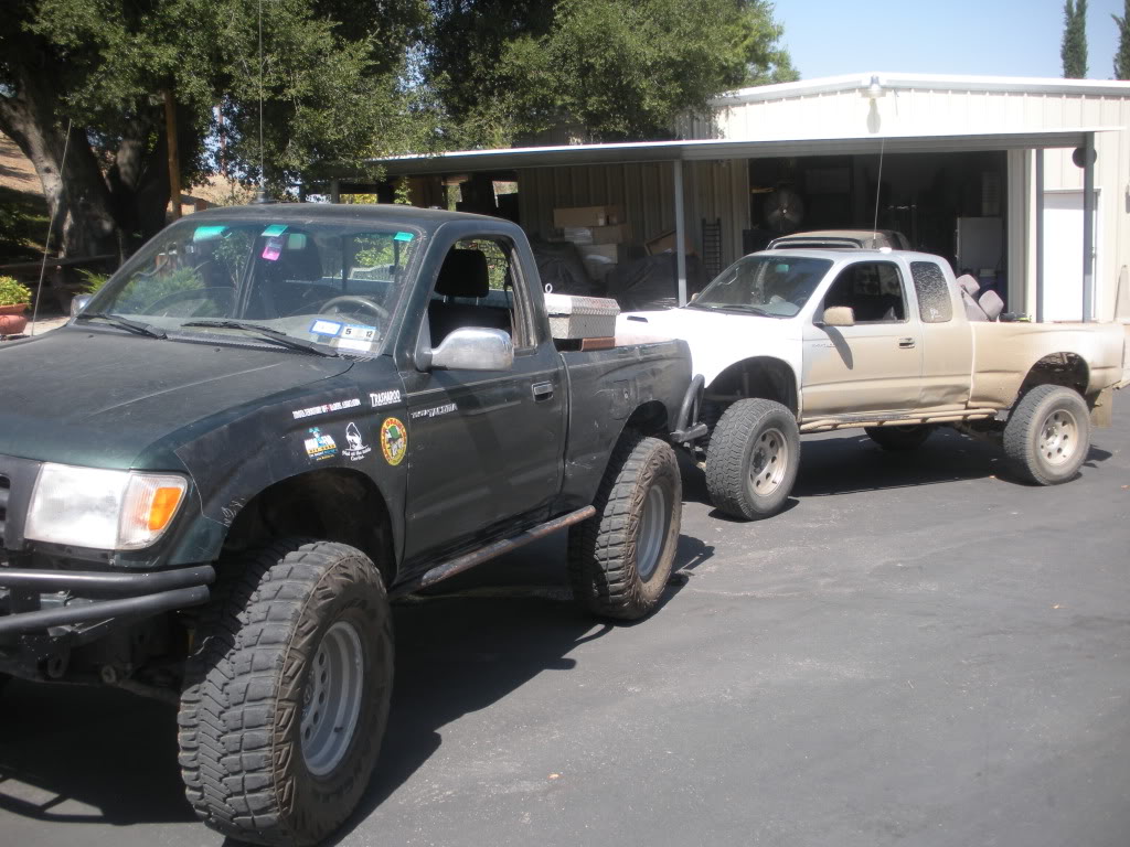

I helped a friend tub his 4Runner today. Well, half of it. He asked me to assist since I have the experience doing it.
My truck and RJ's truck

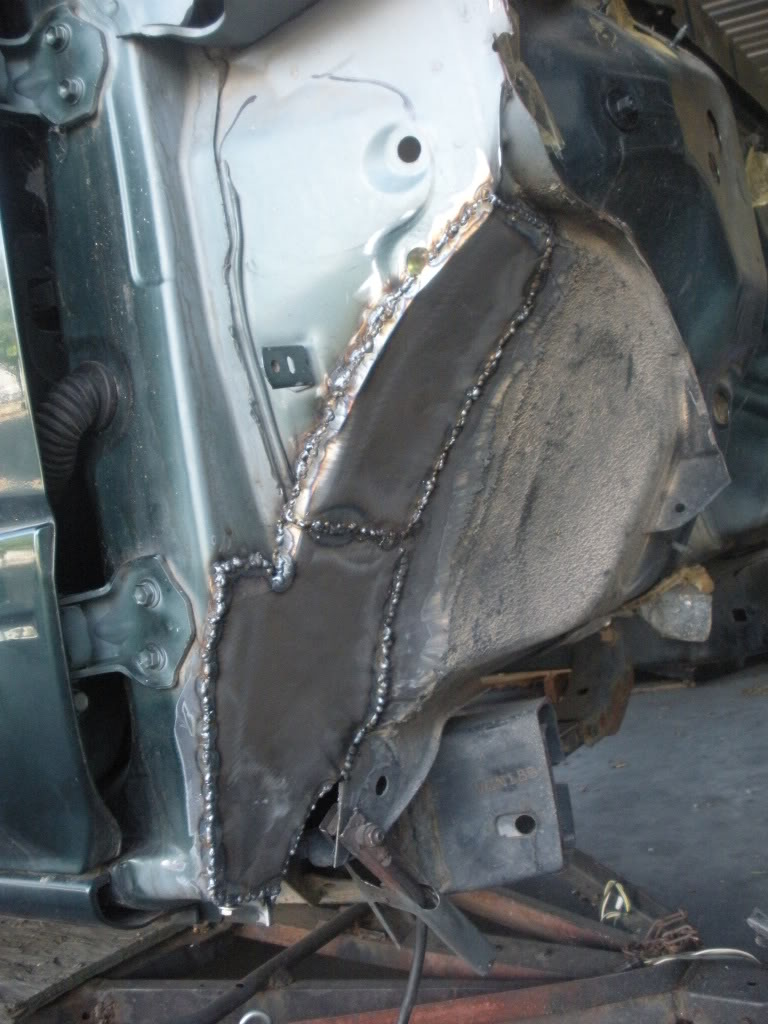

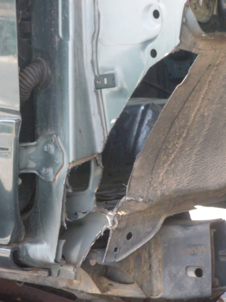

The cut
Dremeling out the stripped out captive nut for the fender

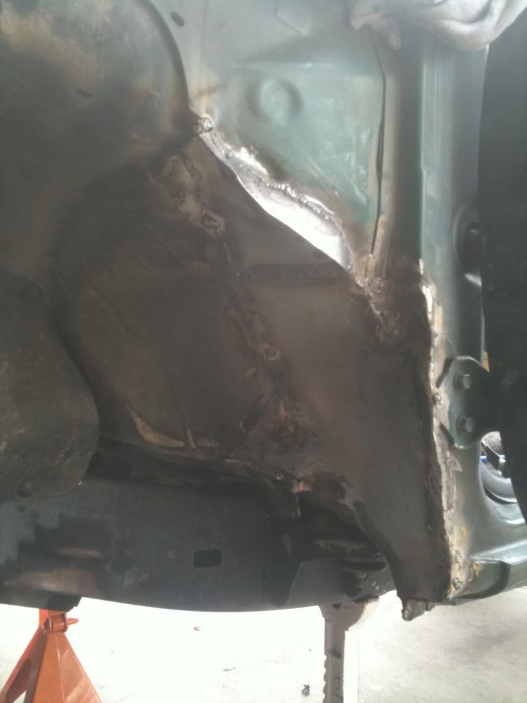

Lower section
And upper section
We did that in about 4.5 hours. It took me a lot longer since I kept mocking up the tires every hour.
