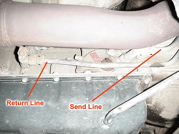

When looking from under the front bumper, you can see the 2 steel transmission lines. Can someone tell me which line (the left or the right) is the line that sends the oil from the tranny to the cooler. Thanks, would help me out.

Check this pic. I believe the send line is the outside line, on the left when looking back from the front of the truck. So the inside line is the return.

Old Jul 27, 2010 | 05:08 PM
J2F42C's Avatar
Joined: Feb 2010
Posts: 570
From: Outer Banks, NC
Left one.....
Old Jul 27, 2010 | 06:52 PM
hdoggie24's Avatar
Joined: Sep 2009
Posts: 86
cool. thanks just wanted to double check on that. just finished up my tranny cooler install and i was pretty sure i hooked it up right. thanks. i know have piece of mind that my tranny will never get the milkshake crap.

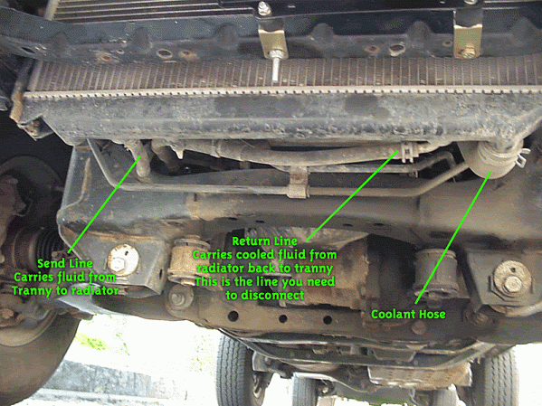

Aren't these contradictory?
Attached Thumbnails which transmission line heads to the tranny cooler?-bypass.gif   which transmission line heads to the tranny cooler?-cooler_09.jpg
Yes they are, the second pic is mislabeled. If that is the case, that Magnefine is not working as well as it could be for the flow is going backwards....
