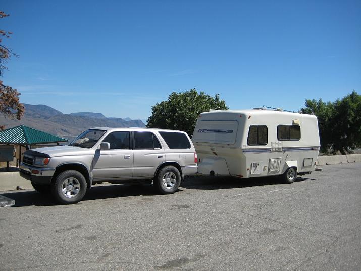

Well it's been quite a while since I started this thread, but since someone replied to it and brought it back to life, I may as well provide an update on my towing experience. I towed the trailer from Calgary to Tofino and back, through the rockies, and taking the 'scenic' lillooet-whistler route which was recommended to me. Overall, the towing was OK. In a head wind I could really feel the drag. The lolloet detour was a bad idea, and had some really steep sections. On the average 'steep' hill, I was going 60 in third gear so she was kind of struggling. People wizzing past me, while I'm clutching the stearing wheel and leaning as far forward as I can to help the rig up the hill. It was middle of summer, and 30+ degrees C outside. What really worried me was after a long hilly stretch, the metal shaft of the stick shift (I have manual transmission) would be hot to the touch, like almost uncomfortable to keep your hand against it for too long. Same with the 2H-4H-4L shifter shaft. That tells me the gears are piping hot, probabaly not a good thing - and causing a lot of wear.
