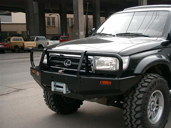

The standard ARB Tacoma Bull Bar lines up very well with the 4runner's SR5 flares.
Gratuitous poser shot:
I prefer the smaller hoop on the ARB versus the hoop on the TJM-15. I also like the clean look of the T-17 and almost went that route.
