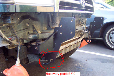

After a discussion I had with another member (WATRD) about bumpers, I fired off an email to TJM in regards to 2 issues
1) What's the deal with the air bags and the TJM-15 bumpers?
2) Can the holes on the brackets which mount to the frame rail ends be used to hang D-shackles and be used for recovery tow points? See this image for the holes I'm talking about.
This is conversation with TJM:
-----Original Message-----
From: DAVID BIENVENUE [mailto:davidbienvenue@msn.com]
Sent: Wednesday, August 06, 2003 12:20 PM
To: info@tjmbullbars.com
Subject: RE: TJM T-17 shackle mounts?
Ryan,
The holes I'm talking about are actually on the brackets that attach to the end of the frame rails, not on the bumper which is then attached to those bracket. There is a hole on each bracket that looks like it was designed to hang D-shackles off of. I realized that I have the T-15, not the T-17, but I think its the same for both bumpers.
David
Response:
G'day David,
Sorry for the delay in getting back to you. I was mistaken on my first email to you, I though you were inquiring about different holes. The holes on the bottom of the mount kit that you describe were meant to be tow points. You are also correct, the mount kits are the same for both the T17 and T15. Let me know if you have any other questions. The bar has not been tested for airbag compatibility. This does not mean that it is not compatible, it simply means that we have no data to show whether or not it is compatible.
Regards,
Ryan Parrish
TJM Products USA
www.tjmbullbars.com
So, to summarize, yes, you can hang shackles off those holes, and the airbag compatibility has not been tested. Just a little FYI for ya!

Work quite well actually.

Yup! Its not that I didn't believe you Steve, but it didn't hurt to get collaboration from the company itself. I'm probably going to get a little bit of reinforcement added on like you did.

Little bit my I added a full 3/4" of material to each side.

Also, I was concerned about the strength of that material for a recovery point. Ryan stated that they were meant to be TOW points. I'm thinking there may be a big difference in "recovery" and "tow".

My bumper is without a doubt the steel one. I customized the mounting as well. Pulled a full size Jeep Wagoneer out with those points at the Mini-AZ4RJ last November.
That's really good to know. I was ready to leave hooks on the frame and ignore the holes. Did you use round bar stock on either side to fill the shackle space?
Yes, that is exactly what I did. I also beefed up the front mounting point inside the frame rail.

Mine didn't come with the tow point. It's a TJM t15 with part number 1586W. Looking at the pic, it seems to me that the 96-98 mounting brackets have these and not on the 99 and newer mounting brackets.
