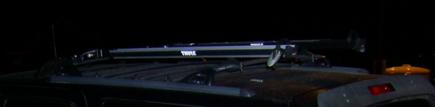

I attached my two Thule bike racks directly to my factory load bars. Unfortunately, the only picture I have with me is one I took at night, hopefully you get the idea. I used all of the mounting hardware and purchased some additional t-slot bolts. I removed the front load bar from my runner. I then removed one side of the front load bar, and slid the rubber strip out. This exposed an open t-slot down the length of the bar. I slid the extra t-slot bolts into the load bar, reattached the side and put the whole thing back in the rails. It was then a matter of attaching the bike racks.
