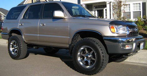

The rim sizing you show will work; I almost got the same rims, but ended up getting different ones:

Originally Posted by hross14
Just kidding--i just never understood the 4x4 combined with the Bling--Something to think about though is whether or not you want to eventually upgrade to larger tires (33's or 35's) you would want a 3 5/8 BS on 6 on 5.5. Just thoughts about planning ahead. Micky Thompson classic II's have that size.
would that backspacing work with my current tires though?
and nice rims skjos

4.5" of backspacing will be fine with your stock tires.
My rims are 17x8.5 with 4.5" of backspacing. They fit my 265/70r17 just fine, in fact they also fit 285/70r17 without any a-arm issues, but I didn't feel like trimming the crap out of my wheel wells.
265/70r16 and 265/75r16 will both fit nicely with 4.5" of backspacing, however, if you have running boards the 75r16's may touch a little when turning sharply.
