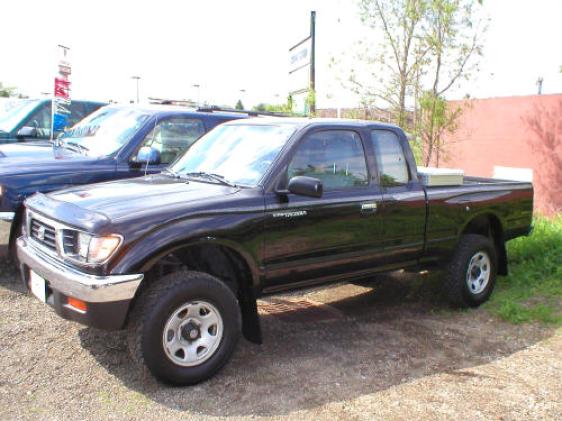

Smile
Just to let everyone know that gave me useful information to my question. I did end up purchasing the Tacoma and so far so good. No big problems yet and it runs great. I love it. Even though it is a 1996 and I have had newer vehicles, this is my favorite car/truck yet. It is amazing how great it runs with 117,000 miles on it. I have owned other cars that didn't run that smooth with 50,000 miles on them. Anyway, thanks for the help and this is a great message board. Now for the mods...
