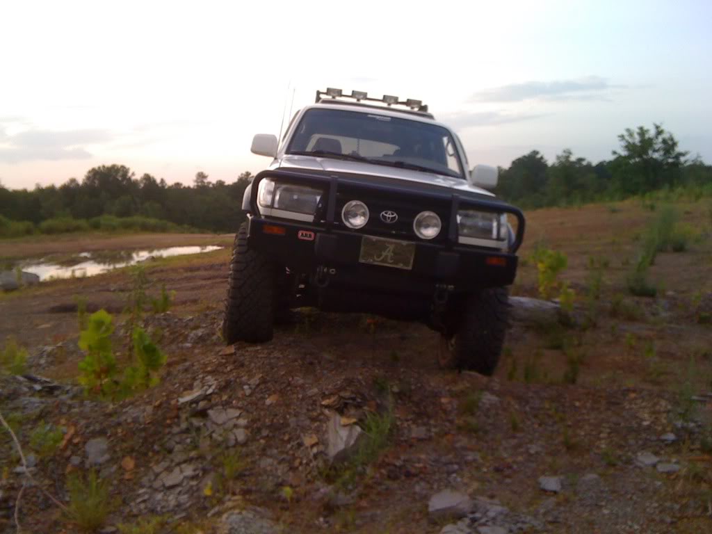

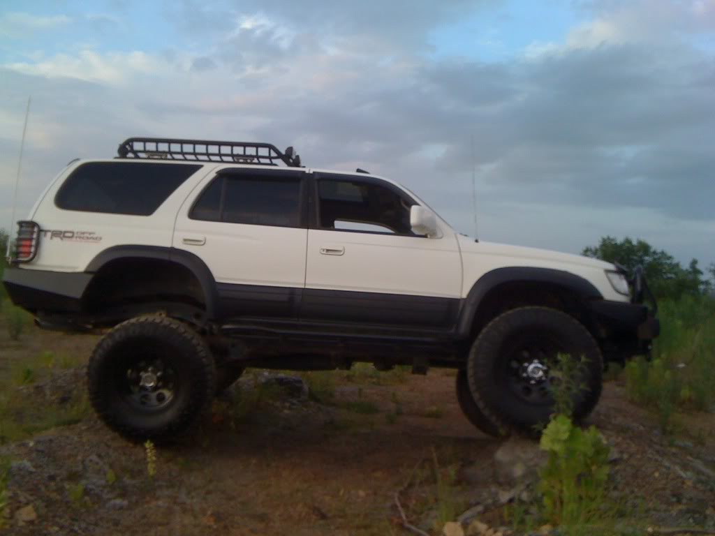

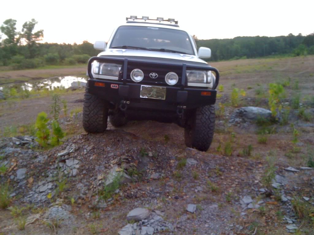

And as promised pics... No measurements though, running out of daylight...
Before: Front sway bar connected...

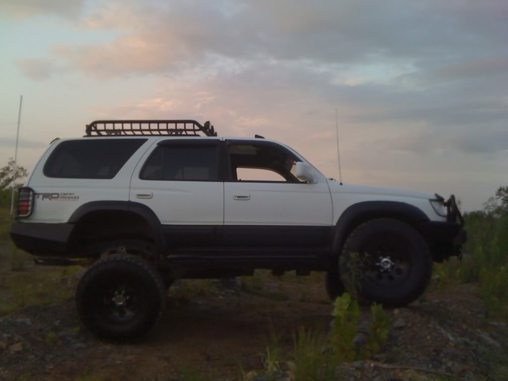

After: Front sway bar disconnected...

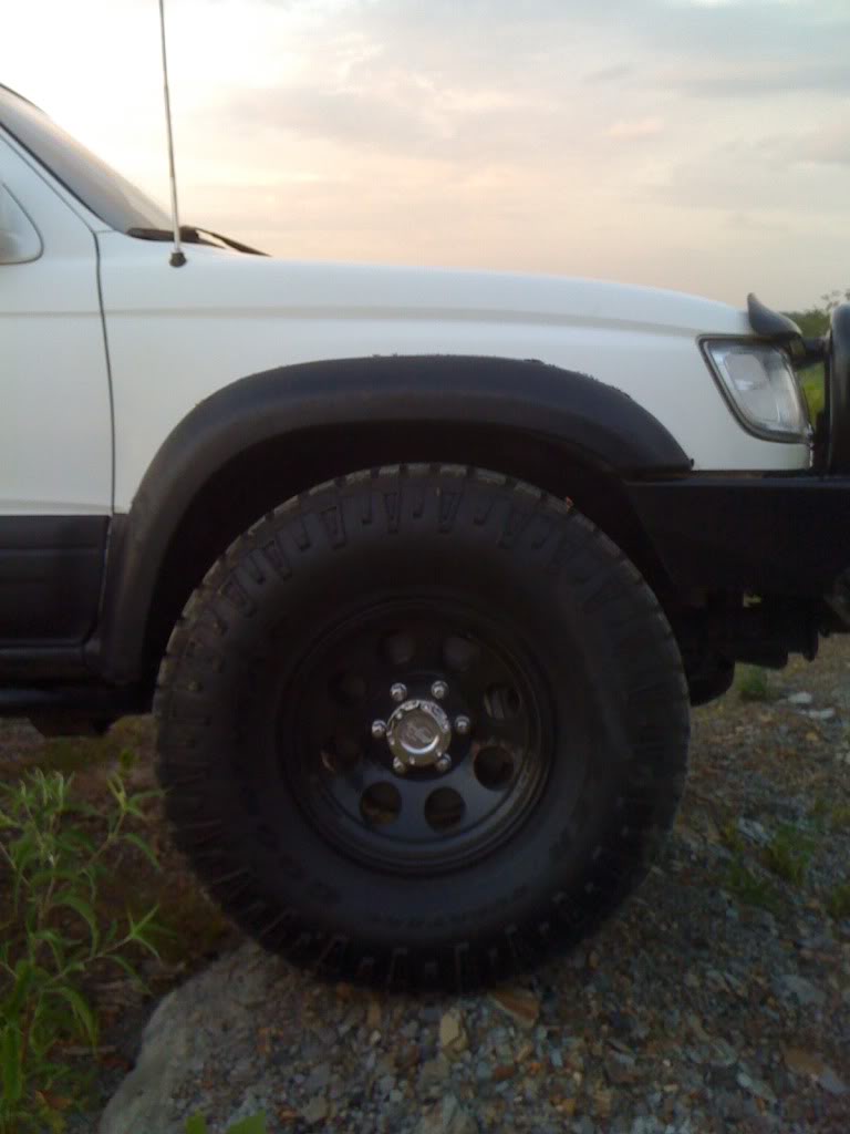

So yeah... I'm a beleiver???? Front stuff with a 35" tire - CloseUp...

has anybody seen the photos that Kregg just posted? He's showing compression not droop.
In some people's defense, disconnecting the swaybar does not give you more travel. The only thing that will is modifying the upper and lower bump stops or adding a bracket lift and not extending the bump stops.
What it does do however is allows you to use more of the travel that you already have. How? By taking the stored energy in the swaybar out of the equation. With the swaybar disconnected the swaybar is no longer "pushing" up on the frame, which takes away from the ability to stuff the tire right to the upper bump stop. On a harder hit on the terrain you won't see as much of an advantage as the force on the tire pushing it up is much greater. Where you really see the benefit is when crawling.
As a side note, you won't see as much of a benefit if you are running a stiffer spring, stiffer shock or have your torsions bars cranked more. WHich is probably why some people are seeing between 1" and 3" of travel "increase"
The same goes or the "added" droop but for the opposite reason. The swaybar will no longer be "pulling" up on the tire allowing it to droop easier to the lower bump stop.
