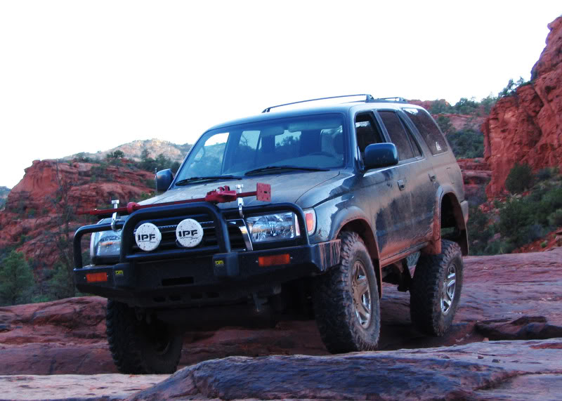

Quick Disco's are the way to go. The links Brian makes are BEEF. I have them on my 'Runner and love them. 19mm socket/ratchet and the bar is disco-ed in 5 mins or less. Perfect for a weekend wheeling trip!

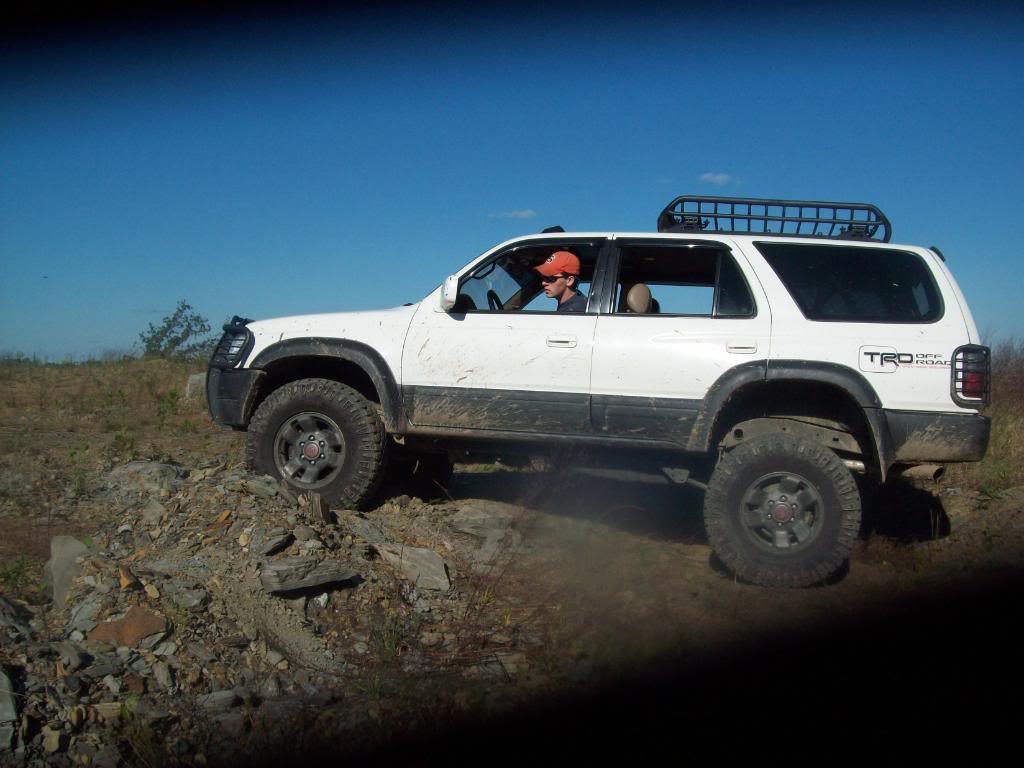

And flex with the bar disconnected...
Quick Disco's are well worth the money, IMO!

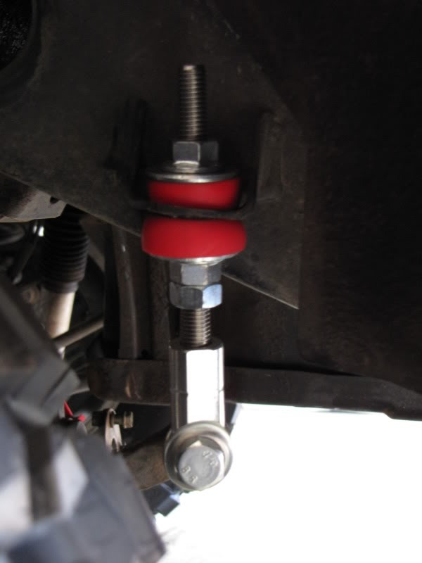

You can make your own endlinks that look exactly like those overpriced ones for about $40/pair.
All stainless hardware. Aurora heim joints. All metric. Dick around on McMaster for an hour and you'll find everything you need. I'll snap a pic of the front ones in a bit.
It was a night and day difference handling wise after I put these on. So much more stable on the road. Steering response really sharpened up. Almost no slop when compared to the OEM ball joint links.
Disconnecting the sway bar yields minimal difference in flex, but it does certainly put less strain on the bar and links. And trying to secure the bar so it doesn't contact suspension components or CV boots can be tough.

Originally Posted by Midget96
...Disconnecting the sway bar yields minimal difference in flex...
I beg to differ bud.
Same rockpile out behind the house, sway bar still connected. Notice the lack of compression in the front compared to the other picture I posted.

Originally Posted by waskillywabbit
Key words here: LOOK LIKE
You cannot even buy the pair of heims I use for $40.
Again, buy what you want, make what you want, but these are high quality, beefy parts that will last. Never had a set returned for breakage.
Why do you need a PTFE lined heim joint for a part that uses a fraction of their range of motion?
I can buy 6 of the metal/metal joints for the price of one Delrin joint in the extremely rare instance that the cheaper ones wear out.

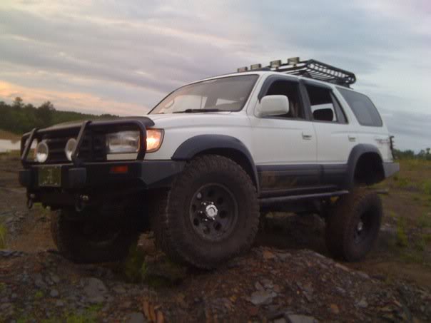

I've got more flex than that with my sway bars disconnected, so it doesn't matter to me. All disconnecting them does is let point parts flop around as your suspension cycles. The 1/2" at best of increased travel isn't worth for 90% of wheeling. If I was rock crawling for an entire weekend, I'd disconnect them solely to prevent breaking the links or sway bar bushing mounts.
Flex with swaybars connected:
