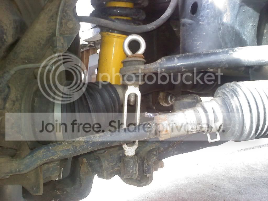

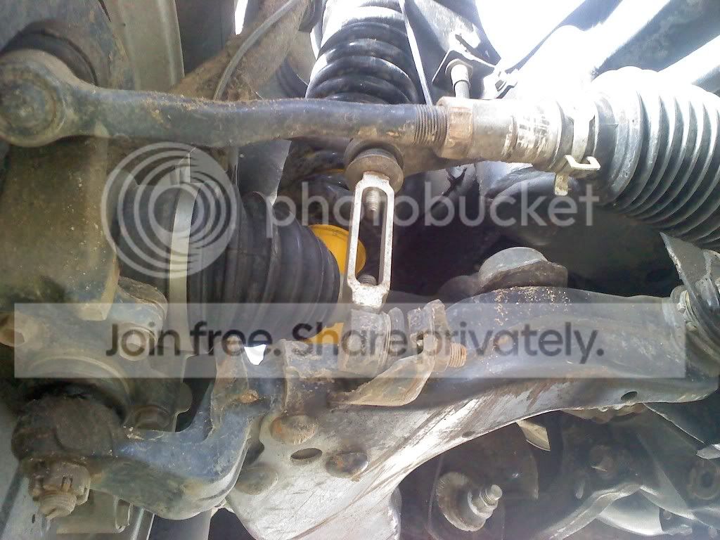

i tested my setup with and without sway bars and i got about 3 or more inches of travel increase in front and a big increase in the rear with no sway bars. i now dont run a sway bar in the rear. i tried discos in the rear but there is so much articulation that when stuffed the axle hits the sway bar on one side and jams the other side of the bar into the truck.
here are some pics of my front disconects i made. cost about 7 dollars i think. they are easy to use to.
