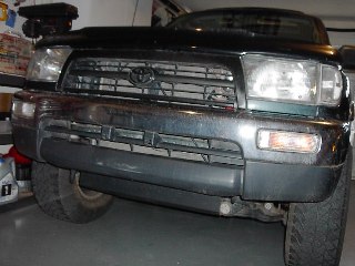

Another vote for painting it. Attached is a picture of my painted black gril and emblem. Remember, prep is key.
My bumper is next!
Attached Thumbnails swapping chrome grille for black...help needed!!-black-grill-001.jpg
