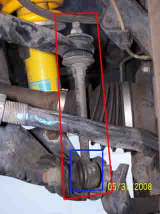

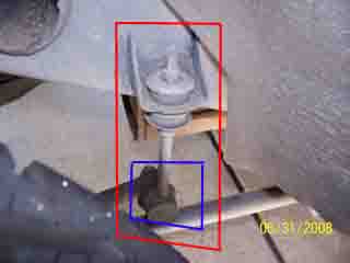

Ok everyone, need some help here IDing 2 suspension parts (I think they are the same, but want to be sure) and the haynes manual is not helping much.
I was under giving her a check-up and found these and I think they need to be replaced. I need help IDing the red boxes, and on the rear picture, whats in the blue box is leaking greese. The rubber boots on both sides are torn on the rears. The rubber on the tops of the fronts looks to be wearing a bit to me, but I don't know.

sway bar endlinks.... I need some new ones too. Sometimes they are sold as sway bar bushings or sway bar links. Yours don't look too bad... are they leaking at all? Any grease coming from the rubber boots?

yes on the rears, and the rears are torn....

same here...then they are gonna need replacement when you get the chance. I've been looking for some replacements for a while... but they are $90 each from toyota
