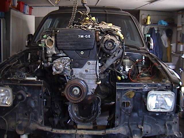

Hi. I'm currently finishing a supra swap into my 4Runner. The 3.0 l is a lot longer than the 3.0 V6. But is does fit without the use of the fan.
Anybody performed this swap before?
And what kind of electric fan has been used in front of the radiator (the only solution it seems) ?
I'm trying to find an adress or other info on pusher fans.

You said you are completing this swap?? Pics man we need pics! I know of only one other guy that performed this swap. I think he's got a site somewhere. Anyone have that link I can't find it in all my Runner related stuff.

pics
I've got tons of pics. Although I'm not finished yet.

Flex-a-lite fans have a pretty slim design, and should fit in the space described.
Wow, that will be great when you get it running. We definetly want to see pics as you go!

a supra inline 6 in a 4runner. . . . (wipes the drool of his shirt )

PS Is that a 7MGE (non turbo) in there????

Oops sorry I know yours is a turbo SuperRunner, I was trying to ask 4Runner4Ever...his pic says 7M-GE and I saw no turbo parts on that engine (didnt' look that hard though) so I thought i'd ask...turbo=more bang for the buck....

Unfortunately it is a non turbo. But it still has a lot more torque and horsepower than the s...y V6. Blown two headgaskets in one year. Just had it tuned (ported, headers,ignition etc.). Two weeks later the igniter failed: it's now a V5.
Instead of repairing it (i've got the head gaskets in stock!) I bought a supra at an auction for 600 euro (500 50$ I believe)without seeing it. It turned out to be a non turbo automatic with right hand driving.
So now I've got all necessary parts, except for the manual trans. I've used the R 150 gearcase from the '90 4Runner and fabricated my own bellhousing. I've ordered a clutch for the turbo supra and bought a used turboflywheel. Looks like I'm quite finished now except for radiator, electrics and prop shaft. The propshaft has been custommade and will arrive tomorrow.
I hope to have it running in 2 or 3 weeks.
You sure that is going to work?
The turbo supra uses a pull style pressure plate, and requires the extra 30mm of room the supra belhousing and input shaft have over the R150.
I run a non-turbo flywheel and a non-turbo clutch because with my custom bellhousing, I cannot use the turbo setup.
