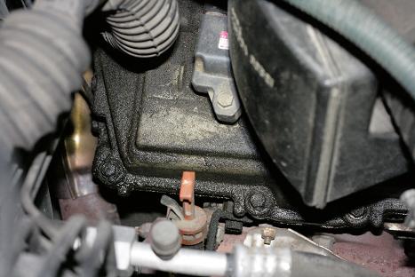

here are some pics. 1st pic is just the throttle, 2nd is showing the result of a leaky valve cover gasket, 3rd is just the otherside of the engine. I'm not really sure what else i can take a pic of...
now that i'm thinking about it... i think i'm just being paranoid about this whole thing.....
