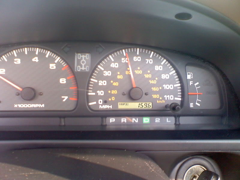

Ok I have something new to add to the theory pool. I know to reset the CEL light you unplug the batt. - or + and leave it off for a few minutes then re-attach the removed wire. This resets the ECU and the light goes off and the ECU re-learns the numbers from the o2's.
Enter theory 1. when the CEL is on and the VSC lights are on as well then your O2's have tripped it and you will get 1 of 2 coeds indicating front or rear O2. While the light is on your vehicle should have switch over and is now running in an open loop not conserving your fuel as it should be because your air fuel ratio is off.
Theory2. If theory 1 is true then when you disconnect the batt. terminal and then re-connect after proper elapsed time your CEL light is off and the vehicle is running normally in closed loop.
Theory3 . I have only had to disconnect the batt. a few times and after each instance the fuel economy soars to almost 19mpg. If this holds true then I will disconnect the battery every 2wks to see if I get an overall increase. While the only down sides are reseting the clock and proffered stations the upside is better fuel economy.
You'll notice in the upper right hand corner 162 MI. This is my actual mileage on the current tank of fuel as the needle just hits 1/2 tank/

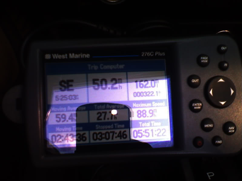

There is a slight deviation I cannot even remove with the Super Lift True Speed calibrator. But after a full tank and highway/ city driving the GPS and 4Runner trip meter often only disagree by 1-3 miles.
