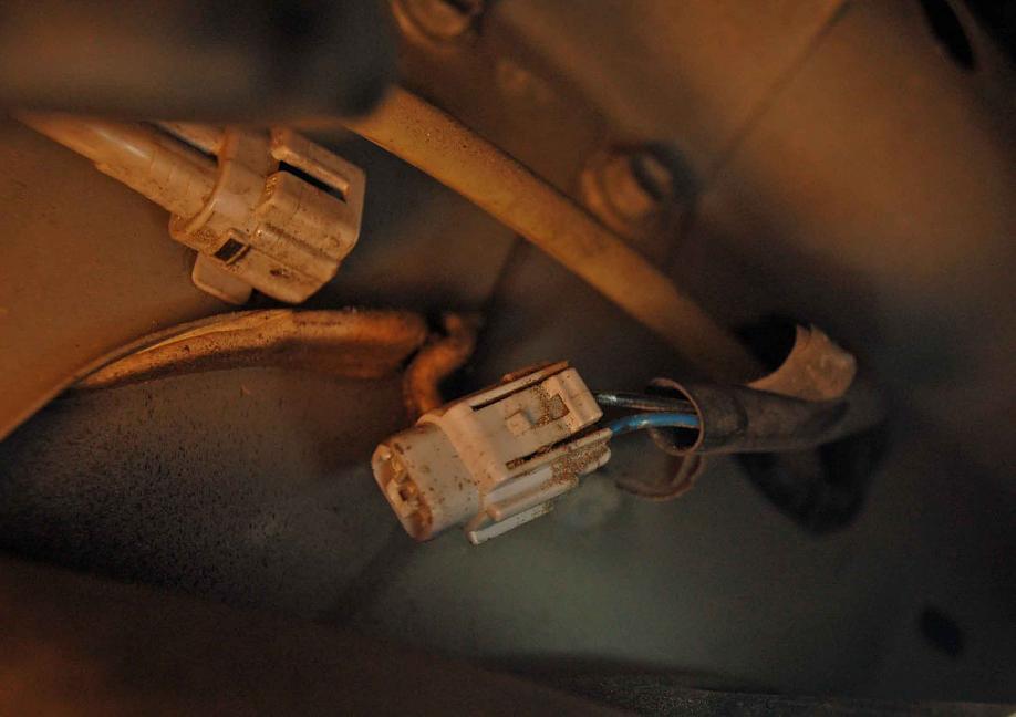

I've decided to just live with the mast on my 97 4runner. The plastic teeth have broken (again). I would like to just remove the power from the antenna assembly, but not sure what it looks like. I've pulled the plastic liner back in the wheelwell and traced a wire back which is clipped to the middle of the inside fender (behind the plastic). It has a blue and black wire going into this clip. I've disconnected that. I checked the radio and there is no power going into the antenna mast (thankfully no more grinding noise). I want to make sure this was the correct clip to disconnect and that nothing else will be affected by this. I've manually pulled up the antenna and radio reception is fine. Am I good to go now?

I've taken a few pics of the large black wire coming out from the antenna motor. And also of the clip this couples with on the wheel well fender. This is the one I've disconnected as shown in the picture.Successfully replaced OEM antenna mast?-antenna-motor-assembly.jpg

or you can just put a switch for the antenna so it doesn't go up when you switch your radio on.
see that blue wire on the second pic? splice it and put a switch and you're good to go!
