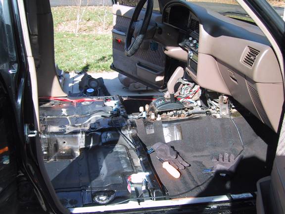

Alright...now time for my pics and some questions.
I now have all of the carpeting removed and I'm ready to start on the Peel & Seel on the bottom, the headliner will be another day...probably tomorrow.
So...with that said, here's a quick pic of where I am at. I will ask questions after I post this, I was going to post more than just this one but the stupid image I wanted to post is .1mb off so I can't do it and I don't have anyway to host them. Oh well...its more important to me to get my questions answered.

OK, time for the questions guys.
First off, when I pulled the carpeting up there was this thick, squishy black padding of some sort that kind of ripped up with the carpet. Some of it was stuck to the carpeting, causing big holes to be ripped in it and then some of was still stuck to the floorboard. I am assuming this is the stock sound dampening. I have now torn up just about all of it, except for the parts where it is really stuck. Am I right in assuming that this is the stock sound deadening stuff? Should I replace this with something else once I get the Peel & Seel put down? What should I do about this?
Second thing is...this carpet looks like its gonna be a PITA to put back down, is it as really hard as it seems?
Another thing, do they make aftermarket carpeting for the 2nd gens. I looked at the retail price from the dealer for just the FRONT carpeting and it was going to run me over 500 bucks, and that was at the employee price at the dealer! Rediculous I tell you!! Any ideas?
Thanks for lookin and any help or ideas you can provide would be great!
Fink
Fink

Yeah - that squishy black stuff tears VERY easily. And unless you can piece it together, I would say take it out if it's too beat up. I only say this since the carpet will get a little lumpy if there are too many gaps in the stock sooundproofing. What I ended up doing was just putting the spray on sound deadener onto the metal and then doing a layer of regular dynamat type material on top of it. It still ends up thinner than the foam - just be aware that when you do this, any stereo wires under the front area might appear as ridges in the carpet. This happened to me, so it forced me to make sure all the cabling for the cap and 2 amps was nice and neat by running it down the sides.
As far as the carpet - I would try to reuse the current one if it's in decent shape. I can only imagine new carpet being less flexible and harder to put down. I would see if anyone else has any input on this part.
